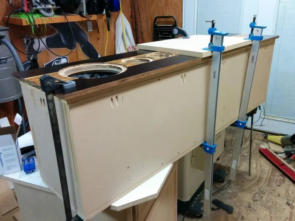

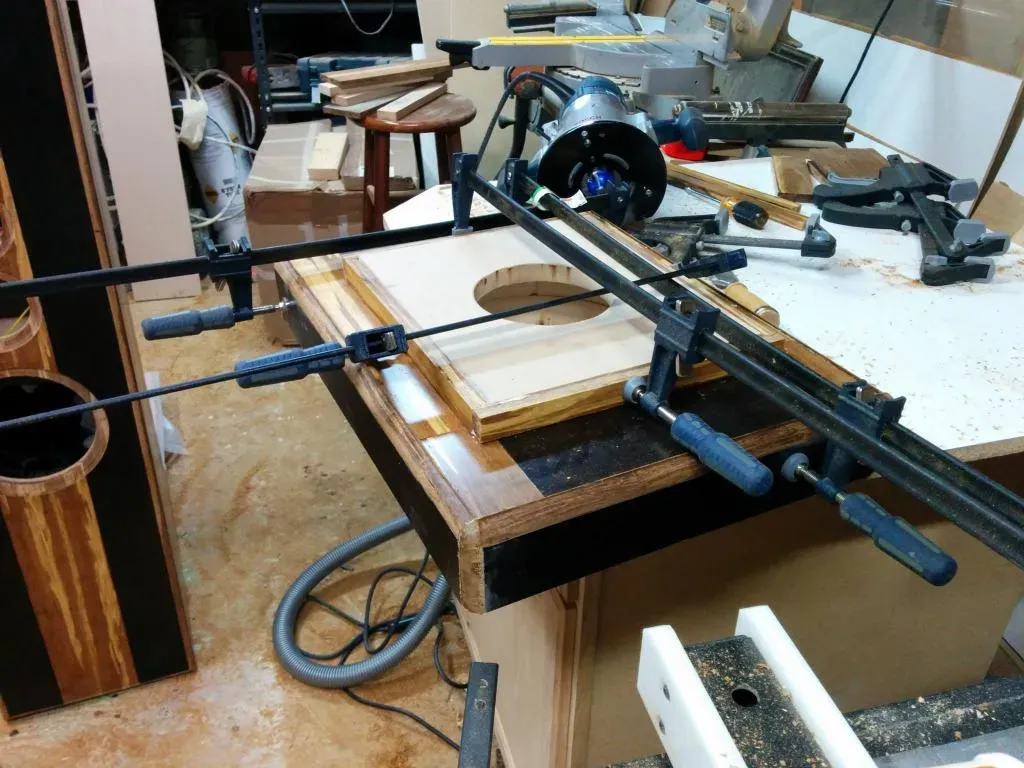

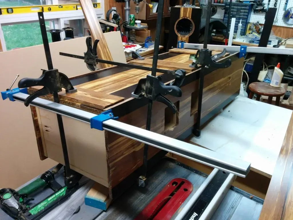

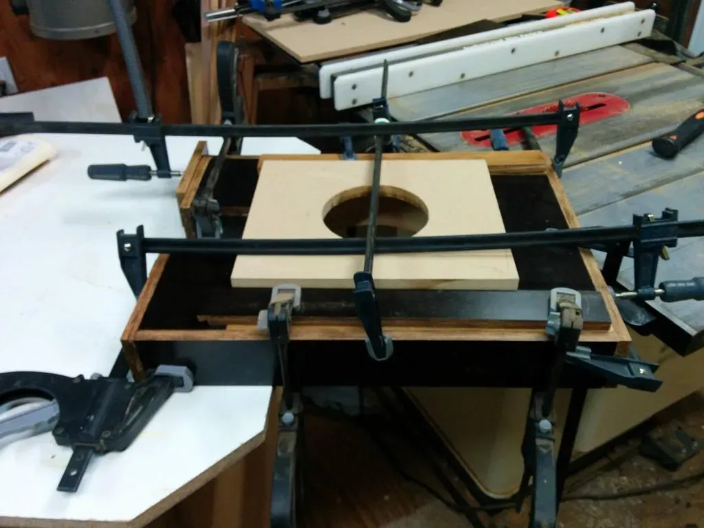

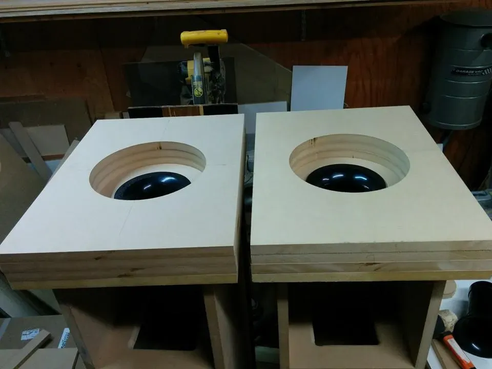

    Hey all,

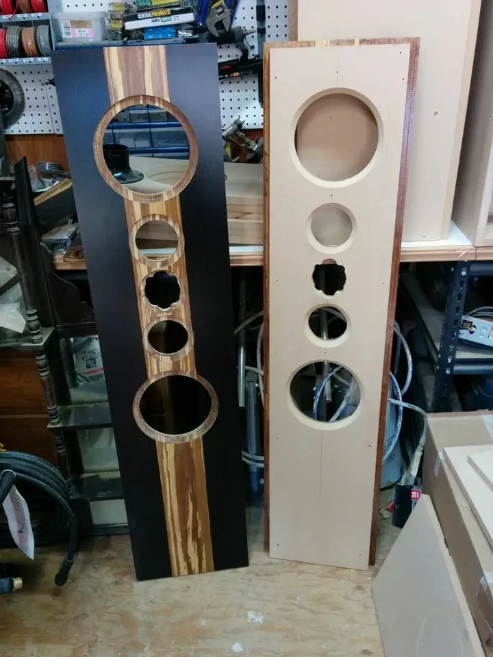

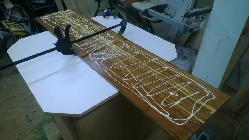

    In the past month or so I have embarked on a full-size Statements build. I am nearly finished with the mains and will move on to the Center Channel.
    Here's the build of the Mains (one more to skin):
    Images not available
    Regarding the Center Channel. I would like it to be a full size Statement i.e. retain both 4" mids. I can build it to standard spec and replace my current projection screen with an audio-transparent screen but the speakers are purdy and I'd like it to not hide.
    Thoughts on
    A.) Building the sealed version and just flipping it on it's side
    B.) Offsetting the tweeter and try to maintain on-center distances between all drivers..
    Thanks in advance!

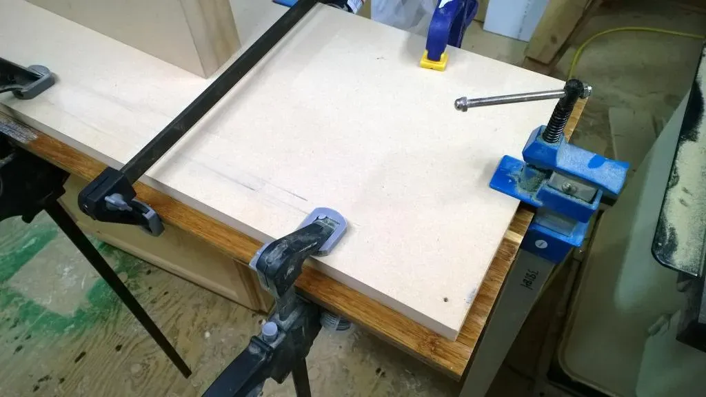

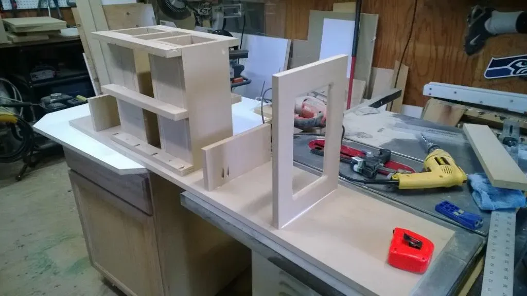

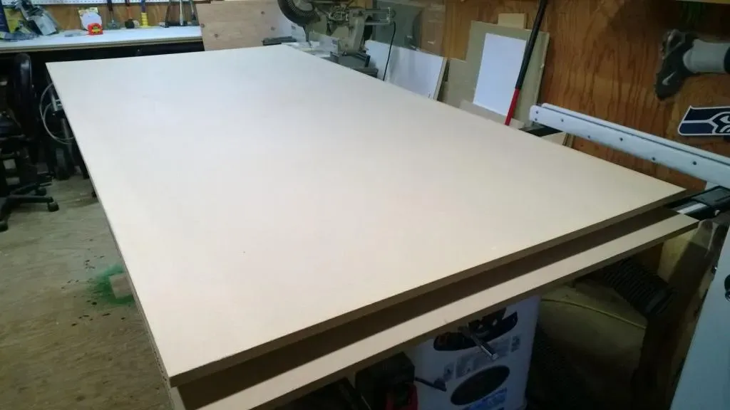

    Build photos

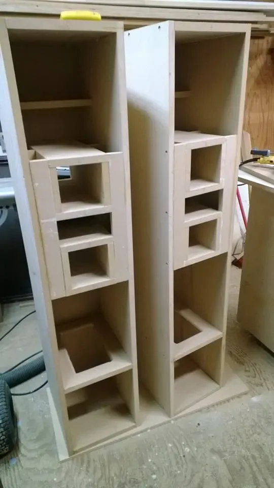

    Last edited by theSven; 01 April 2023, 15:53 Saturday. Reason: Update image location

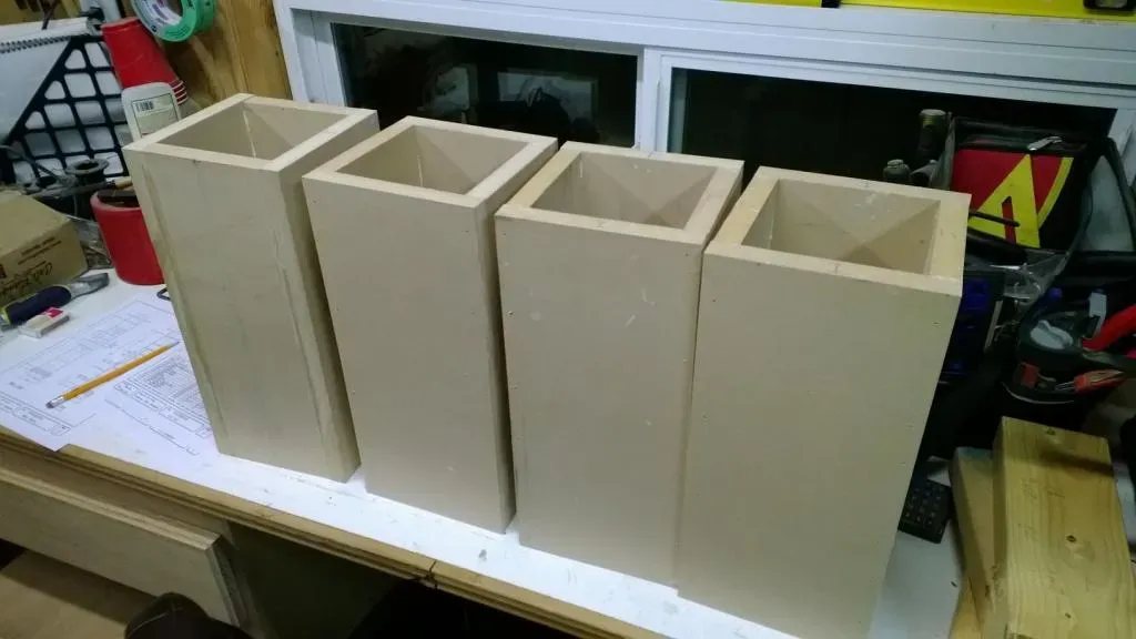

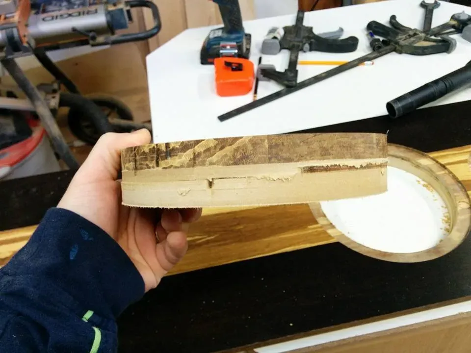

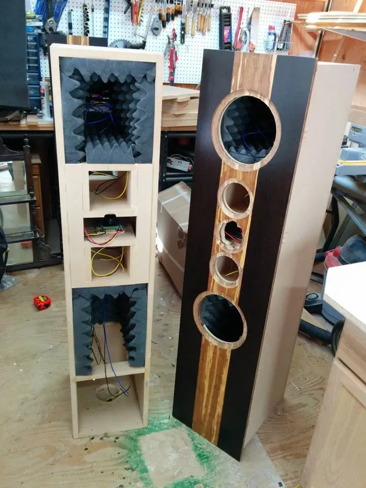

      Build photos
      Last edited by theSven; 01 April 2023, 15:56 Saturday. Reason: Update image location

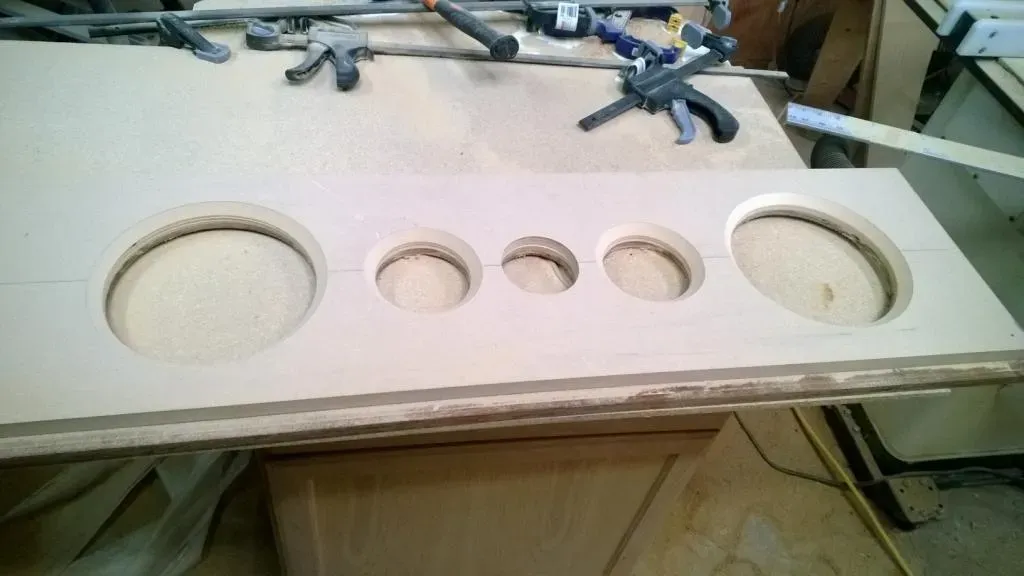

      • poppapig
        • Mar 2014
        • 34

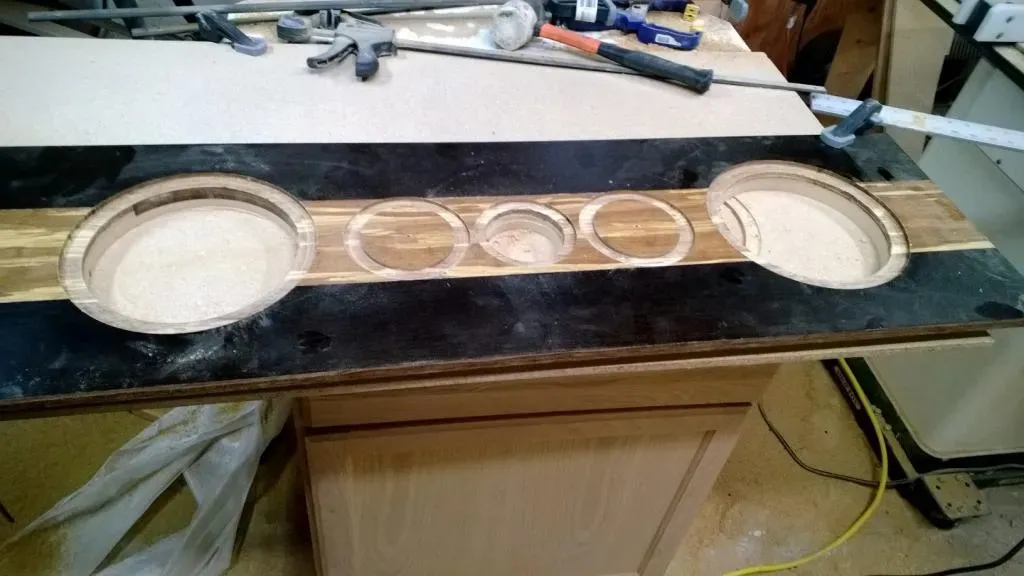

        Build photos

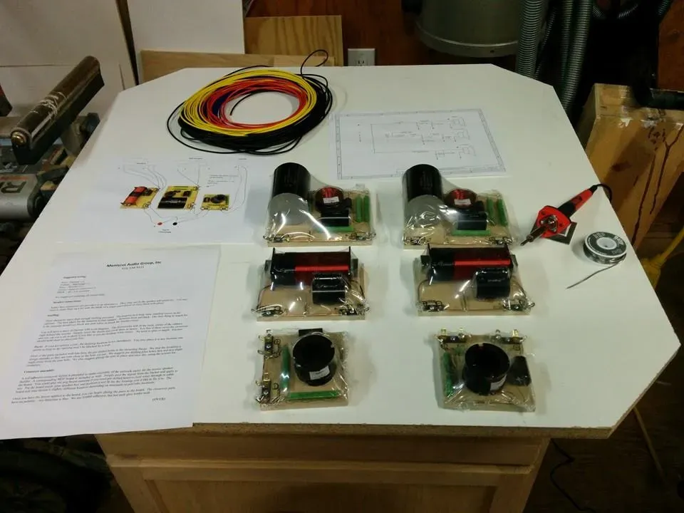

        Last edited by theSven; 01 April 2023, 15:58 Saturday. Reason: Update image location

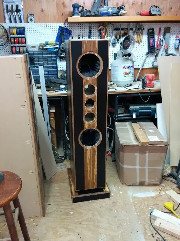

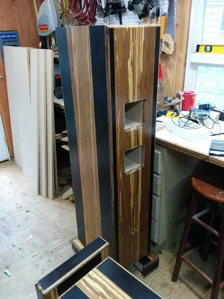

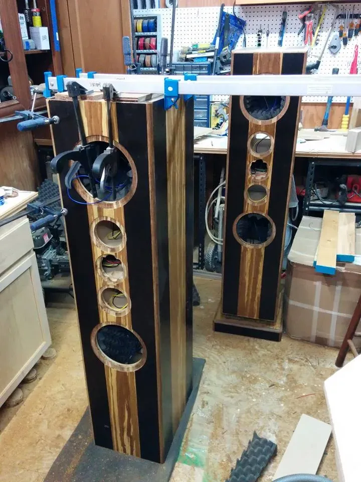

        • poppapig
          • Mar 2014
          • 34

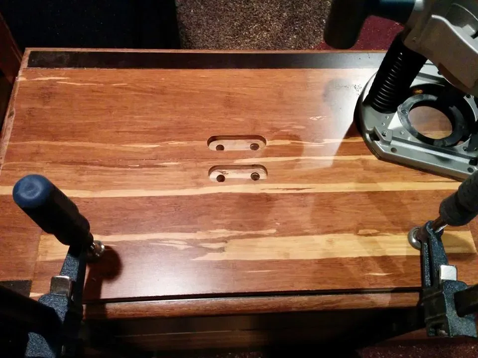

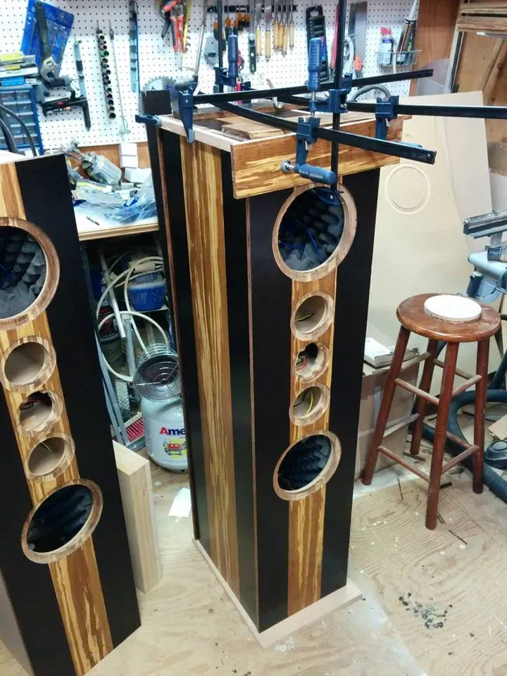

          Build images

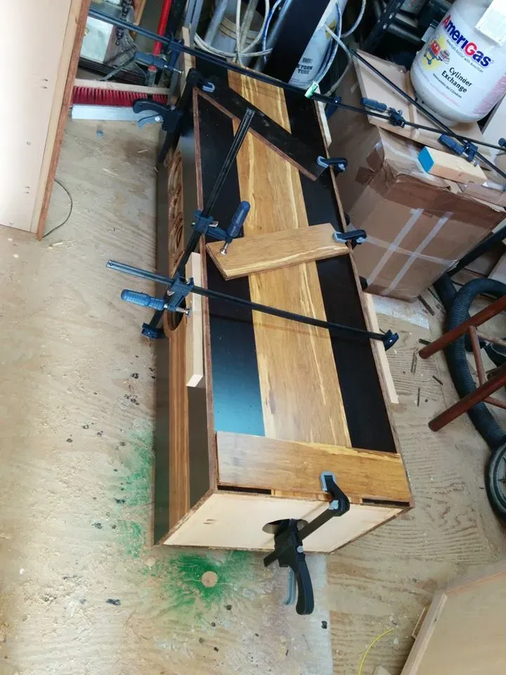

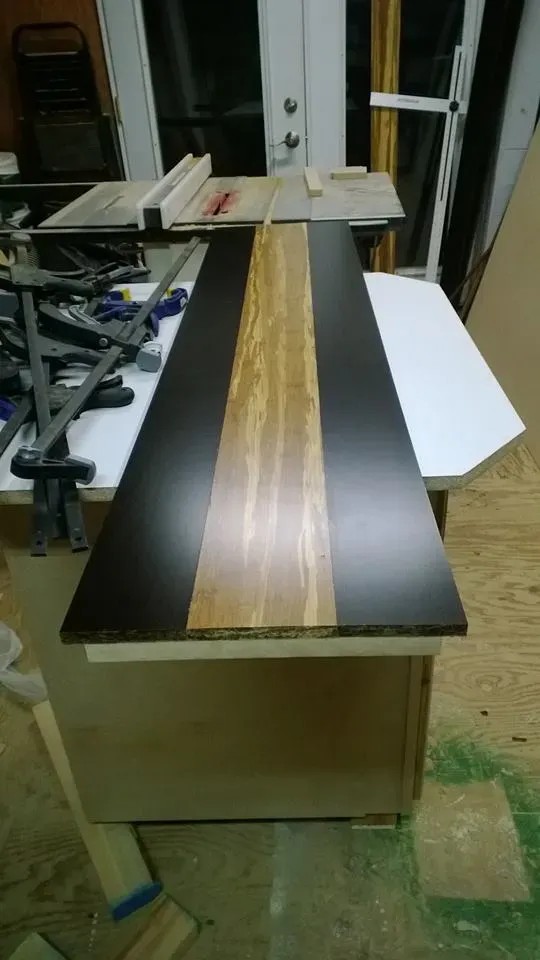

          Last edited by theSven; 01 April 2023, 16:01 Saturday. Reason: Update image location

              Very nice build!
              I'd suggest the Frodaddy center based on what you're wanting. There is a thread in Mission Accomplished that should have all the build info.

                Very nice build!
                Ha! I was JUST perusing his pages Thank you Jim, the project has been challenging and allot of fun..

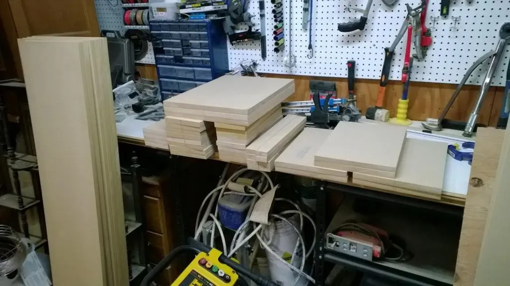

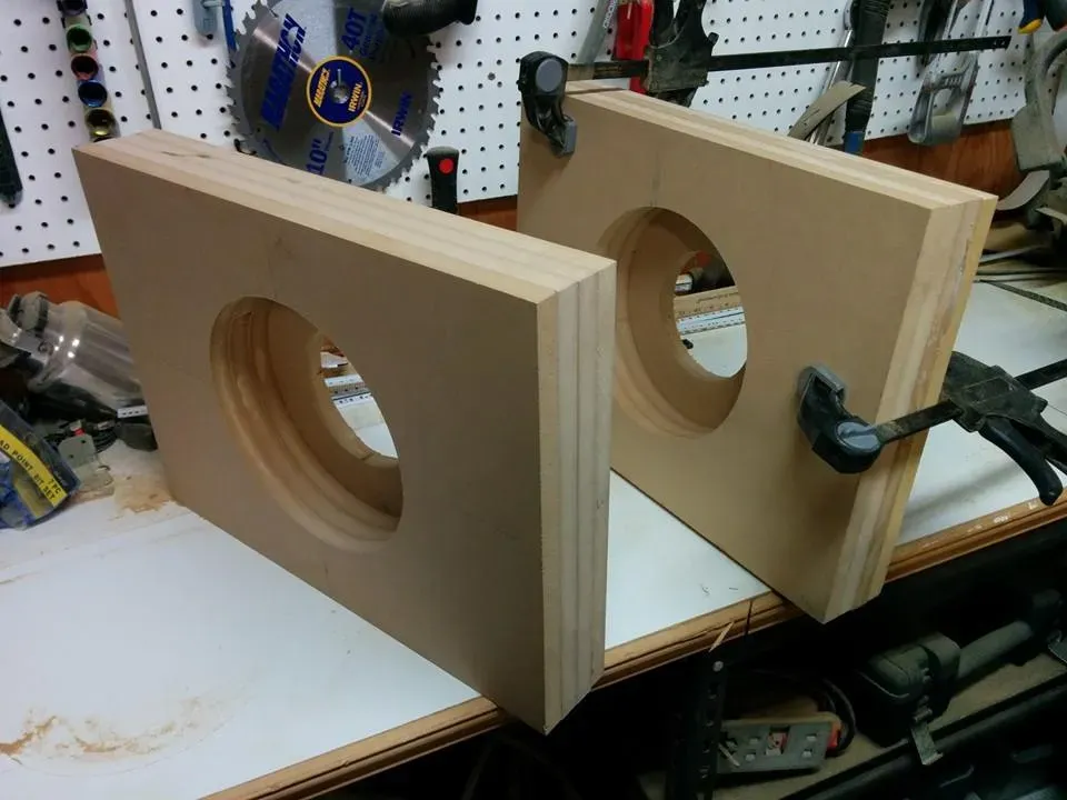

                          Two thoughts.
                          1. I can't see if you cut a channel in the back of the base so the port could breath. If not, you need pretty tall spikes on the bottom of the base to give the port plenty of breathing room. I used 2 1/2" tall spikes plus I have a 5" wide channel cut in the back of the base.
                          2. Breakin; I like to get about 20 hours of playing time before I do much in the way of critical listening. Normal volume playing what you'll listen to is fine. Turn it on and leave.
                          • poppapig
                            • Mar 2014
                            • 34
                            Two thoughts.
                            Thanks Jim,
                            I didn't see the Base channel in the specs but that makes sense. I ran the unfinished base over the table saw, but the finished base will require skill-saw surgery
                            Regarding break-in: Ok, very good!

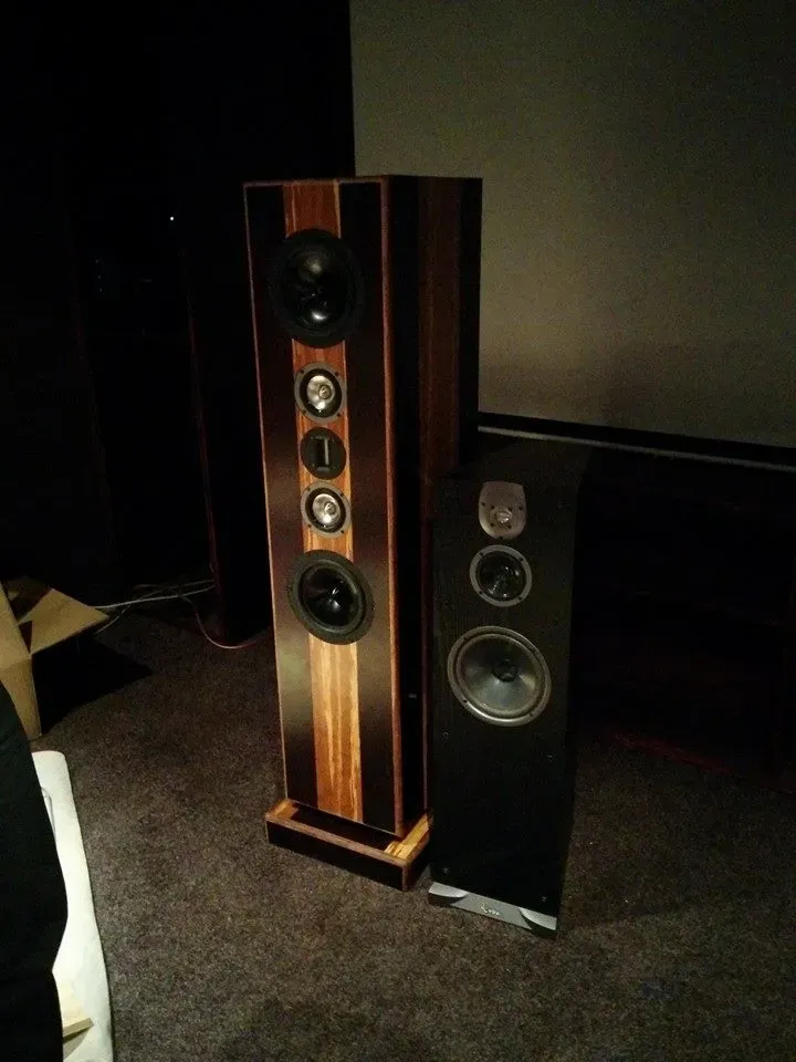

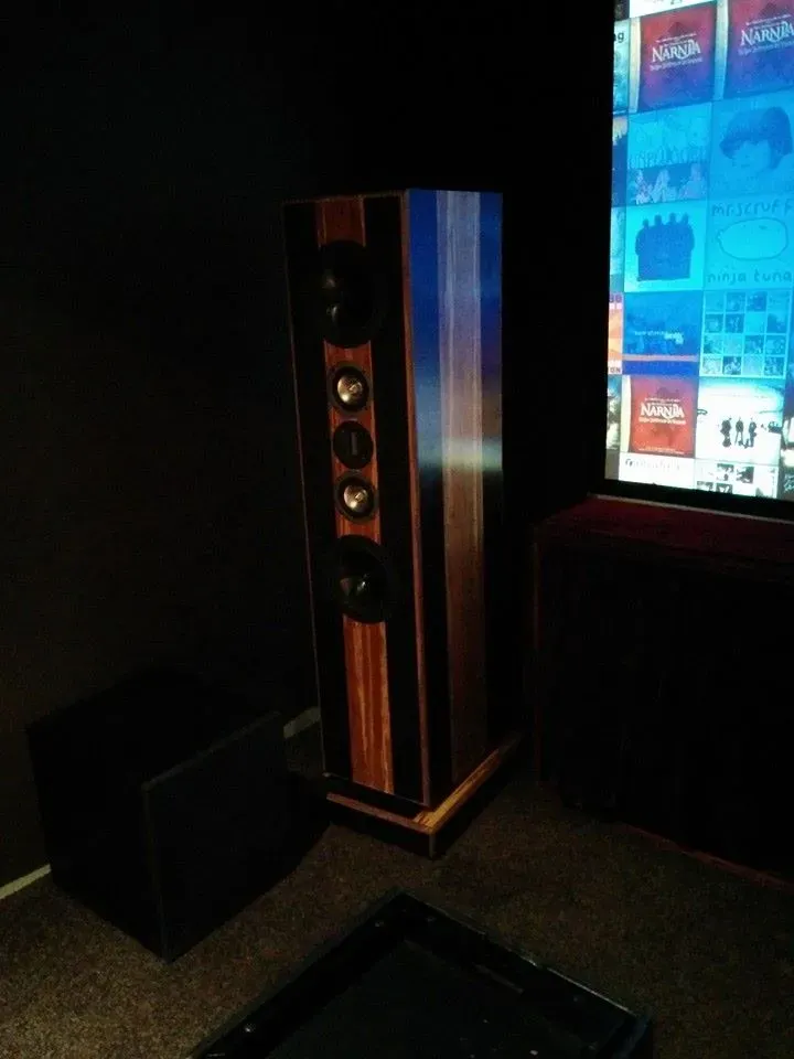

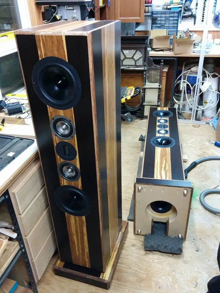

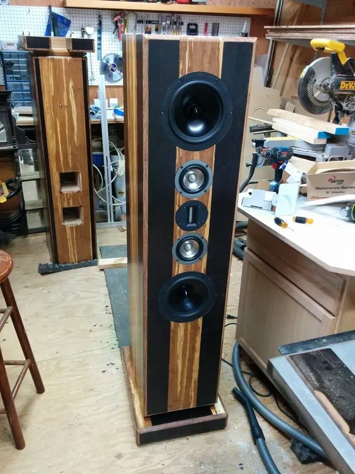

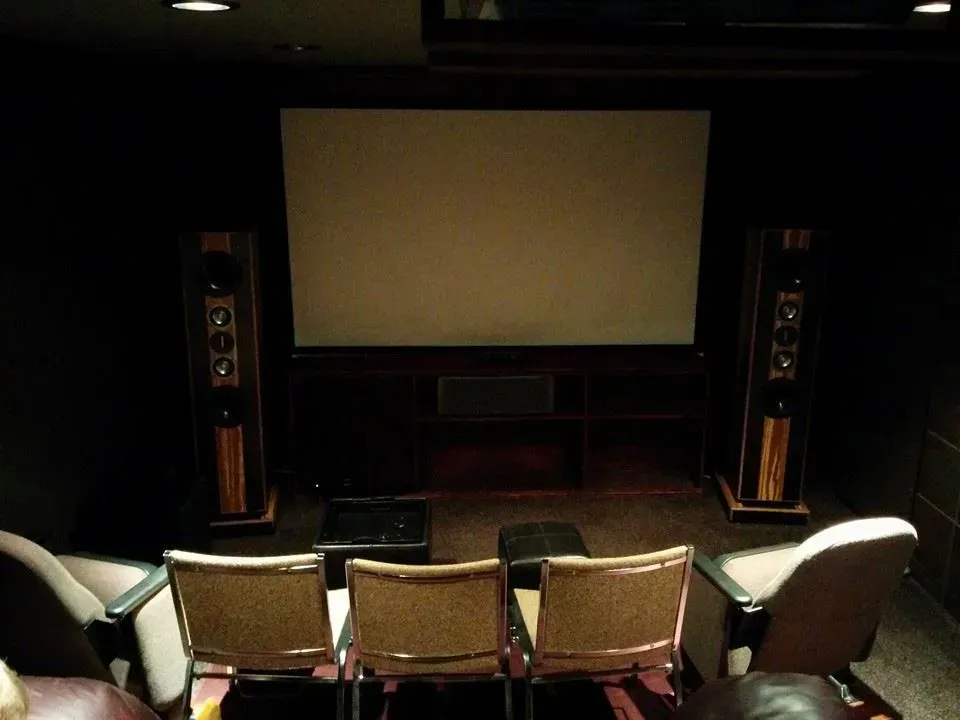

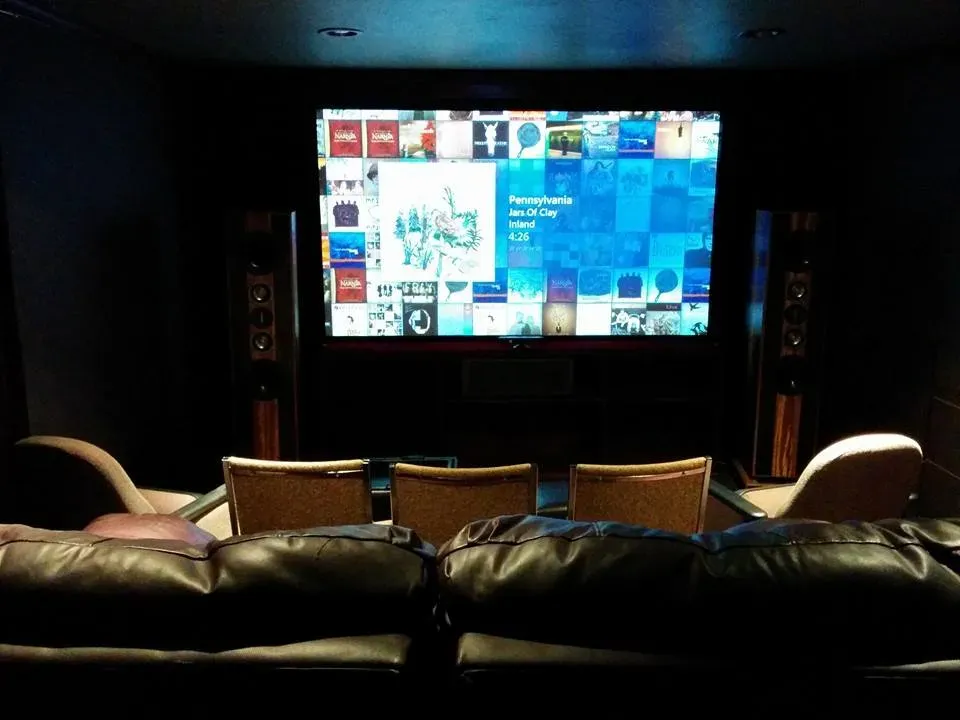

                                                  MISSION ACCOMPLISHED!!!
                                                  I'll take time later in the week to provide listening impressions but for now here are the final pics (though I may take more with a legit camera as these are all from my phone).
                                                  Pretty sure these tip the scales ~230lbs each. My good buddy is a power-lifter and I'm a Triathlete; we needed the training to carry these inside They are placed 18" from the back wall and maybe 14" from the side. I don't recall what the recommended side-wall placement is.. The "little" floor stander next to the Statement in the picture is an Infinity Delta 40 (ran those for 15yrs!). I will likely make a velvet side panel for them to eliminate the screen glare. I am already very impressed with some listening I did before a gathering in my Man-Cave last night (Film&Theology). I stared at them often as if they are two centerfolds who have taken up residence lol.. They are big and beautiful.. Yes I hugged each one! Hey what can I say.. I'm a Statement-hugger.
                                                  Last edited by theSven; 01 April 2023, 16:10 Saturday. Reason: Update image location

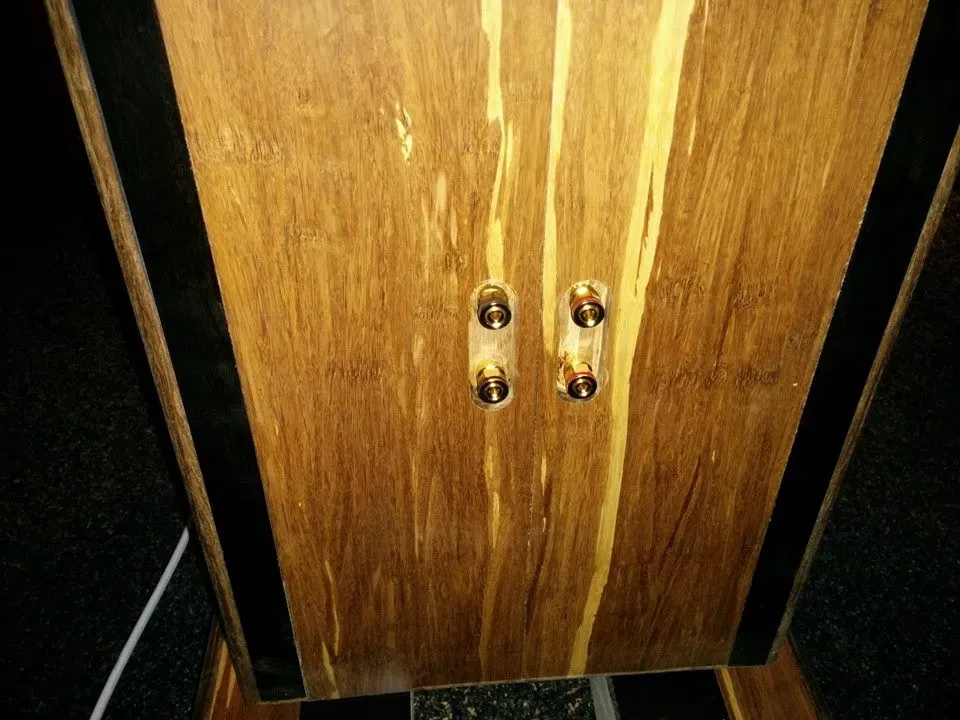

                                                                    I would sum up the use of my Statements as eclectic. They live in my Man-Cave/Family Ent room where Movies/TV/Xbox are viewed and listening is done. Probably a 75% TV/Gaming to 25% music listening split. I have diverse musical sensibilities but particularly enjoy acoustic sets/pure vocals. I also enjoy high quality live concert series videos.. I like sensible, clean/tight base and play most everything at a moderate listening level.

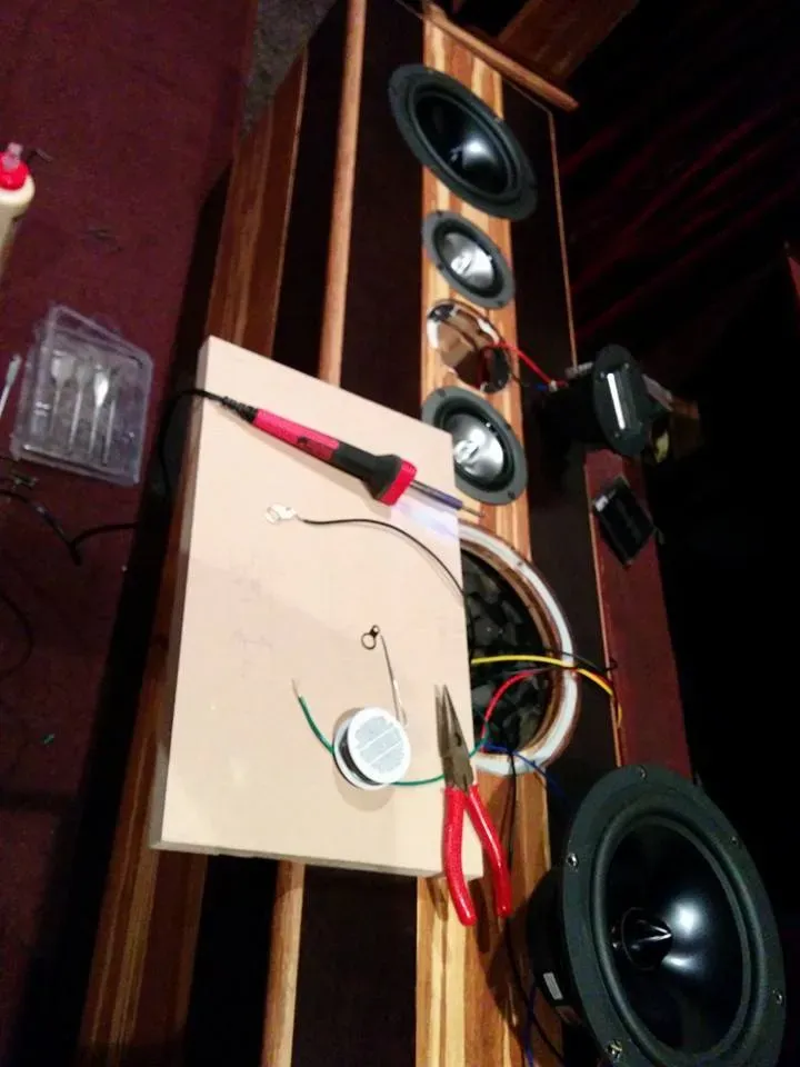

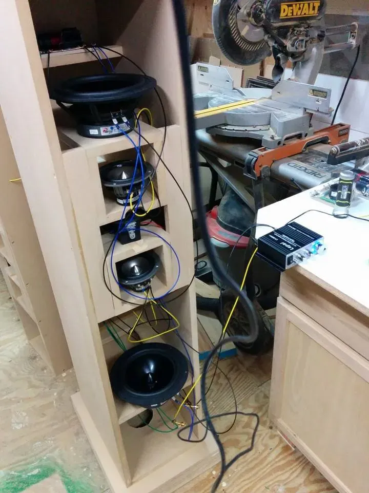

                                                                      The Bamboo Mammoths got hungry, so I Bi-amp'd them

                                                                            Two thoughts.
                                                                            It has been a while since I logged in of course having built my own statements I had to see how everyone was doing on theirs and noticed Jim's comment "I can't see if you cut a channel in the back of the base so the port could breath" I don't remember this in the original plans, did I miss something? Is this new? Can someone explain this for me? Thanks
                                                                              If I remember correctly, it was a running change that was made after the Statements were published. As long as the port has plenty of room to breath it's not a requirement for good bass at all. I also used 2" spikes to lift the base far enough off the floor to allow good air flow in all directions.
                                                                              You'd know if you had a bass problem by now.
                                                                              • Mrpictureman
                                                                                • Aug 2008
                                                                                • 28
                                                                                I'm pretty pleased with the bass response and tightness, although I do have them elevated 2 1/4" so I will stick with what I have Thanks Jim
                                                                                • PassingInterest
                                                                                  • Mar 2010
                                                                                  • 30
                                                                                  They look Majestic!
                                                                                    Progress always makes the best photo....

                                                                                      Some updates:
                                                                                      Last edited by theSven; 01 April 2023, 16:14 Saturday. Reason: Update image location
                                                                                        Beautiful! :T
                                                                                        • kevinm
                                                                                          • Jun 2013
                                                                                          • 417
                                                                                          Looks good! Very unique. What do you have in those cabinets on either side of the center?
