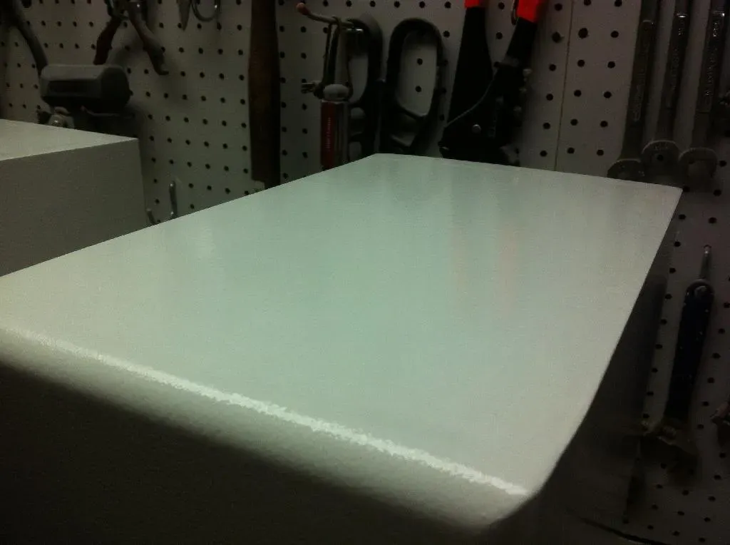

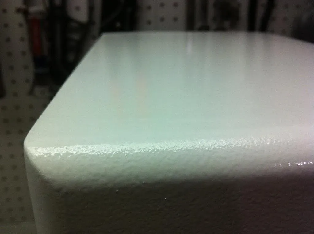

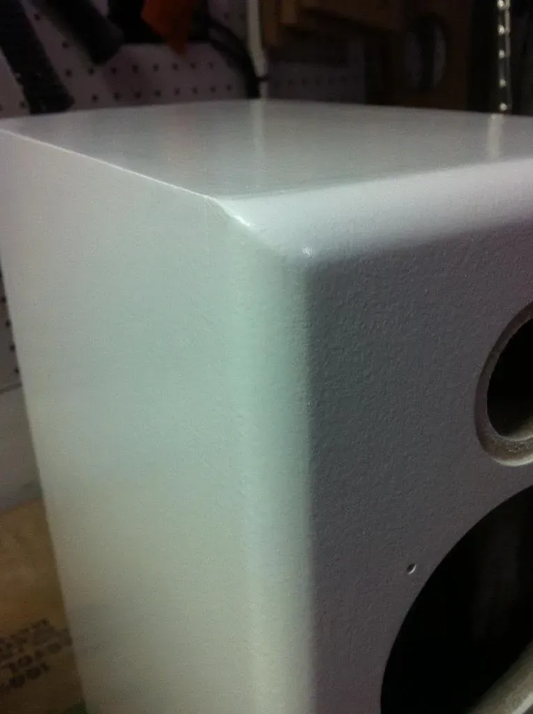

    Almost done painting the last cabinet. The thinned out acrylic is flowing very nice. It's not finishing completely flat (which I didn't want), I would call it more of a leather like texture. I'm very pleased! The semi gloss shine/reflection is coming out great too.

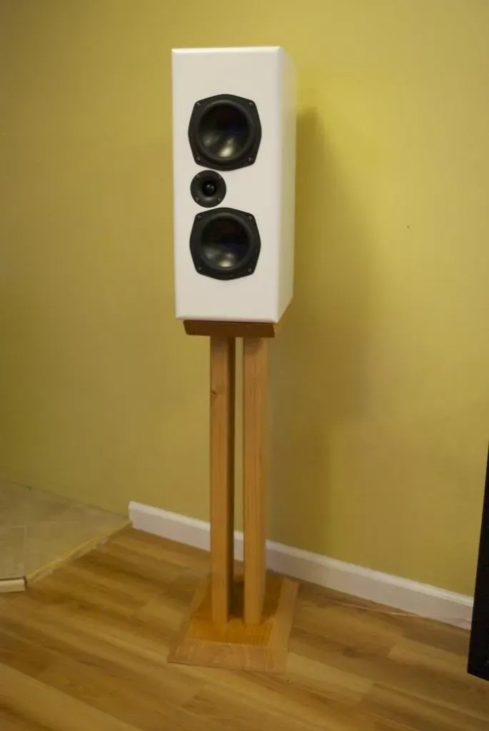

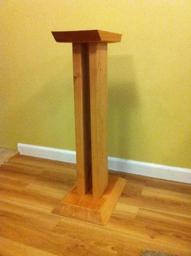

        You know you're getting close when you're building stands! I cut, sanded, stained, assembled these tonight. Used some 2x12's I had laying around, and spent $15 at HD for some 2x8's and 2x6's.

          Those will work. Almost there.

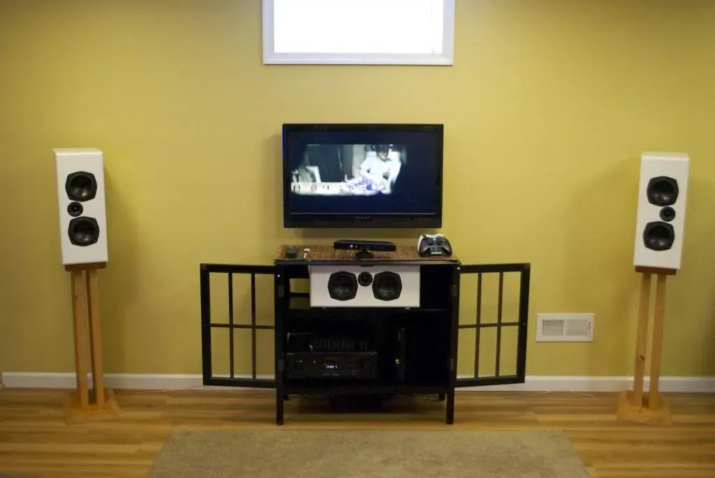

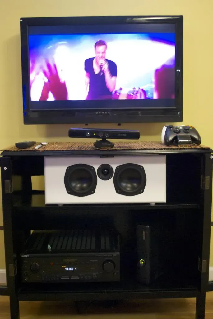

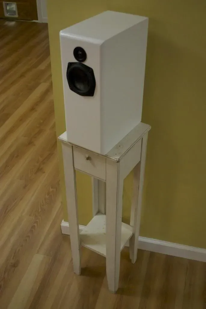

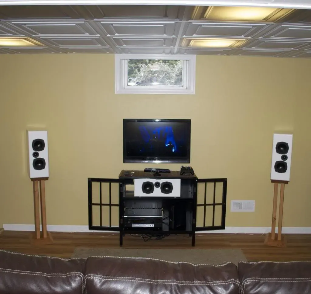

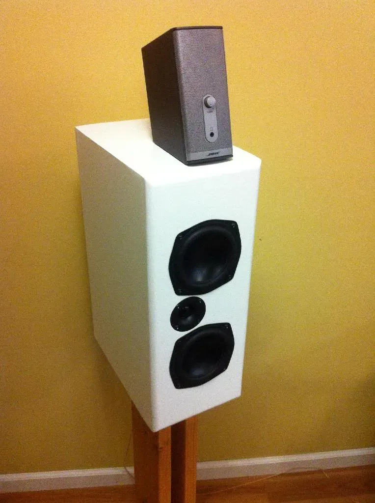

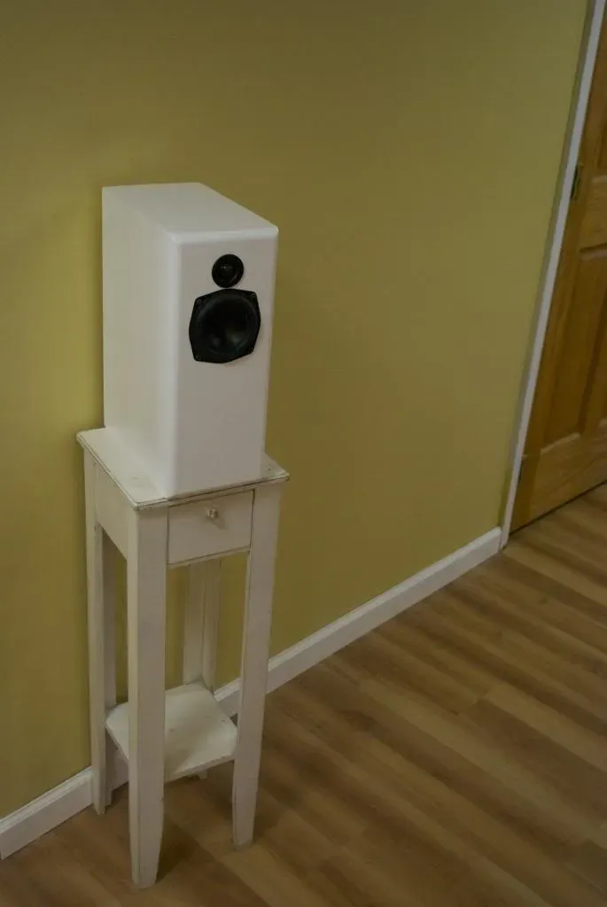

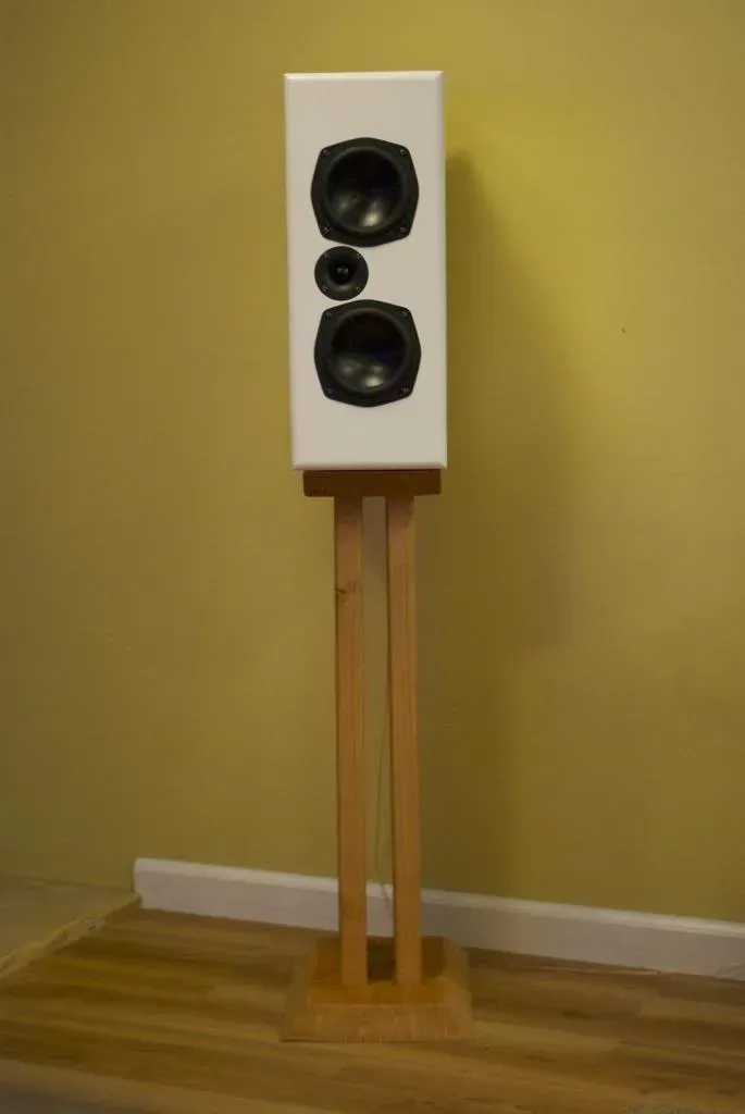

            And then there was SOUND! Initial impressions are "Stunning". Symbols, Rim Shots, Mids and Bass are all beyond what I had thought. The listening will continue as we break em' in. I love the sealed box, and the fact that I don't have to worry about spacing them out from the wall. Incredible sound for such an affordable build. Very pleased! I would recommend these to a friend to build w/o question. Thanks Ryan and CJD.

            The Bose speakers that they replace.
            Click image for larger version  Name:	6BDBC346-52BA-4847-B9A6-AEC37A268430_zpswa6dq9st.webp Views:	0 Size:	94.1 KB ID:	934839

              I'm glad you like them. They look great.
              One thing I would recommend with the center channel, Pull the center out, so there isn't the lip above it. And, see if you can fill in the sides with something solid. Try and adjust things so that there are flat surfaces all around the face. Try and make it more like an in-wall. See this post to see what putting the speaker in a cavity like that will do to the sound. It isn't pretty. And it definitely is audible. https://www.htguide.com/forum/showth...mp-Baffle-Step Maybe it is time for a new entertainment center?
              Then be sure to experiment with placement. Generally, Tweeters in improved but narrower sweet spot. Tweeters out, slightly less but wider sweetspot. The differences are so minor, might never hear. Toe in more and brighter, toe out and more off axis so it can take some edge off the top end. Closer to the wall more bass reinforcement, but you get a null in the frequency response. Pull out away from the wall and the less bass reinforcement but that null moves around.
              Now where is the subwoofer???
