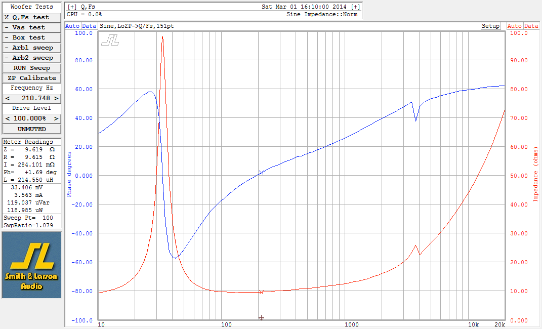

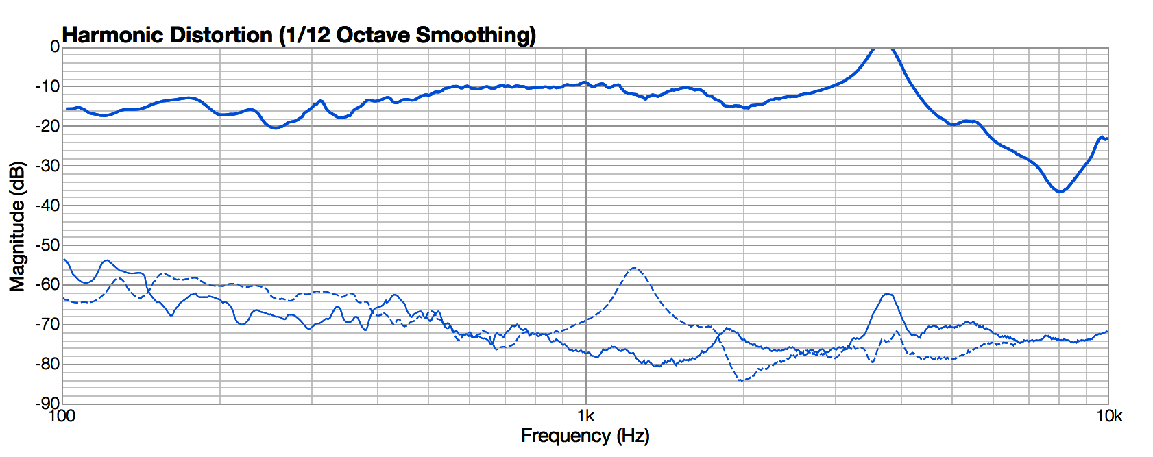

                        I'm guardedly optimistic- I think these parts, and the chosen sealed alignment, have a lot of potential.
                        This graph sums up the basis for my optimism,
                        as well as this one:
                        the low distortion, both 2nd order, and in the midrange, is a function of the very nice motor design, which is also highlighted by the very well behaved impedance curve (for two in series) shown above- minimal inductivity modulation and a well controlled curve combined with the stiff enclosure design and LF alignment (fairly well damped Fb at 32 Hz) should work quite nicely with good room placement. Cross fingers...

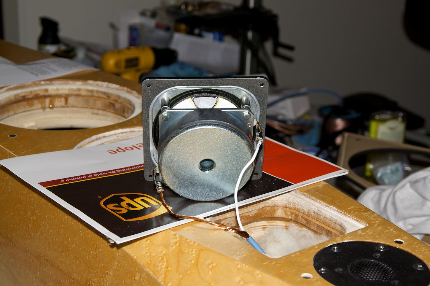

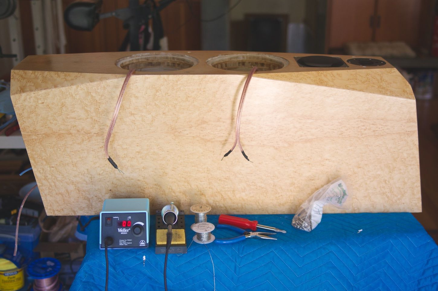

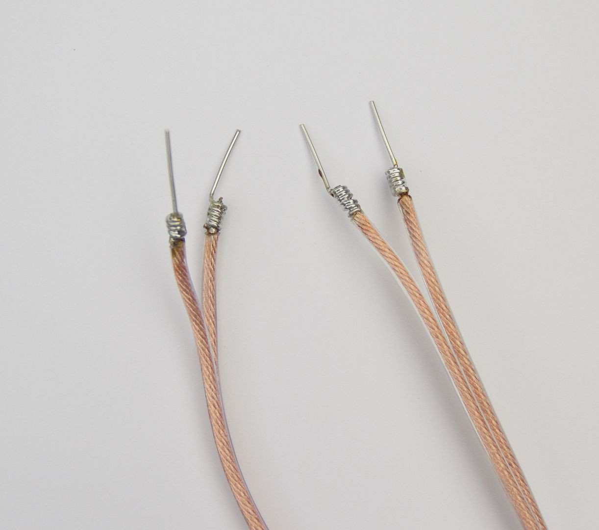

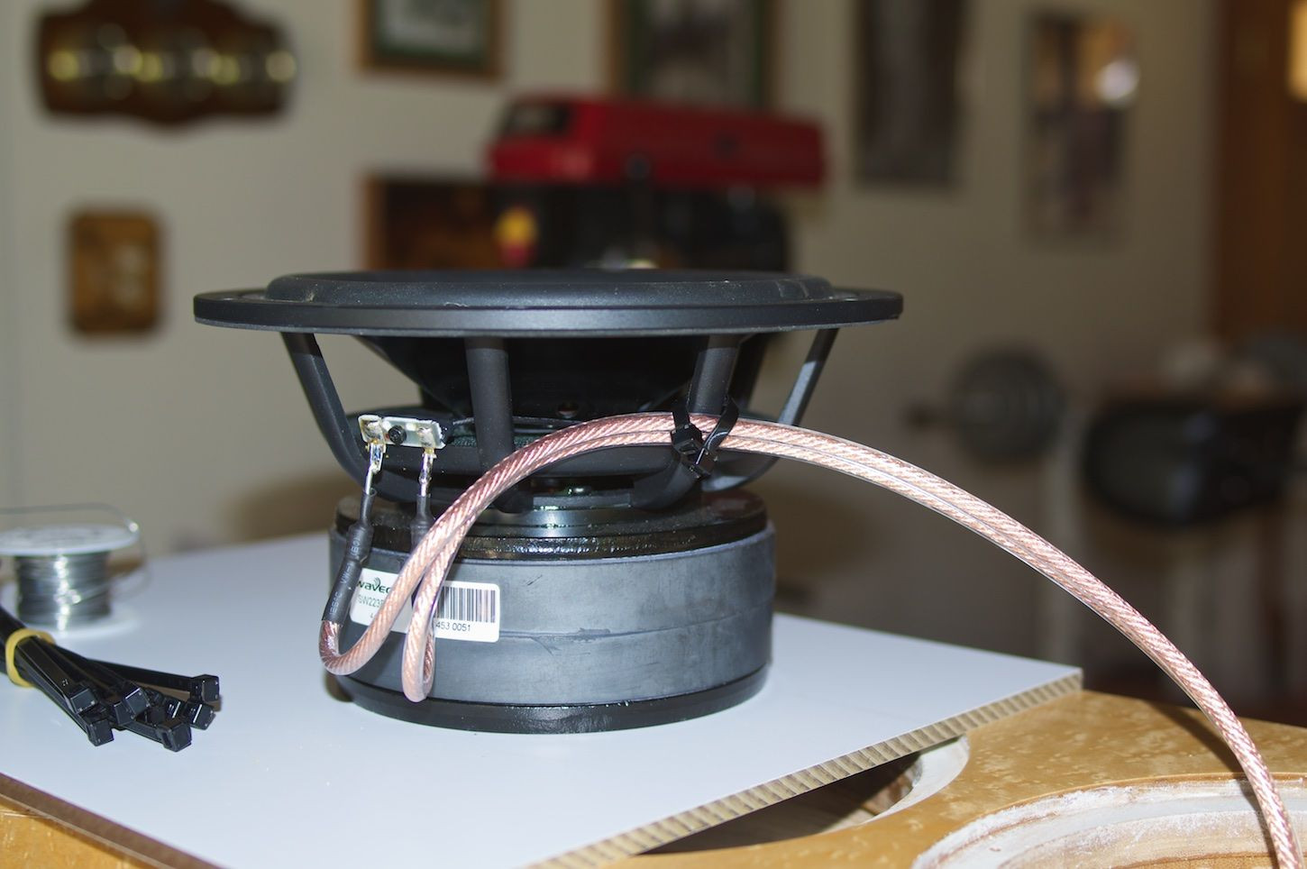

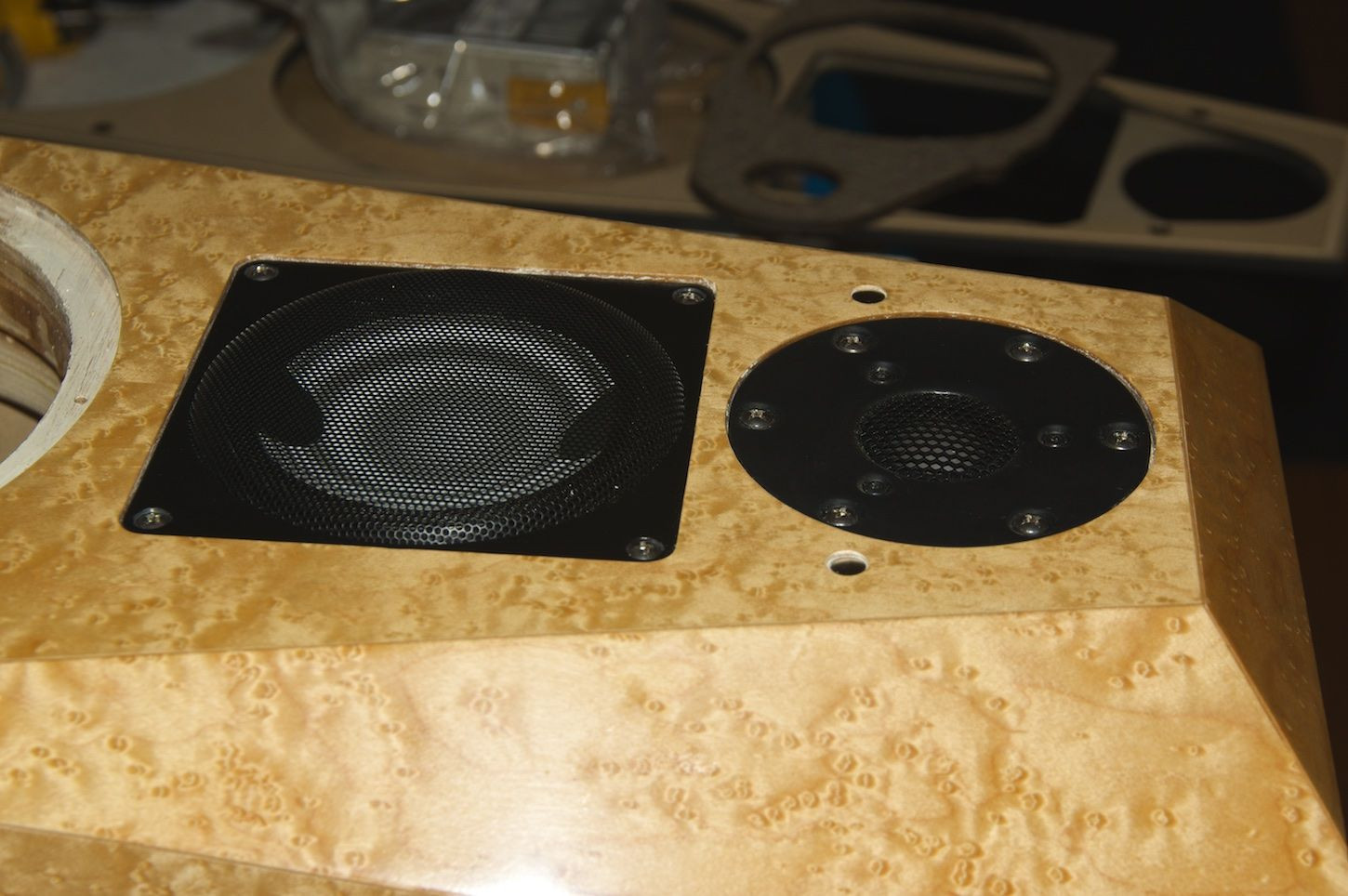

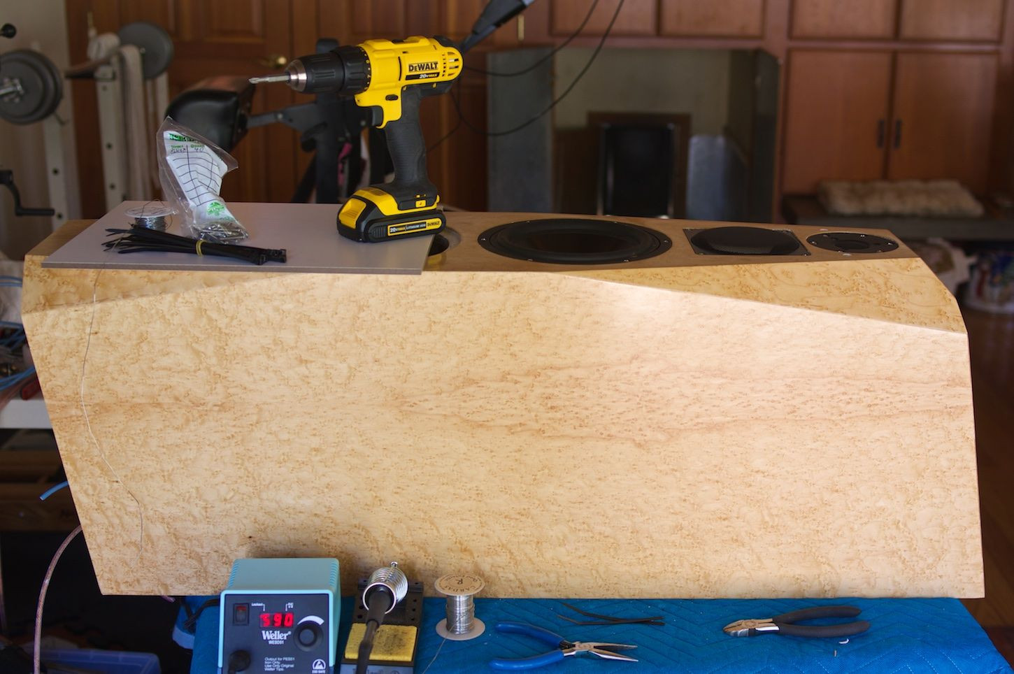

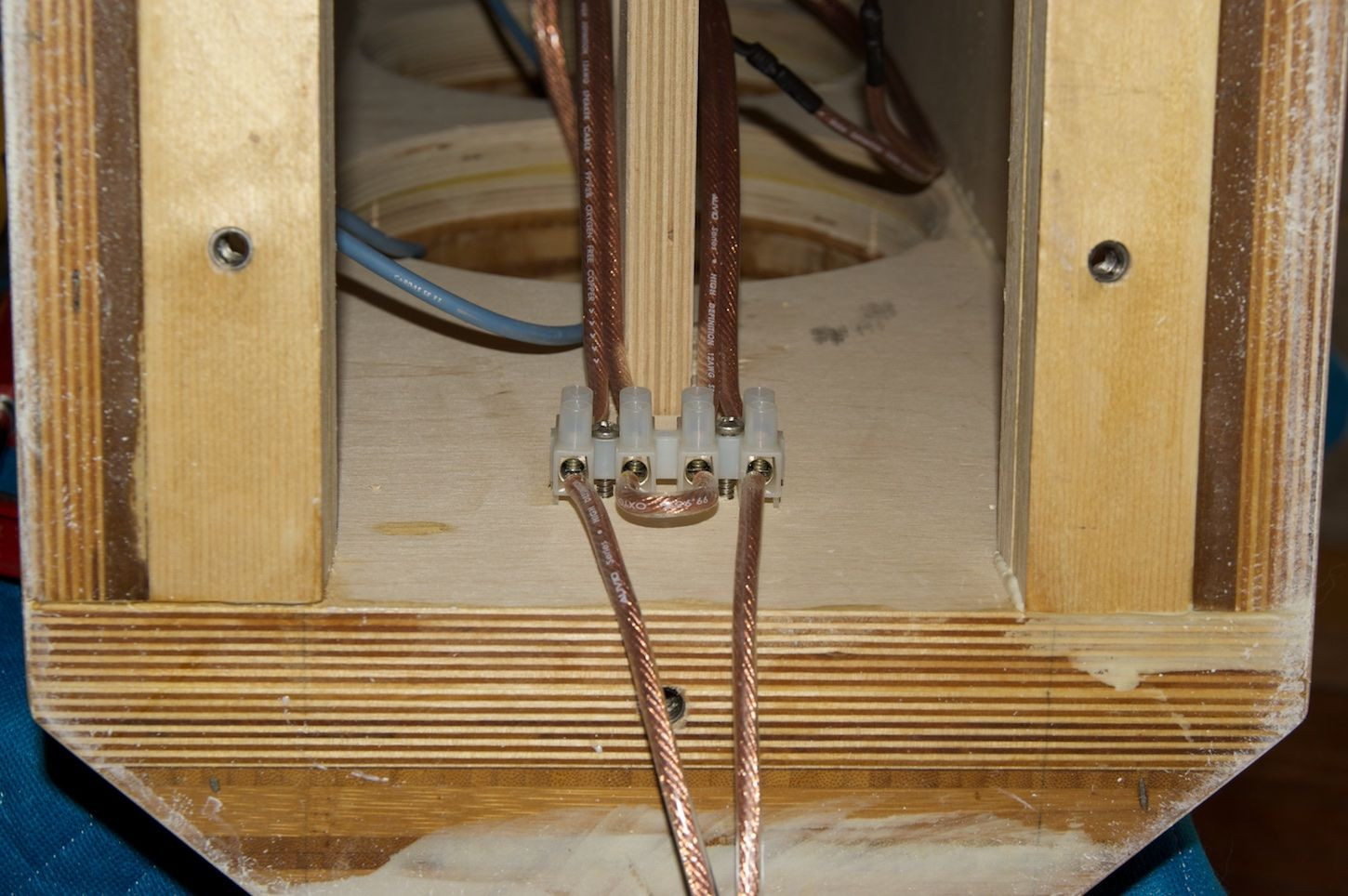

                                              Well, you guys won't approve, but I'm actually mounting drivers, but just with philips head stainless steel screws! On the other hand, I AM being rather OCD about the wire connections, putting AWG 14 pigtails on the Cardas SE11 concentric cable and the AWG 12 for the woofers. Pictures later this weekend, once I have enough progress to be meaningful.

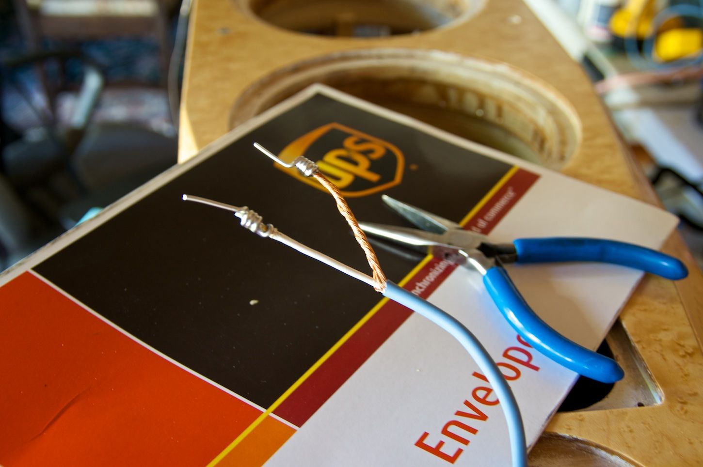

                                              The main hassle about working with the Cardas SE11 is that it is Litz wire, and with my digital controlled Weller cranked up, it still takes 2-3 minutes with the iron and solder to get the insulation to flow off. A solder pot or a classical solder gun can do it faster, if above 600 degrees, but will usually burn or oxidize the solder to a degree. It takes about 2 minutes per lead to tin the wires, then applying a pigtail and soldering is fairly fast.
                                              The update will likely be on Sunday, not tomorrow, because tomorrow it looks like I'm driving up to Roseville CA, north of Sacarmento, to pick up this critter (bottom picture) and ride it back, then take GF out for a nice dinner, since she's going to drive me up there!

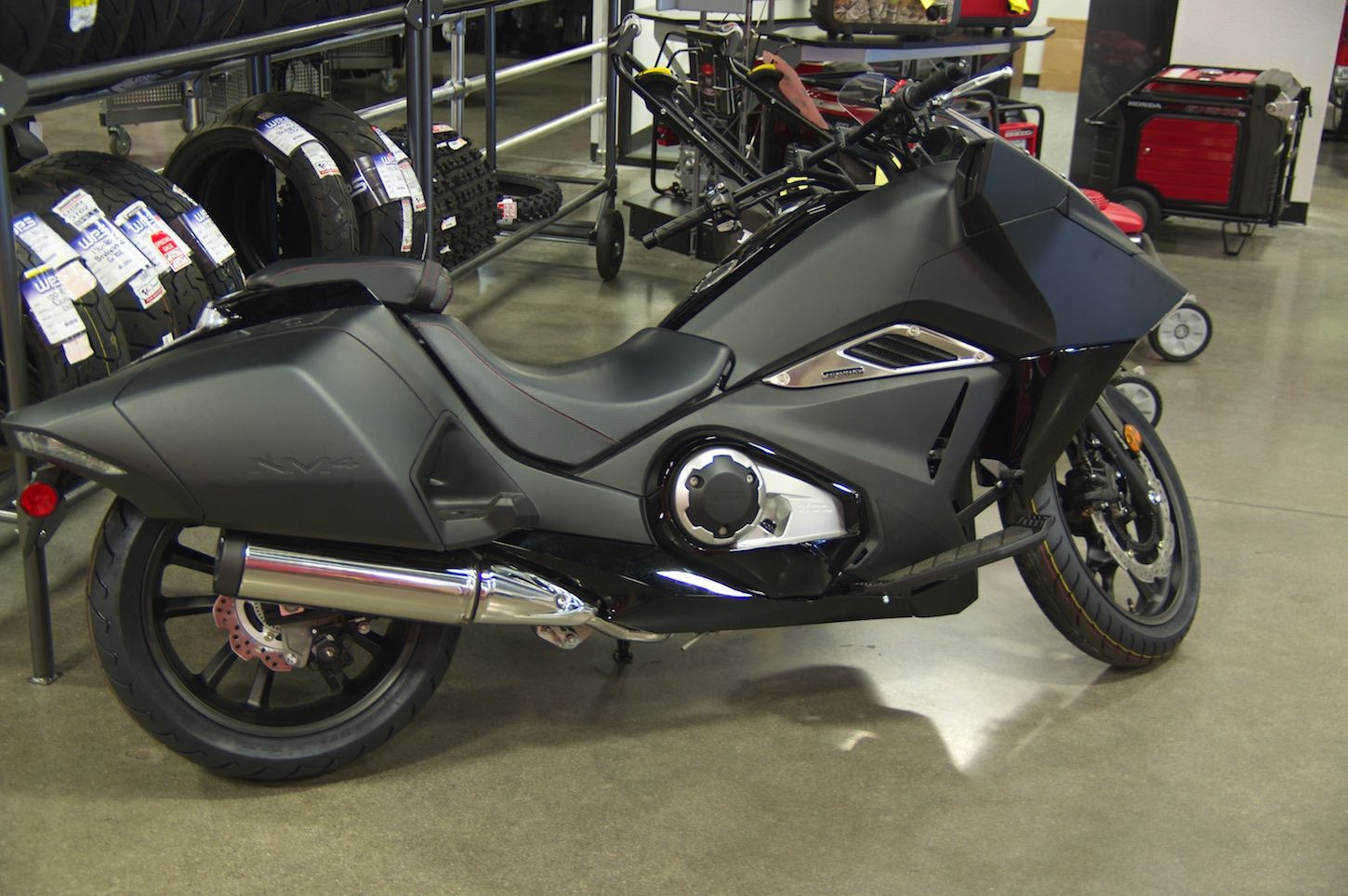

                                              Click image for larger version  Name:	VP3102085_1_large.jpg Views:	1137 Size:	69.8 KB ID:	859167

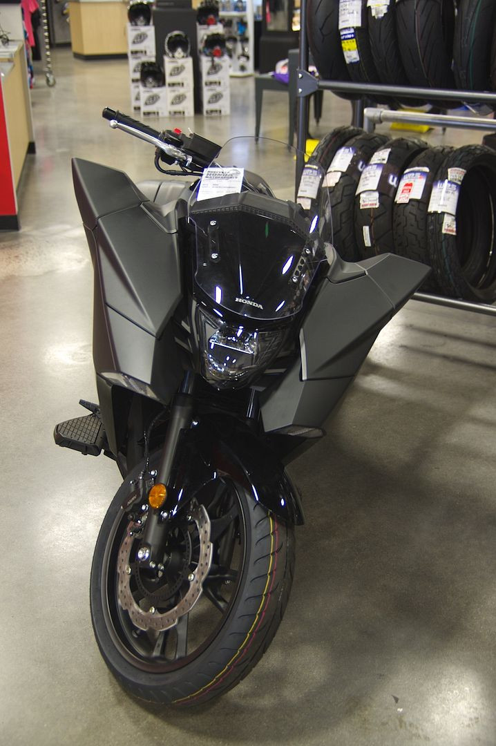

                                                Very cool. My co-worker just picked up on of the comfy BMW bikes. There was some sort of recall so he can't ride it till August so they offered him 2500 in parts. I jokingly told him that will get him a nice set of branded gloves.
                                                I almost pulled the trigger on a new Infiniti Q50 last week but held off since it would sit almost 50% of the year. Also went with a buddy to look at a Ferrari 360 and a Bentley Continental GT, he has a larger tolerance for massively depreciating assets than I do haha.

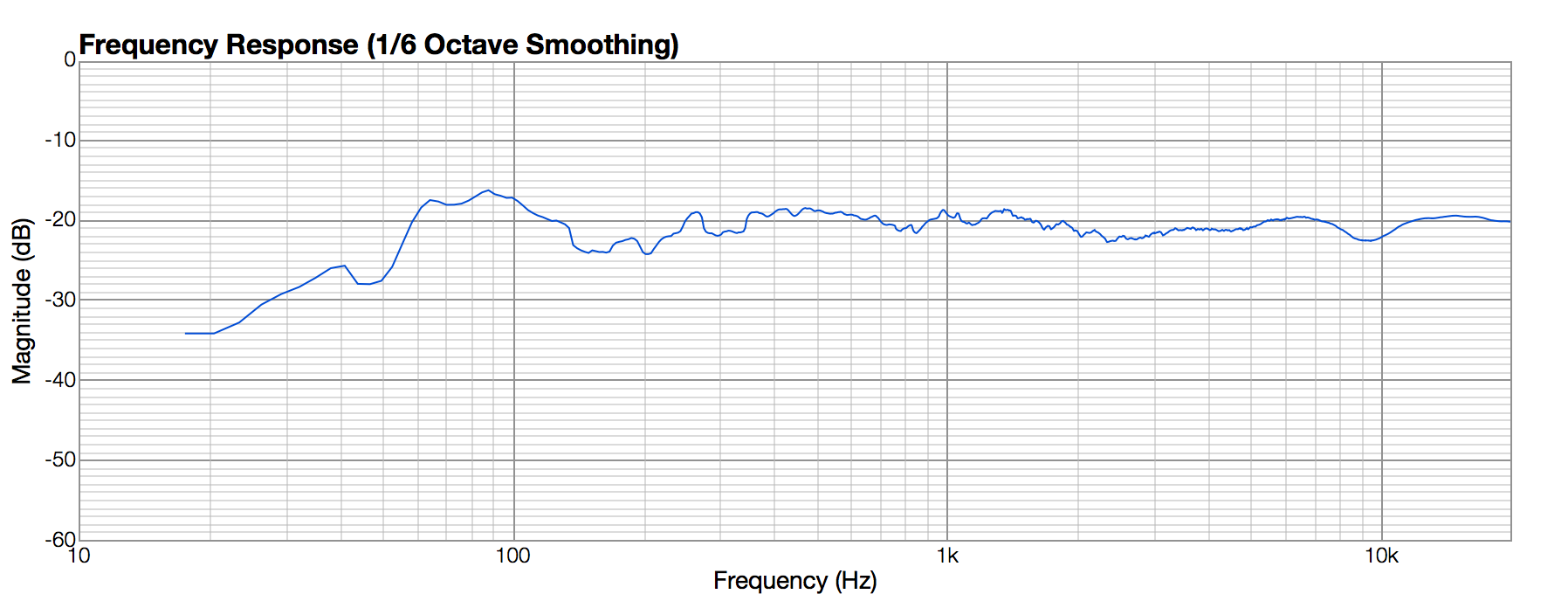

                                                  There's what I believe, and then there's ultimate reality after testing is finished. Now, I believe that from the sequence of simulations I did, including extensive reverse null evaluation behavior to tune the phase characteristics, that things are well in the ball park for inductive and capacitive components. Actually, I believe the resistors tuning levels and damping are OK, too-
                                                  Let's look at that test plot-
                                                  I believe the slight dip in the 100-250 area is due to floor bounce and other boundary reflections- the near field response on the driver looks as it should- I'll evaluate this further upon assembling the first cabinet with several far field measurements in different room positions.

                                                  Well, I've got some stiff muscles in my thighs today- the riding position on the VFR1200 is more sporting than the VFR800 I have! Which was a surprise, but not a long term problem, as I already have goodies on the way to fine tune that and some other things. Most of them are coming from the UK via eBay, though!
                                                  Interesting to hear about your friend, and I also appreciate your thoughts about the Q50. And they tie together. Because though I've had the hots for one of these VFR1200's since they came out, the BMW K1600GT sport tourer really distracted me.

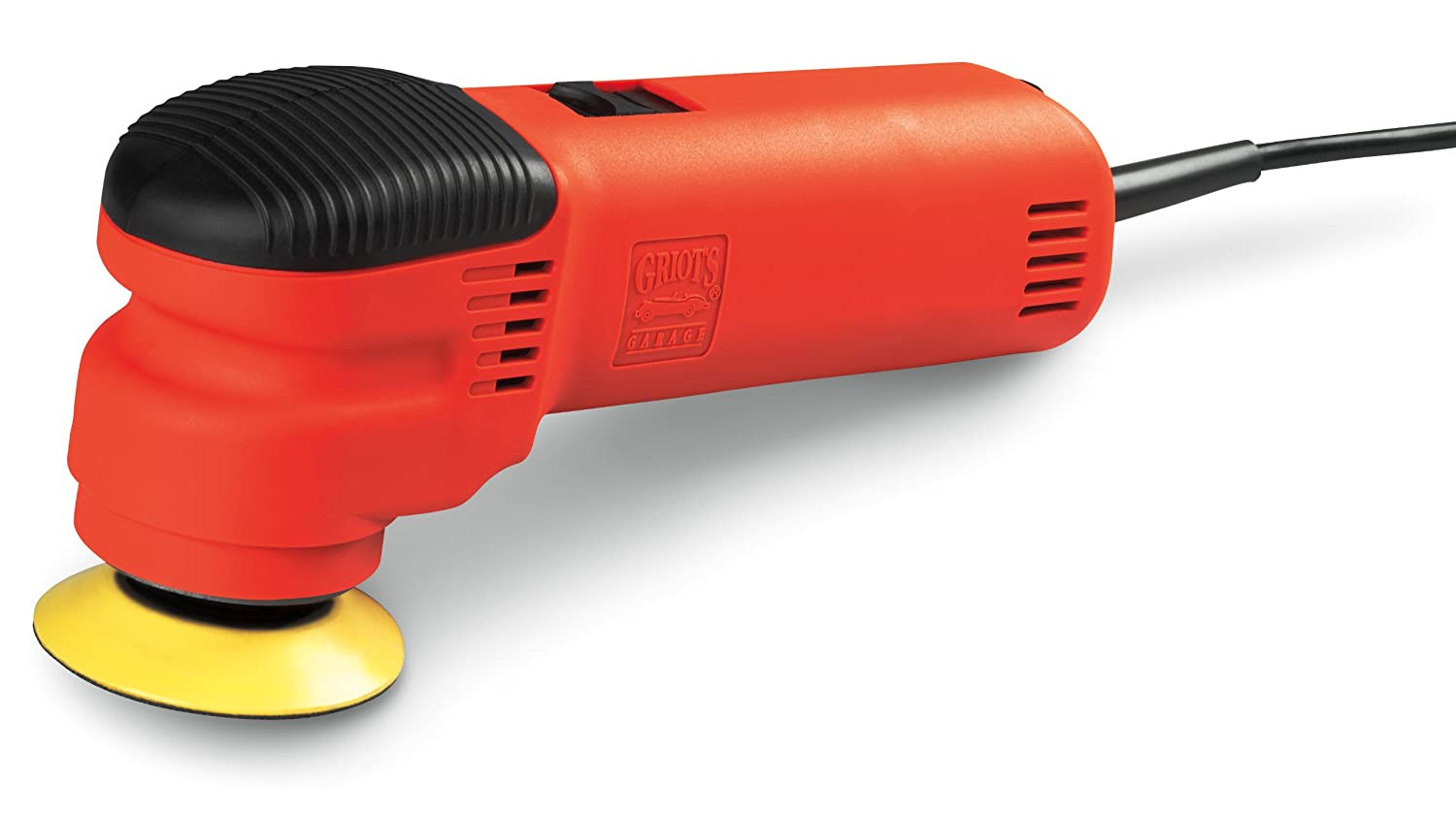

                                                                                Better living through 3M
                                                                                3M 39008 Headlight Lens Restoration System
                                                                                I've been polishing the GF's headlights.... :B
                                                                                This is a job that takes a smidgen of skilled labor, with an electric drill, but if you've ever wet sanded and polished out a lacquer finish, it's a familiar process... the ideal tool would be a 3" random orbital sander- and though I thought no such thing existed, 3" random orbital polishers for automotive detailing with hook and loop pads DO exist, which would be perfect - the drill is a bit trickier. Will order that today.
                                                                                They do have video's online that highlight the technique, but the instructions that come with it are pretty good, too. Not sure I'd turn my daughter or GF's son loose on this, but we're going to try it with him; another set are on order for his Accord coupe, which needs it even more baldly than GF's Passat.
                                                                                With the 3" random orbital polisher, no excuses- I ordered it today (I already have a double kit of the 3M 39008 on order for his Accord...)
                                                                                BTW, it DOES work as well as the pictures on the kit and their web site show- done properly, it looks like a brand new lens.

                                                                                  Finally figured out what this was... a new Honda model I saw at the dealer ship in Roseville, but didn't have time or inclination to ask about.
                                                                                  Looks like something either from Bladerunner or the Bat Cycle- uses the same FIT engine derived 700cc parallel twin as the NC700X and several other new bikes. It is very strange in the flesh... if you want to tell the world you ride to the beat of a different drummer, and get great gas mileage at the same time, while having a fair amount of storage, this might be your bike...
                                                                                  It appeals to me a bit just because it is so weird... :W

                                                                                            Let's get back on topic. the next section probably isn't very needed for the hard core DIY guys, but is provided to show how I terminate the wiring leads and have been putting things together in my own OCD kind of way.
                                                                                            Cardas SE11 stripped for the tweeter connections, and AWG bus wire used to create "pigtails".
                                                                                            The SE-11 is a concentric litz wire speaker cable, one conductor inside the other, reasonably low inductance but no where near as expensive to manufacture as stuff like Neutral Reference or Golden Reference. About AWG 11 according to Cardas.
                                                                                            It's a particular help to do the pigtails with the tweeter...

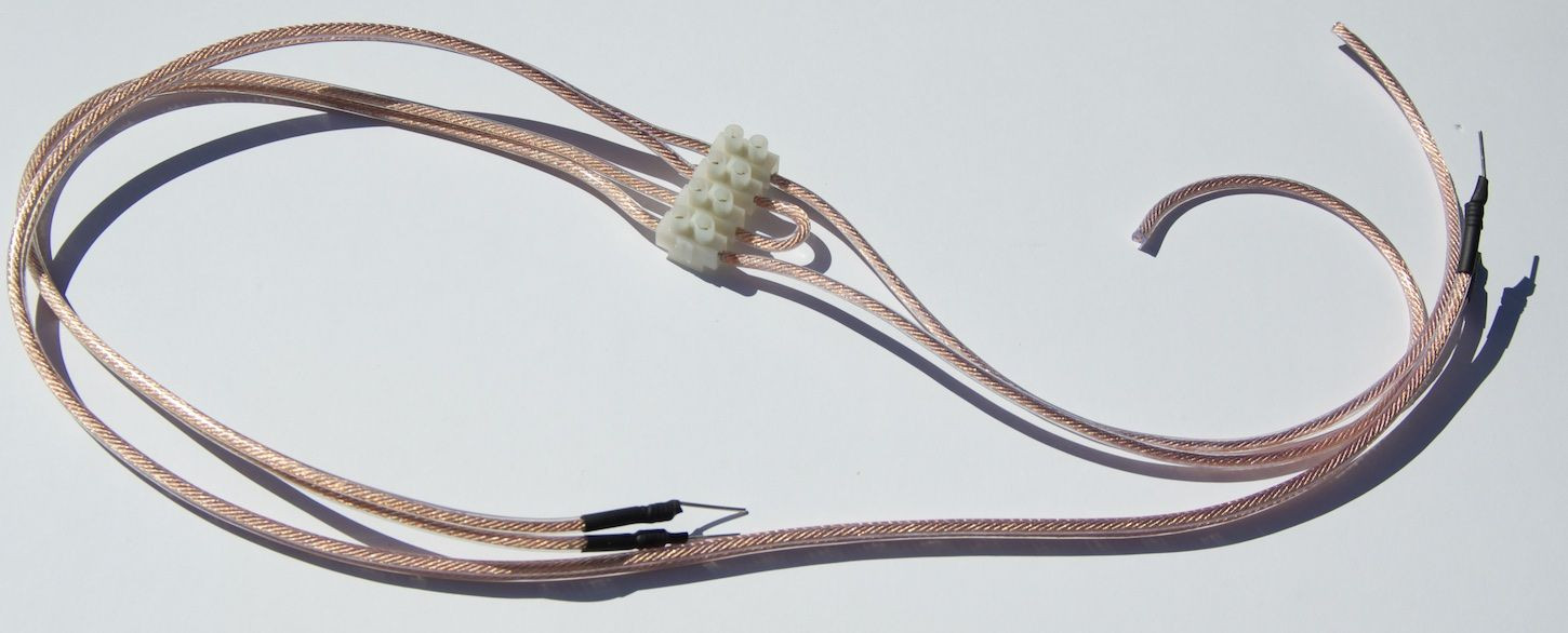

                                                                                            Here's some of the woofer wiring cables terminated the same way.
                                                                                            Here's what the complete woofer cable looks like after assembly, including the terminal block for the series connection:

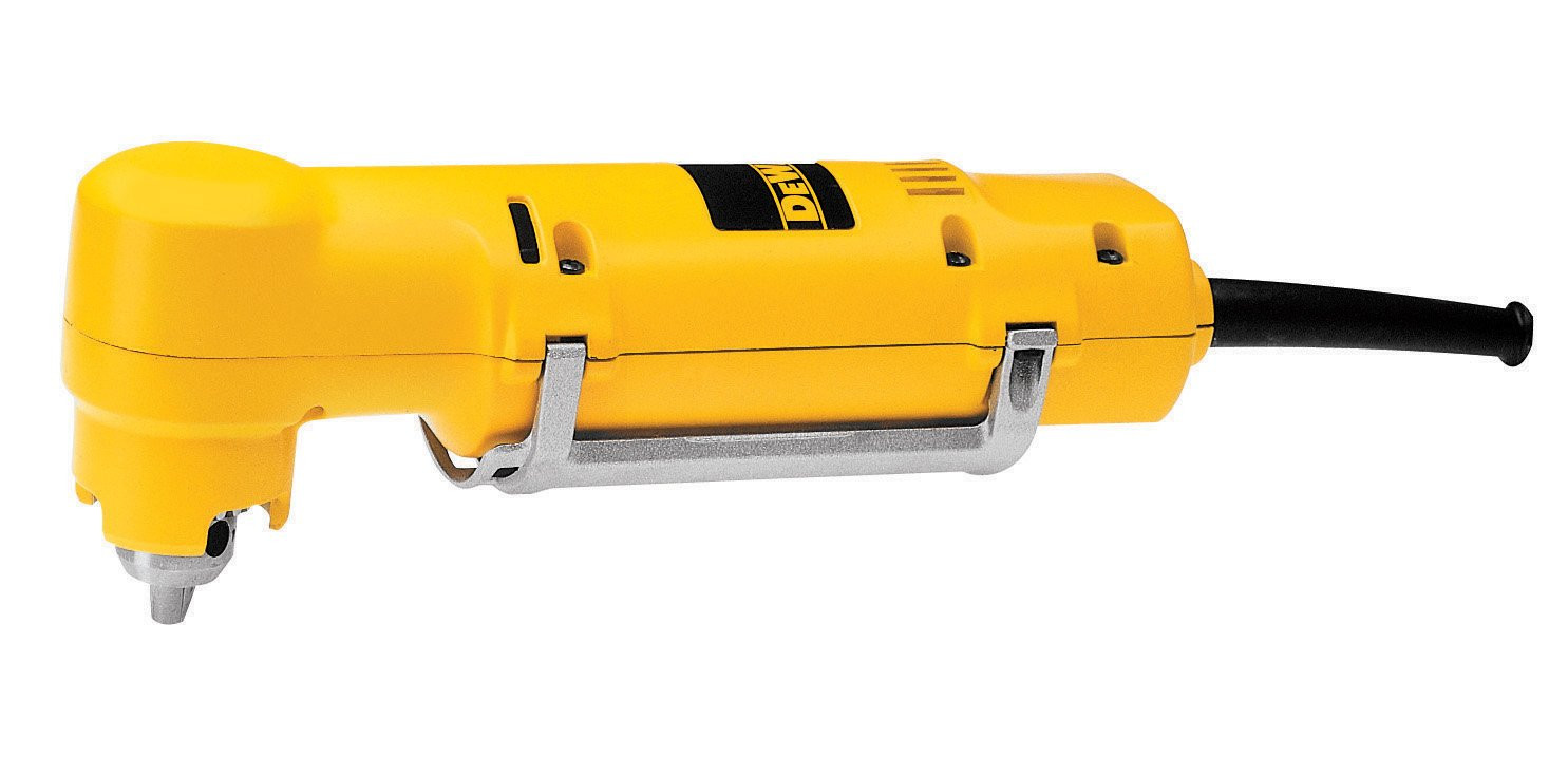

                                                                                            Here the woofer cable is installed in the cabinet; this is where the right angle Dewalt drill comes in real handy.

                                                                                            Here I've pigtail soldered the midrange driver, prior to installation using the stainless Reports screws:

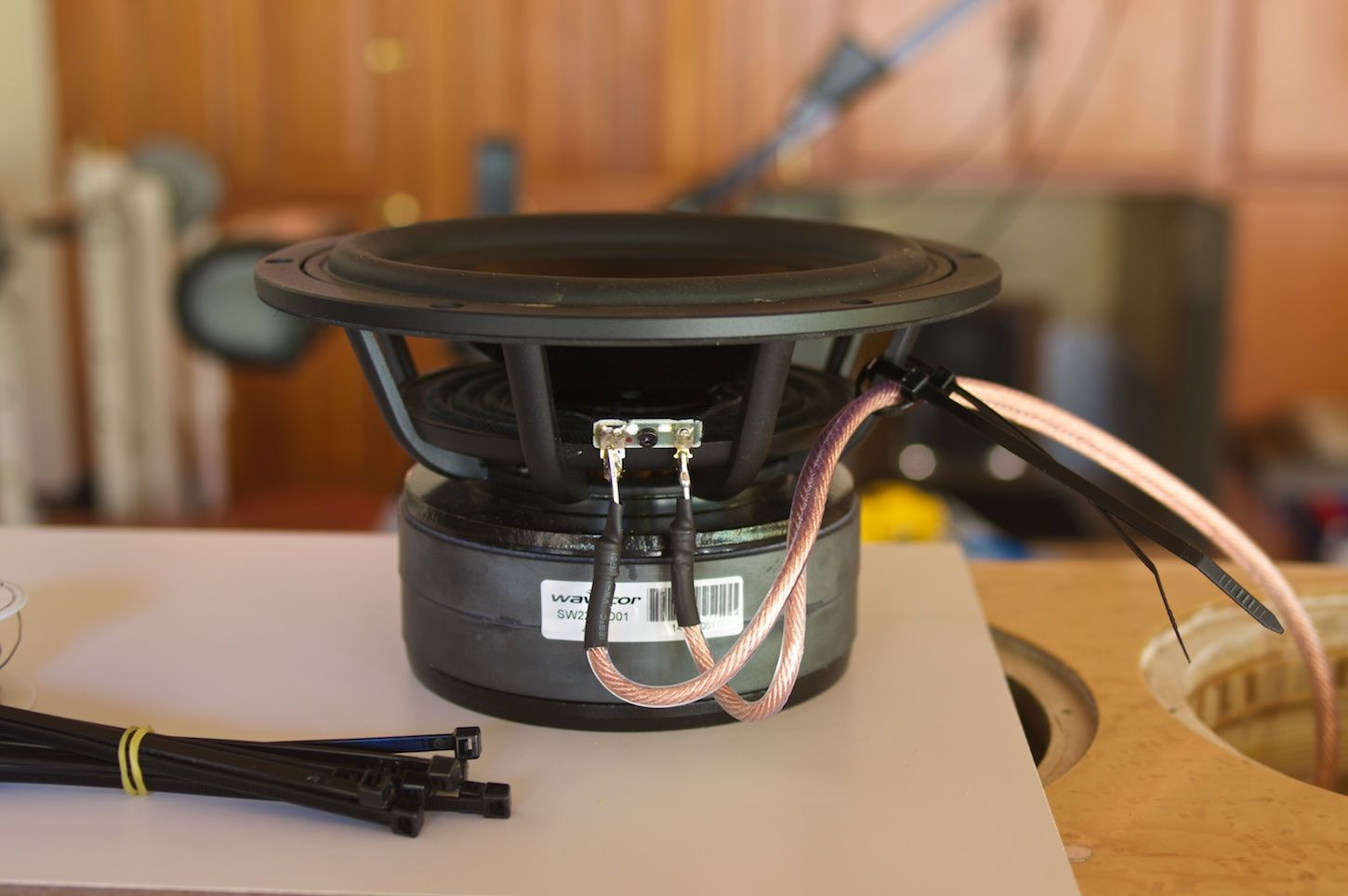

                                                                                            Now I'm ready for the woofer installation.
                                                                                            With the woofers I go a step further and stress relief tie wrap the cables to the woofer frame.
                                                                                            It's also a good idea to use some kind of plate and board to set the woofer on, because even fairly hardened lacquer isn't really all that hard, or difficult to mar.

                                                                                            The finished cabinet is QUITE heavy, considering the size! I'm sure those Wavecor woofers have a big role in that. Last step is going to be wiring up and mounting the crossover base plate- stay tuned, later this weekend.
