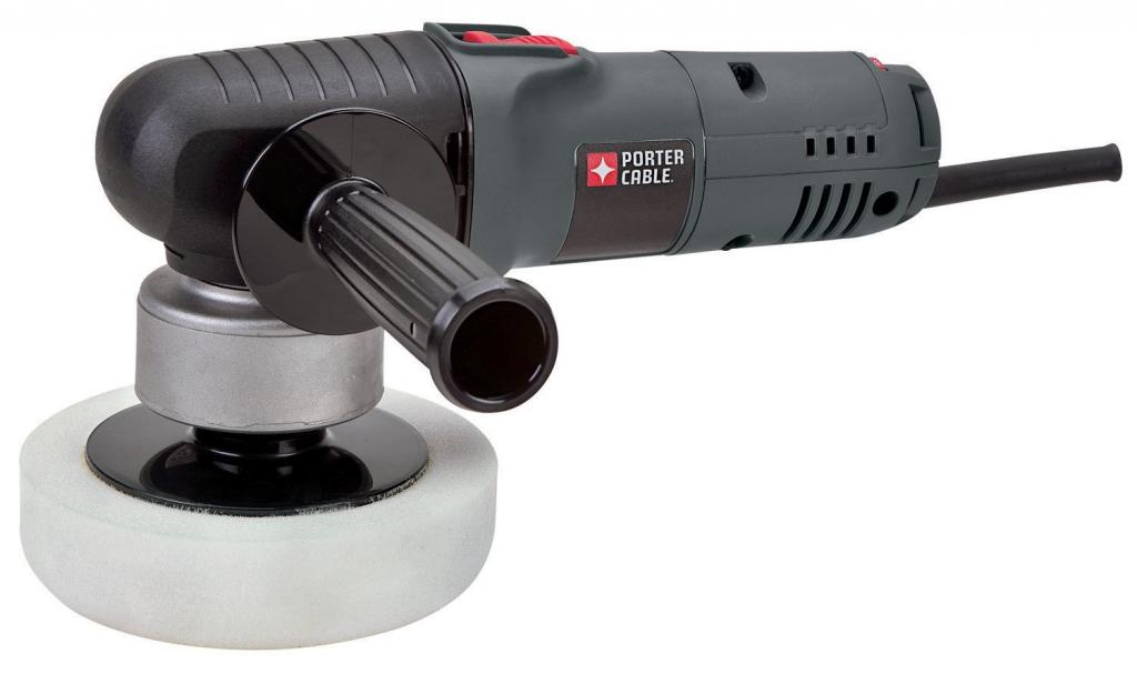

    The Poerter Cable orbital sander has been worth it's weight in gold!
    Second that. I've been trying a few different piano black finishes on speakers and after frustratingly mediocre results from using a sanding block, I broke down and bought the PC sander - best decision I've made since adding a router to my tools. A day's worth of hand sanding can be done in an hour or so.

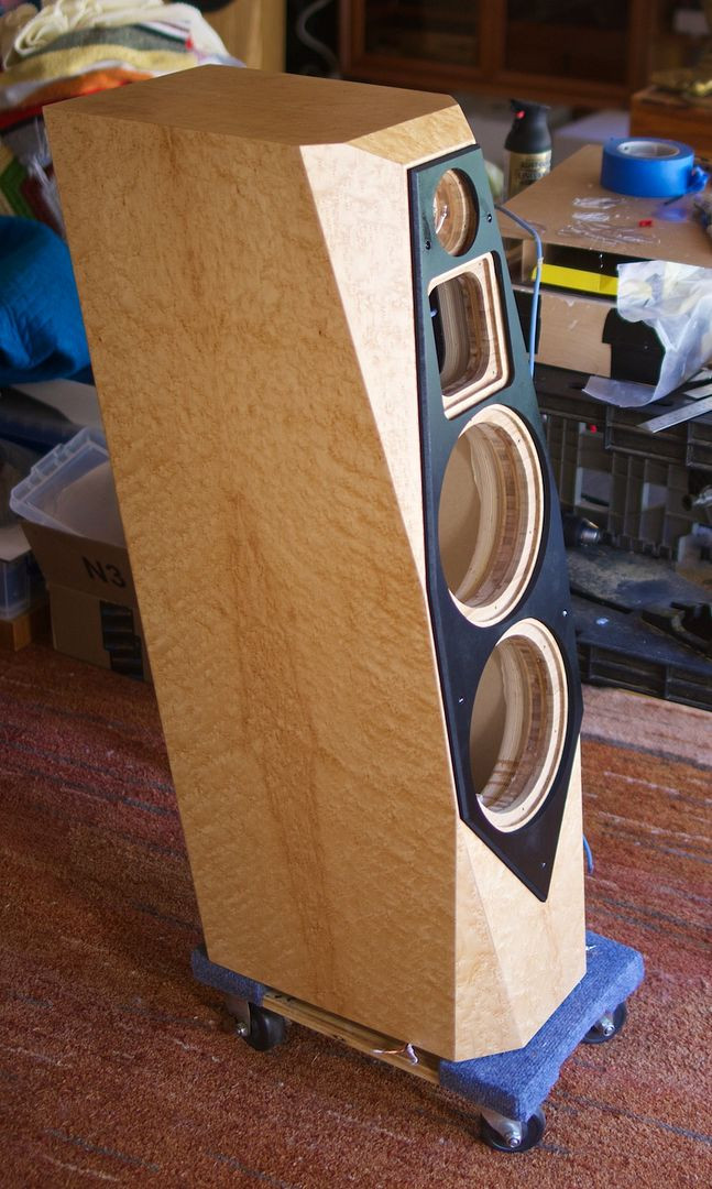

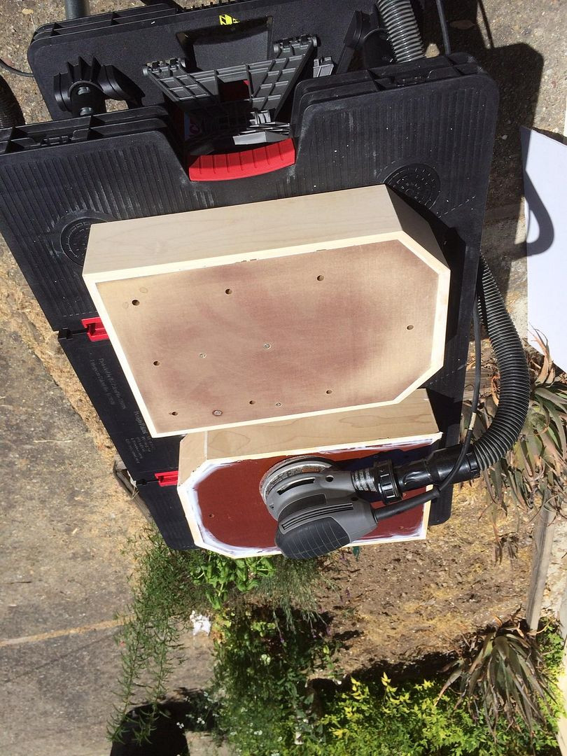

      Didn't quite get as far along as I'd hoped- didn't get to the rubout, had some other errands to do this afternoon- but the grilles were painted and dried, and the attachment with these relatively small magnets (compared to what I bought for the Isiris) works just fine! :T
      The finish is like a slightly matte VOS finish from Gibson at this point- quite happy for the most part how it's turned out, but I expect a bit more pop after I finish the rub out (have 3M rubbing compound and special pads for the PC sander). Tomorrow I hope, though I have laundry and automotive chores, too!

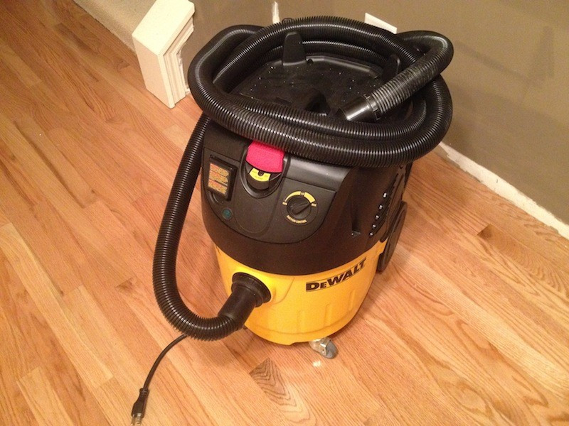

                    I always use the PC orbital sander or any block sander with the DeWalt 10 gallon dust extractor vac I have- that's the D27905H- it's actually made in Italy, has Hepa filtering in the deluxe version, and is worth every penny for how it makes the job faster and safer.

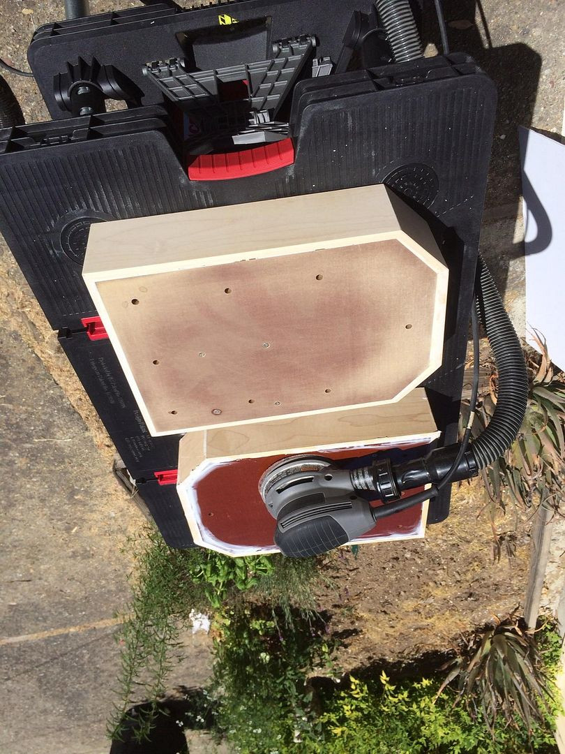

                    With my current day job setup, time is what I have so very little of- none during the week, with a 5AM to 8:30PM typical door to door since I've been working at a customer site 5-6 days a week full time since September. Was supposed to be off this by the end of April, and now it's looking to run until October or November- to say I'm not happy is a gross understatement!
                    The orbital sander and some 100 grit Mirka pads made short work (less than 15 minutes) of the clean up sanding from my rough and tumble fit and glue job on the bases... this kind of productivity is a lifesaver/enabler for me, as by hand this might take an hour or more.
                    I can't say enough good things about this combo- the DeWalt D27905H, the PC 390 sander, and Mirka disks and pads.

                      Do you wet sand with the PC? I first used my DeWalt sander, but panicked a little when I saw the paint build up inside of it. So I ordered up a variable PC sander polisher and Pneumatic velcro backing pad and the Mirka discs and pads. After I saw your recommendation, I picked up a few sets and can't believe the quality. I definitely recommend them too.
                        • 16120
                        #686
                        I've been doing wet sanding with the PC random orbital sander too- but have been thinking about something like the PC you linked to- thanks- I added them to my Amazon Wish List! When I do wet sanding, it's not very wet, just spray the surface lightly, and go over it gently - this has worked real well. I don't consider myself a skilled woodworker, so frankly, any advantage I can get by spending on better tools, I do it- for me it pays off quickly in time and results.

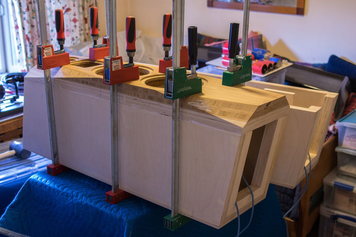

                        Some more parts for the bases cut, and one side glued with the Ace Hardware Marine Epoxy. I've actually gotten more done today than I expected, but still have some more automotive chores. Still, it's been a productive weekend... not what I'd call a holiday, though! :W
                          • 1913
                          #687
                          Glad to see you making good progress with you Ardent. Beautiful work and best I can tell you're an excellent wood worker! Don't sell yourself short!
                          I may have missed something but how are you attaching the bases to the cabinets? With the crossovers inside I'm guessing you're making them removable?

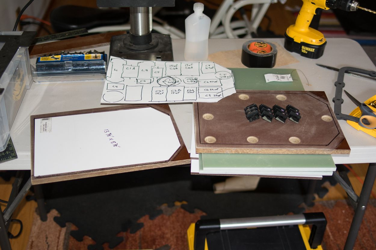

                            Hi John,
                            The cabinets have a large attachment area for the base.
                            Note the holes in the phenolic plate used for the crossover plate in the base assembly- these will have flat head socket head furniture bolts to mount the base to inserts installed in the base of the cabinet. A custom laser cut foam gasket is used to assure a good air seal.

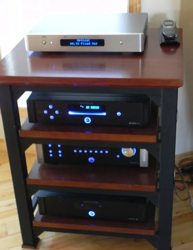

                                Old setup showing the front wall, these speaks are gone and the sub soon to be gone.
                                This is the new front wall setup with a new component stand and the planned IB location. I'm going to move most of the gear to the back room to clean the front stage a little leaving just the essentials.
                                IB manifold will have 2 Stereo Integrity 18's. I don't have the room to place the port between the towers so it will have to stay to the right. The old sub has the best response in that corner and EQ'ed fairly well so here hoping the port is well placed.

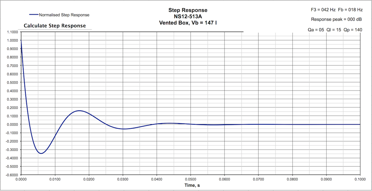

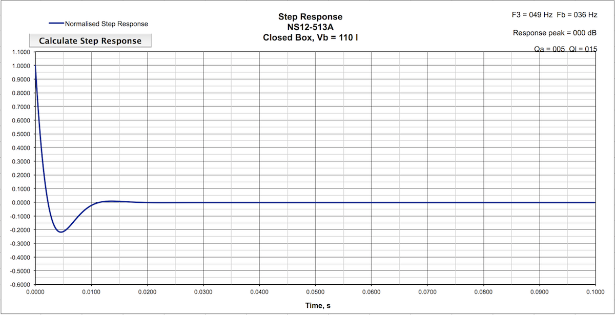

                                    To highlight the difference sealed/IB versus ported, note these step response calculations for two versions of the Isiris, MJB's ported version, and my sealed version. His are larger, and will play louder in the low bass, but have some compromise in transient definition as a result.
                                    Ported:
                                    Sealed:
                                    'Nuff said.

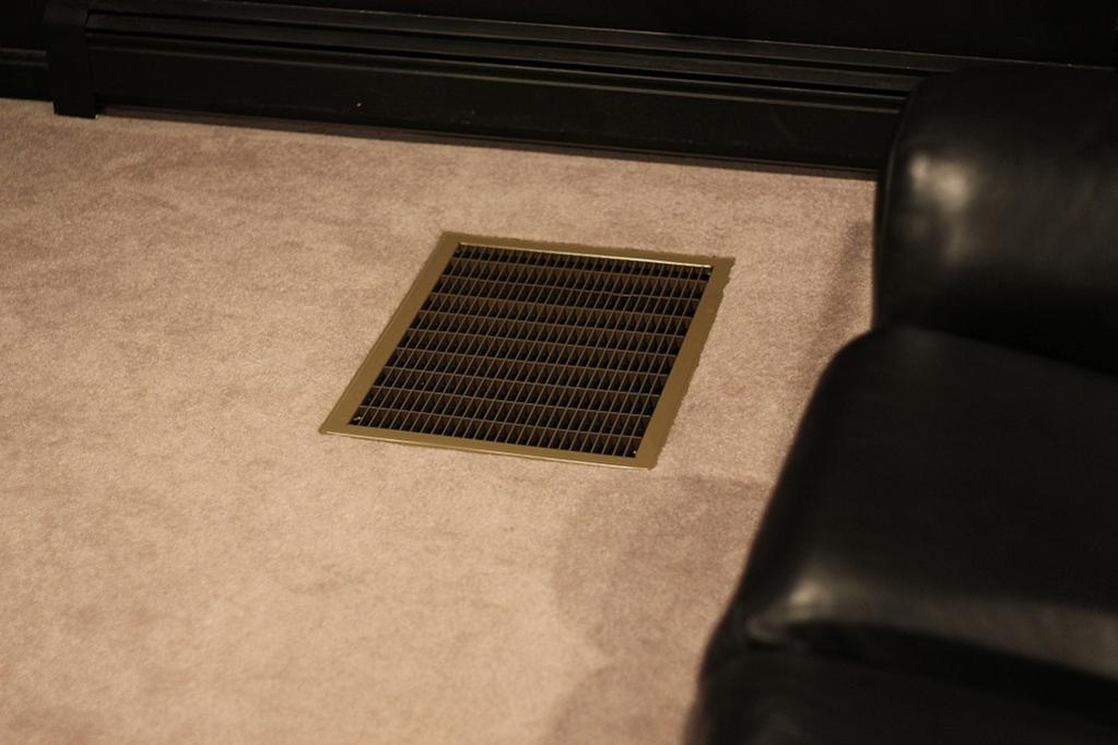

                                      I think he means the infinite baffle sub will be outside the room and the port to the "box" will lead into the room.
                                      Here is an underfloor IB sub with it's in-room port.
ID:	859127Click image for larger version
                                      Dar, what configuration are you planning on using? Are you going to run them on two different sides to reduce vibrations?

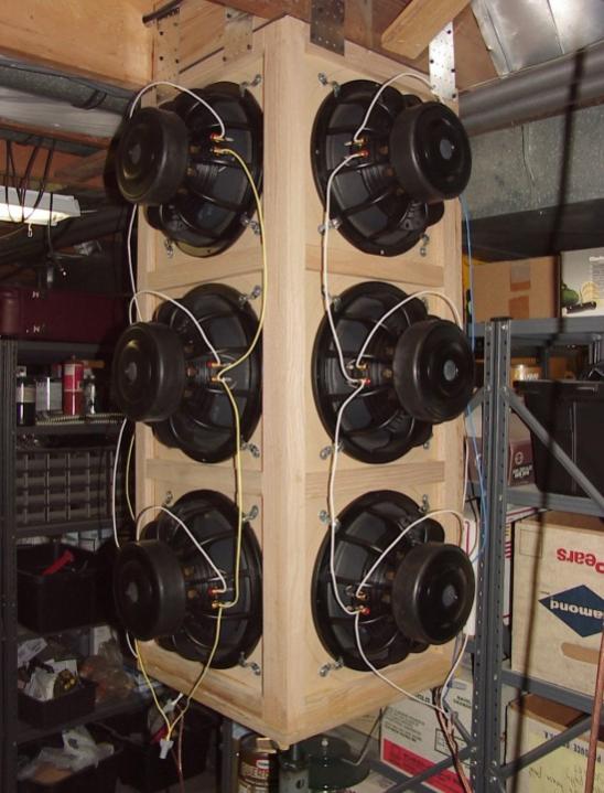

                                          Yes IB, thanks for filling in Kevinm.:T Dam it! Work is now blocking my posts, may have to resort to the phone.
                                          Sorry Jon, by the Port I meant manifold front opening.
                                          These 18's are going to be horizontally or side mounted in the manifold with the cones facing each other and the magnets in a storage room behind the front wall. The storage room should give me just over 10x VAS. Thought of 4-18's in 2 manifolds but not enough front wall and I would be busting the 4x VAS rule. I registered over at the Cult and I'll have to start a build thread and take advantage of your old buddy Thomas and the gangs thorough knowledge when I get going.
                                          The down firing sub in the pic is sold and is going to pay for a new Behringer NU3000DSP to drive the 18's. I'm hoping the DSP with multiple stored EQ will give me separate EQ's for Movies, TV and 2 channel. I feel like I'm starting from scratch, lots to learn and it should be almost as exciting getting this going as finishing the Ardent.:B

                                                                                    Well Jon, I firm up my sources for the Ardents. I originally thought I would add a Oppo 105 to handle movies and music but with the new version creeping up to $1400. I thought the 103 can be had for $500 and would be fine for movies so why not get a stand alone DAC. So after considering the Emo Stealth DC-1, Schiit Gungnir and borrowing a few older ones from friends, I did some auditioning around town. I listened too some nice Naim, Bryston, Exposure, Moon and some very rich for my blood Chords and the very nice PS Audio MK2. And you you were right again NAD M51 with the deal I got only adds $600 to the dac and Oppo 103 combo.
                                                                                    The M51 is smooth, detailed with a good base grip, very little between it and the PS Audio MK2 at twice the price. This was a good compare same place.
                                                                                    I'm all smiles, thanks for the hint and you know with all this talk of your Modulas MK2's, they just resolve better with better sources. I don't think you need a design change on them I think your partner would love them for your movie set up. :W I got a 1 day software conference in Calgary so I get to check Ben's new digs out but I don't think I should haul the NAD there as i think we have already corrupted him enough. :B
