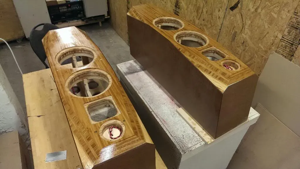

        Epoxy is awesome. Tried both the usual 205 and 207 (special coatings) hardener since there was some kicking around at the shop. It made the epoxy a bit less viscous and seemed to penetrate better. Not as good for filling the little voids in the bamboo however. I'll probably use it again tomorrow after the sand for the final coat.

              Rolled it on then tipped it off with a plastic scraper. West systems recommends using a roller to tip off but we were running low. It's pretty messy to work with and getting it flat is a bit of work, especially because if you don't it sucks to sand later.

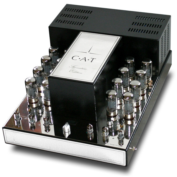

                              and he has special versions of the TotalDAC D1 configured as "mono block" DACs, with the reclocker units and is pondering a TotalDAC server to replace his current unit. Let's say he's kind of serious about this stuff; we discovered TotalDAC about two years ago when he decided he needed an upgrade from his dual Antelope Zodiacs driven from a DCD8, and we started looking for higher performing solutions- evaluated quite a few at his place. His wife has rather good ears, too, and is supportive... within reason... a very liberal definition of reason, by most accounts!

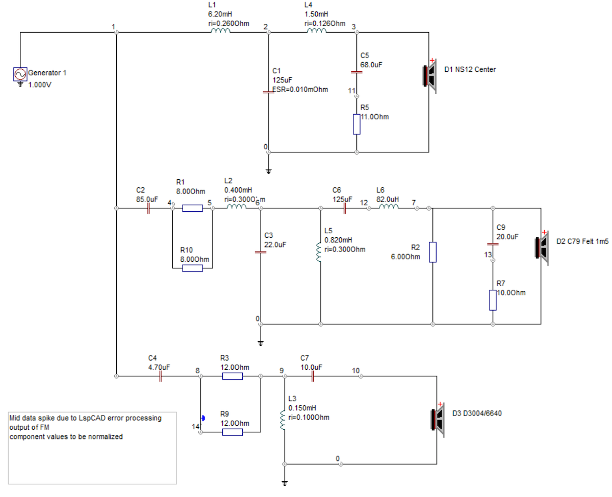

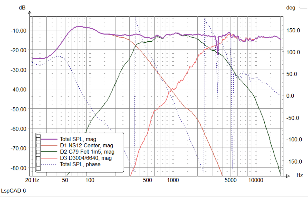

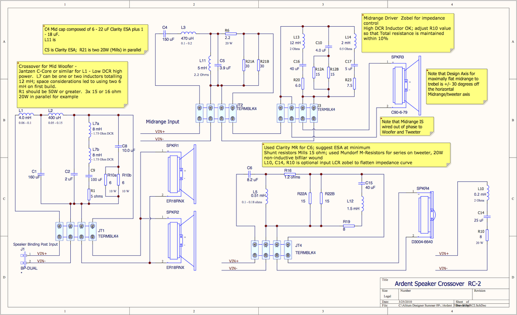

                                Very Preliminary Crossover concept proposal
                                Here's the work I did yesterday in some stolen moments... (geez, sounds like something out of a romance novel... but then, how would I know what a romance novel sounds like?)
                                this is a preliminary adaptation of the Isiris crossover topology to the Wavecor Ardent- note, I DO mean preliminary- everything could change. To some degree. Note also the downward spike in the midrange response is not the measured data, but an artifact I see now and then importing data into LspCAD if there are too many data points and too many decimal places for Lspcad to digest comfortably- often I massage/clean up the data from Fuzzmeaure first in Excel- didn't have time to do this yesterday.
                                The trial network design:
                                The simulated response of the trial design:
                                The purpose of running this test yesterday was merely a feasibility study, something to assess my belief that this was readily adaptable with small modifications, and that we could get something in the ball park. Of that I'm quite certain now.
                                For reference, here is the last version of the Gen 1 Ardent with Seas Woofers using the Duelund transfer function crossovers:
                                The midrange crossover was built on two boards connected together, due to size, as is the Isiris. With a sealed stuffed cabinet, I don't believe we'll get the column resonance which required the zobel damper network of L7, C9, R1. It wasn't needed in the Isiris. The revised configuration of the midrange crossover used for the Isiris pretty much eliminates the need for an LF Fs zobel for the midrange driver - no L13, C16, R20. The steeper 3rd order roll off of the NatP function crossover eliminates the need for a notch equalization LCR (no L14, C17 and R23). The steeper tweeter network also eliminates the need for a tweeter FS zobel (C15, L12, R19).
                                The flexibility and transfer function of the Duelund style crossover is very attractive, but only with very flat drivers. It was a great success in the NeoD CC center/main speaker, with the very flat Dayton RS52 dome mid, but much more difficult to implement well with cone drivers in a large three way like this. By going back to my roots with the NatlieP concept crossover, I think we've moved forward quite a bit- easier to implement, retains all drivers wired in phase, lower parts count compared with LR4 and nicer fill in the crossover region.
                                As Stever Ballmer would say, "I like our strategy... I like it a lot!" (I hope I'm not as wrong as he was! But the listening results with the Isiris indicate it's on the right track).
                                So, Back to the Future, Marty- we've got some speakers to finish building!
                                One more note- for the purpose of voicing this build accurately, measurements for crossover design and voicing will be done with the grilles installed.

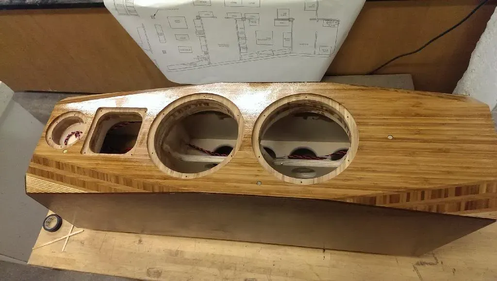

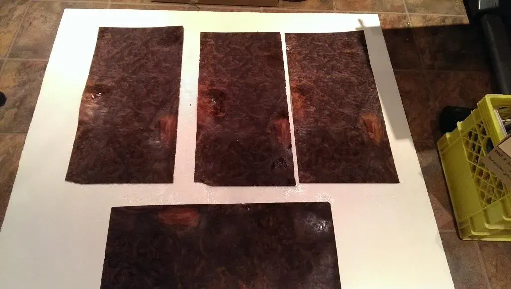

                                                  I got all the inserts for the bases in and epoxy is curing magnets in the grills and baffles. Magnets have a nice press fit in the grills, you just add epoxy in the back and drop the little pugs in flush with the fronts of the grills. :T I tried to inset the magnets just less then a 1/16" in the baffles, hopefully they grab as nice as Ben's. The little red dots on one side of magnets sure help keep the polarity straight for you.
                                                  I'll need 2 sheets of veneer as well, I found out last time that rustic plank cherry has a little more waste getting the most interesting look on the larger pieces. I was looking at others but keep coming back to the cherry so I guess I better just get it ordered.
                                                  I took a stab at costing the prelim crossover and looks to be under $1,500 per pair with premium parts for the mid and tweet section. :T

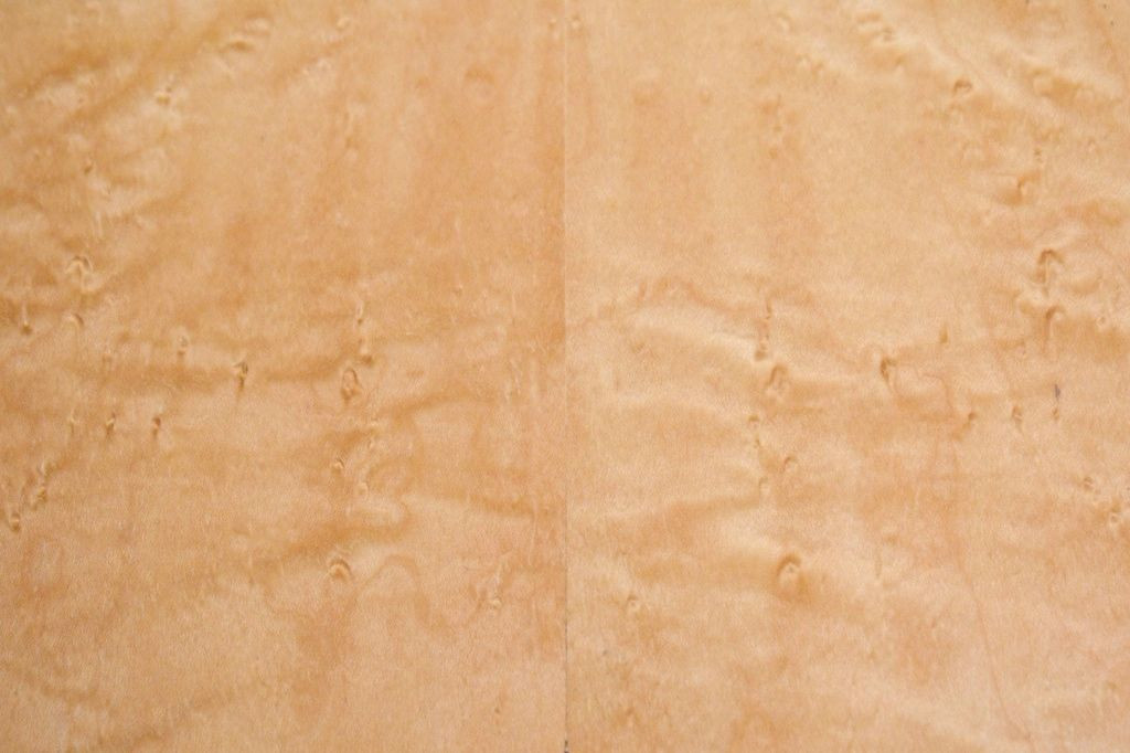

                                                          This has worked well for me in the past, with the caveat that figured woods like birdseye or burl need to be flattened first with a veneer softener and press, and tried out thoroughly before being attached this way. Also, the newer water proof PVA such as Titebond 3 does NOT work well with this technique- original Titebond or Titebond 2 work better.

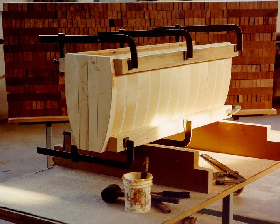

                                                            Another possible off the beaten road source would be bench tops, for work benches; I have a massively strong work bench made of beech.

                                                            Of course, there's not reason in principal that you can't make your own thick baffles from hardwood this way, laminating them on the short side, not the edge - from any wood you want. Takes time, and a bit of coin, I think... :W

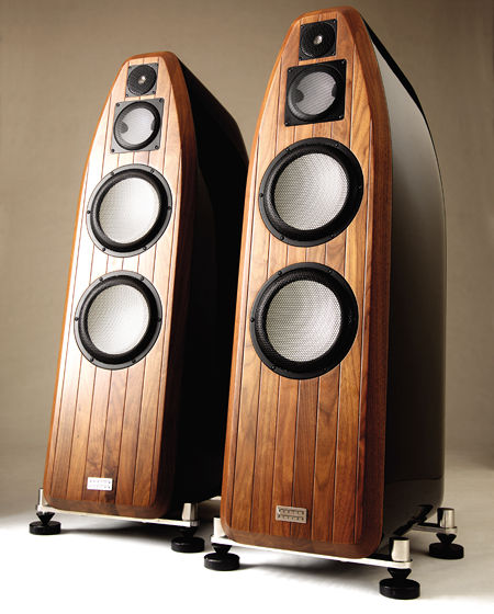

                                                                  Some speakers that seems to use wood in the construction (but I might be fooled)

                                                                      I have preliminary BOM prepared for the Wavecor Ardent crossovers, with options- mainly, if you want to go crazy on the tweeter caps, Clarity MR's for twice the price of the Jantzen Superior Z. Not sure that's a sensible upgrade... have Solen AWG 14 inductors in several locations where there is no performance impact to reduce cost.

                                                                                This morning I couldn't resist taking a peek before heading out to Starbucks and my errands for the day. It was shipped direct from the manufacturer, turns out it was from Sauers Veneers, the same brand I usually buy solid veneer locally at Woodcraft, (and the source of the birdseye maple for the facet pieces). The quality looks great and matches closely the figuring and color of the solid veneer I bought, so things are definitely looking good- I did some test veneering with Sauers solid birdseye back in 2009, and ran a test of my "proposed" lacquer finish process, and that turned out very pleasingly.
                                                                                I found a shot I took back then:

                                                                                I realize it's pretty hopeless to try to explain this with a picture- once it's lacquered, figured maple will change it's hue depending on the angle of light, and your viewing angle- and light areas go darker, while dark areas go lighter, like of those quasi 3D layered pictures- so while unstained unfinished figured maple may at first blush seem boring, it's anything but with a closer look when it's finished.
                                                                                Picture just doesn't do it justice...
                                                                                Also, it's a subtler look than I've done in the past, but something I think I'll be able to live with, without getting tired of it.

                                                                                      Progress has slowed a bit on my end. Need to flatten the raw veneer that will be used on the back before it can be bookmatched. Got the PSA veneer trimmed to size, one thing i noticed is the angles on the facet above the tweeters are slightly different than my model (well blame that on tolerance stacking) so if anyone uses that .dxf just cut a little wider than the .5" boarder I left.
