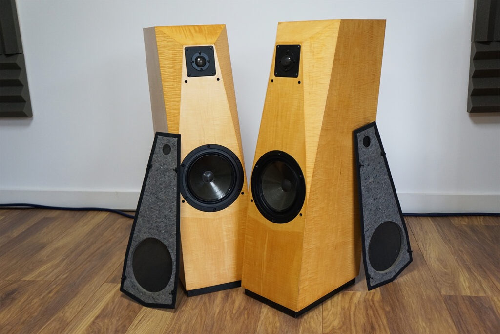

    So, what are the historical antecedents? (This is sort of like answering a question such as, "who in your family do you resemble?" Which can be very complicated, or obtuse, if who you resemble was never living when you were born, and a key example goes back to the mid 1800s, in my case). But no time span like this.
    So, I'd list these items as being in the genetic soup of this project:

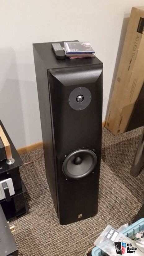

    • M8ta, circa 2006/2007, for a roughly 8" two way in a tower format speaker similar to Avalons- too bad Charlie Hansen passed nearly 10 years ago, he could tell you about the prototype speakers I gave him when my development and business partner died from an aortic aneurysm when I was away at CES in 1980 scoping out the competition. Charlie was working for me in a small professional audio outfit in Boulder Colorado while attending school at CU. More than 45 years ago.
    • NatalieP, also a two way, with smaller drivers, and an unusual crossover with a low turn-over frequency to get the most out of an Usher tweeter made for PE, the RS28a.
    • SMJ Audio Calliope, with the SB Satori MW19P-8, and the Peerless DA25TX-008 Corundum dome tweeter. IN and Out of availability, never goes out of style.
    • Ardent D, for overall enclosure concept, materials, and finishing options (possible to get a nice result with just golden Watco oil and wipe on polyurethane. Some modifications to dimensions and configuration, of course.
    • Modula Magnifique, based on the concept of a Bessel fourth order high pass, given specific requirements for driver Qts, enclosure size, etc. are made. Complete analysis still pending.
    So, I'd say the enclosure details are pretty close to being fully nailed down, with one special option set-

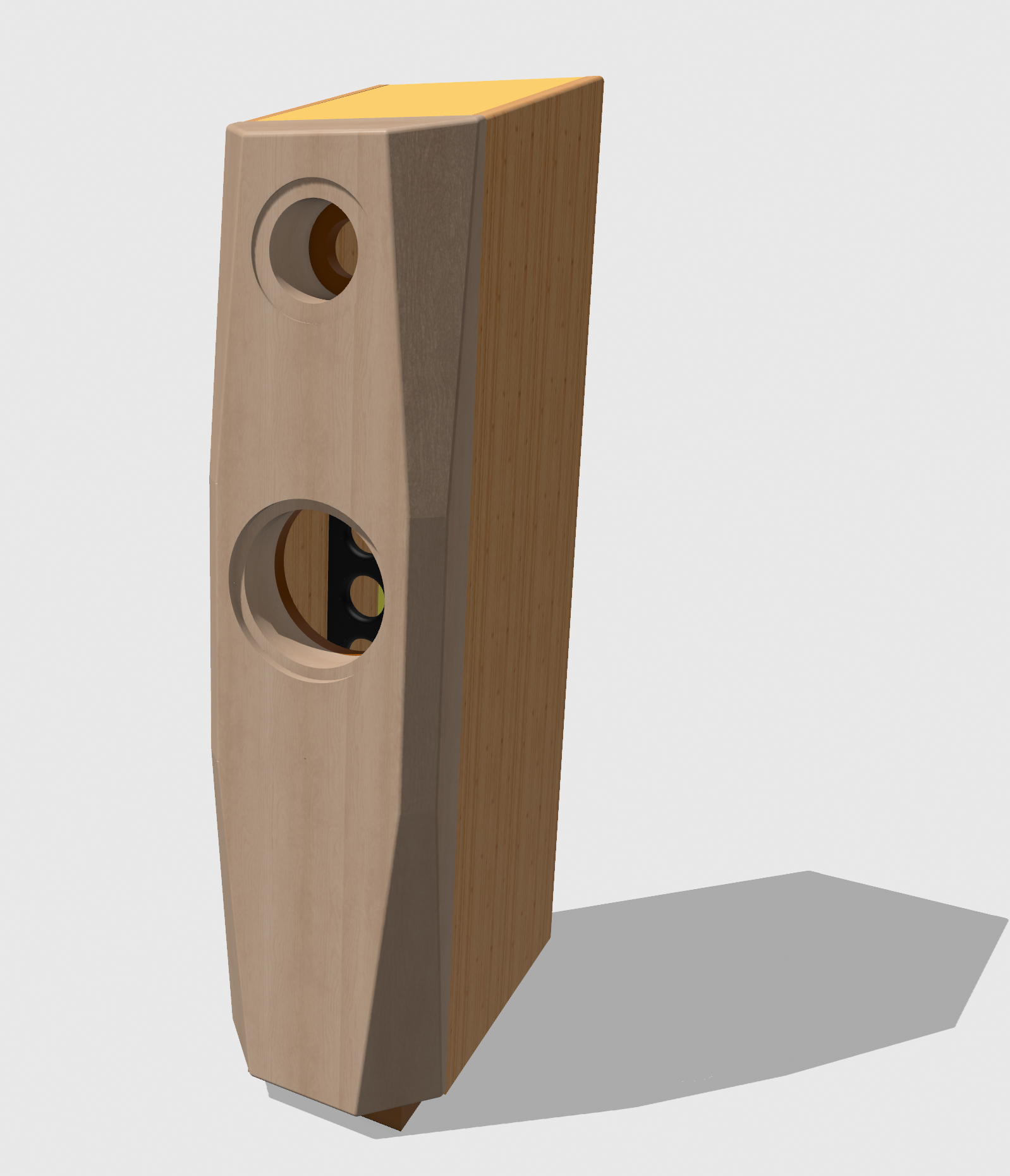

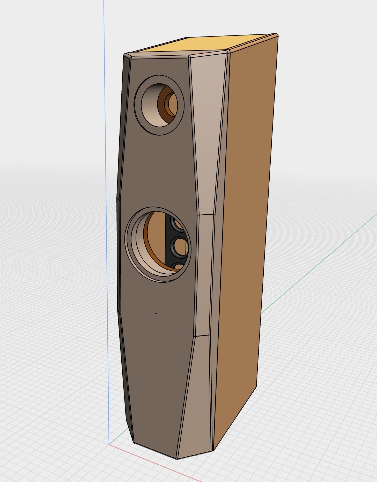

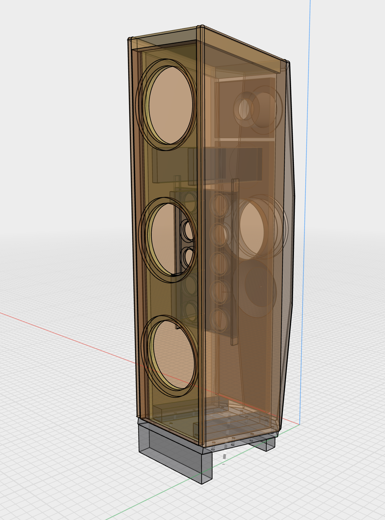

    For now, a few renders of the enclosure.
    Just the facts, ma'am, as seen with basic visualization.
Name:	Modeling Basic.png

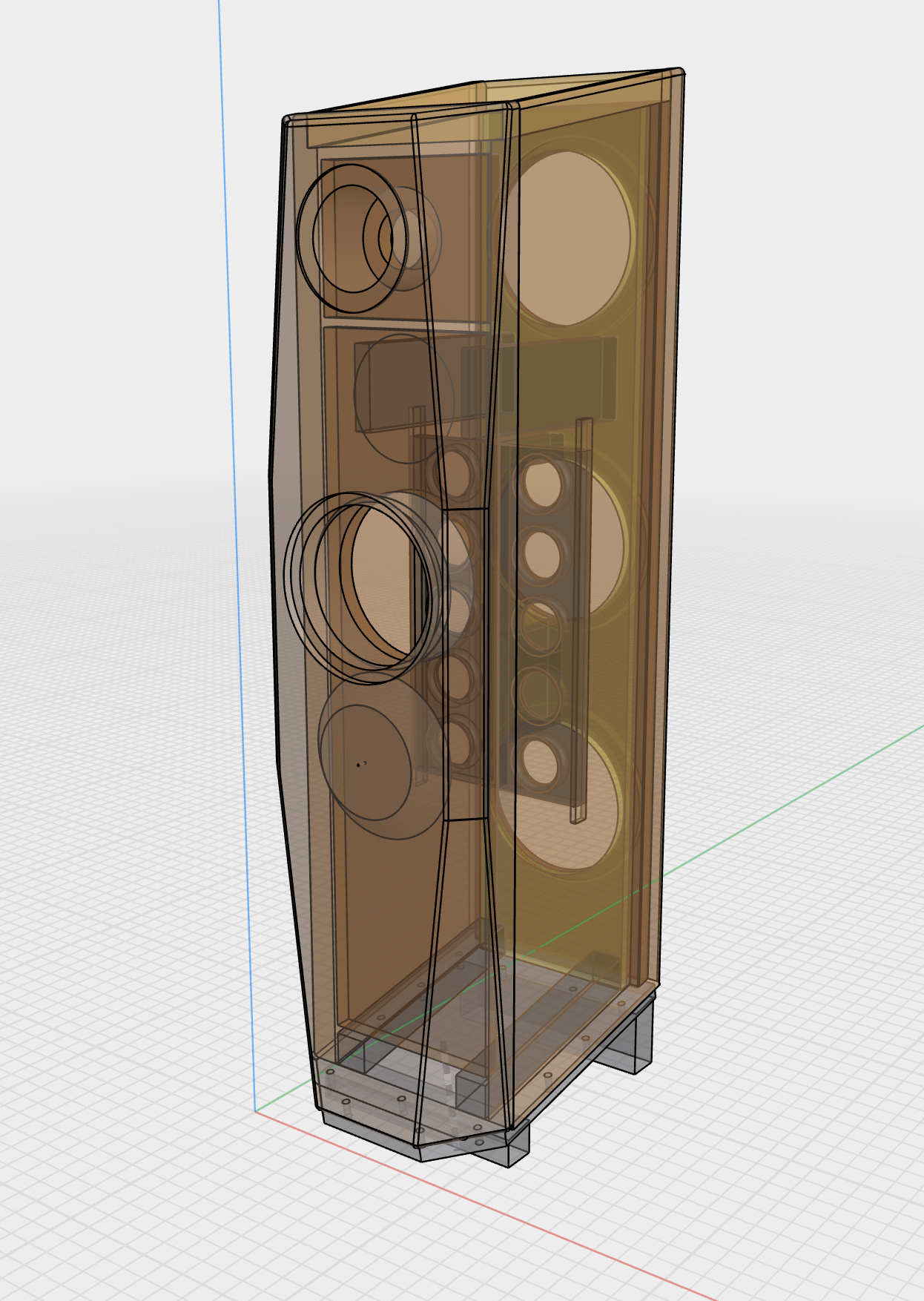

    An X-Ray view of the ported version:
Name:	X-RAY Ports.png

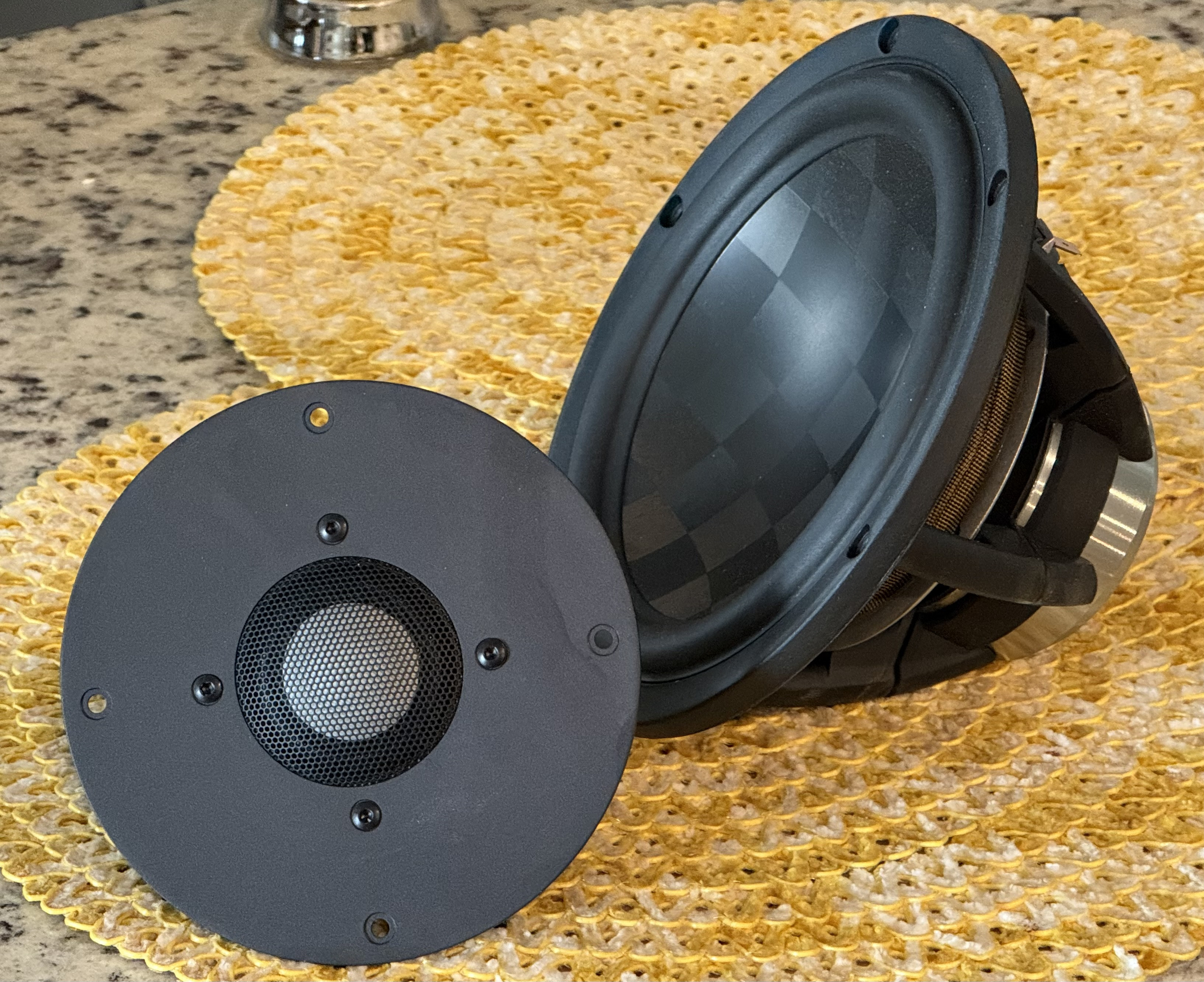

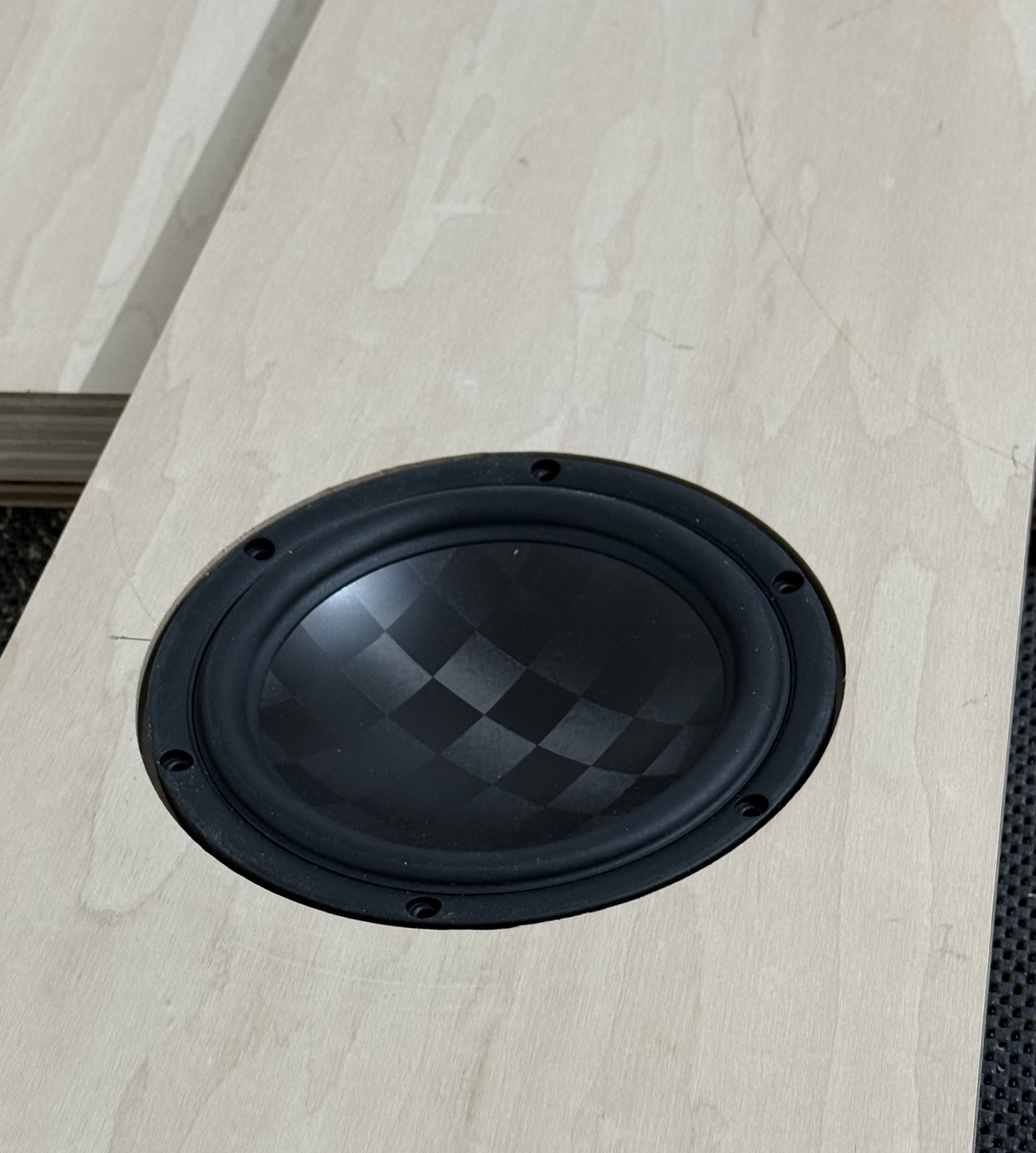

    Well, a lot going on today, and I forgot to mention the drivers:
    • Woofer: Satori MW19TX-08 Textreme woofer
    • Tweeter: Peerless DA32TX-008
    Of course, a pic...
      JonMarsh commented
      Editing a comment
      Yes, I get a bit of a buzz just looking at them and handling them!

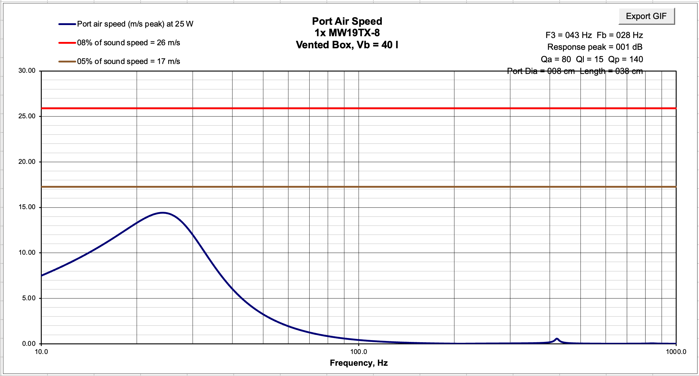

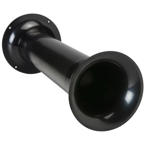

    Let's talk possible low frequency alignments- something sexier than just sealed. Of course, this is an area where DIYW can always rule, but perhaps some examples will be useful.
    I examined two types in detail-
    • A downward firing double flare port
    • A passive radiator setup- many possible variations, but I've been having fun modeling with the new Dayton SS10, I have four currently on hand; though truthfully, I think it is more suited to Evil Twin, as it has some interesting characteristics, but will lead you into a design that seems influenced by the Dark Side.

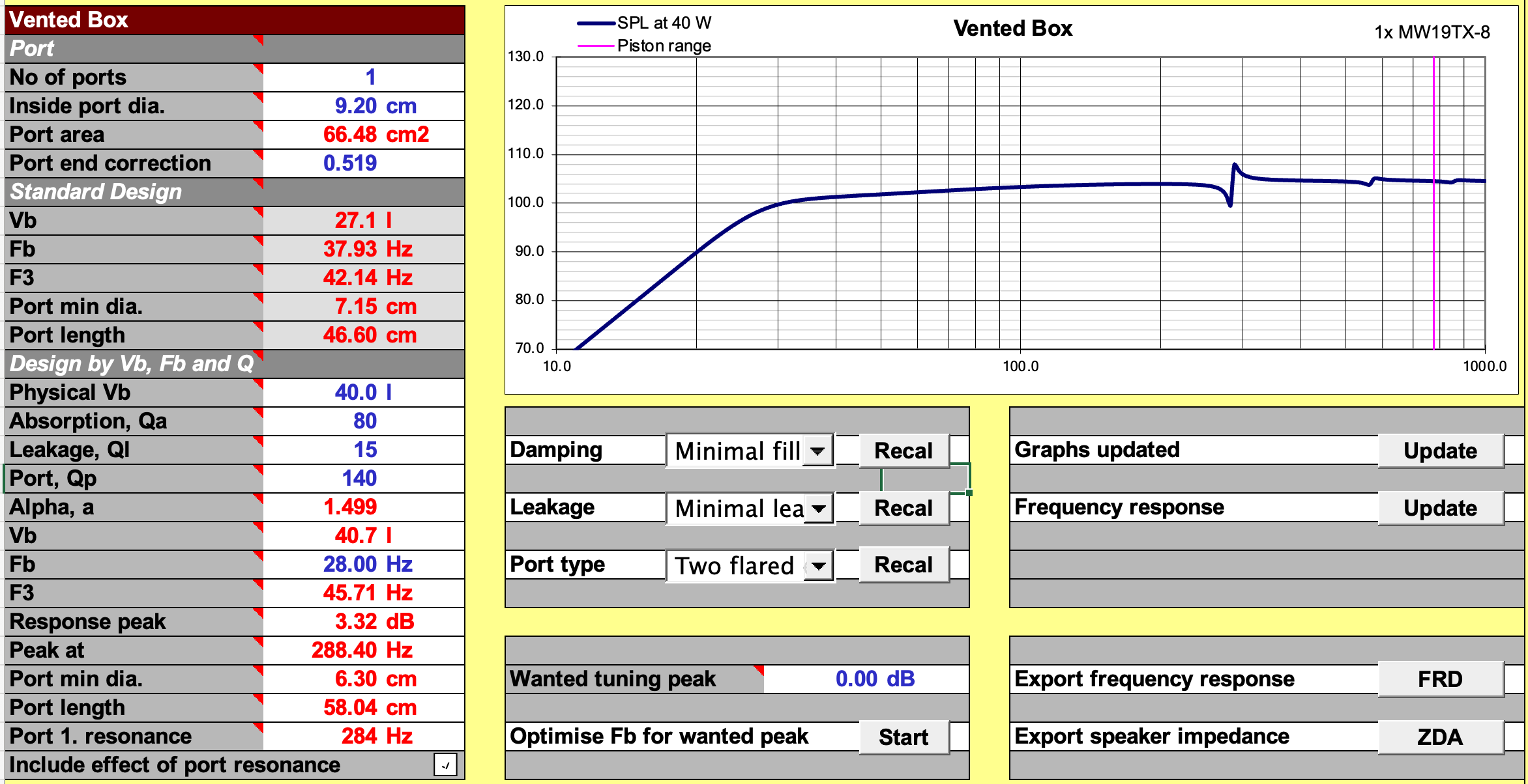

    Let's start with the vented alignment-
Name:	Vented Design 3in Port Dia.png
    The port diameter is a critical parameter- too small and the high air velocity results in compression and distortion at higher SPL; too large and port resonances at significant amplitude will occur in the working pass band.
    Like this one:
Name:	MW19TX-8 Vented Design.png

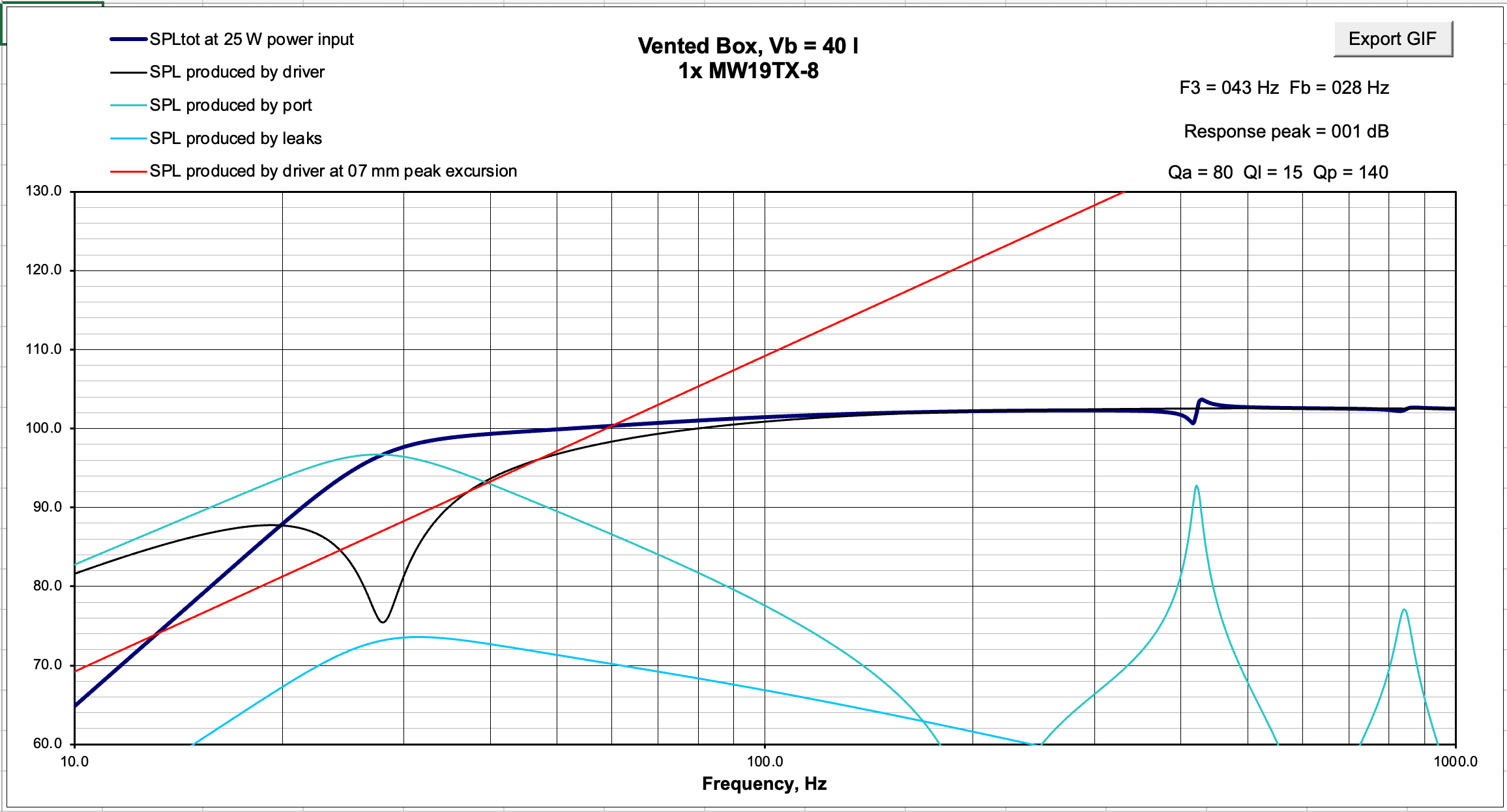

    With the 3" diameter port, things are fairly reasonable, if not quite perfect, and port resonance is fairly low and port air speed is within reasonable bounds.
Name:	MW19TX-8 Vented SPL.png
Name:	Vented Port Air Speed 3in dia.png
    This is for a port construction flared at both ends. ET says don't even consider not using flared ports..

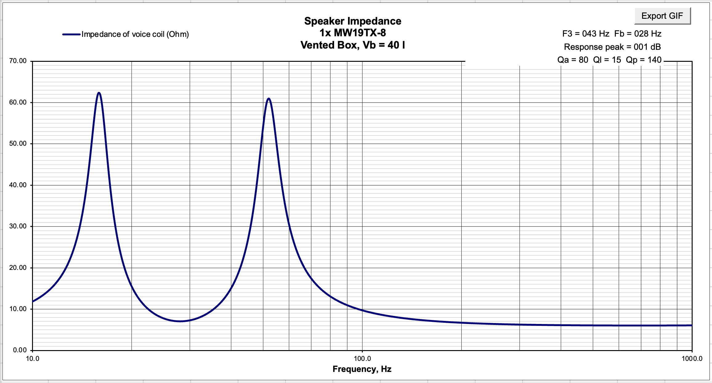

    Lastly, the LF impedance curve, it's almost like a smiley face...
Name:	Vented Impedance Curve.png

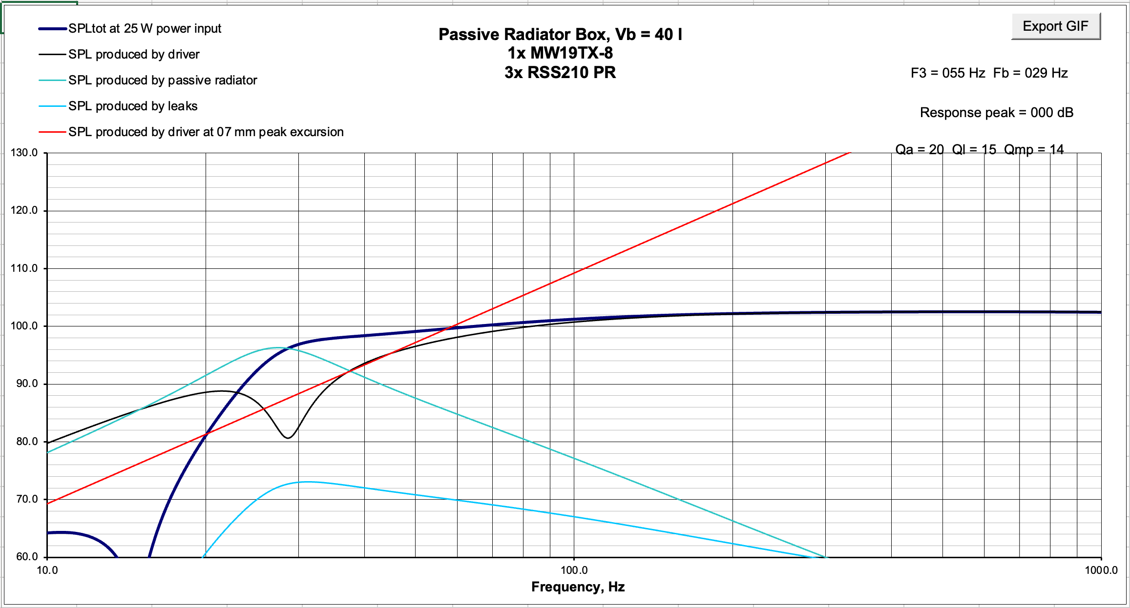

      • 16175

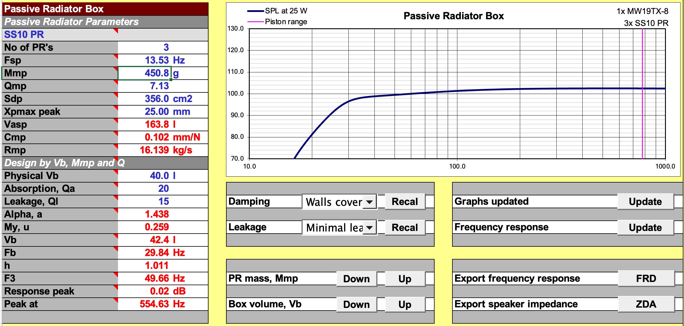

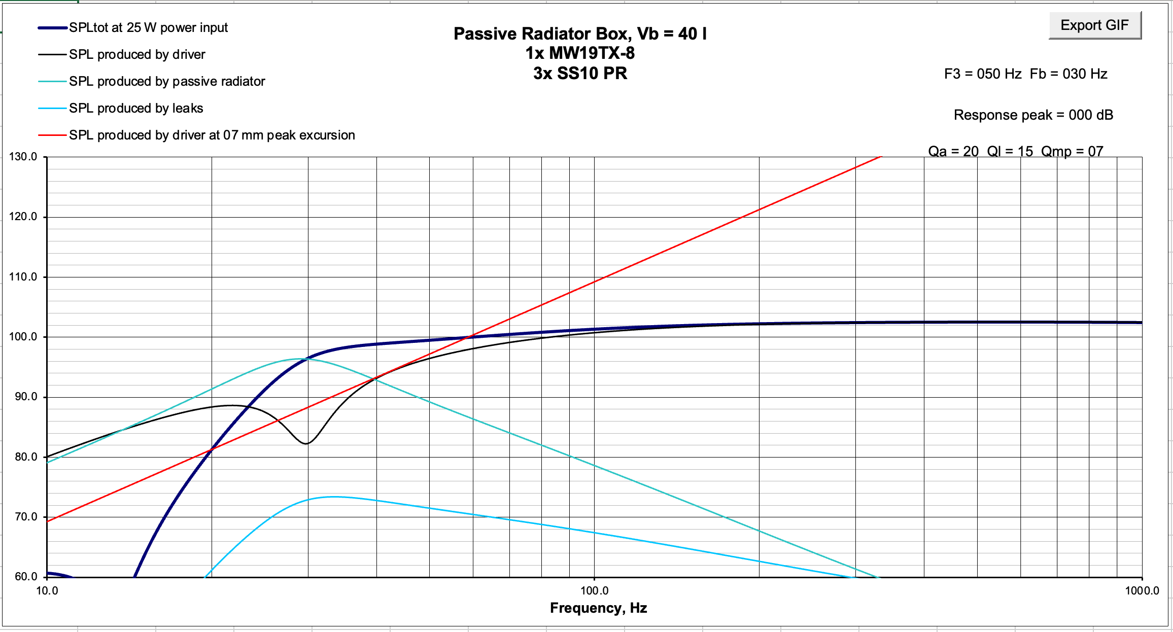

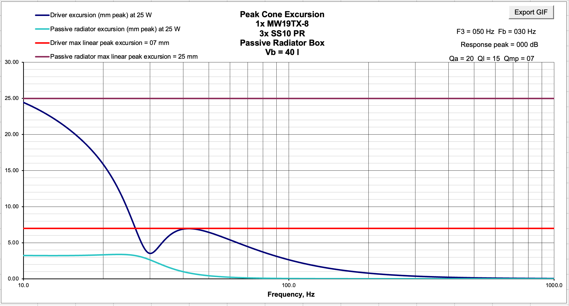

      Now, with ET looking over my shoulder, I'm going to take a trip on the dark side- PR's on the back side of the enclosure, and to make the challenge even more interesting, let's consider one of Dayton's newest high value parts, the SS10. I ran through many alternative configurations, and even flirted with a full 4th order Bessel alignment, but in the end settled for something a bit more conventional... but given the parameters of the SS10, not without it's quirks. PR alignment quirks include the relatively large steps in MMP depending on how many weights one uses and how large each weight is; sometimes one might prefer smaller steps, and that is possible, but requires visiting your hardware store. Here, we're keeping it simple... sort of.
      Click image for larger version  Name:	3x SS10 PR Design.png Views:	0 Size:	237.6 KB ID:	961115
      These PRs will always be loafing, but hey, so are many modern cars at legal speed limits, right?
      Baseline tuning target for Fb is similar to the ported alignment, but there are no port resonances or similar issues. For various reasons, I wound up with a Fb of 30Hz.
      Click image for larger version  Name:	3x SS10 PR SPL.png Views:	0 Size:	134.5 KB ID:	961116
      This was partly to wind up with a similar max woofer excursion for the same input power limit at low frequencies as the vented design, and Qmp of the PRs is a factor in that choice.
      Click image for larger version  Name:	3x SS10 PR Woofer Excursion.png Views:	0 Size:	122.5 KB ID:	961117​

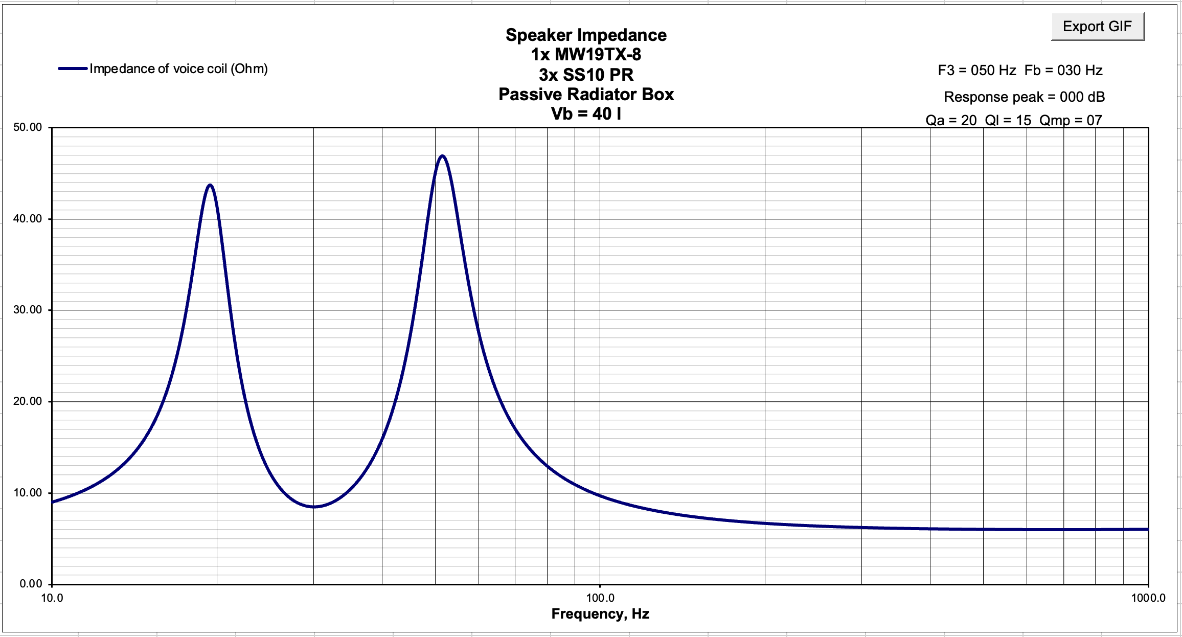

      Another smiley face impedance plot, sort of, this time with a bit of a wink and a nod...
      Click image for larger version  Name:	3x SS10 PR impedance.png Views:	0 Size:	107.1 KB ID:	961118​
      Yesterday I also ordered the maple ply for front panels and top, and two more Dayton SS10's... glad I have all the other needed wood on hand!
        JonMarsh commented
        Editing a comment
        And after two design reviews, have switched to RSS210-PR, have a near identical curves- the SS10 are just a bit too big for this enclosure, and given the limits of width for the maple ply, expanding it isn't feasible.

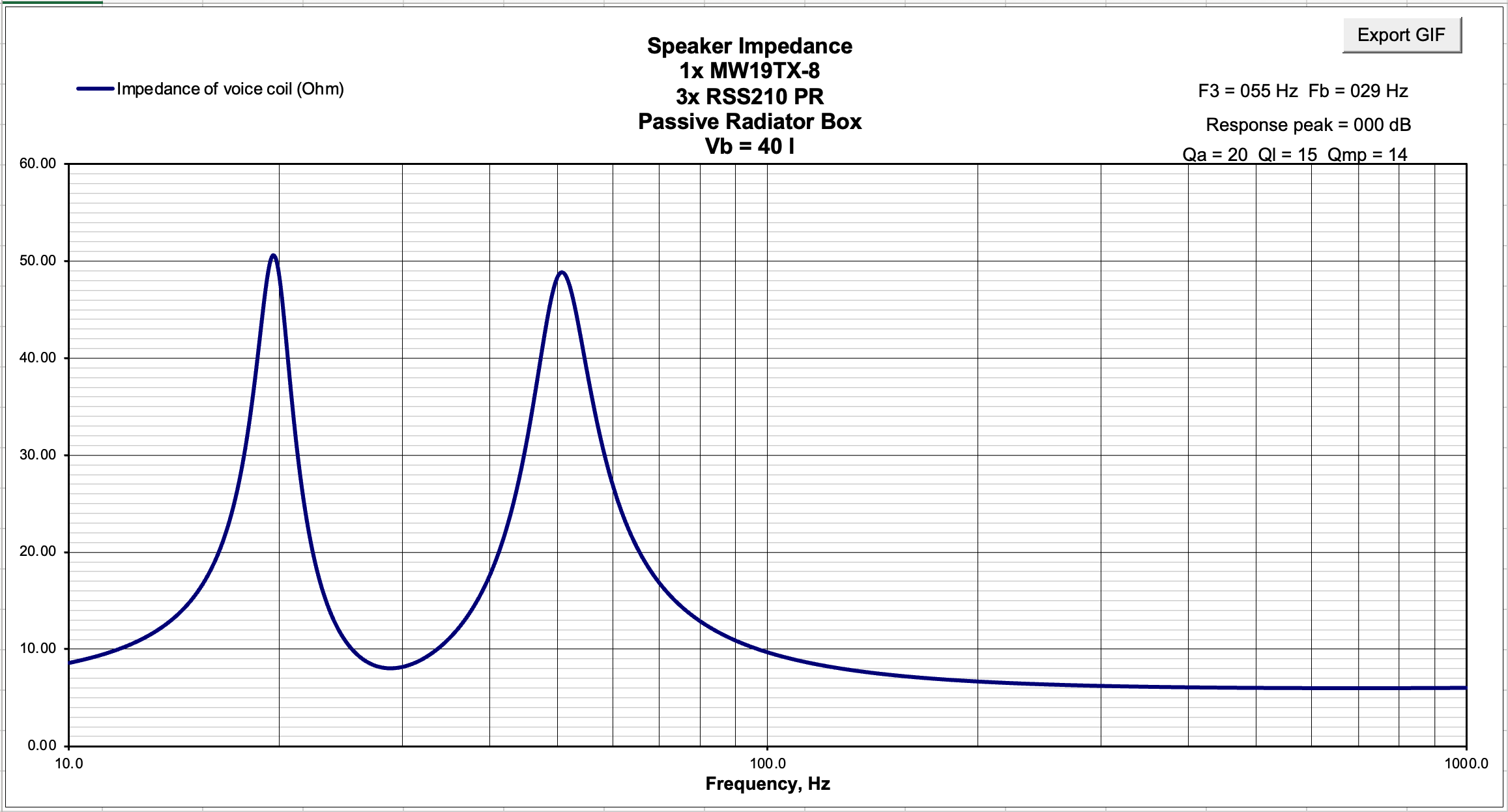

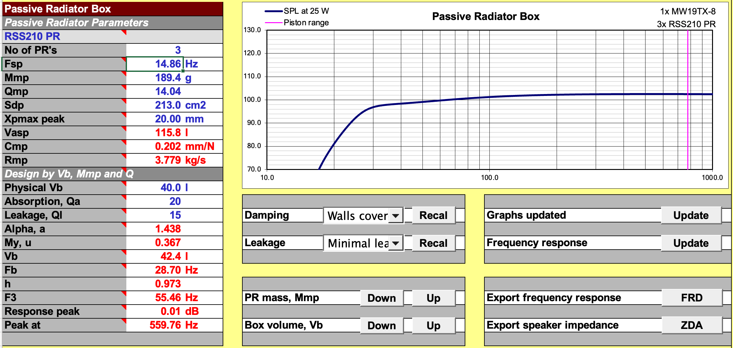

          • 16175

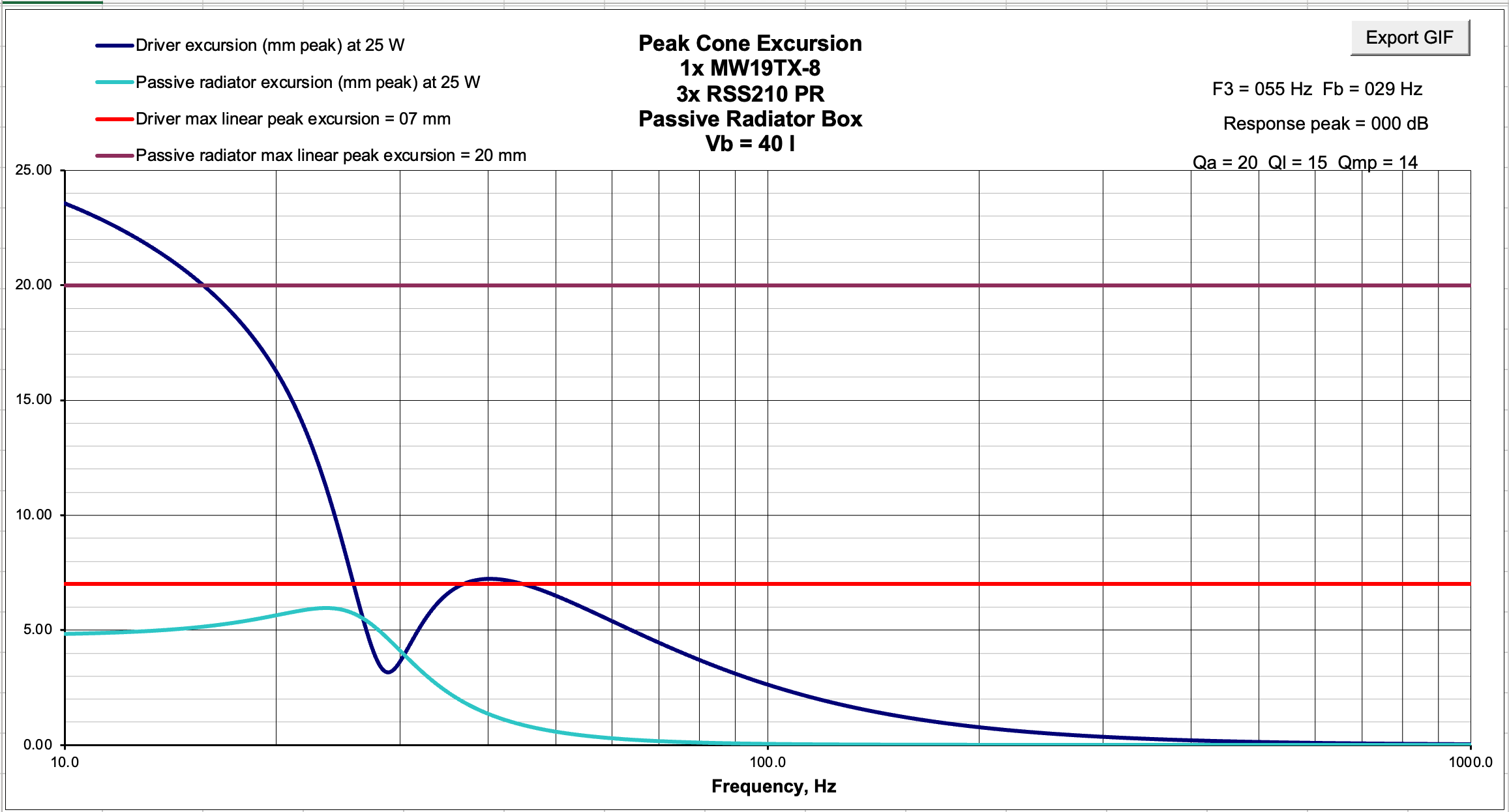

          Working on the 3D cabinet design for the Passive radiator version, I came to the conclusion that the SS10's are just a bit too big- just like the RSS265 were on the original Ardent D build. But, thinking back to what I recall of the parameters and balance of the RSS210 PR, I did an analysis for that, and it seems to be the sensible way to go... to whit:
Name:	3x RSS210 PR Design.png
Name:	3x RSS210 PR SPL.png
Name:	3x RSS210 PR Excursion.png
Name:	3x RSS210 Pr Impedance.png
          Not quite Twin Sons of Different mothers, but pretty close tuned this way...

            Mainly for Darryl's (and a few other curious parties) benefit I'm going to show the cabinet updates and the concept for how it can be tuned or oriented to an end users preferences, as regards the vertical angle. This was only explained a bit in the Ardent D project, because it was basically a conventional format acoustical prototype for the stacked laminate enclosure we planned for Sven and that SMJ Audio (Steve Manning) built.
            So, since I'm building a Passive Radiator version, that's what I'm showing drawings for, but they key adjustable part of the architecture is the supporting base, which allows the front and back bottom of the enclosure to be at different heights. Aspects of this came from a sub Brand of Tidal Audio, VIMBERG, that I admire as regards design esthetics and results.

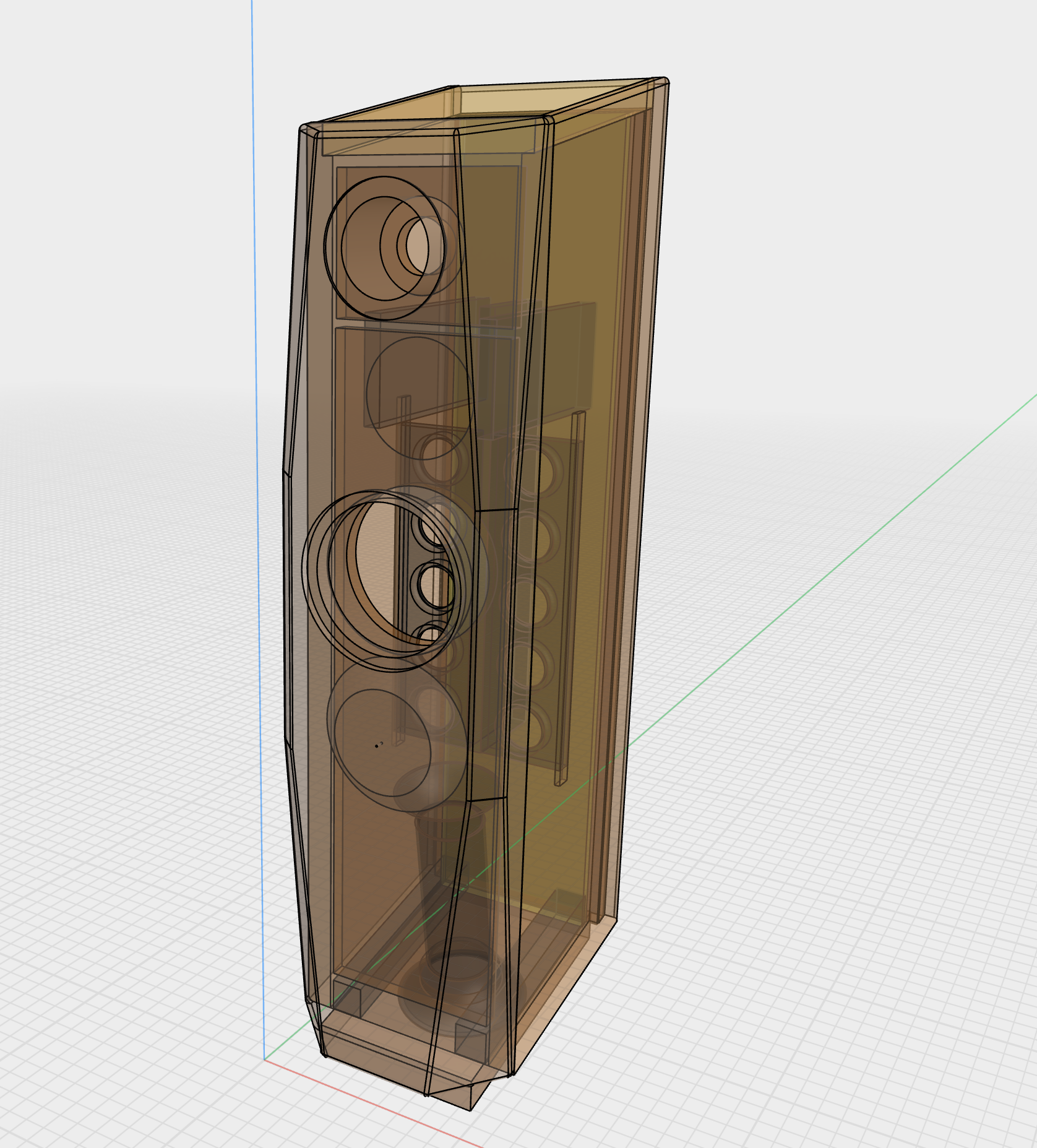

            So lets look at a few views of the updated drawing:
            First, a front view... Note the base structure, a high density phenolic base plate, made from Leecraft BK3, which will attach via bolts at a number of locations in the bottom of the cabinet equipped with threaded inserts, M6 RAMPA being my preference. Of course, DIYW. The elevating blocks can be varied in height, varying the vertical angle of the cabinet. The material I used was scrap pieces of maple ply, due to it's strength and ease of working (basically no rip outs on routing or drilling operations)
Name:	7-15 Update X-RAY Forward with sides.png

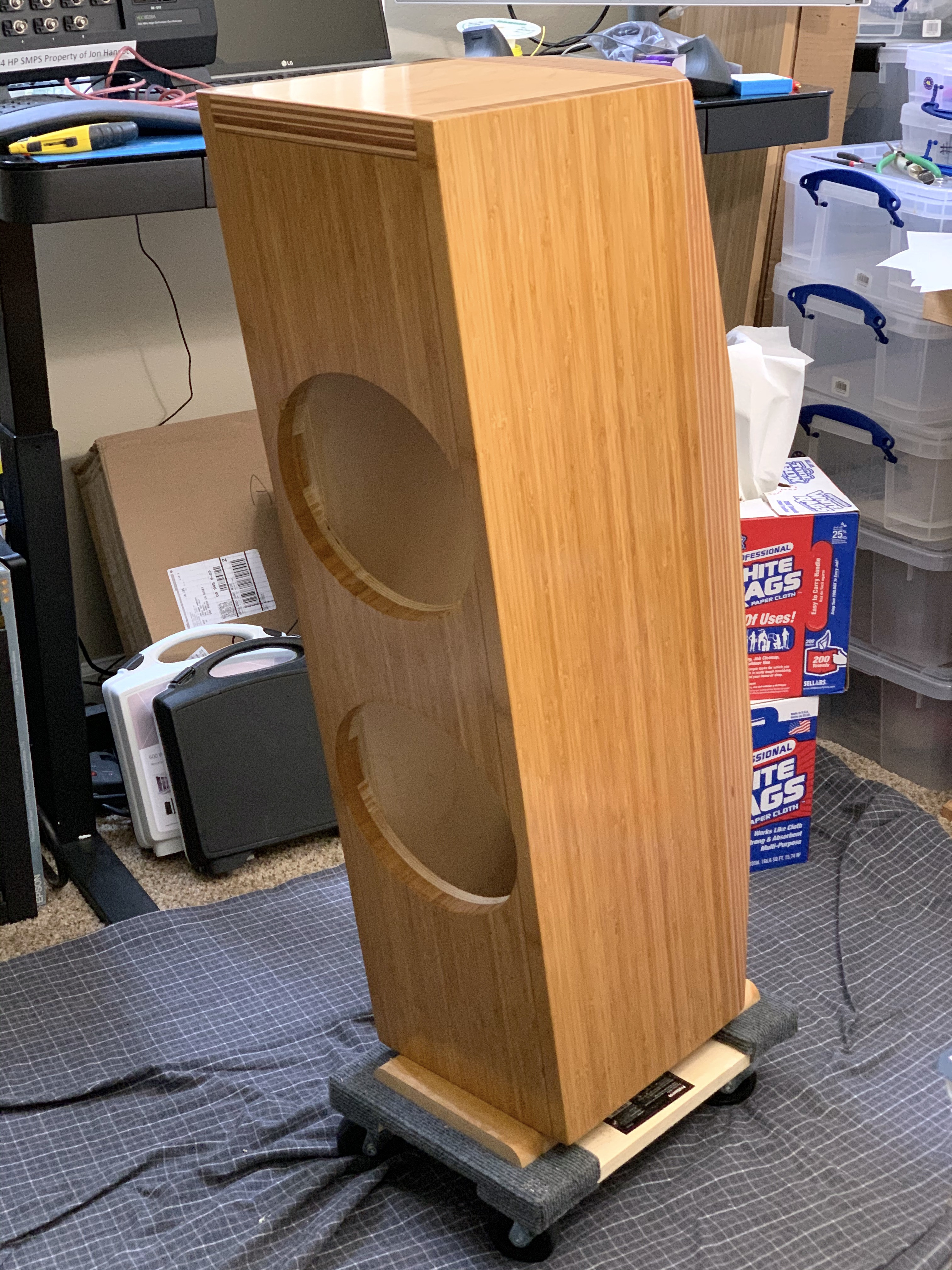

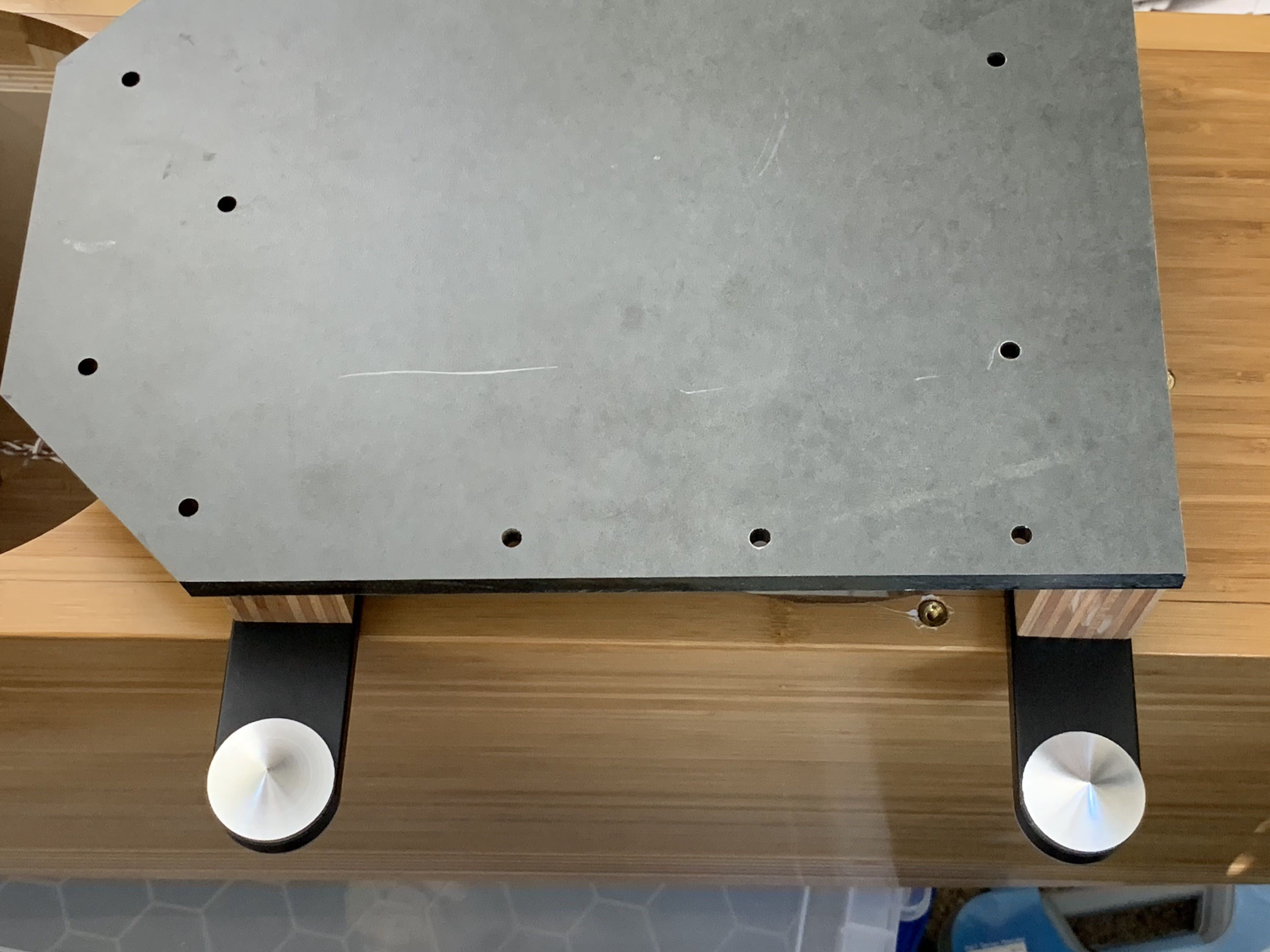

            Here's a photo of what one build example of the base looked like:
            The outriggers are a basic product made in China, available on Amazon, and easily converted to different interface products with the floor.

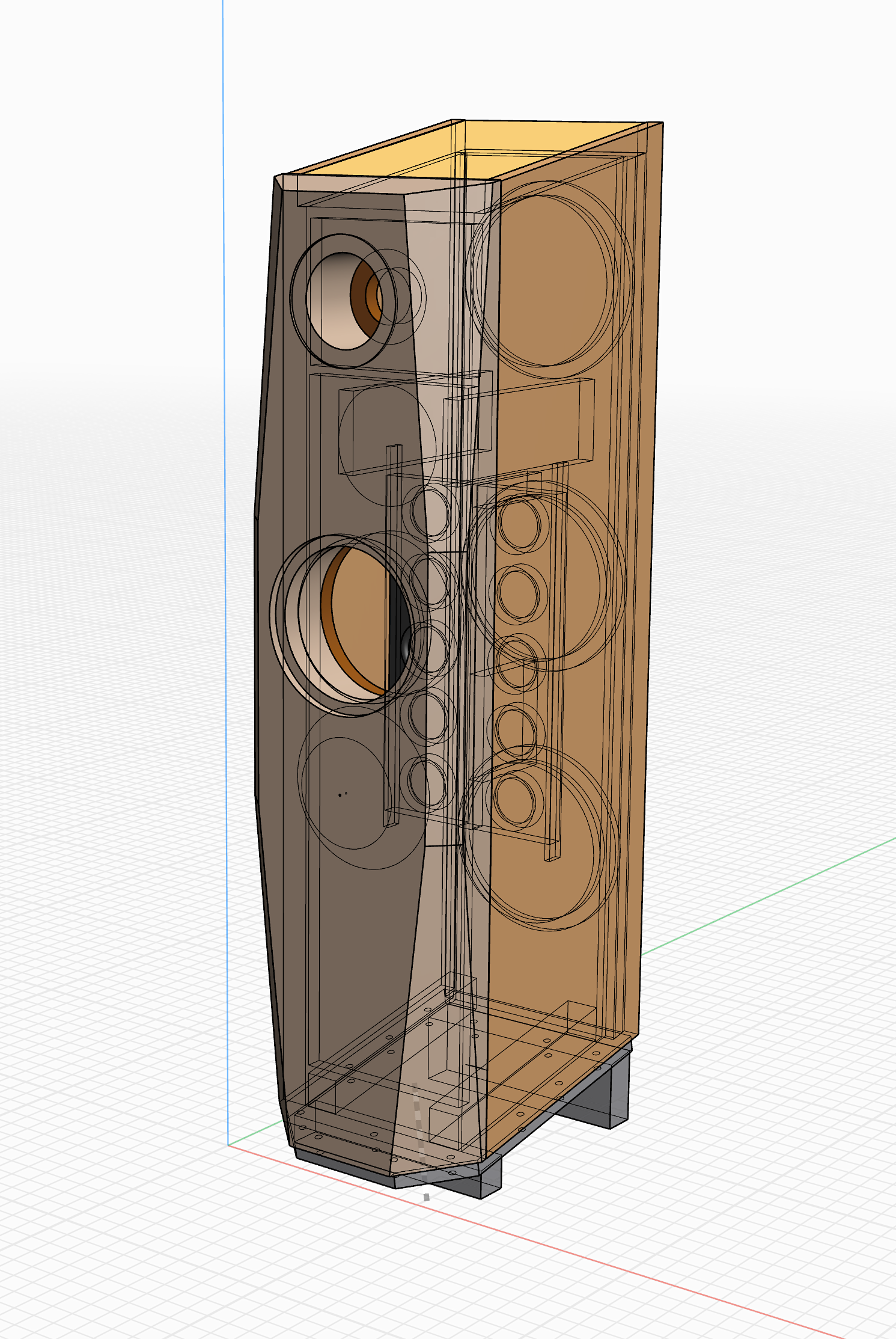

            Rear view makes the concept a bit clearer, with rear panel openings for the RSS210 passive radiators- not shown is an input plate connector. This could be on the underside of the phenolic plate:
Name:	7-15 X-RAY Update Rear With sides.png

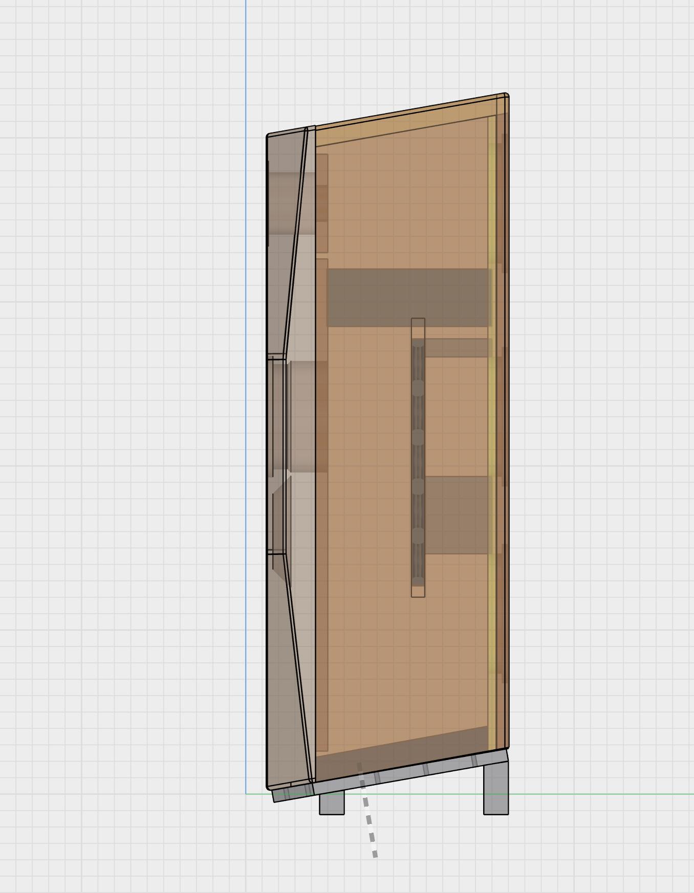

            And one more view, from the right side, with the view of the nominal cabinet axis included:
Name:	7-15 Update X-RAY Right with sides.png

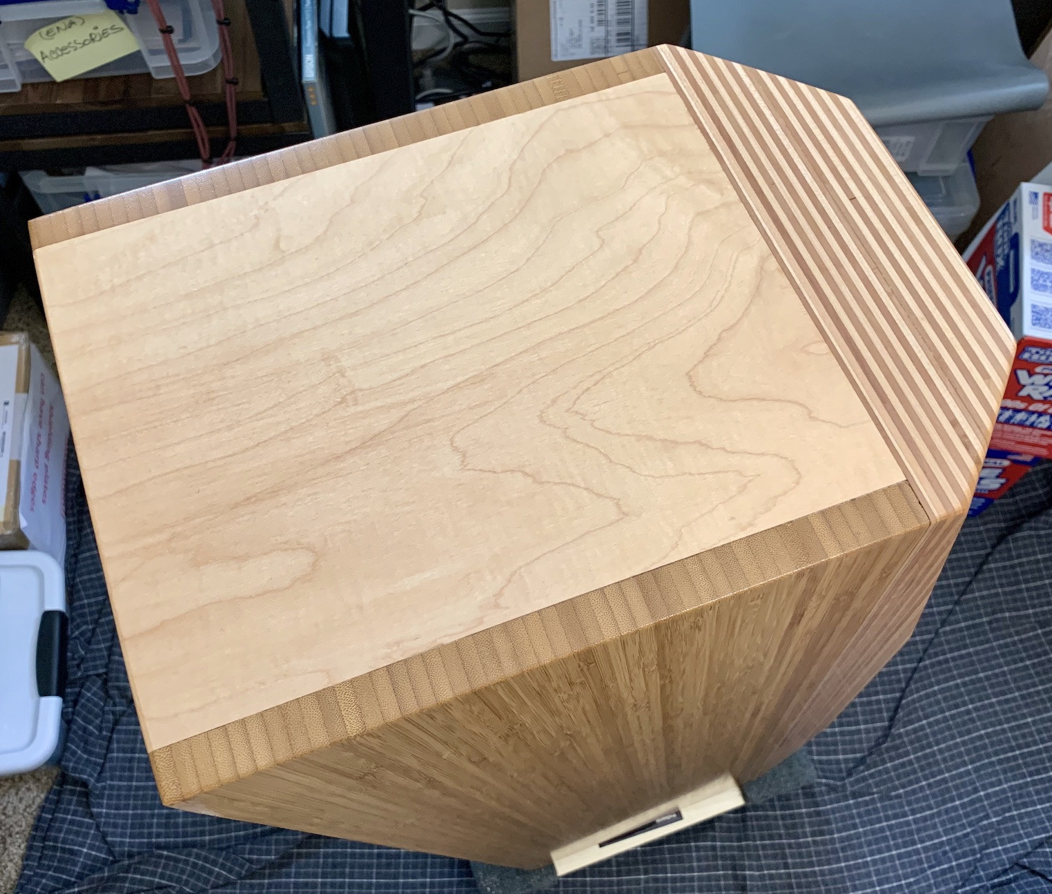

              And last, a photo showing the top of one of the original Ardent D's, showing what things look like after it's all put together and finished:
              Click image for larger version  Name:	2nd Cabinet.jpg Views:	0 Size:	2.87 MB ID:	961146
              Click image for larger version  Name:	2nd Cabinet Top.jpg Views:	0 Size:	530.3 KB ID:	961147

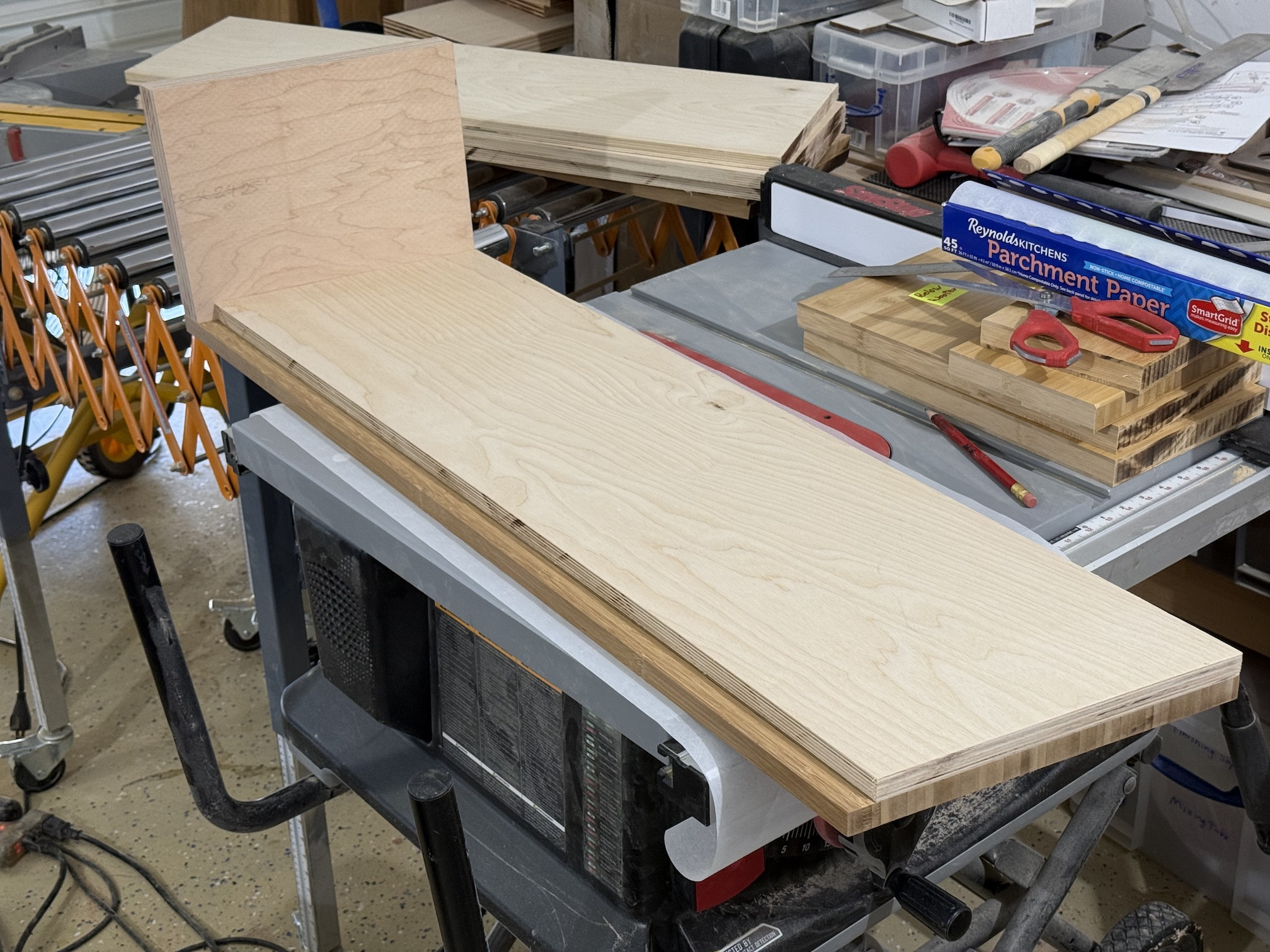

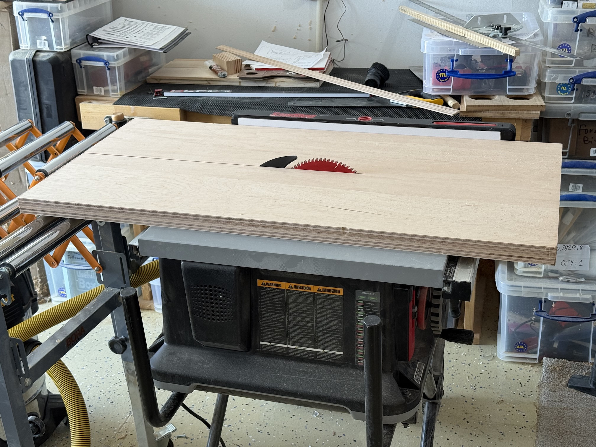

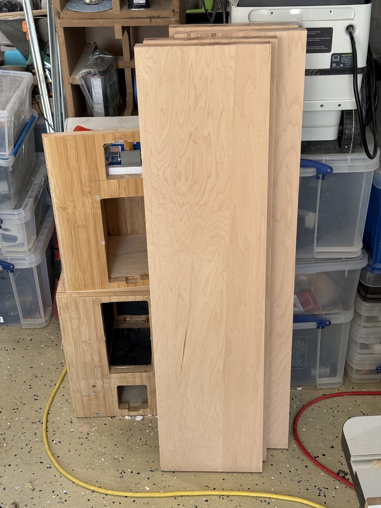

                • 16175
                Maple Ply arrived on schedule this afternoon. It’s nice when stuff goes according to plan

                  I'm going to post one more PDF screen capture right now- in this one, I took off the edge fillets, that were implemented in building the original Ardent D, as it allows the dimensioning for the raw pieces to work more easily.
                  Note, the original 3D design file for the Ardent D was prepared in Shark CAD; since around 2022, I've only been using Shapr3D, developed in Hungary, first for the iPad Pro, then Mac, then PC.
                  I'll create piece part PDF drawings using this version of the cabinet design. All the major ones are already complete; just some small parts to finish up.
Name:	Jul 18 Hidden Edge ScreenShot2.png

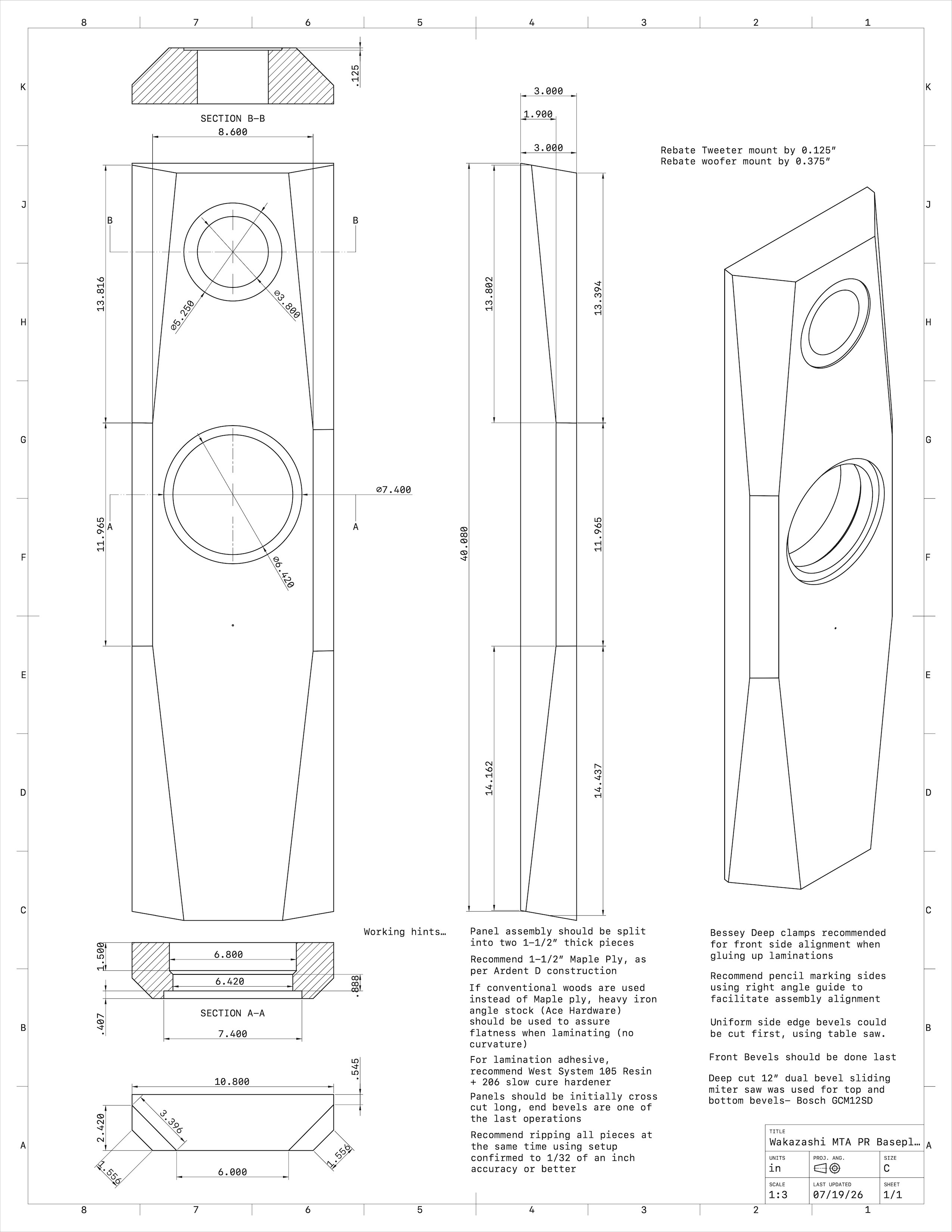

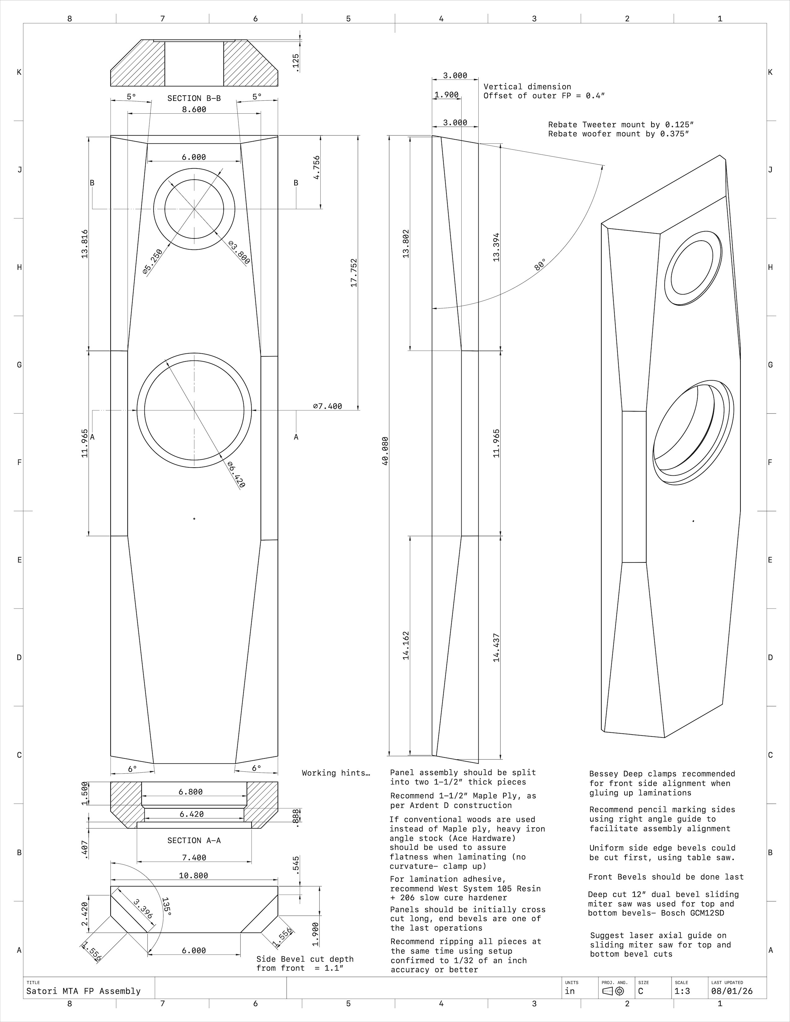

                      • 16175
                      OK, some early "sharing" here, so that folks keep in mind the work required for this build, should you choose to accept this "Mission Impossible".
                      (well, it's far from impossible, but it's not a simple 6-1/2" two way in a box with 90 degree corners...)
                      I've added some "hints" and directions into this print, should answer some questions, and establish a realistic baseline. Of course, I'm assuming overall a reasonable accessibility to tools, including a variety of routers, a high grade miter saw, a capable high precision table saw with a reasonable deck size, and a good quality biscuit joiner, like a Makita or DeWalt.
                      No CNC was harmed or used in this plan or past contructions.
                      THESE are INITIAL DRAWINGS FOR A PROTOTYPE CONSTRUCTION FOR A DESIGN THAT HAS NOT YET BEEN COMPLETED AND TESTED (Meausrements in cabinet and crossover work pending).
                      So, consider this for information purposes only, though obviously, it's what I'm building, based on past experience and fairly standard design work, as shown earlier in this thread. This JPEG was created from the PDF. Message me if you'd like a copy of the PDF.

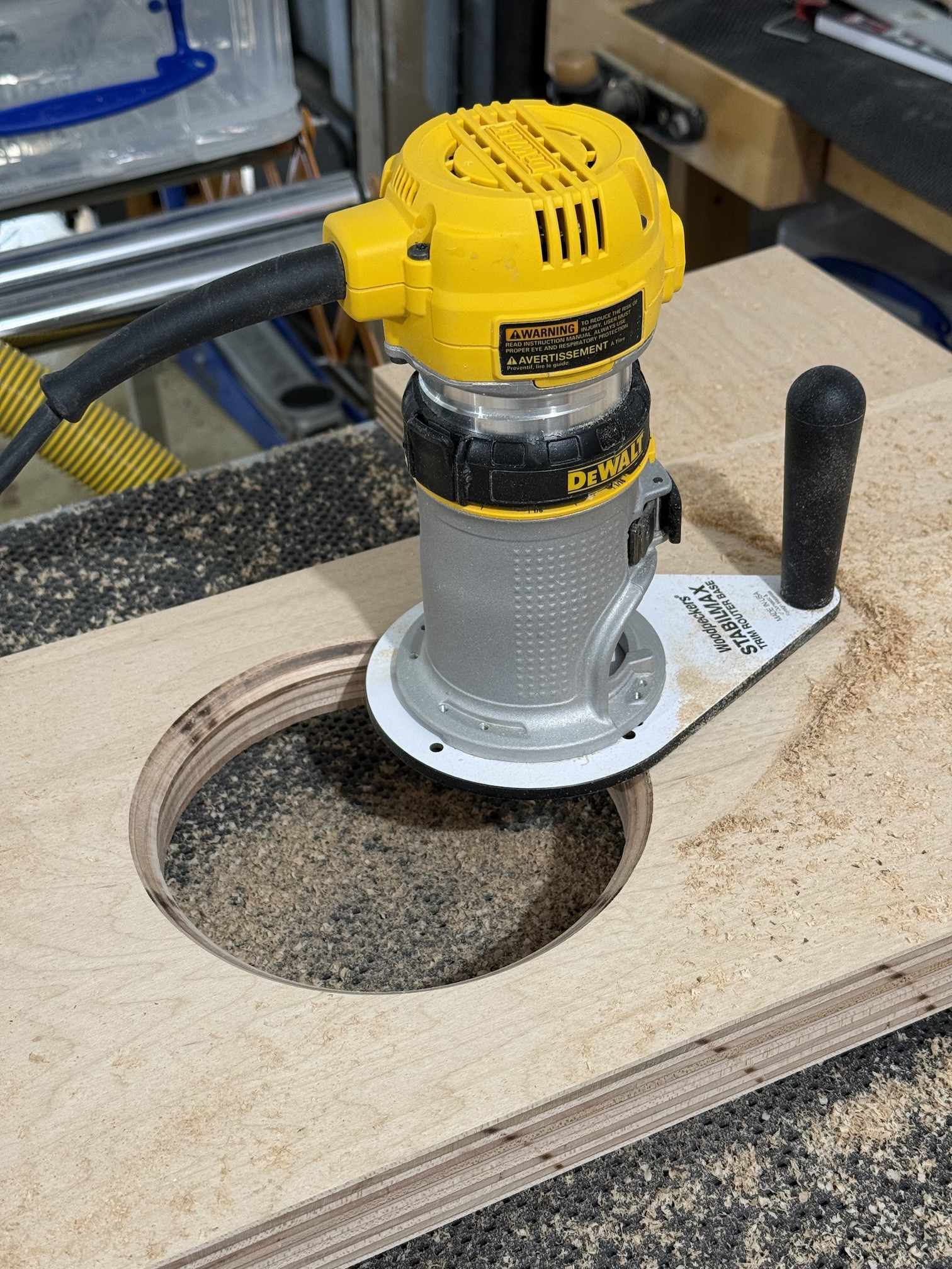

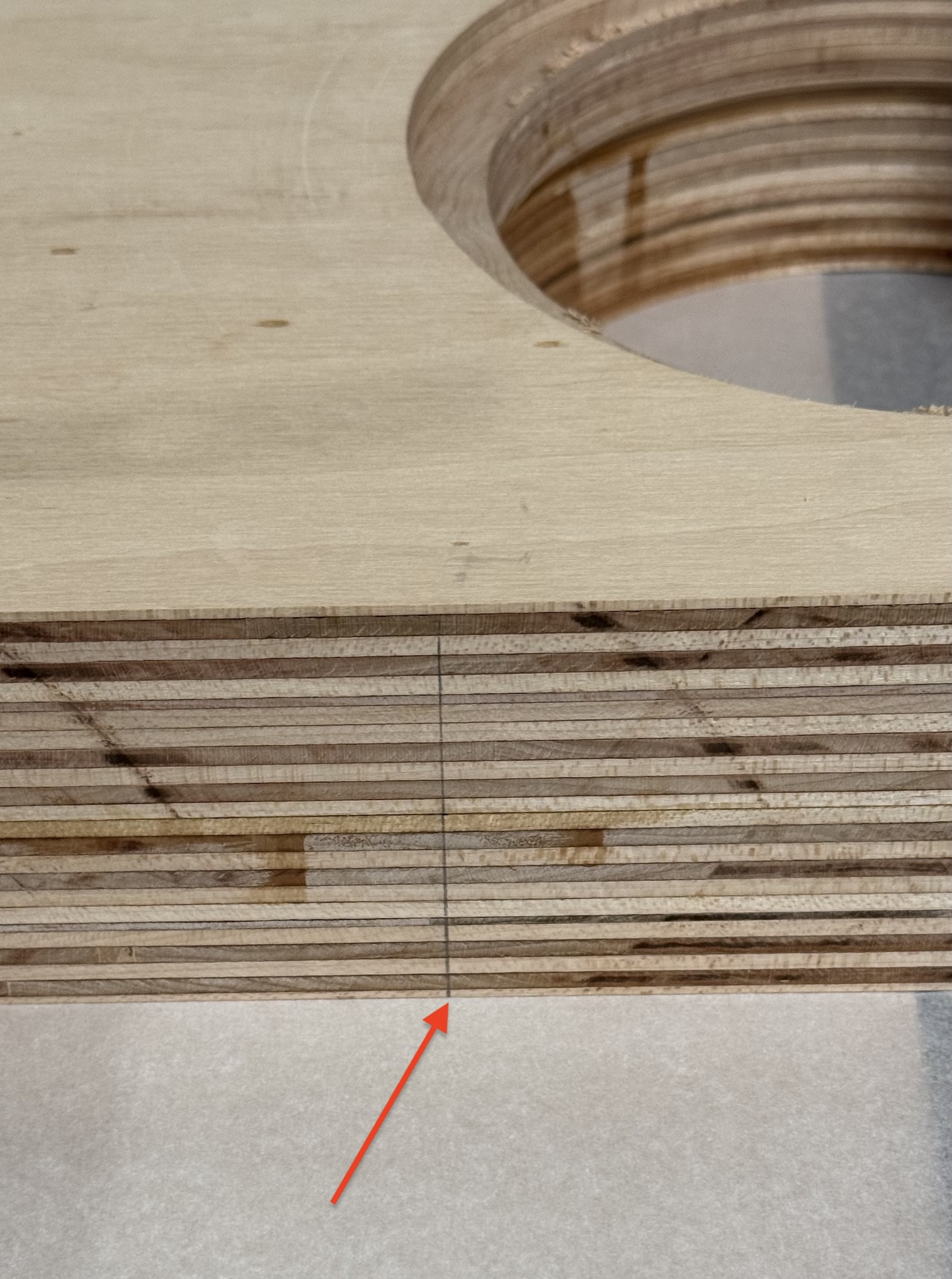

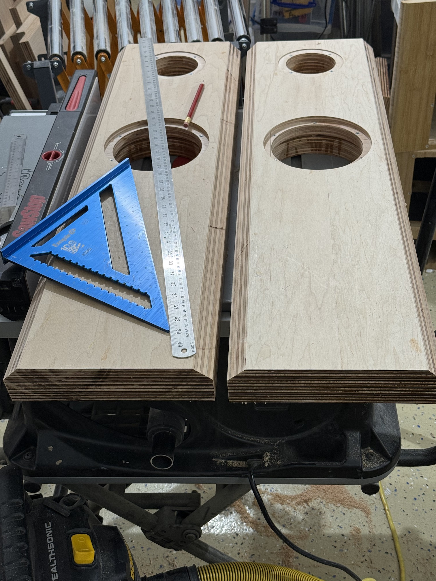

                      Click image for larger version  Name:	MTA FP Edge 3x PR  210.jpg Views:	0 Size:	778.9 KB ID:	961158
                        JonMarsh commented
                        Editing a comment

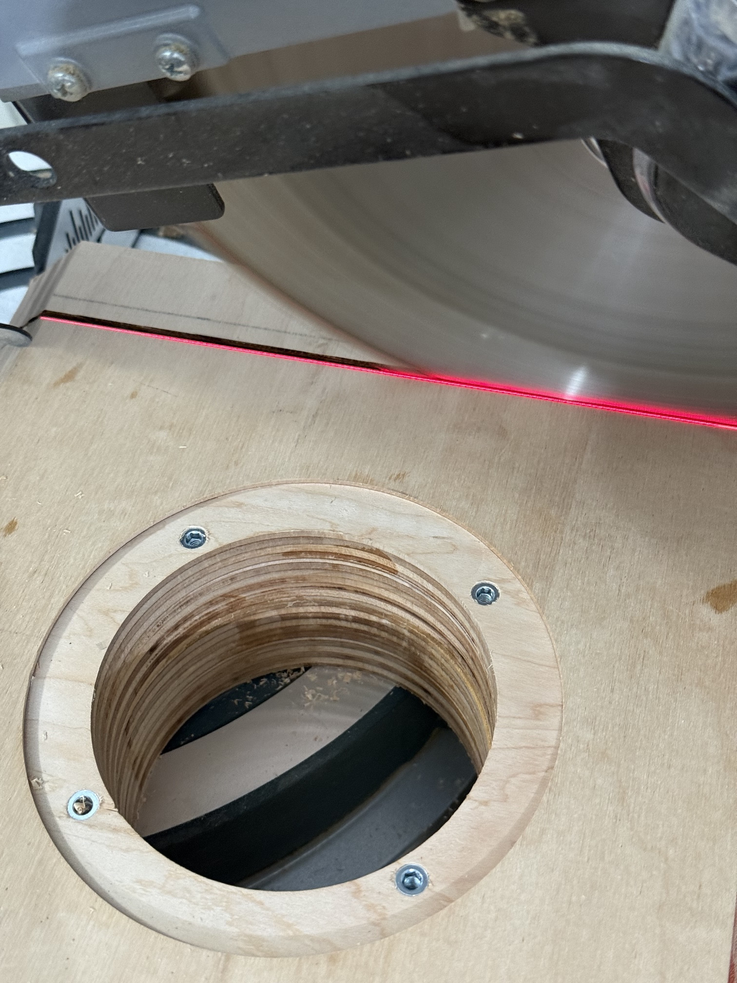

                        Didn't mention this, but the routing operations should be done on the 1-1/2" thick panel pieces, how ever you choose to fabricate those. This is why we want precision operations so that stuff lines up properly when assembled. I can post about those steps if any one is interested.
                        JonMarsh commented
                        Editing a comment
                        All the other piece part drawings are completed and printed out as of late this afternoon.

                            A complete update pass was completed this weekend on the Shapr3D files- just detail stuff, and note taking, but also started an Excel file that I'm outlining the piece part fabrication notes in.
                            Also took my wife to the airport to visit her older daughter in Seattle for a week- doesn't count on the project, but you know how getting stuff like that sorted out goes with a wife that doesn't speak English well. Or probably you don't know!
                            I'm starting on the front panel fabrication first... get the tougher stuff out of the way!

                            And, proof of activity! Basic cross cut and today panel ripping.
Name:	Baffle work setup.jpg

                              OK, got diverted with some communication tasks, but back in the garage shop, did the cut off on the second Maple Ply piece, then ripped both of them to spec. One thing about working with expensive woods, one needs to measure two or three times and cut once- yield loss is expensive, and only more so the father into the build process.
Name:	Ripping Pause.jpg
                              Four of the raw front panel parts, 1-1/2" thick. With these ATB tooth blades, my cuts are much smoother than the factory ones.
Name:	Fronts Ripped.jpg

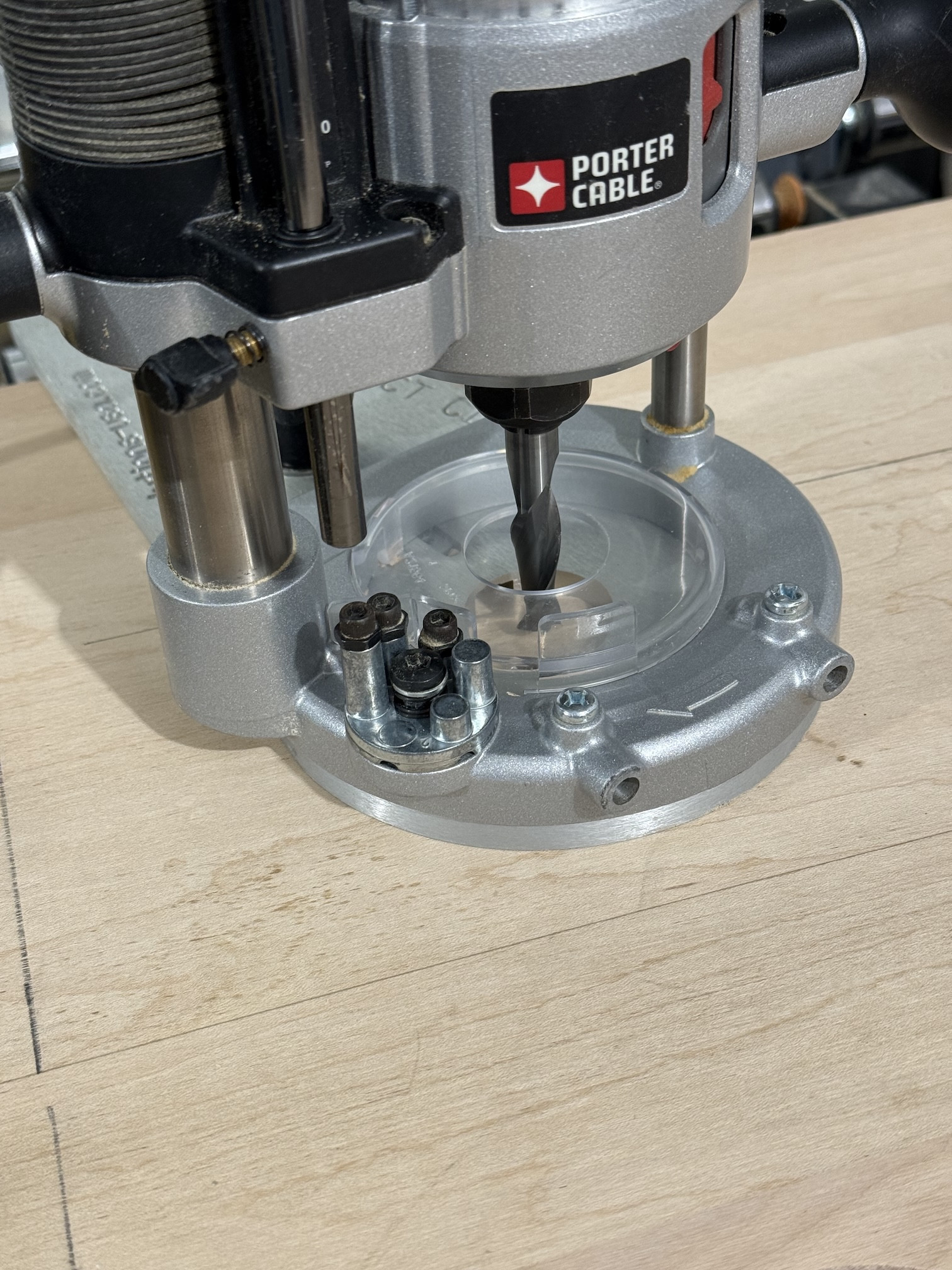

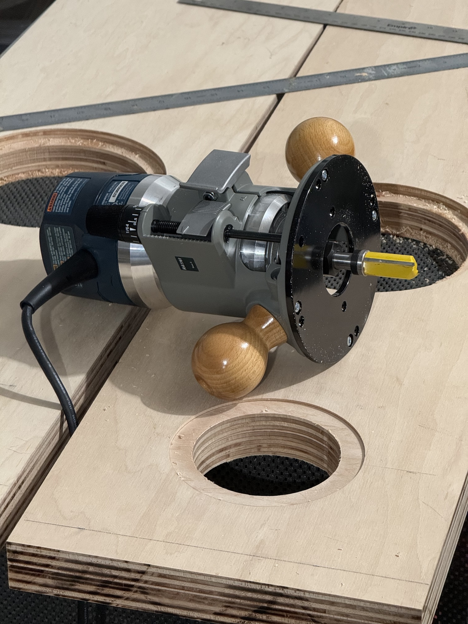

                                Something Old

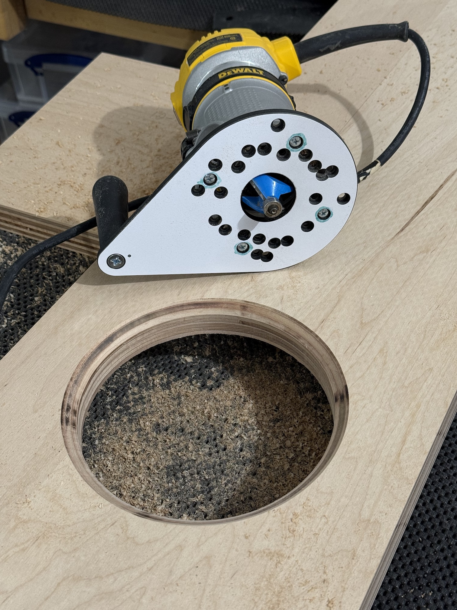

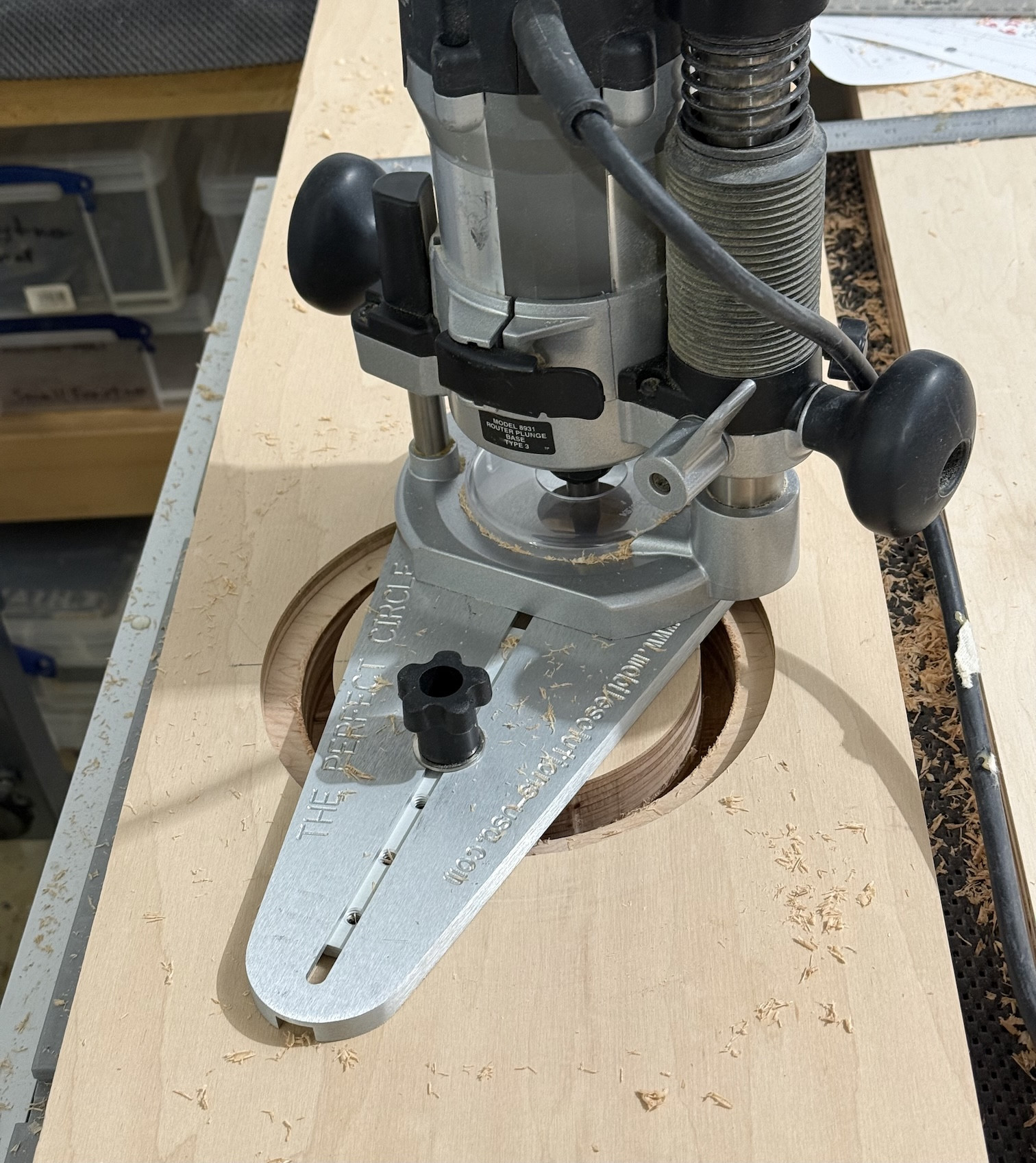

                                This sone is easy- it's my favorite router for doing driver holes, probably the oldest router I have and use regularly, a Porter Cable model with a Perfect Circle template. I'll talk about this just because I think it hits all the sweet spots for doing that kind of work, though at this point one would probably have to find something similar, 'cause I don't see this one on Amazon, for example.
                                Click image for larger version  Name:	Porter Cable Perfect Circle.jpg Views:	0 Size:	629.1 KB ID:	961221
                                There are three key things about this router, or any that you might select for this task-
                                • Excellent dust management, via a well sealed working space with ducting going to the top where it's easy to plug in a vac hose, such as I do from one of my DeWalt vac's from Costco
                                • Infinitely adjustable circular routing accessory which can flip the orientation of the routing pin and the adjustment knob- can do very small holes as well as rather large ones.
                                • A really well thought out plunge stop and primary plunge high clamp, which supports clean steps and making it possible, for example, to setup four or five routing depth steps in my 1-1/2" thick baffle parts, leaving a 1/8" thick layer easy to cut through and pull the center out, then smooth over with a router with follower bit.
                                Click image for larger version  Name:	Porter Cable Depth Control.jpg Views:	0 Size:	772.9 KB ID:	961222
                                Something New?
                                Picked up a new fixed base Bosch router that was on sale, as my old fixed base Bosch now lives in a Bosch Router table! And a nice shaft side follower bit, for cleaning out the bottom of routed through holes.
                                Click image for larger version  Name:	New Fixed base Bosch.jpg Views:	0 Size:	702.2 KB ID:	961223​
                                  JonMarsh commented
                                  Editing a comment
                                  Didn't mention this above, but the driver rebate cuts are done with a conventional two flange carbide tipped outer, but the through hole cuts are all down with a 1/2" solid carbide plunge router bit with a 1-1/2" cutting depth, Ultra-shear models from Woodpeckers.

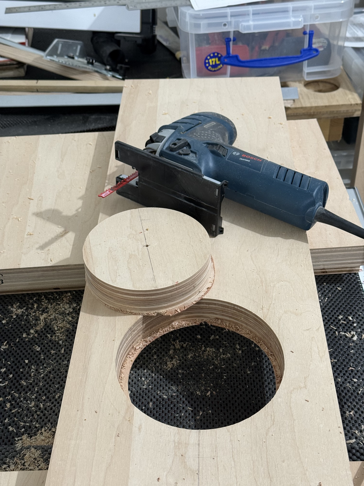

                                Click image for larger version  Name:	Blue Bosch Saber.jpg Views:	0 Size:	764.9 KB ID:	961225
                                Blue Bosch saber saw...

                                Oh, and my cute little bevel follower router bit, for sequencing to a different size through hole on the woofer in the inner panel...
                                Click image for larger version  Name:	DWP611 Blue Bevel.jpg Views:	0 Size:	882.2 KB ID:	961227​

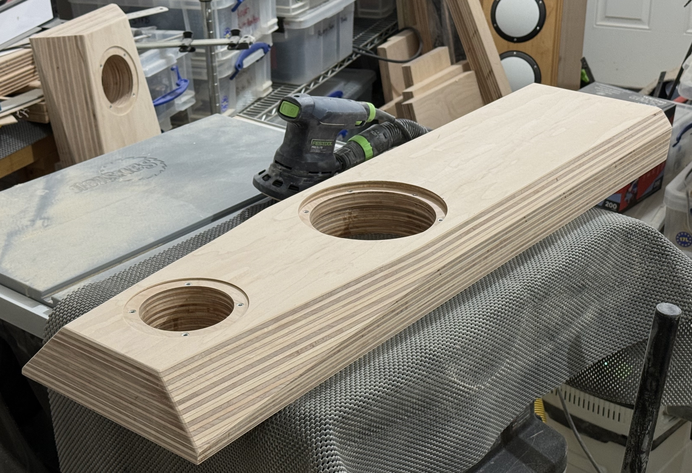

                                  Some basic stuff completed on the outer front panel pieces, including a slightly larger bevel on the back side so that it can transition nicely to a 7.0 pass through hole on the inner baffle for the woofer. This is for getting ready to glue the two 1.5" panels (which could have been made up of two 3/4" layers, but that's another story, not being told today) together with some precision...
Name:	DWP611 Bevel Cutt.jpg

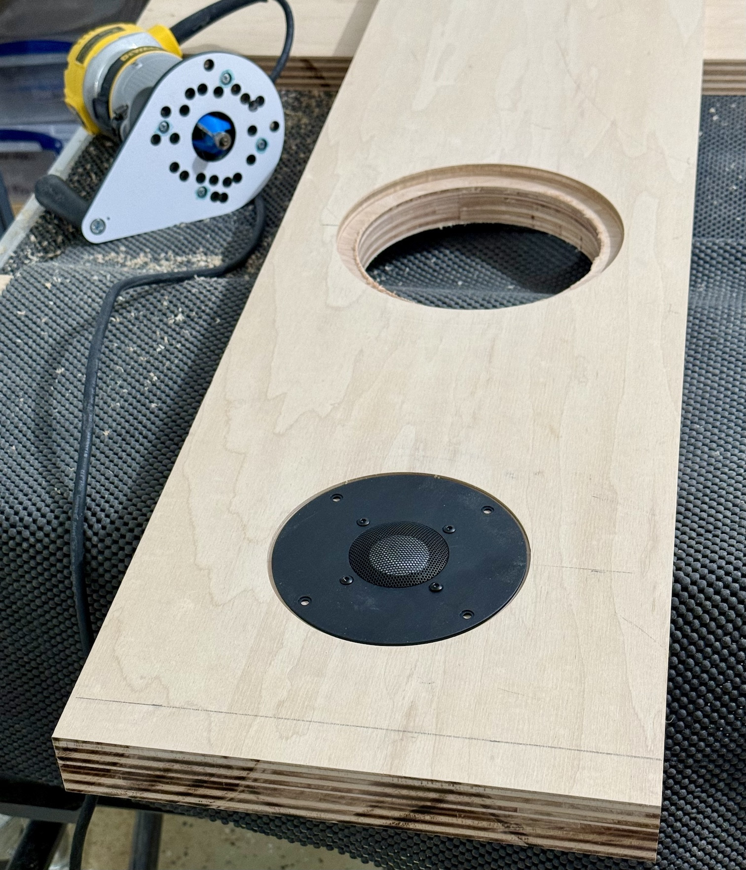

                                  Of course, fitment checks were needed for the DA32TX tweeter and the MW19TX-8 woofer...
Name:	DA32TX check fit.jpg
Name:	MW19TX Check Fit.jpg
                                  Since I'm planning to use grille cloth panels with Felt on the back (something borrowed from my self from the 70's, I'm not concerned with ultra tight gaps between the driver edges and the wood baffle. These seem pretty reasonable to me. Some of the needed hardware, like threaded inserts, will be done after the panel glue ups, and before cutting the big bevels, as this gives a larger working surface for using the Rockler drill stands and getting a nice perpendicular through hole for the inserts.

                                    The DeWalt DWP611 is sort of a Chunky Monkey for a 1/4" shaft router, but with an accessory base like this, can provide a very stable platform for router operations I wouldn't try with one of my Bosch Colt routers

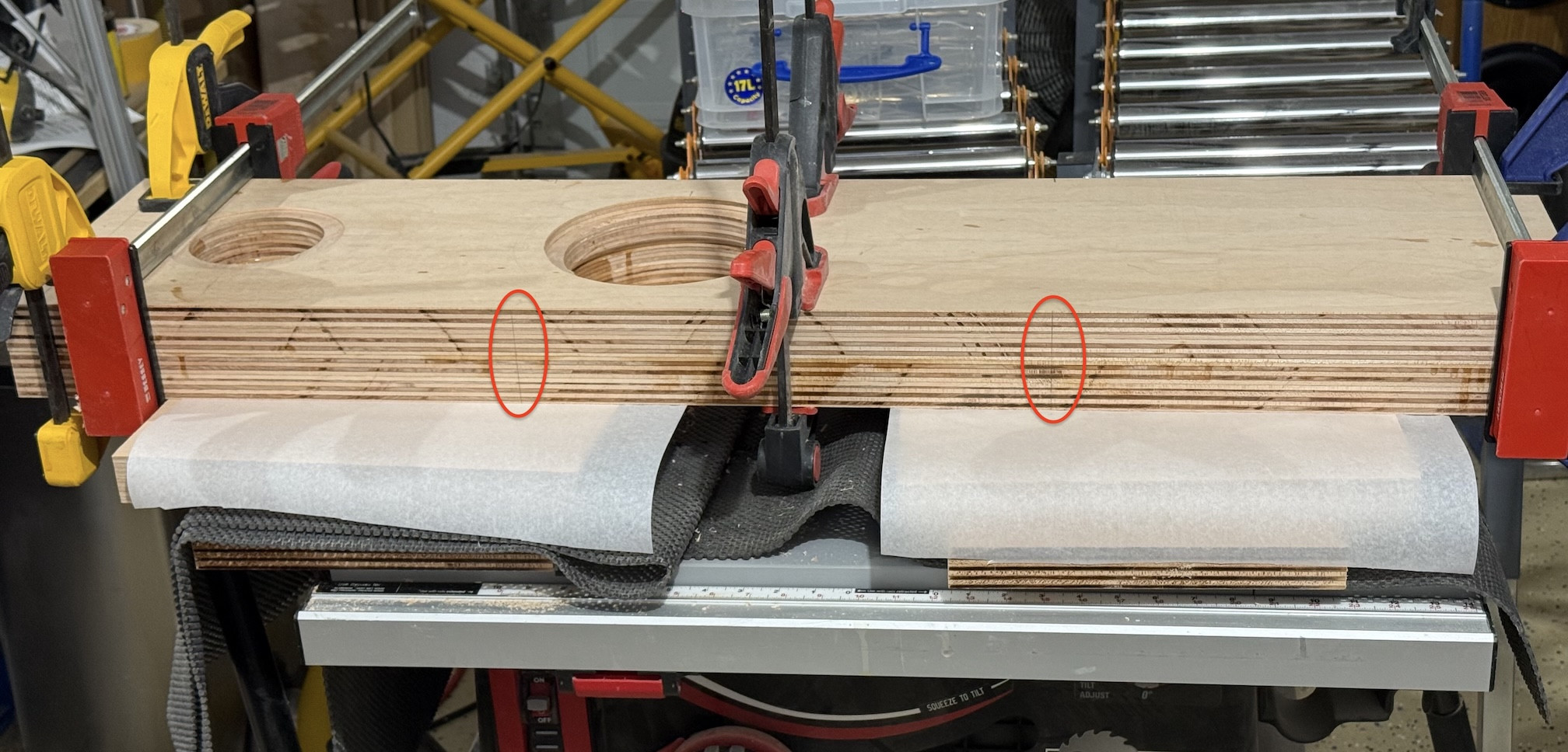

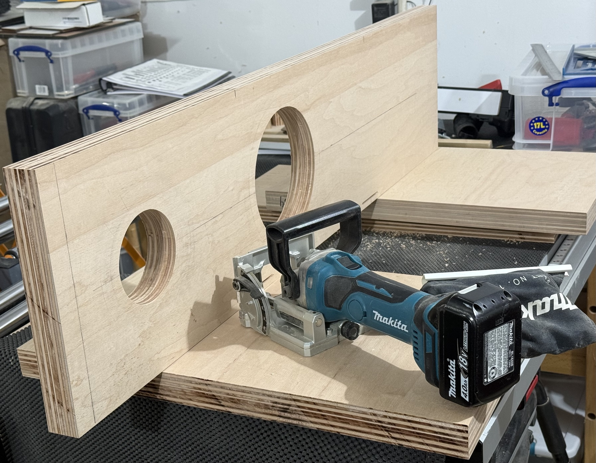

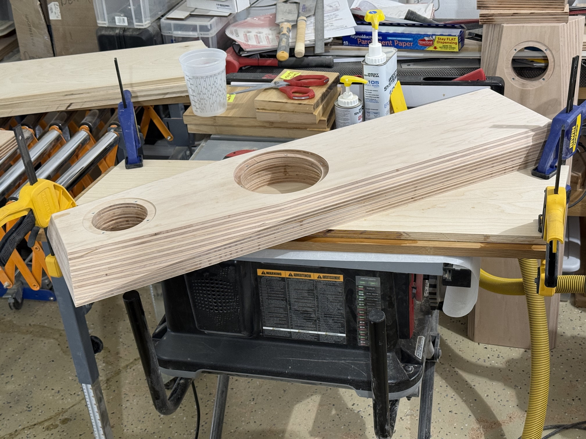

                                  Getting ready for the glue up is pretty simple- I double check the routing alignment for the driver holes, and line that up for as close to perfection as I can get, sliding the panels slightly up or down if needed.
                                  Then, I draw marking guides using a 90 degree angle guide in two spots on the sides, just like for the Ardent D builds- in this case, 14" from the top and 14" from the bottom.
                                  Aligning on these marks will provide a high degree of precision when gluing the inner and outer panels together.
                                  This operation is obviously done in pairs, for the panels that will be glued together.
                                  Then, I use the Makita biscuit joiner to cut slots for the #20 Plate Joiner biscuits I'm using, which will provide the "gross" side to side alignment during assembly. Then using a typical Ace Hardware 1 qt mixing container I combine three shots each of System West 105 resin and 206 hardener (very slow setting, don't need to get in a rush here) and coat the upper side of the inner panel, insert the biscuit joiner plates, and then the outer front panel.
                                  Note, this assembly operation should be supported off your work bench or work table by at least 3" or more; I use a couple of spare cut off piecers of the 1-1/2" maple ply. Then, the inner and outer pieces are aligned on the previous marks, and first I snug up the pair of side to side Bessey clamps, then use three pairs of smaller caps to provide compression of the glue joint.
Name:	Panels Glued Parchment Paper.jpg
                                  Note the ovals I've added to the picture highlighting the alignment of the alignment marks! This is getting assembly repetition on the order of 1/100th of an inch, which is pretty reasonable for manual operations.
                                  This resin and hardener combination takes about 24 hours to fully set.

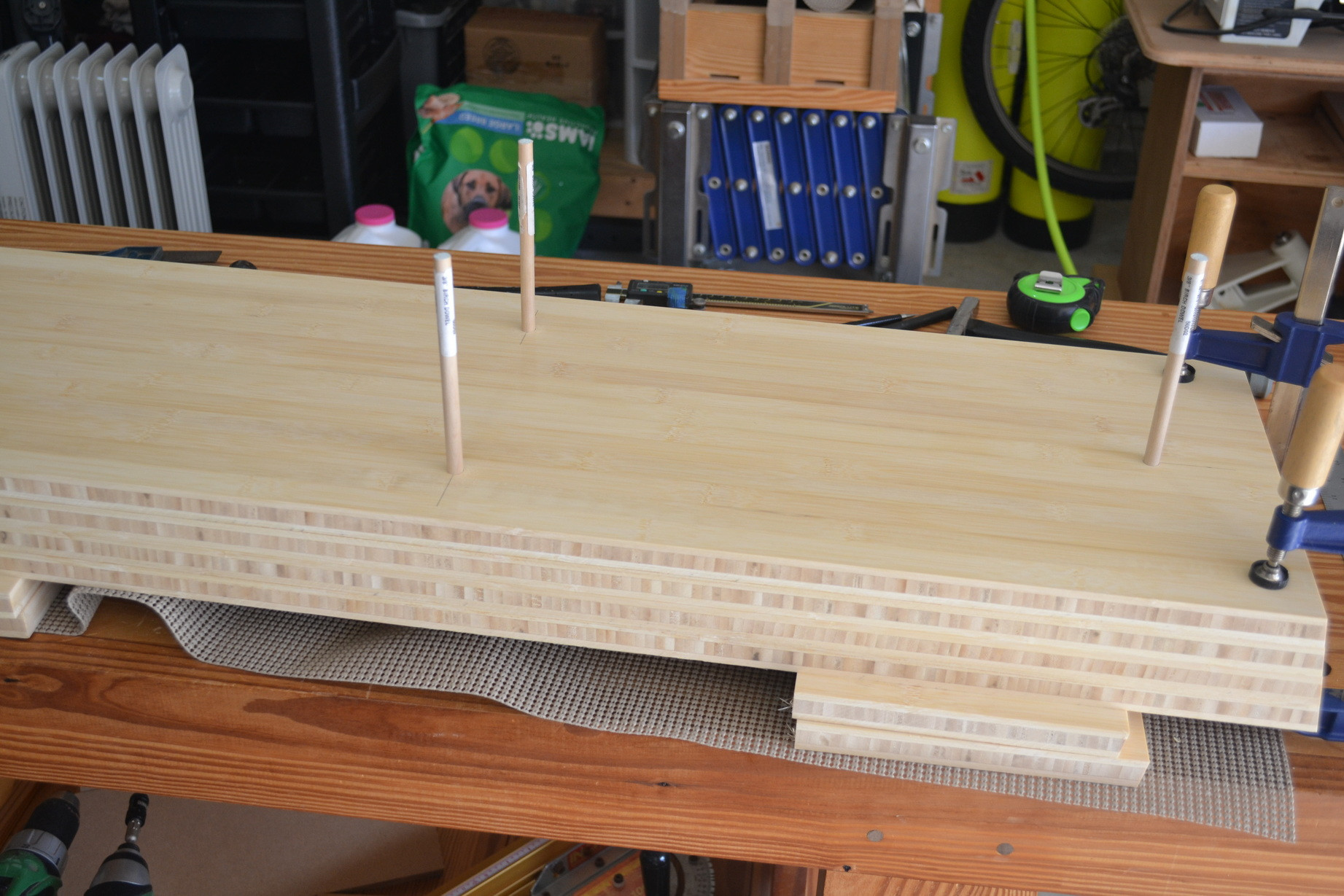

                                    • 2140
                                    Another option for baffle layer alignment .....
                                    I use three or four dowels which keeps alignment in both X & Y planes.
                                      • 16175
                                      Very good Steve!
                                      OTOH, I don't have CNC for doing some of the detail work, and after all, I'm just the wires and sparks guy...
                                      I did try dowels in one form of the TPL75 module for the Saint-Säens, but needed to use Forstner bits to get a clean precise path for them. With my limited toolsets, my path for this kind of build has been to get the interior stuff done as accurately as feasible, then do the facet and outer cuts.
                                      Now, if only I'd had the money and a place to put large workshop like yours here on this suburban Middleton property! (well, could have used the main part of the backyard, but wife would have had a hissy fit... HOA probably too!
                                      But these may be useful hints for the guys interested in building this, and relying on friends or relatives to do the woodworking...
                                      Now, it's time for me to go assemble the 2nd main front panel pieces!

                                            Now, this is the "Official" update to "something borrowed and something blue"...

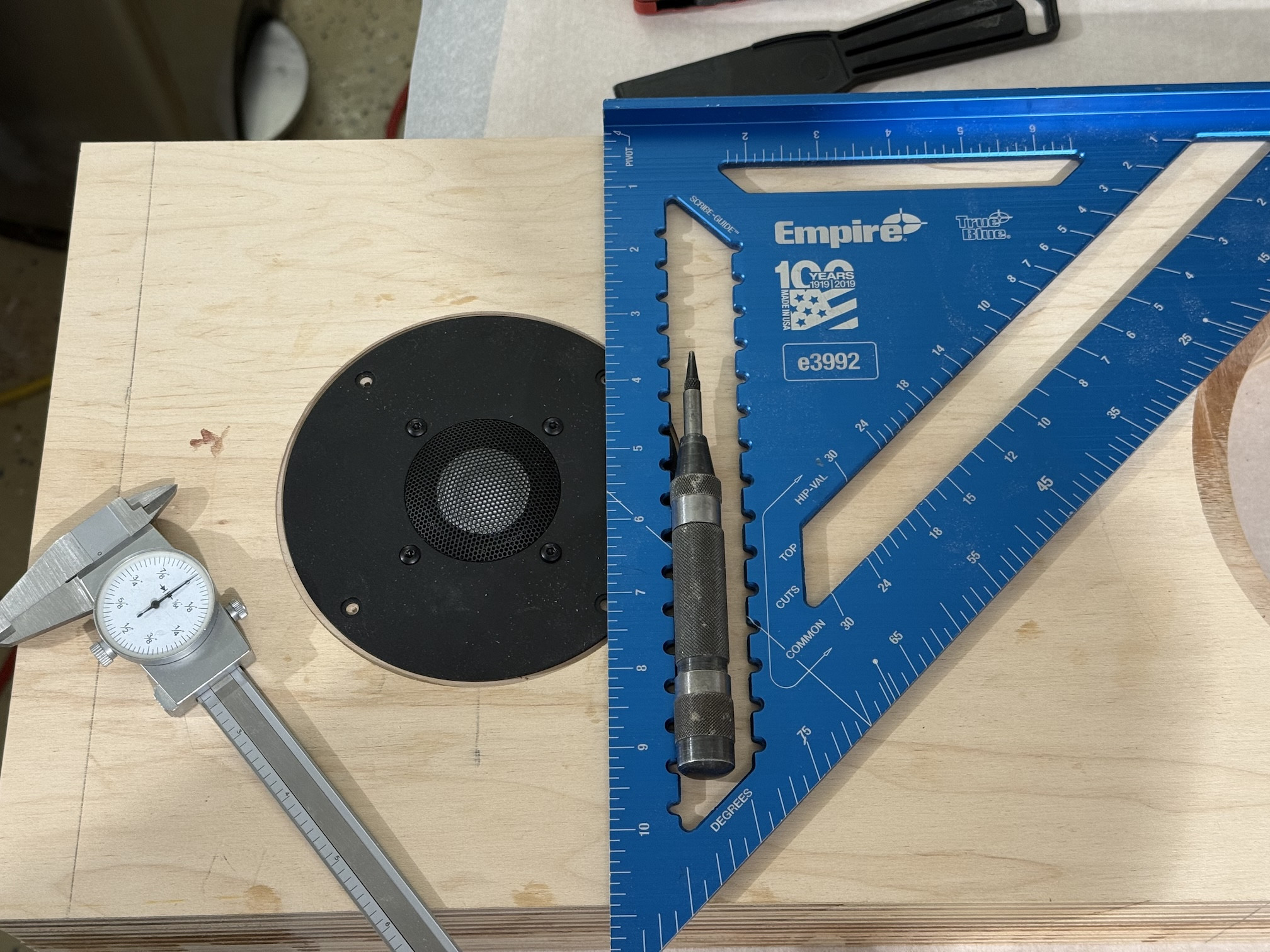

                                            Or, more to the point, it's just how I locate the locations for installing the inserts, without using a data sheet for the driver, by using simple geometric construction and an angle square.
                                            Click image for larger version  Name:	Tweeter Inserts Geometry.jpg Views:	47 Size:	748.6 KB ID:	961247
                                            Did the woofers the same way, and if it wasn't getting so hot already and I got up early to go pickup wife from the Boise Airport, I'd be installing the inserts next.
                                            But, given that it IS Sunday, I'm going to try buying into that whole Sunday day of rest thing a little bit, even if it's only going to work out to 1/3 of a day of rest! At least it won't be a Monday Sunday like it often has been lately...
                                            OH, and something I didn't explicitly explain- The hole punch? This is a spring loaded push to punch version, it's probably the oldest tool I have, dating back to electronics work in the 70's.
                                            In regards to locating and drilling holes for driver inserts, I place the driver exactly where I want it, centered in the routing, then for each hole, push the punch three times until the spring loaded punch "punches". This creates a sharply defined indentation which the tip of the drilling bit is seated in, before drilling.
                                            I take this procedure for granted, but I should have enumerated it, for those not exposed to the idea before.

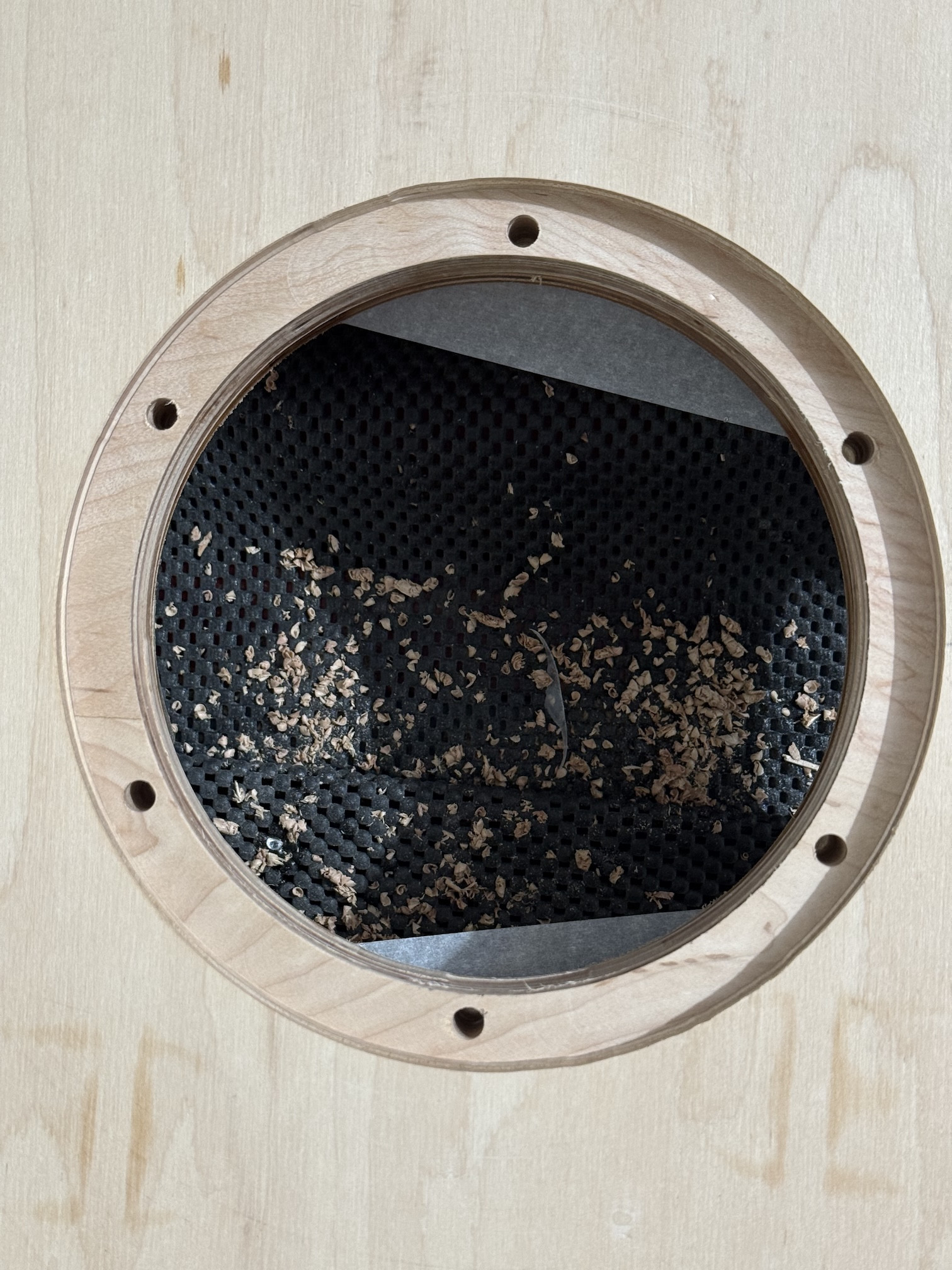

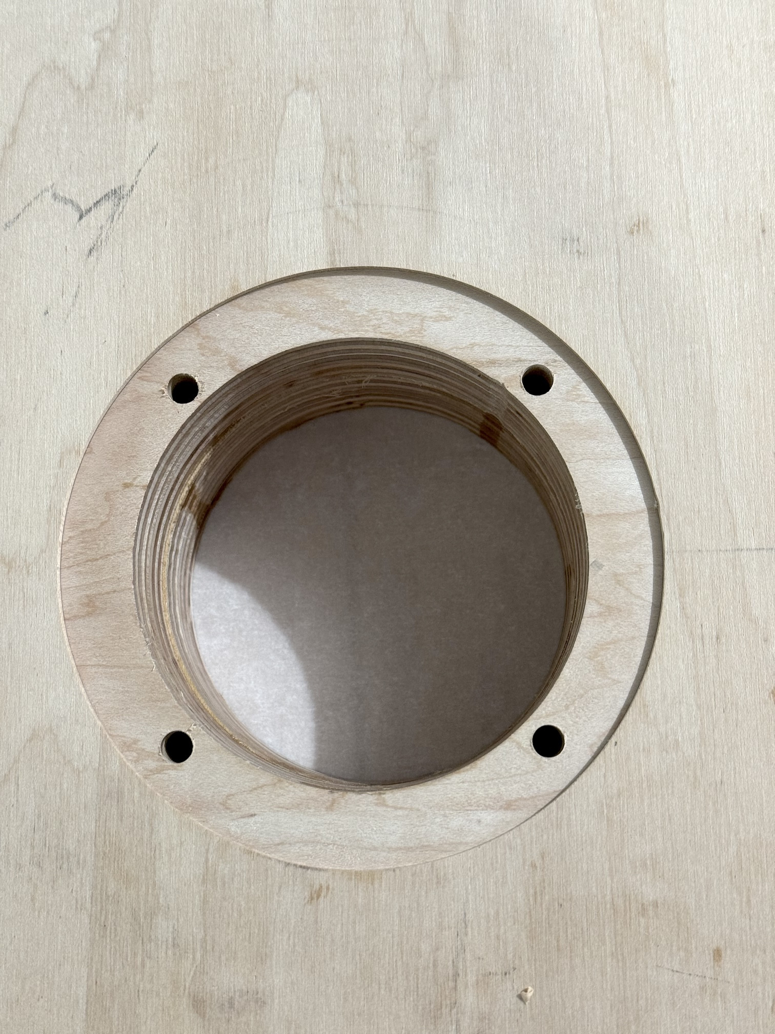

                                                  • 16175

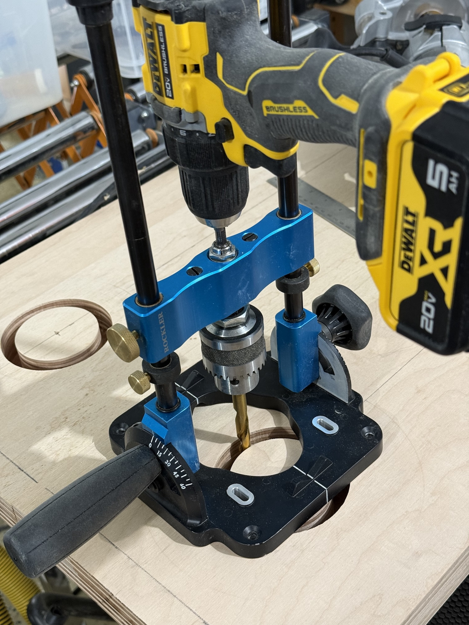

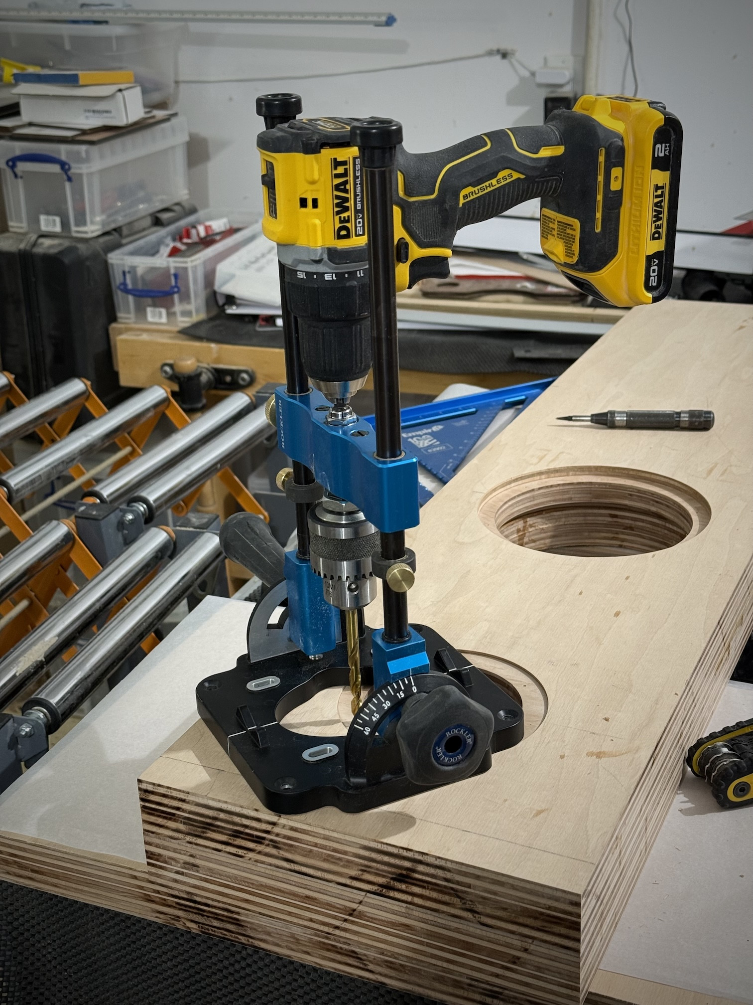

                                                  Well, I figure even though it could have been an afternoon of rest, why not get little more done?

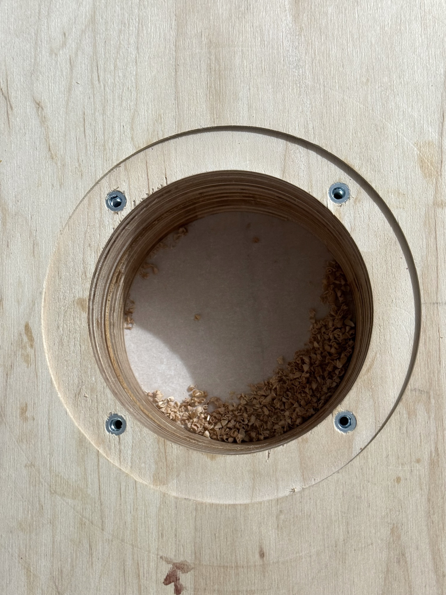

                                                  Next task is pilot holes for threaded inserts and installation- I'll be lazy and just do the ones for the tweeters...
                                                  Click image for larger version  Name:	Dril Guide Setup.jpg Views:	0 Size:	723.9 KB ID:	961253
                                                  This is my favorite combo for this task- the DeWalt DCD794 is (IMO) an excellent compact drill; very small front to back without compromising the chuck drive functionality, several battery sizes available, and a very good speed control range on the trigger, easy to control through a wide range. And did I mention it's small and relatively light?
                                                  With the dual adjustable stops for the drill plunge depth, it's easy to setup this fixture for consistent results without guesswork.
                                                  Here we see the results for the driving the DA32TX tweeter mounting inserts...
                                                  Click image for larger version  Name:	Insert Hole Set DA32TX.jpg Views:	0 Size:	785.4 KB ID:	961254

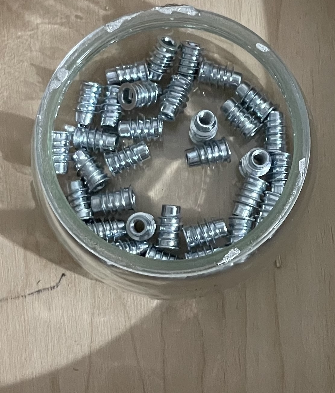

                                                  These are 9/32" diameter holes for the Rampa M4 8 x 12 mm inserts I'm use frequently.
                                                  Click image for larger version  Name:	5_Rampa M4 Inserts.jpg Views:	0 Size:	361.7 KB ID:	961255

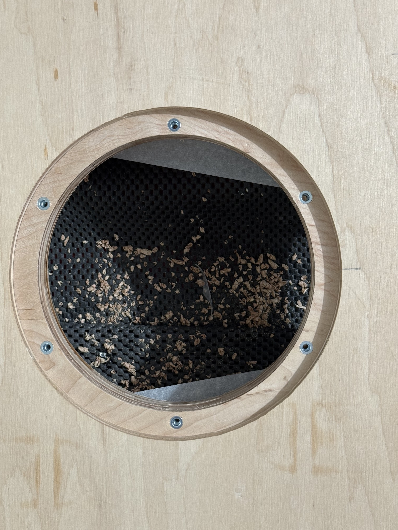

                                                  I've tried and used many brands of threaded inserts over the decades, but these are my favorites for several reasons:
                                                  • Quality and strength of steel base material and plating
                                                  • Excellent thread design, easy to start straight and install using a 4 mm Hex tool
                                                  • Many thread sizes, including many metric sizes that I favor of late working with European design drivers, like M4 and M6.
Name:	Inserts Installed.jpg
                                                    • 16175
                                                    And now both of the MW19TX-08 woofer insert mounting holes and inserts have been installed.
Name:	MW19TX Holes.jpg
Name:	MW19TX Inserts.jpg
                                                    Next up will be a light sanding and leveling of the sides, then the front panel outside bevel cuts.

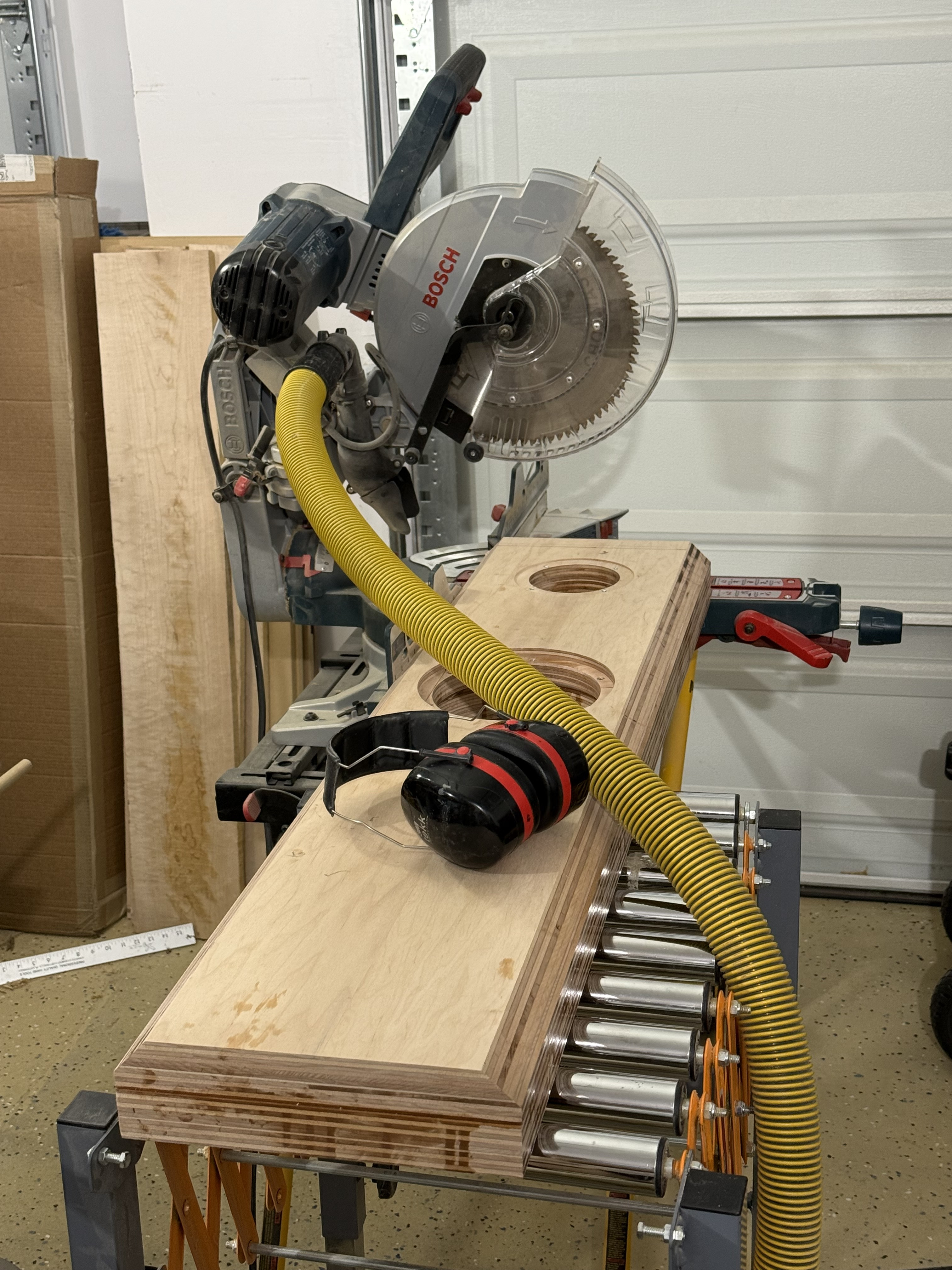

                                                      • 16175
                                                      The AQI and high temperatures are not making progress on this particularly easy...
                                                      But now things have moved over to the Bosch dual bevel sliding miter saw, to work up the more complex parts of the front panel.
Name:	Setup for T & B Bevels.jpg
                                                      Setup just takes a little extra room to support the long front panels; first task at hand is cutting the upper and lower end bevels. The laser guide I have installed on my Bosch makes precision checking of the cut BEFORE the blade contacts wood a lot more practical- pretty essential for this wires and sparks kind of guy! But it's hard for just one person to take a picture of it in action, because it turns on and off depending on whether the blade is rotating.
Name:	Laser Guide.jpg
                                                      With the ATB Forrester blade I use, the cuts are literally glass smooth in wood like this. To give you an idea, the Nampa cop that lives across the street wondered if I could cut some target posts for him, which they use at the Nampa police shooting range. He had the raw small posts... I cut them to the heights he needed, and he couldn't believe how smooth the end cuts were compared with what they are used to seeing...
                                                      Here we have both front panels with the top and bottom 10 degree bevel cuts at the right positions for the overall 40" height.
Name:	T & B cut.jpg
                                                      If all goes according to plan, and I have the garage cooled down enough to work for a few hours, all the top and bottom bevel cuts should get done today....
                                                      that will be followed by initial finish sanding.

                                                        Hey Boss Man ..... Despite being nice a crisp, I'm noticing a fair bit of burning on those cuts. I don't know how old your blade is? Could be time for a sharpen, or evaluate the speed of your cut, might be too slow?
                                                        • Scareurpasenger
                                                          Scareurpasenger commented
                                                          Editing a comment
                                                          Could it just need a cleaning?
                                                        • 16175

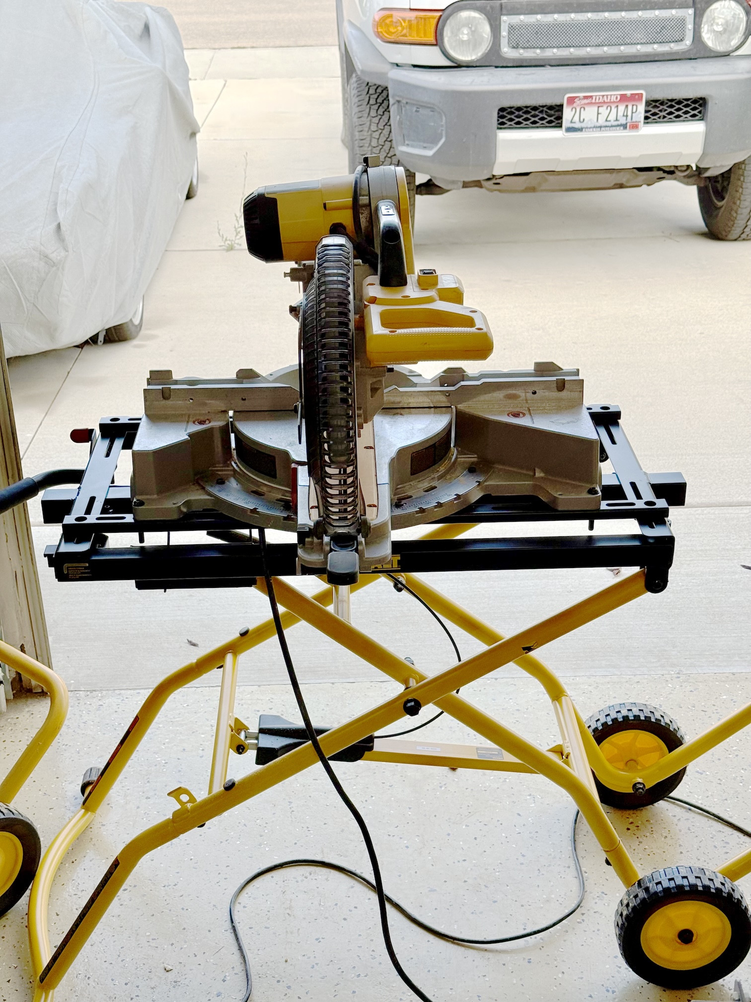

                                                        Yes, I agree- though not in the mood to replace a $250 blade, and though it feels sharp, and produces a glass like finish, it could also be that I'm not using an optimum feed rate. But then cutting through 3" is a bit tricky for us wires and sparks guys...
                                                        I've brought in the DeWalt DWS780 saw, too for the front bevels- and simply popped for a new blade for it. Also a new stand, as the Bosch is on the original stand. It's rather different to setup than the Bosch, but can handle thicker materials at extreme bevels.
                                                          • 16175

                                                            One comment, for anyone that hasn't worked with the DeWalt DTS780, you really need three hands or a helper remove or install a blade, given the blade drive shaft lock, holding the blade guard in the right position, and placing or tightening/un-tightening the blade screw after positioning and installing the end mount hardware. Fortunately ET was stopping by, curious what nonsense was delaying my work on the Saint-Saëns planar, and lent a "Force hold" to get me by on the assembly.
                                                            Reminds me of why I bought the Bosch saw.
                                                              JonMarsh commented
                                                              Editing a comment
                                                              Now I just have to wait for delivery tomorrow of the new DeWalt saw stand- my original one is under the Bosch saw!
                                                              JonMarsh commented
                                                              Editing a comment
                                                              And the other thing I don't like about the DWS780 (a model still for sale) is the lack of soft start. It's a bit rough around the edges, sort of like me...

                                                                FINALLY!
                                                                Promised myself I would finish putting the stand together and getting the old DeWalt DWS780 mounted BEFORE I took my morning walk, which meant getting up early and getting started after a fast breakfast.
                                                                And the printed manual that came with it had shading inside the circles with the part identifier numbers that was so dark one couldn't read the numbers clearly the way it was printed. Download PDF, export pages to JPG, adjust lighting curve. Problem solved.
Name:	DSW780 Mounted.jpg

                                                                  Well folks, I think I'm going to go back and inject some Hales Concept 2 DNA into this build...
                                                                  In case anyone needs a refresher on the Concept 2, voila!
                                                                  What is notable here, is that cabinet facets of a sort (rounded in this case) are only on the top side...
                                                                  Where they're needed for acoustic reasons; putting them on the bottom as is done with many designs is mainly an esthetic embellishment.
                                                                  One that takes a bit of work!!!
                                                                  So, we have a tentative engineering update on the build in process, mainly to save me a significant bit of labor!
Name:	Front Panel Sand bevels.jpg

                                                                  • To complete the facet cuts, I usually use a Japanese hand saw- but this week I spotted something interesting at my local Ace Hardware, a double edge DeWalt copy of the Japanese hand saw concept! Two different tool size options to use... it worked out pretty well, it's well made, and the replacement blades are available. Oddly, it's not very readily available on Amazon, compared to many other DeWalt products
                                                                  • If you look closely in the picture in the previous post, you might notice my Festool orbital sander on the table next to the example front panel, and the dust collection vac with suction hose is peeking out a bit in the far lower right. Managing the sanding, especially on this hard rock maple ply, requires a good orbital sander; traditionally I have used DeWalt and Makita models, with Mirka Abranet sanding disks, and those are pretty good for "conventional" tools. You may already have your favorites. As I related in a post in the Saint-Saëns planar thread, I finally got the Festool one I ordered in 2018 but didn't receive until 2019 setup properly, buying the base model automatic suction vac (AC for the orbital plugs into the vac, turning it's fan system on and off depending on whether the orbital is turned on, and it's my new champ.
                                                                  • Reviewing my wood stock on hand, and the limited amount of 1/2" BB ply compared to 3/4" BB ply (I bought loads when Ukraine was invaded, figuring correctly that the war might cause supply issues for genuine Baltic Birch ply, so I'm probably going to change the inner liner on the sidewalls to 3/4".
                                                                  • Another admission to make- I have had on hand a package of my favorite bamboo boards from Woodworkers source for about a year- cutting the side walls is going to be Eazy-Peazy because the design width of those walls is the same as the actual manufactured width of the bamboo boards. So, less ripping to do...
                                                                  Happy Sunday Funday!
                                                                  • Scareurpasenger
                                                                    Editing a comment
                                                                    I love seeing some of the mainstream manufacturers providing the Japanese pull saws. I bought a folding Jorgensen saw and was very impressed by the quality for the price.
                                                                    JonMarsh commented
                                                                    Editing a comment
                                                                    I saw the Jorgensen saw online at Amazon, when I looked for pictures of the DeWalt- looks pretty nice! - but I don't think they have it at Ace Hardware. And that's just a mile and a half away from me, so I spend more time in there than the grocery store!

                                                                  Most of the panel parts for the enclosure have been cut now; there are some ongoing dimensional and design adjustments, nothing particularly major. Things like the inner side walls now being 3/4" instead of 1/2", since I have so much of the 3/4" on hand!
                                                                  Also, some tweaks to internal panel parts in consideration of that, and also simplifying the front to rear bracing. (I dug out some 7/8" bamboo ply and some interior bits have now been fabricated with that- drawings to be updated after the first enclosure goes together).
                                                                  Here, you can see a fitment check for the right side outer panel (bamboo board) and inner panel (3/4" BB ply), plus the top piece panel which is 1-1/4" maple ply.
