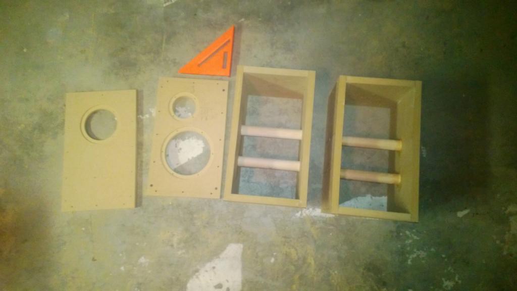

    The boxes

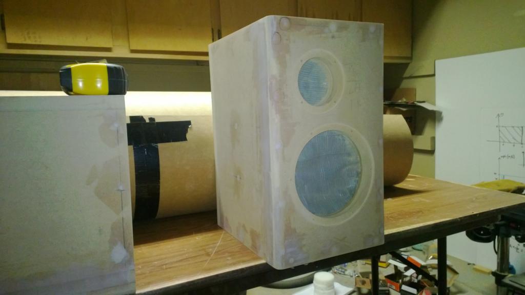

    Bondo-ed up

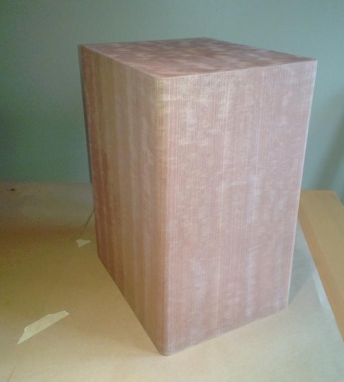

    Block Mottled Makore veneer

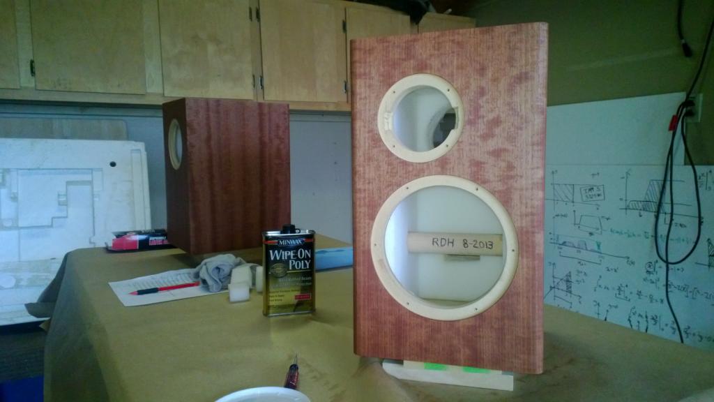

    Wipe-on Poly is amazing!

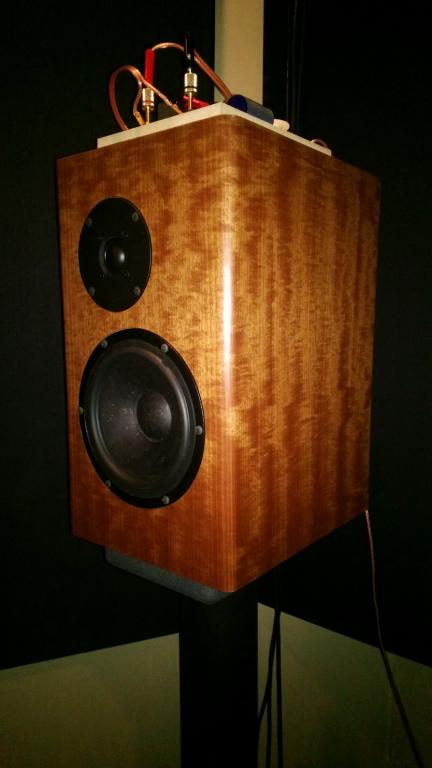

    Time to listen

    Looks great! I like that you dated and initialed the inside of the cabinet.
    -Chuck

      Thanks! It was amazing to see the pattern in the veneer pop out when the polyurethane went on.

              Now that I’ve spent some time listening, I feel I can give a fairly decent description of how my SR71 build is sounding.
              These speakers sound very clean, and they stay very clean even when playing loud. The high frequencies sound accurate and natural. I like hearing the stick sound on ride cymbals and I feel these reproduce it very nicely. The midrange doesn’t sound as effortless as I’d hoped for, but is still neutral in terms of tone. I think I’ll stuff the boxes a bit more and listen to what that does for the sound. I’m hoping this will help to improve the depth of the image as well. Now for the low frequencies; this is where the SR71’s really shine for me. Of the other designs I’ve built, none have been so well controlled, tight and dynamic in the low end. The response very even (no dead notes or suddenly loud notes in bass lines); and I’m able to leave the sub turned off without feeling like I’m missing anything.
              I’d like to give a big THANKS to John "Zaph" Krutke for posting his SR71 design and everything else that’s on his website. I’ve had my eye on this design for a while and it’s finally here!
