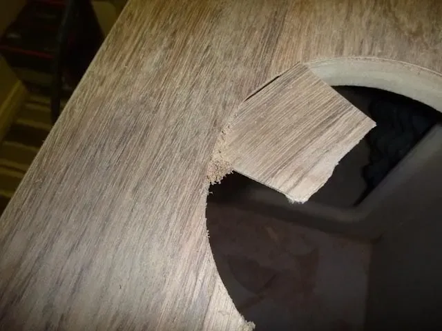

    Ok so my speakers have been veneered and I need to cut the holes nice and smooth.

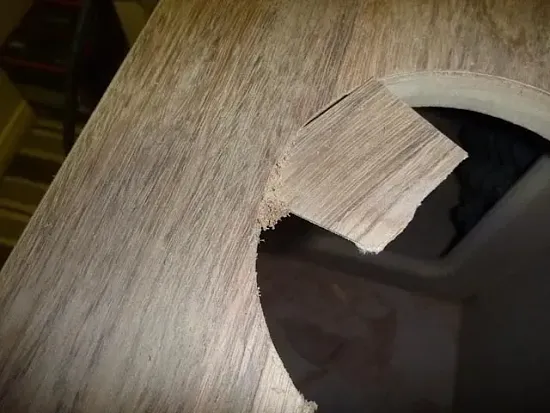

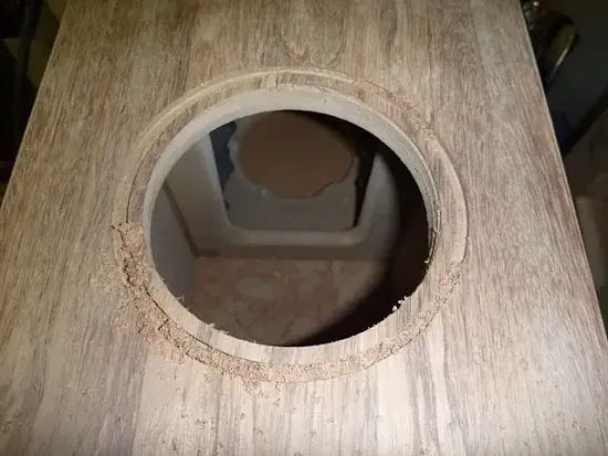

    First I make a rough cut inside the hole somewhere. I used to make a nice neat hole as a starting point to reduce routing, but I discovered it was unnecessary.
    (If your veneer chips or splits easier you may need to cut closer)

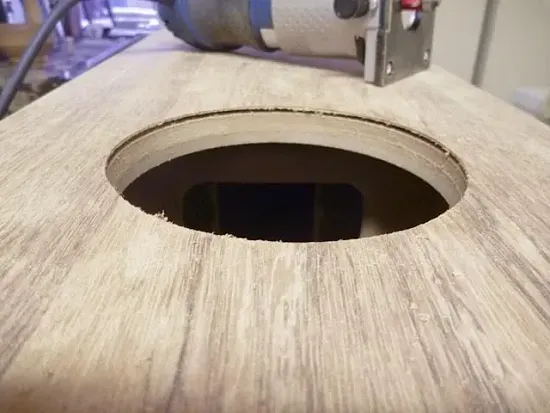

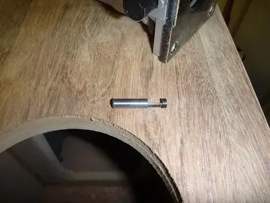

    I then use a standard flush trim bit to cut down to the hole. You could probabaly use the carbide bit but I want to save it just for the recesses

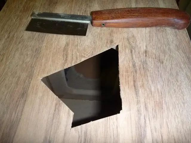

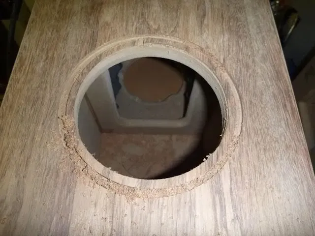

    This will get you to this

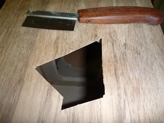

    From the initial cutting you could get a build up of dust in the gap so I scrape it out carefully

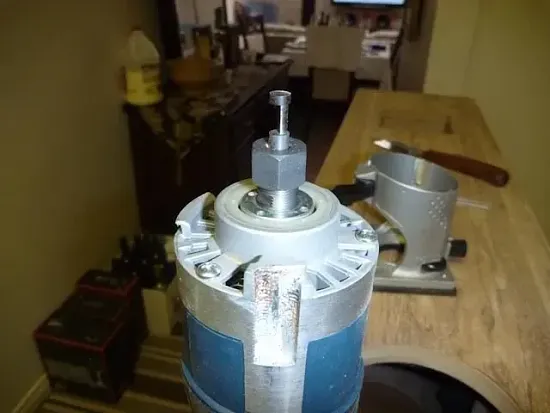

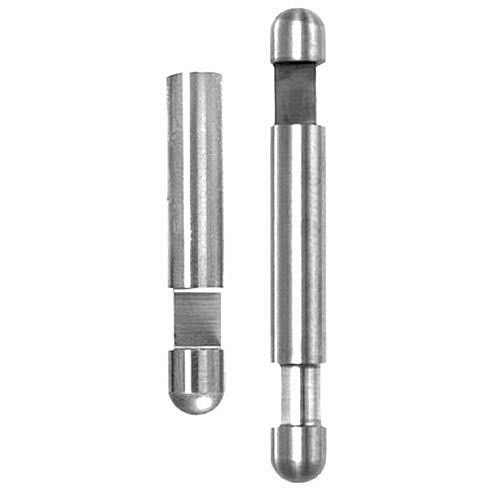

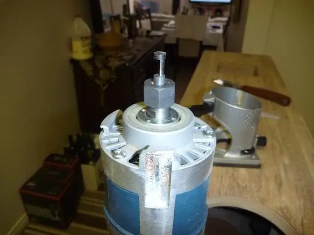

    You then need to switch to the modified solid carbide flush trim bit.
    The bit comes with a domed head, you are going to need to grind it flat, then remove some of the thickness of the bearing.

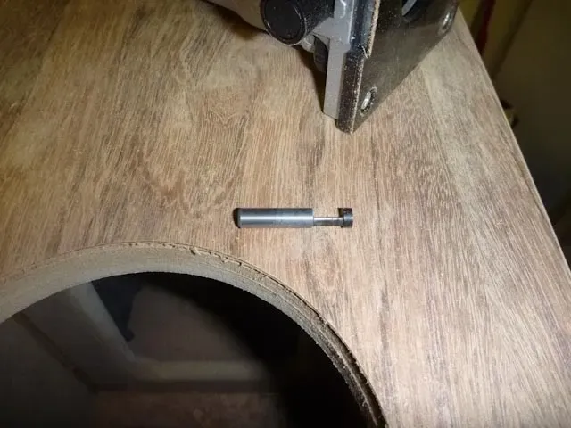

    How much? The bearing part needs to be slightly thinner than the shallowest recess you need to make.
    In my case the port flare was the shallowest so I left about 0.110". You do not need to measure it like I did, by eye is fine.
    Discaimer! Grinding tungsten carbide sucks! I replaced my wheel with a silicon carbide wheel (The Green one) to speed up the process, but it still took time.
    When you are done it should look like this

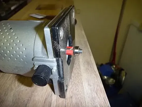

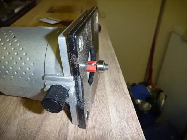

    You need to set your depth on the router so that the end of the bit does not hit the bottom of the recess. The bearing part needs to fit between the recess and the veneer. Mine was close but it worked fine.

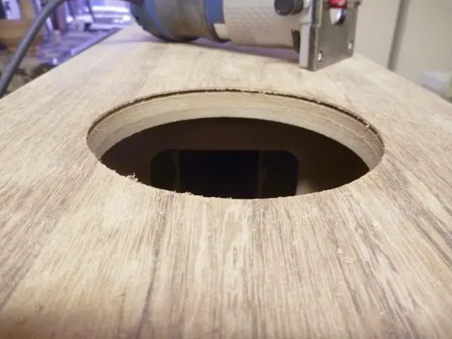

    Then all you need to do is run the router around the recess edge a quick sand and you are done!

      It would take less time to grind the bit if you started off with this one:

              Yeah, I don't know what kind of grinder you have, but I tried grinding down one of those carbide bits, and it just laughed at me.
              So I usually just use a very sharp knife and go slowly. It does work surprisingly well, in my experience. No power tools involved, though
