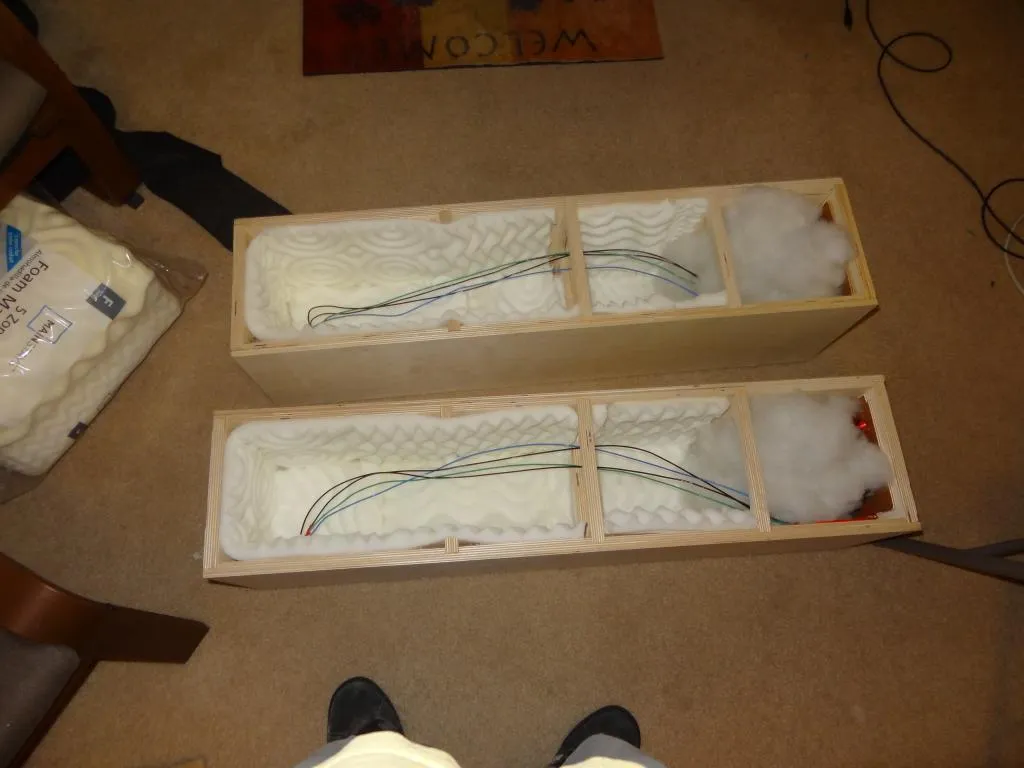

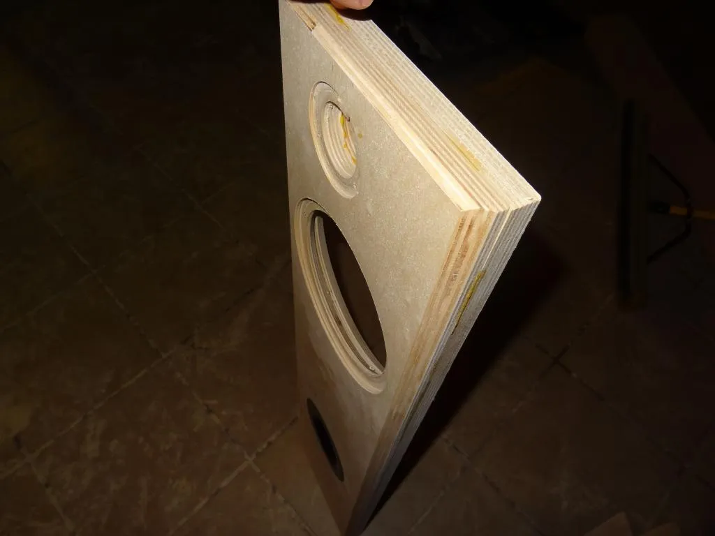

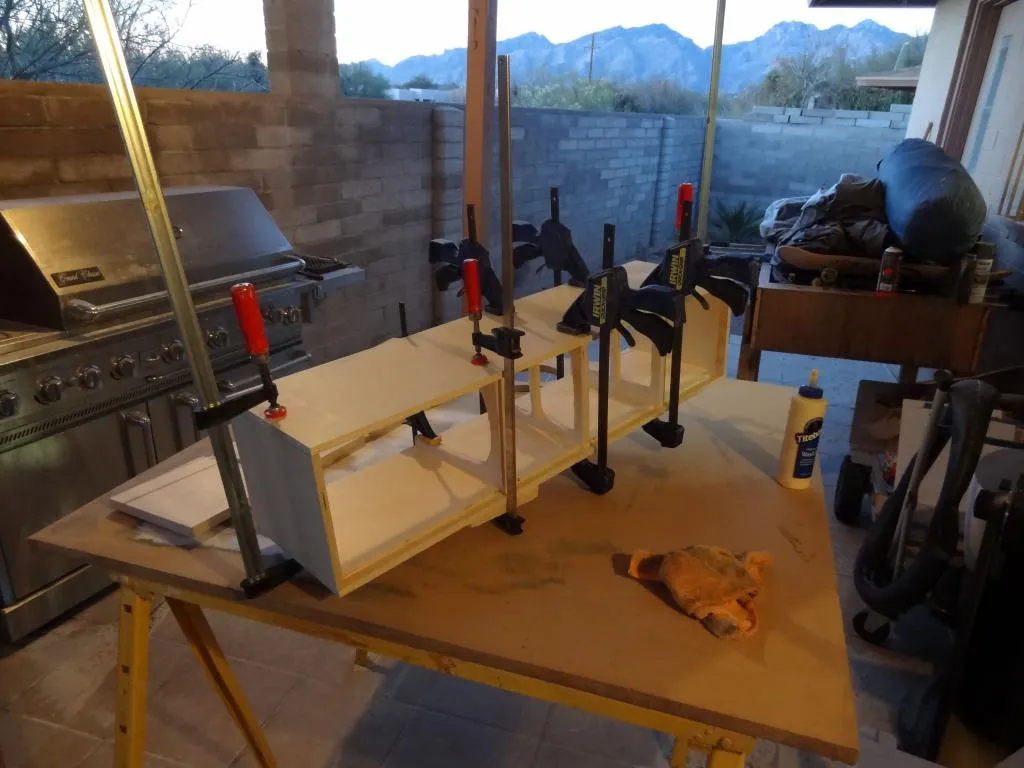

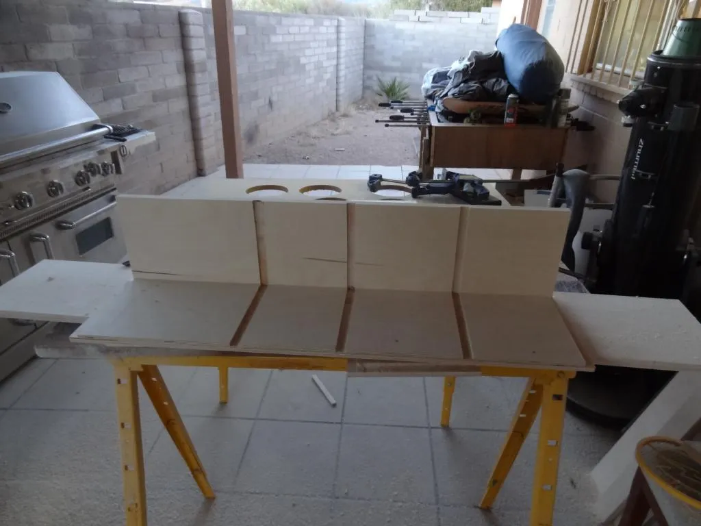

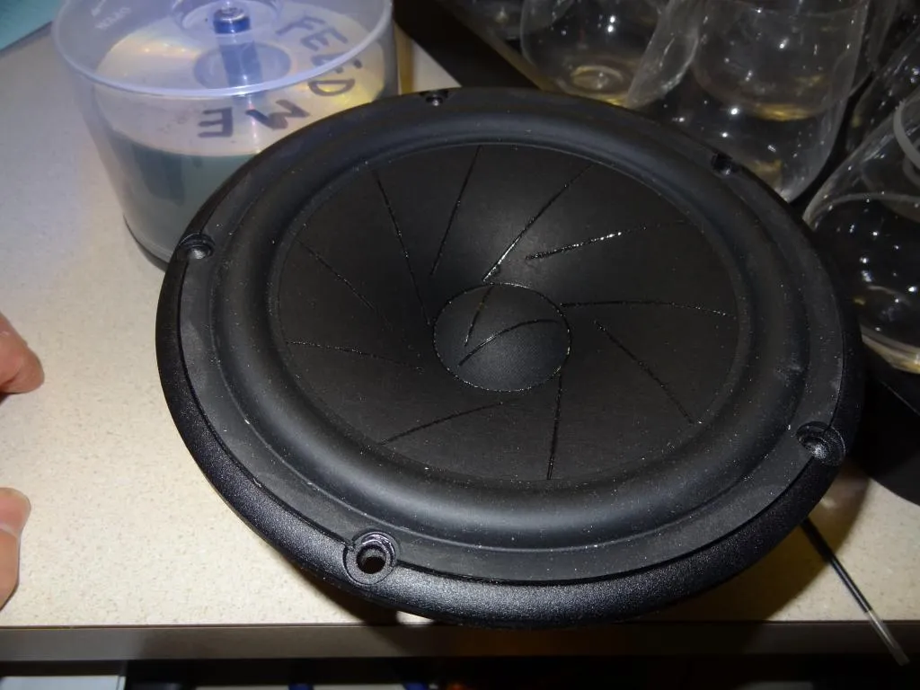

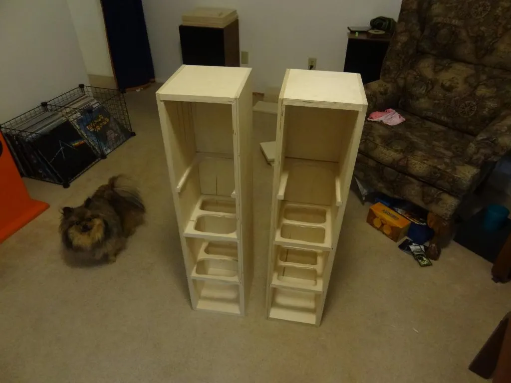

    I put Curt C's Invictus kit from meniscusaudio in a cabinet based off of the ZaphAudio ZRT.
    So it is a 3/4" Baltic birch cab approximately 38 Lt tuned to 30 hz with a 2" wide 5" long port. The Baffle is 1.5" thick

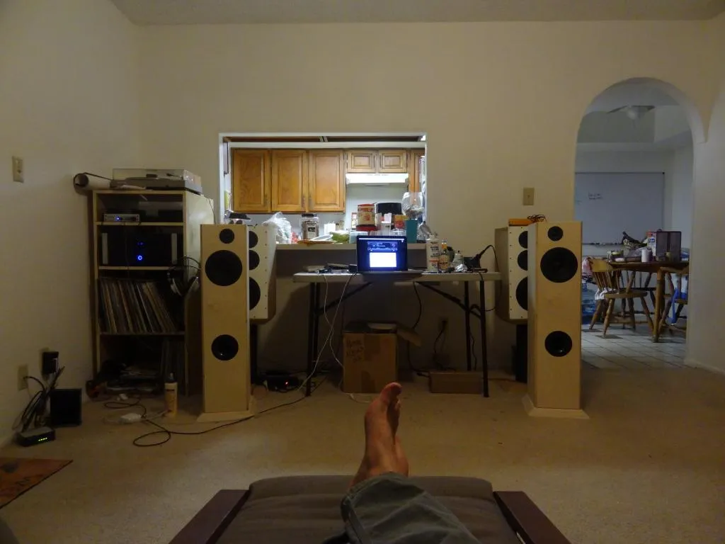

    They replaced Troels designed 3 way classics, and they are pretty much better in every way for my small listening room. Much better bass, equal mids, more detailed highs.
    Any questions or pic requests don't hesitate to ask

        Haven't you heard to improve imaging and soundstage, you should always wear socks.
        Birth of a Media Center
          • 16175
          Well, Pete, socks will lower the diffraction, for sure, but with bare feet you can tune the imaging better... :W
          • Riley212
            • Nov 2012
            • 9
            I like to feel the music in my soles
