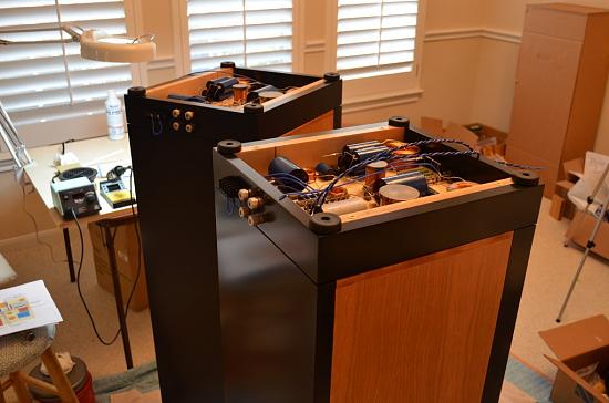

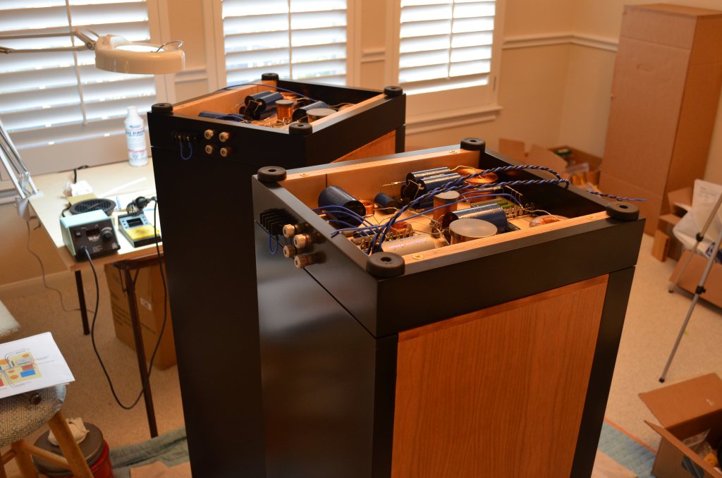

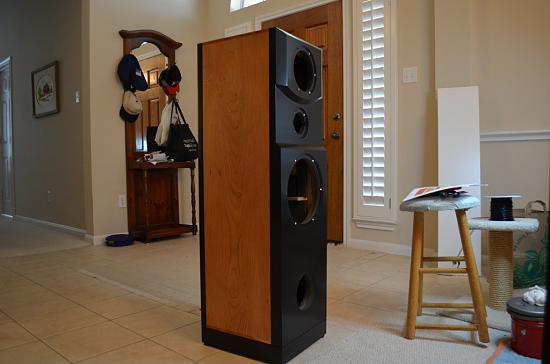

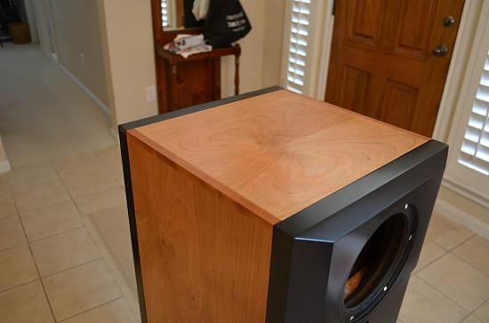

    ...and one more...
    It's starting to all come together :T

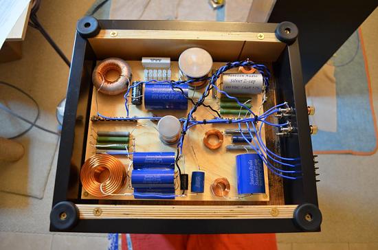

    Starting final wiring

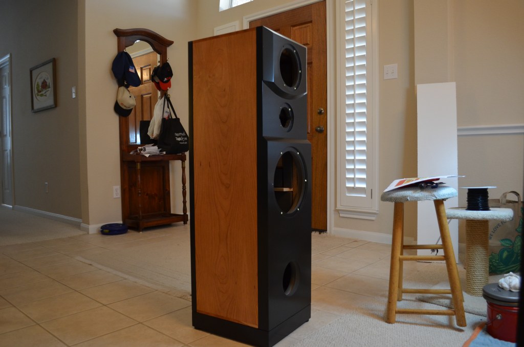

    Bottoms up :W

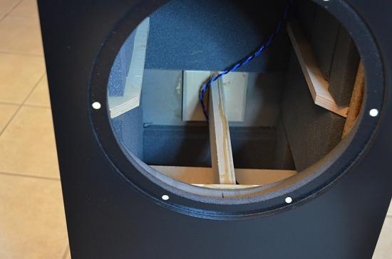

    Added front to back brace
    Full pic

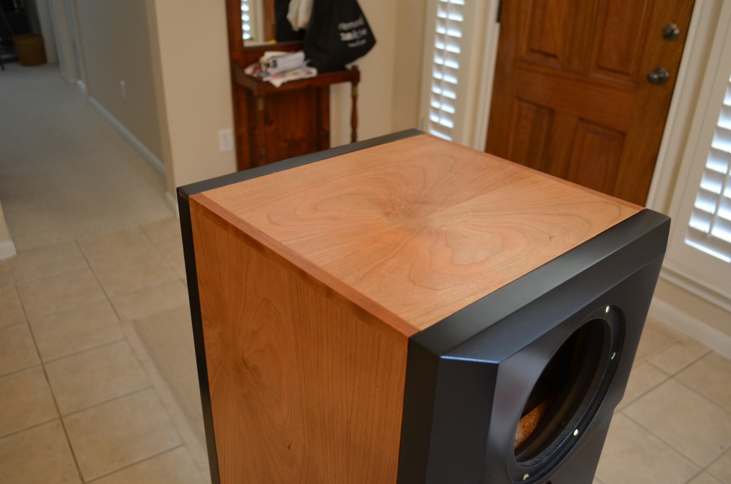

    Top shot

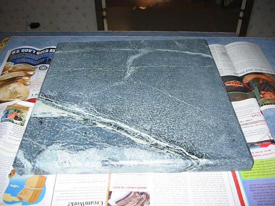

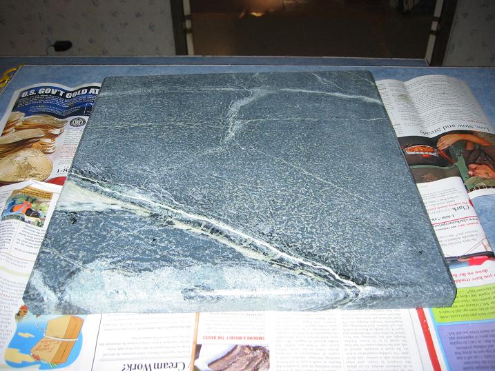

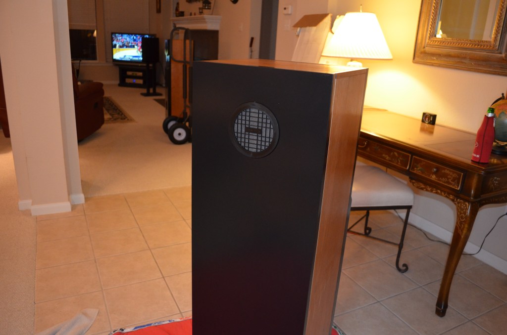

      ...and here is the slab of granite they will be standing on
Name:	100-0014_IMG very small.jpg

        Looking good!
        FYI, I have the same hand truck, but with roll bar padding on it. It's a little thicker.
          #94
          Those are looking really good, some excellent work there.
            • 16205
            #95
            Totally OCD and very good looking work! :T

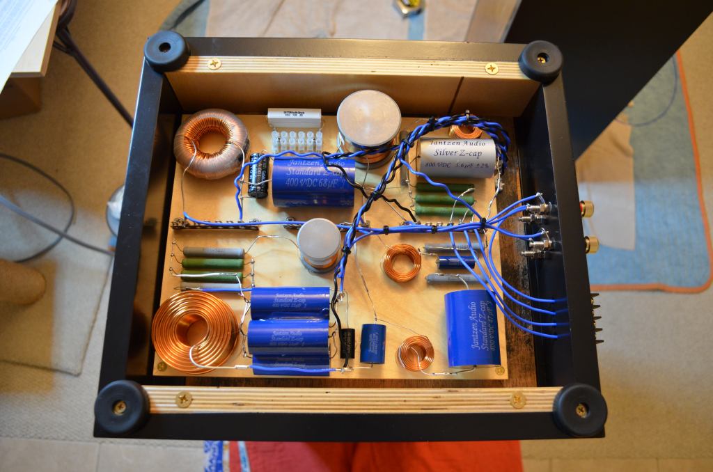

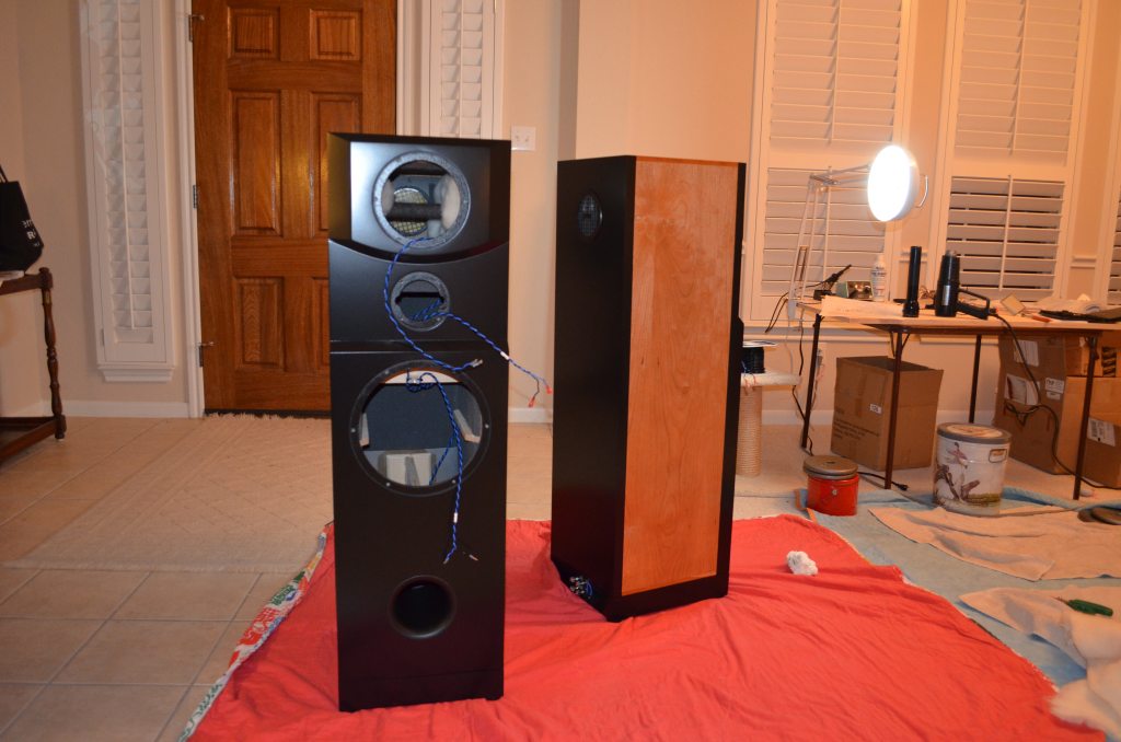

                                              #112
                                              Oh what a journey...

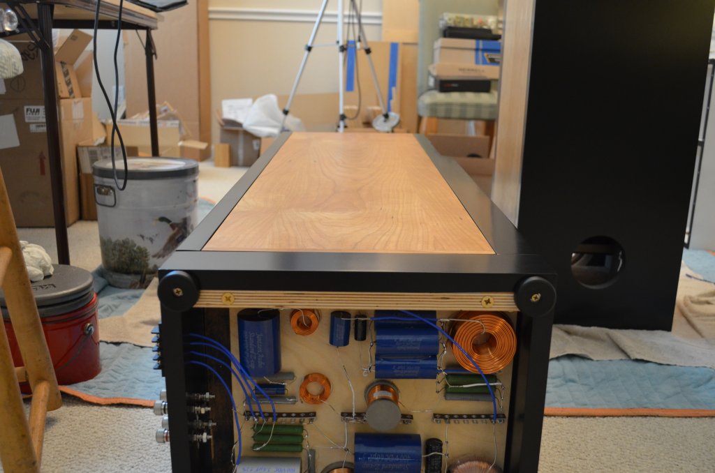

                                              Turns out I had available time this weekend to continue the build...I see why manufacturers charge so much 8O. We do have sound :T but first the steps that got me there...
                                              Final crossover wiring...oh and btw I will be adding a bottom cover. The components are pretty vulnerable...thanks Jim for giving me inspiration
                                              More wiring
                                              Mid aperiodic vent...dampens the mid resonance peak.

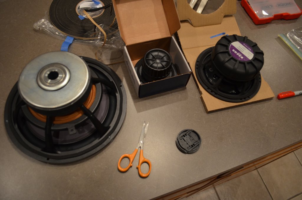

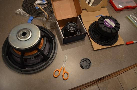

                                              Gasket for drivers

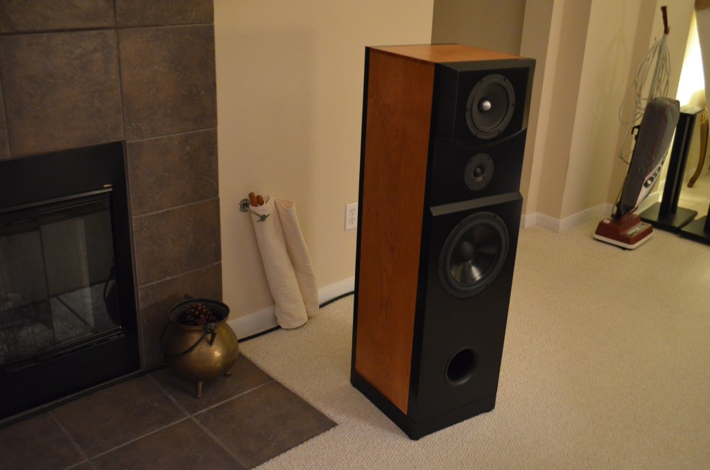

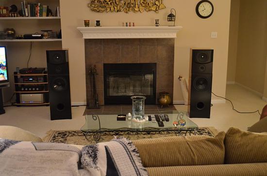

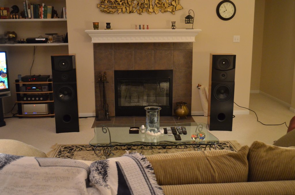

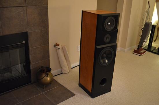

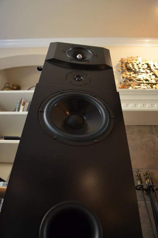

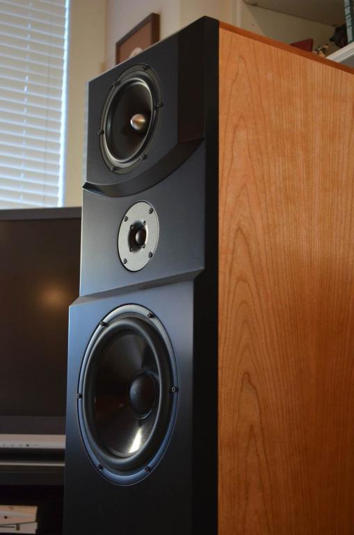

                                                #113
                                                At last...

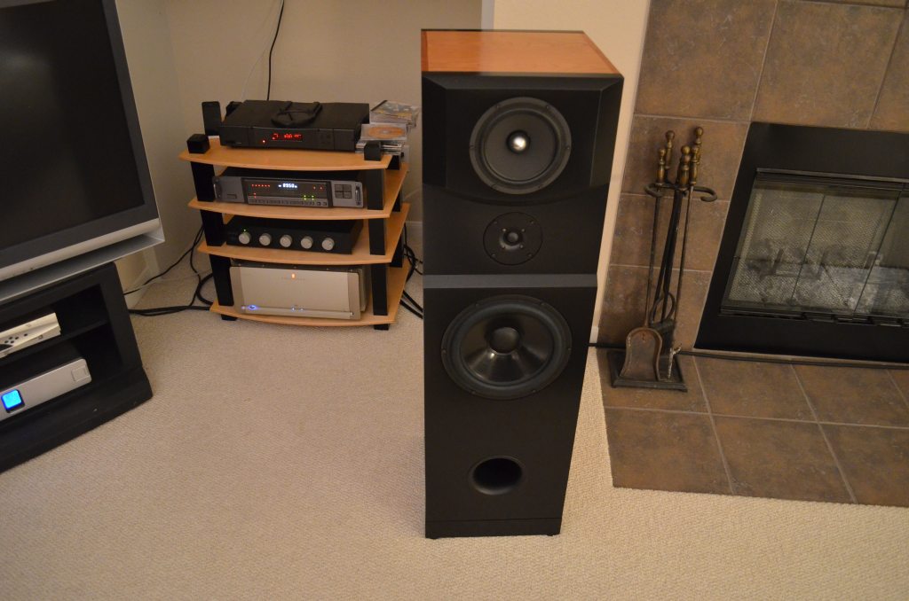

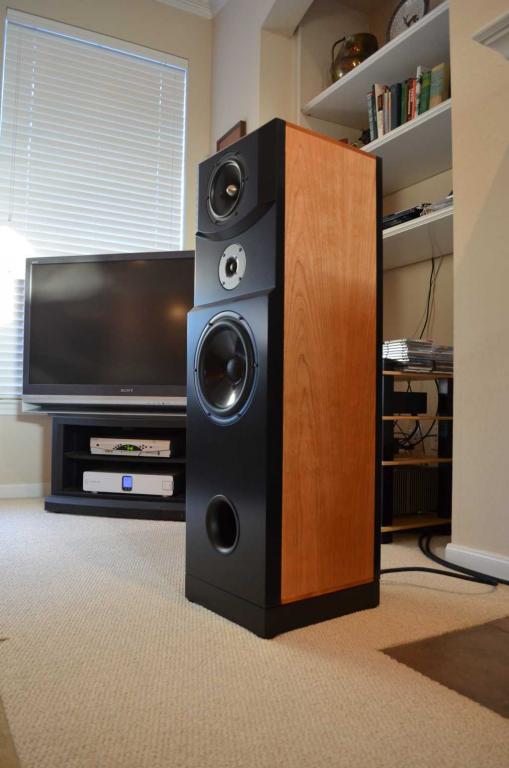

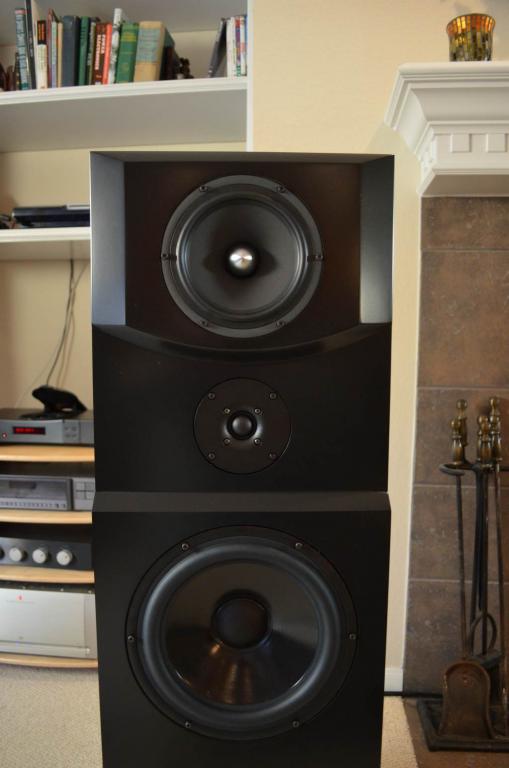

                                                Assembled and listening to music...:B. I've only listened to a few songs so far...they do sound very good. Nothing really stands out...neutral with good dynamics. No bloat at all on the bottom end...I may want to adjust the amount of stuffing to see what effect it has.
                                                One...
                                                The other...
                                                The pair

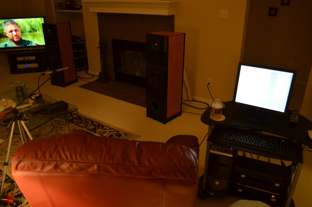

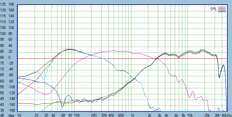

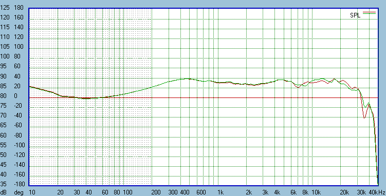

                                                  Testing...
                                                  I ran some tests to verify proper construction/operation. There were so many connections :E good to do a rough check...so don't take these results too seriously.
                                                  My bad pic of the test set up.

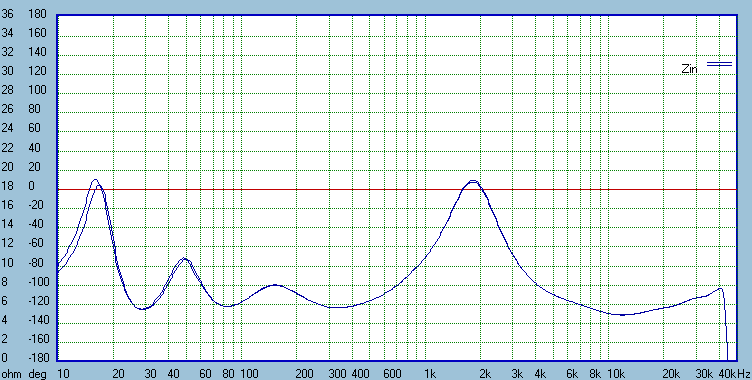

                                                  Impedance of both speakers.

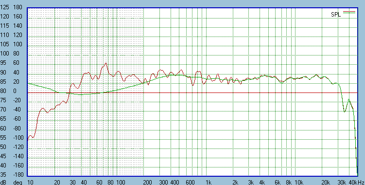

                                                  Frequency response at 1 meter, 5ms and 500ms windows.
                                                  Left and right, 5ms window.
                                                          Click image for larger version  Name:	DSC_0361_sm.jpg Views:	1966 Size:	94.5 KB ID:	858044
                                                          Click image for larger version  Name:	impedance_both.png Views:	1970 Size:	15.4 KB ID:	858045
                                                          Click image for larger version  Name:	spl_1m_5_500ms.png Views:	1967 Size:	18.4 KB ID:	858046
                                                          Click image for larger version  Name:	spl_1m_5ms_both.png Views:	1970 Size:	17.0 KB ID:	858047
                                                          BTW, what gating options does Soundeasy have these days, with regards to the window shape? Can you do a Half Hanning window? That's available in Praxis and Fuzzmeasure, and gives good results for low frequency data without cluttering up the midrange too much from early reflections.

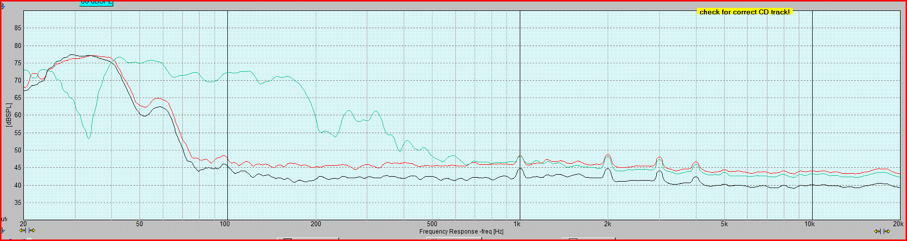

                                                              I did some experimenting today. I put the sub where the Jenzen will be and got the Green curve (crossed over at 180hz for this curve). Then put my sub in the back of the room where I intent to put it measured by the Red curve (crossed over at 40hz, its lowest setting). With the bass boost on (+6db @ 35hz) represented by the Black curve (took the liberty to match the output to the non-boosted response).
                                                              The sub is (2) AC-10 woofers in a 5.9 cu-ft vented box with a Dayton 250W plate amp.
                                                              The place in the back (rear sub) of the room is almost exactly the same distance behind the listening position as will be the Jenzens to the front (about 102").
                                                              I am hoping to augment or collapse that 33hz null (modal null caused by length dimension of room).
                                                              What do you guys think?
Name:	02 12 Sub at back and right and bass boost.GIF

                                                                  #122
                                                                  Originally posted by jim1961
                                                                  Bravo!
                                                                  Questions:
                                                                  Which tweeter slope is used for the graphs?
                                                                  Did you measure your Gemini's in the same way? Do you have those plots for comparison?
                                                                  Did you discover if you can do an ETC? It would be interesting to see what this looks like at your listening position. The FR at the listening position could be interesting also.
                                                                  If you can export your IR file as wav, I could import into REW here.
                                                                  It was the middle tweeter pad level.
                                                                  I didn't measure the Gemini's...I'll see what else I can do...very busy at work :x
                                                                    • 571
                                                                    #123
                                                                    I'll check when I get home...thanks for the suggestion!

                                                                              #128
                                                                              I checked last evening. SE has the following window choices; Hanning, Blackmon-Harris, Rectangular, Kaiser-Bessel and another type of Rectangular I don't recall right now. I was using the Blackmon-Harris...I tried all of them and really saw no appreciable difference. Do you see good improvement between the various windows?...your graphs usually look smoother than what I am able to measure. Other suggestions are surely welcome...

                                                                                  Thanks TacoD!
                                                                                  A little more testing...
                                                                                  I wanted to confirm the crossover points so I did some close mic testing.
Name:	spl close mic 2in.png

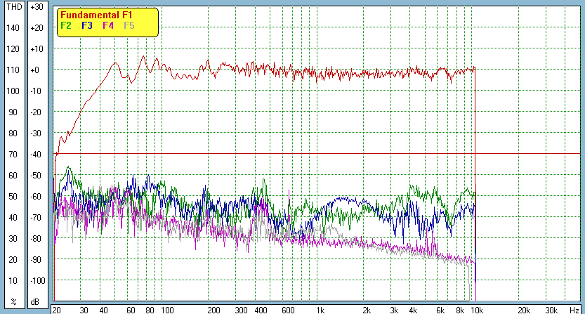

                                                                                  Distortion testing...no problems here. Distortion components below -50db:T

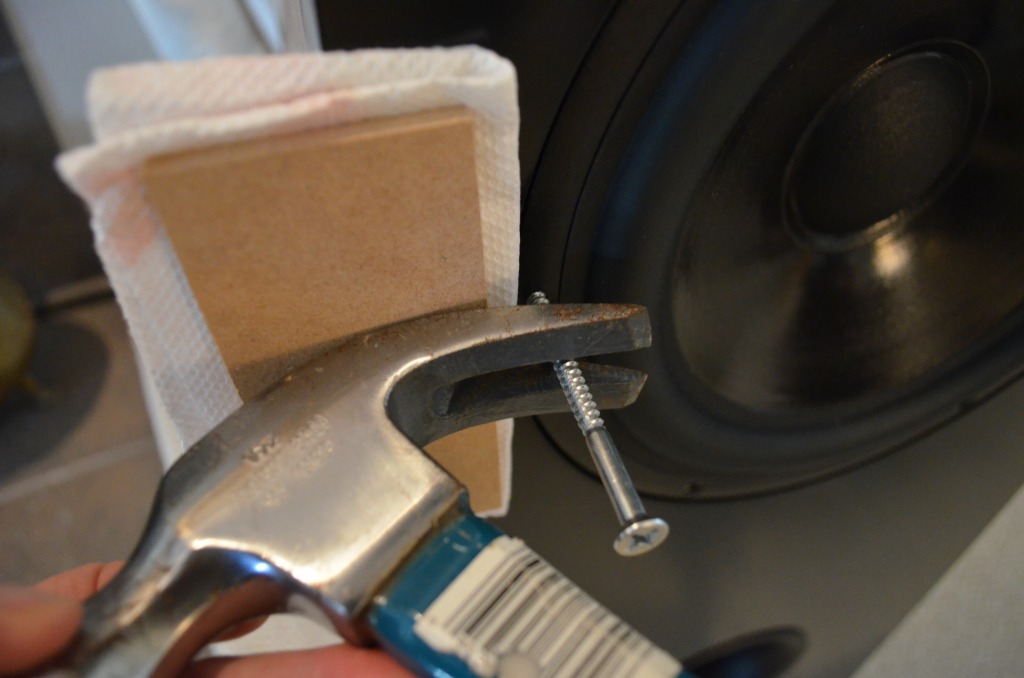

                                                                                    • 571
                                                                                    #131

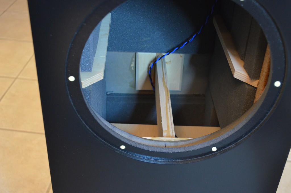

                                                                                    I had better lighting for pictures today so here's a few glamour shots
                                                                                    First I needed to remove the drivers to add some damping material. Even with closed cell foam gasket the drivers were still hard to remove...so here's how I did it. Insert a wood screw to catch the frame only...the pic shows the rest

                                                                                      • 16205
                                                                                      #132
                                                                                      Great work, Scott! :T
                                                                                      I especially like the second and 3rd pics, too! You're setting a standard of craftsmanship I certainly can't match- but one I can aspire to! Troels would be proud to see his design implemented this well!
                                                                                        • 571
                                                                                        #133
                                                                                        Thanks Jon...I will say these surpassed my expectations, the two photos were like...did I take those??? But craftsmanship...the compound angles of your build...now that's difficult!
                                                                                        • jim1961
                                                                                          • Nov 2012
                                                                                          • 357
                                                                                          #134
                                                                                          Looks like you hit the crossover targets right on :T
                                                                                          What smoothing if any did you use for the distortion curves?
                                                                                          Also, what are the measuring criteria? Distance? SPL ? Smoothing?
