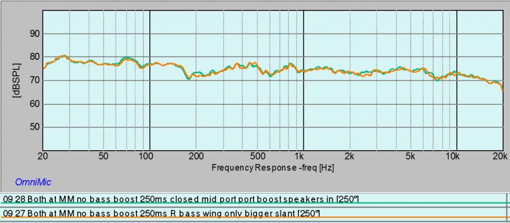

              Orange = yesterday
              Green = today
              (1/24th oct smoothing, mic pointed strait ahead, both channels driven)
              Moved the speaker 6" closer together and gained about 1.5db @ 200hz. I dont think I should go further given other problems that are cropping up.

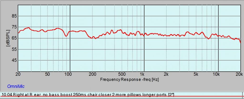

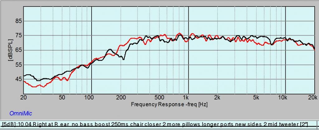

                  Is the dip centered around 225 Hz a function of the anechoic response or the room interaction? It's actually pretty wide for the latter, I'd think...
                  Other than that, looks pretty dang nice, bitty the drop in the 200 Hz area corresponds with what is usually referred to as the power region for classical symphonic music as well as key upper fundamentals in many other kinds of music- should be fairly audible. how's it sound to you, compared with reference grade headphones?
                  Originally posted by Leeuwarden
                  Have you asked Troels about this?
                  Jon, your reference to the anechoic response has some legs I think.
                  Leeuwarden, Your intuition has the same merit.

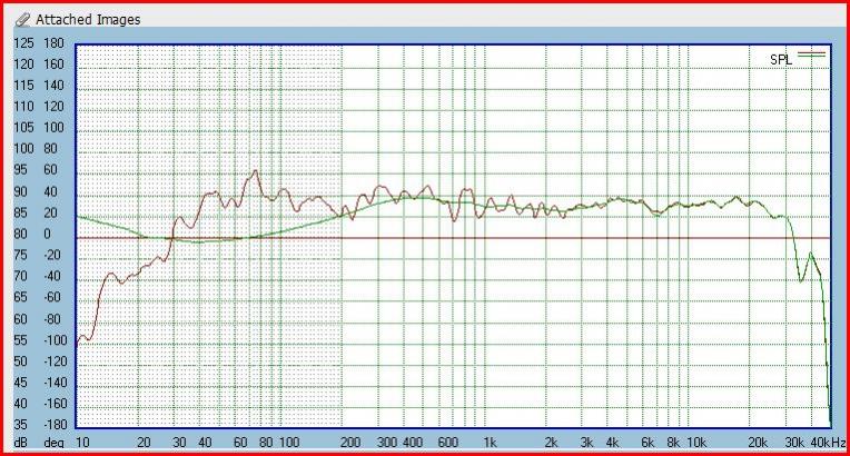

ID:	858713Click image for larger version

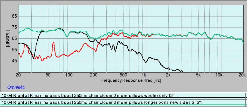

Name:	10 04 Right at R ear  no bass boost 250ms chair closer 2 more pillows longer ports IMG.jpg
                  Looking at this again, it does seem the speaker response is part of it. The similarity to the near field my brother measured has some striking similarity.

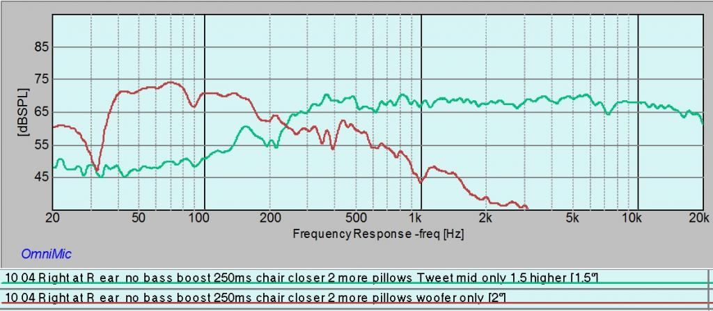

Name:	10 04 Right at R ear woofer sub and tweet mid.jpg
                        Actually this is more right.
                        Looks to me like the biggest problem is the midrange suck-out 160-250hz. Looks like a room problem there. Real guesswork whether Xing the mid lower would fix anything. Maybe.

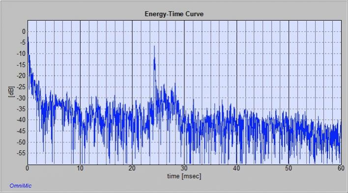

Name:	10 04 Right at R ear woofer sub and tweet mid near vs far field IMG.jpg
                            At LP
                            Here is a ETC (no smoothing) at 200hz .33 octave bandwidth (176-222hz) with just the mids tweets running (ignore blue line at top). If it was room interaction, wouldnt the ETC show a significant peak somewhere?
                            If the mid lull (160-250Hz) isnt caused by a reflection (SBIR), then what does that leave? Room modes? If its room modes, im sunk :cry:

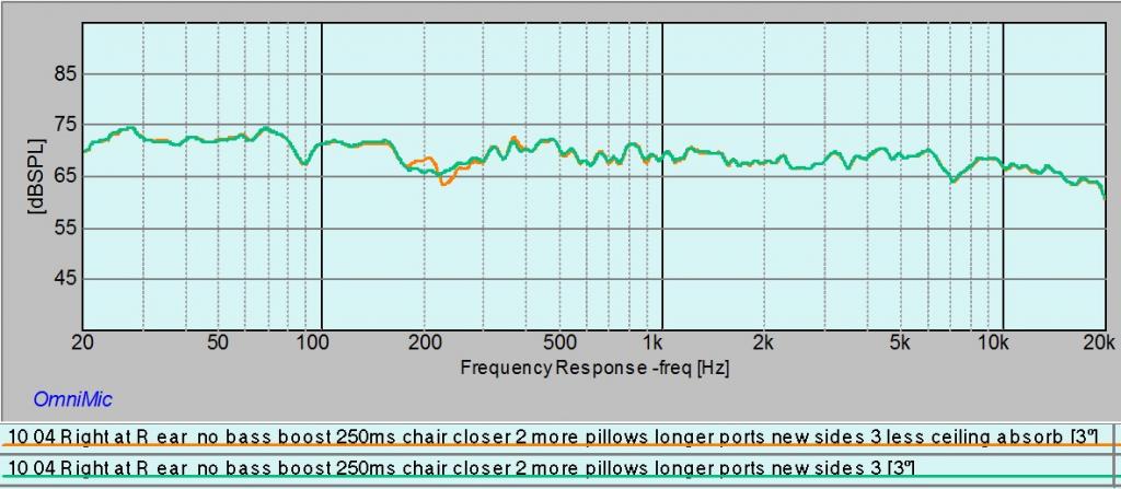

Name:	10 04 Right at R ear before vs no ceiling absorb IMG.jpg
                              I removed a rather large absorber hanging over the speaker.
                              Orange = without absorber
                              Green = with absorber
                              I suppose:
                              1) An ETC isnt up to the task is seeing early low frequency reflections
                              2) I think ill stick with the Green one

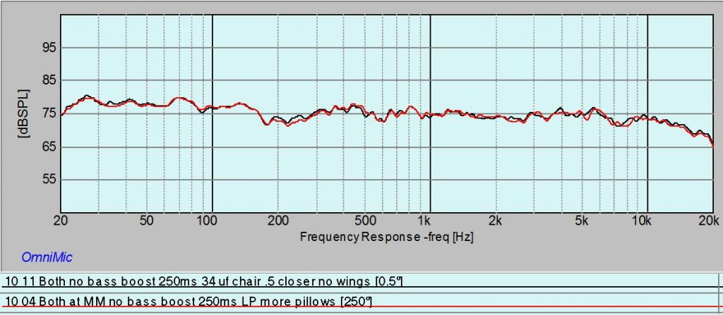

Name:	10 11 FR both 34uf 2.jpg
                                        Red = Before
                                        Black = Now
                                        I added 34uf to the mid HP filter and tweaked a few other things. I think this is better. Thanks Jon for pointing out the value of these frequencies, for I probably wouldn't have taken things further otherwise.

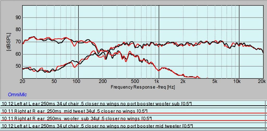

Name:	10 12 driver breakdown L R.jpg
                                            This shows the L and R channels for the woofer/sub vs mid/tweeter responses. The sub and tweeter are inconsequential so including them doesn't tarnish the data. Even these responses are a bit different today than what these show per yesterday for I moved things a bit (again).
                                              • 16205
                                              #202
                                              I'm proposing that you do gated measurements of the woofer and mid woofer which will result in quasi-anehoic response to confirm if the existing crossover design is the issue or if room boundary and room modal effects are causing the issue. You can't separate out floor bounce- the design has to deal with that.
                                              What is the window gate time on these measurements, and what kind of room position do you have for the speakers and measurement microphone? What position makes it worst, what position for the mic makes it "go away"?
                                              Normally when I do in room measurements I do them at a minimum of 2 meters, and at ear listening height. I use the minimum window length with a Half Hamming window that gives me valid LF data down to at least 100 Hz, but preferably 50 Hz. Not many data points down there, and not very good resolution, but for a crossover in the 200-300 Hz area, it's desirable to have valid data points at least every 25-50 Hz. It's a balancing act for getting the system response without too much room effect. But then I also do measurements with 200 msec window, just to compare, and identify room issues and boundary effects that can mess up things in the crossover region.
                                              Part of the system design, of course, is picking the driver positions relative to the floor boundary in the initial design and making sure that doesn't put problems in the crossover region, to where one could be fighting the crossover and the floor issues at the same time.

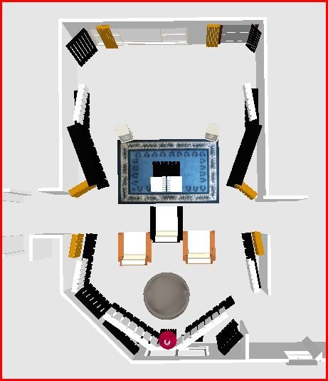

Name:	My Room 09 15 2013.JPG
                                                Black = Absorber
                                                Orange = Diffuser
                                                Gray = Reflector
                                                This ^^^^ shows the basic speaker to mic orientation.
                                                Post #192 shows when the null goes away and also describes at what distance (46"). Basically speaking, the closer the LP (mic) is to the speaker, the less the null. The closer the speakers are to each other, the less the null.
                                                The Omnimic results I have been posting from the listening position are 250ms at 95" distance. Mic height is at ear height which is 1" higher than the exact center of the midranges (see my avatar for driver layout).
                                                Omnimic (my measurement system) doesnt have a half hanning feature. So I would trust the measurements in post 114 and 130 for the near field readings.

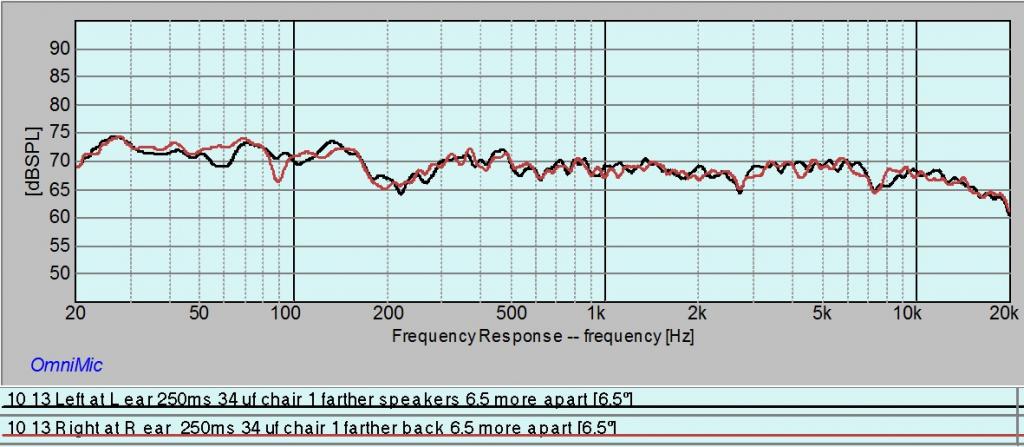

Name:	10 13 R L 250ms @ listening position ear height.jpg
                                                This is my latest measurement

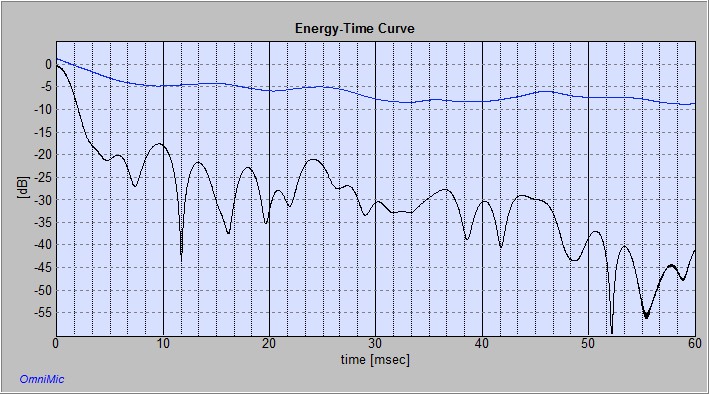

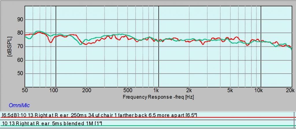

Name:	10 13 R 5ms blnded 1M.jpg
                                                  This is my best attempt to put the far and near field measurements on one graph.
                                                  I used the "blended" setting thats defined as: blends from the "only to" calculation at higher frequencies, to the "all" calculation at lower frequencies. In other words, this mode removes echoes when it can, and doesn't when it can't.
                                                  The "only to" in this case is a 5ms gate. "all" refers to no gate. The Green graph is my "blended" response at 1M distance at midrange height. The Red graph is the far field (listening position response, 2.4M distance 250ms gate)

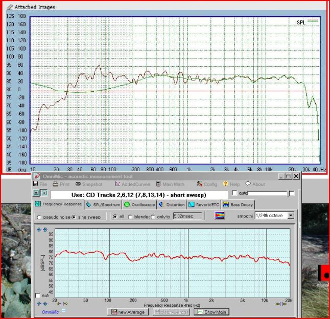

Name:	scott near field vs my far field.jpg
                                                    Here an an attempt to line up my far field with Scotts near field

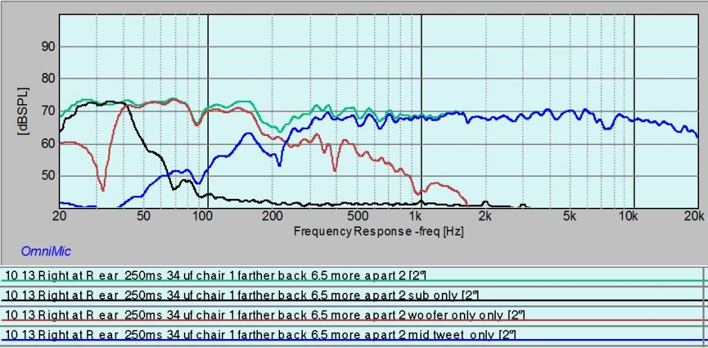

Name:	10 13 R sub woofer mid tweet 250ms LP.jpg
                                                      It breaks down this way at the listening position.

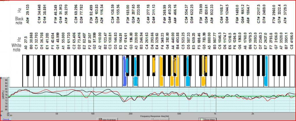

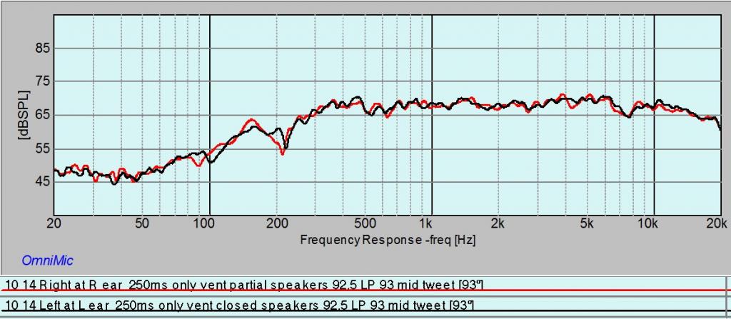

Name:	10 14 R mid vs L mid.jpg
                                                        This graph show how the L and R midranges/tweets measure at the LP. The fact that they are so different in the 150 - 250hz range seems to point to the room more than the crossover. I exchanged the R and L speakers to be certain they behaved the same when swapped and they did within +/- 1 db.

                                                            I think it sounds fantastic. BUT, I have thought it sounded fantastic before also. Time and time again I have surpassed previous levels of perceived greatness (greatness in my own subject and biased perception ).
                                                            So as long as I keep surpassing previous milestones, I keep pushing on.
                                                            I think I need to add that despite the emphasis here on the FR, I actually find more bang for the buck in working on early high gain reflections. When you get ALL those down to -20db, -30db even better I hear things in the recording never experienced before.
                                                            I could achieve a better FR curve if I ignored the ETC data. So what is seen here is the lower priority aspect of my goals.
Name:	10 14 R ETC no smoothing.jpg
                                                            Getting this ^^^^ was much harder than getting the FR decent. As it turns out, removing early high gain reflections naturally makes the FR better given nulls and peaks caused by room interaction are minimized. The present course I am on is the icing on the cake

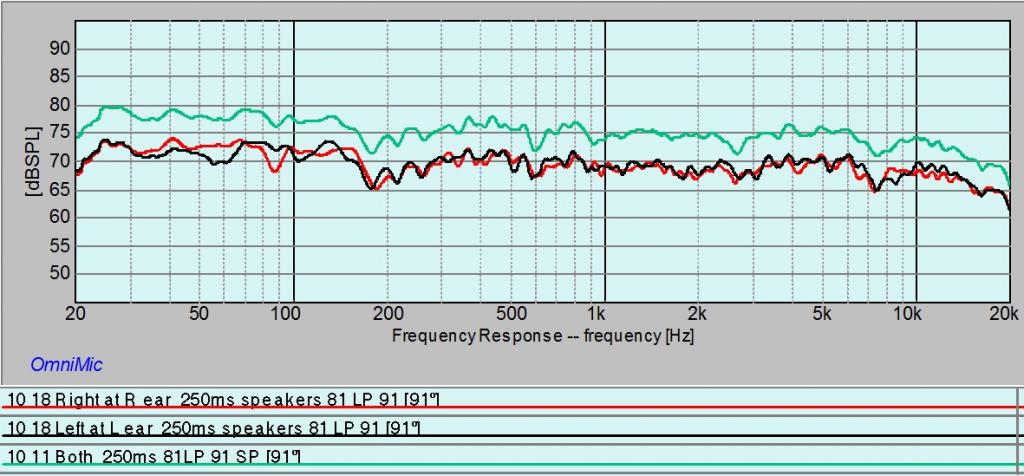

Name:	10 18 Both L R speakers closer togther.jpg
                                                              Black = Mic at left ear position measuring left channel @ LP
                                                              Red = Mic at Right ear position measuring right channel @ LP
                                                              Green = Mic pointed strait ahead, both channels driven @ LP
                                                              If I can manage to keep this response, should I still pursue XO tweaks?
                                                              • Leeuwarden
                                                                • Mar 2012
                                                                • 24
                                                                #211
                                                                I wouldn't. Now it's time to enjoy what you accomplished!
                                                                  Dark Blue -3db nulls
                                                                  Light Blue -2db nulls
                                                                  Yellow +2db peak
                                                                  Orange +3db peak
                                                                  Decided to look at things from a different vantage point. I only looked down to E3, so no data plotted below there (E3-C8 or 164.8hz - 4186hz).
                                                                  I guess my D minors may sound a bit colored. :boohoo:
                                                                    #213
                                                                    Wow!
                                                                    I absolutely love that graphic!
                                                                    First time I have seen that used.
                                                                    It really shows the data in a manner that one can easily conceptualize.

Name:	10 22 FR piano keys nulls peaks.jpg
                                                                          Black = Left Channel (1/24th oct smoothing)
                                                                          Red = Right Channel (1/24th oct smoothing)
                                                                          Orange = +3db peak
                                                                          Cyan = -3db null
                                                                          Blue = -4db null
                                                                          [the bass (below E3) isnt considered given the intentional +3 - 4db]
                                                                          Just looking for new ways to look at the data and put it in a context most easy to assimilate. What id really like to do is plot a graph right on the keys themselves. Havent figured that out yet.

                                                                            [ATTACH=CONFIG]22629[/ATTACH]
                                                                            Green = L & R Summed
                                                                            Black = Left
                                                                            Red = Right
