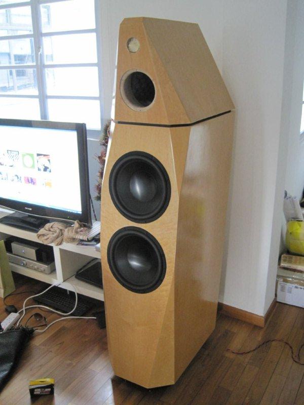

    Some of my projects in SG
    Image note available
    Last edited by theSven; 15 May 2023, 20:38 Monday. Reason: Remove broken image links
      #182
      I had a pair of Tannoy Arden cabinets in white, they reminded me of something out of a Woody Allen movie.

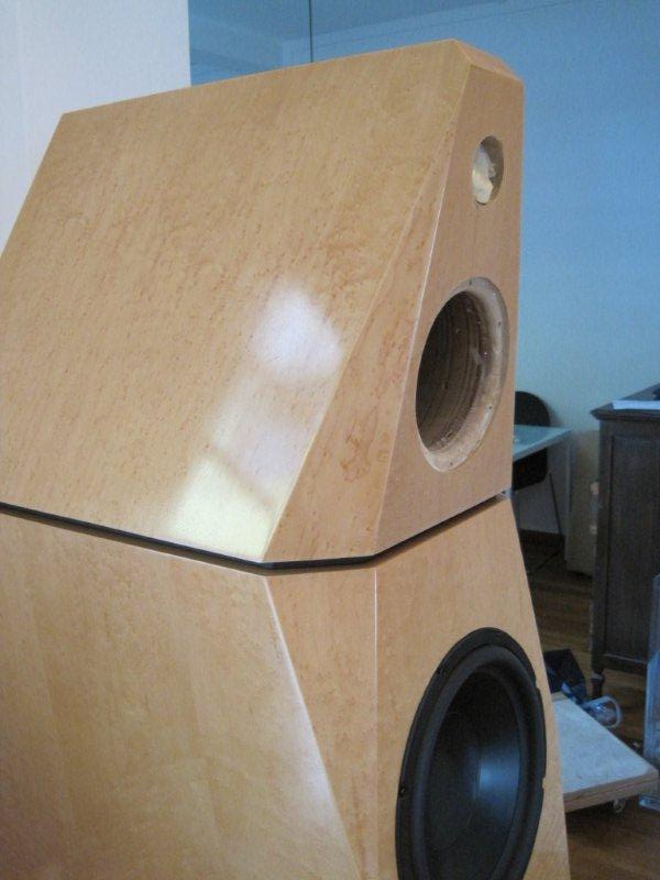

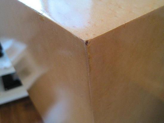

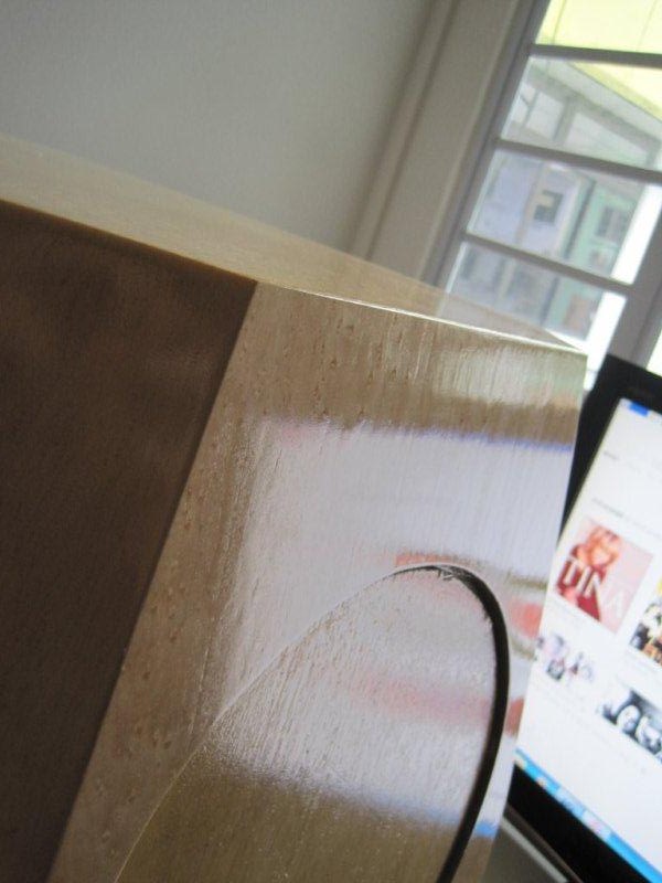

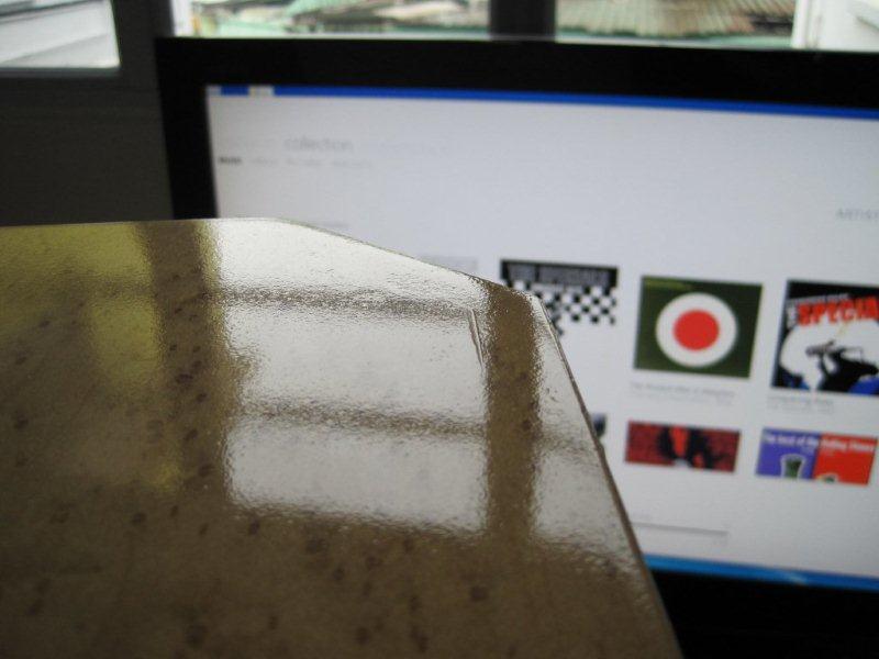

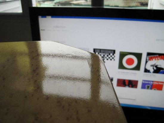

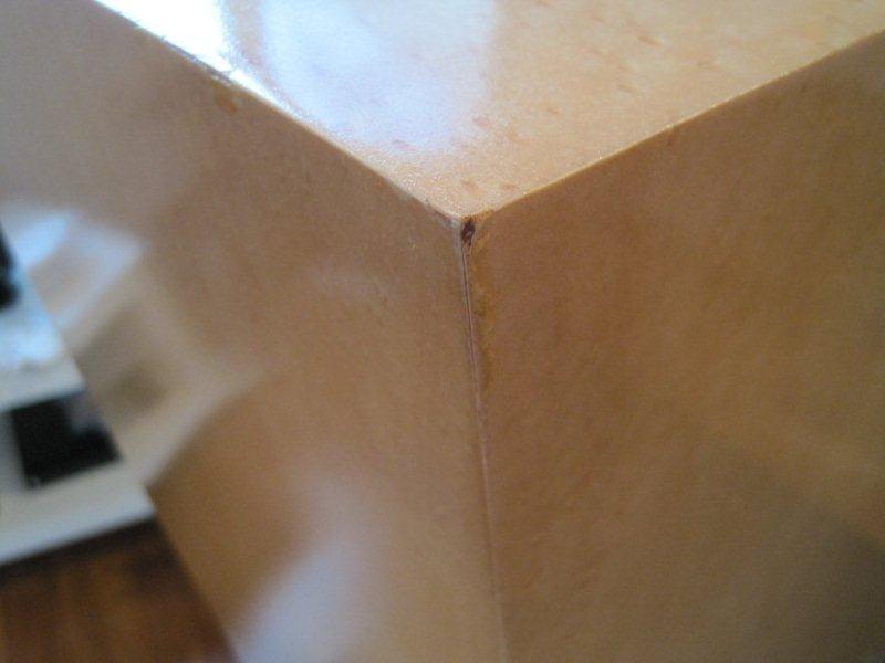

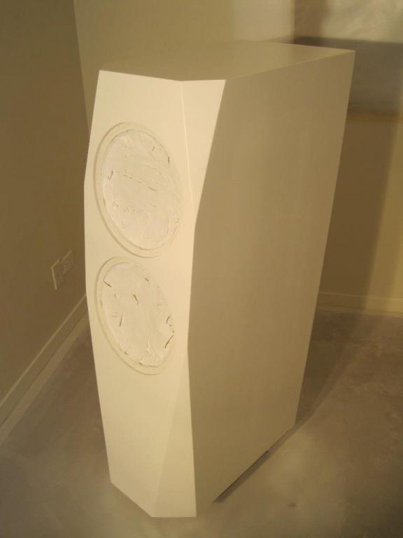

          Originally posted by meb46

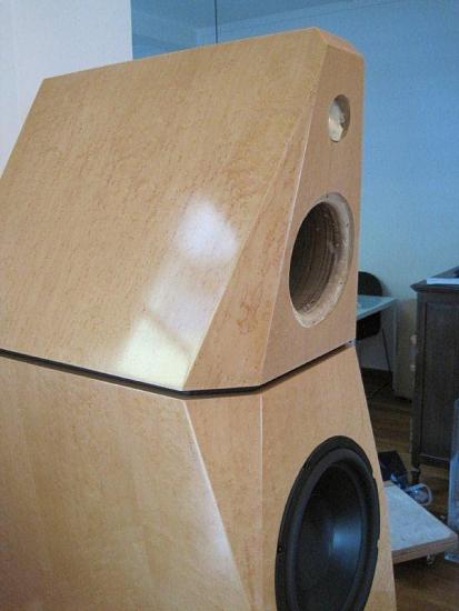

          A few pictures to show how they look as of today... and a few of the frustrating screw-ups my spray vendor has "botched"... GRRRRR...
          Right Hand Side Speaker - Bass Drivers Mounted and wired in Series. The Mid range will not be fitted until I re-machine the Tweeter mount to fit the new Transducer Labs Tweeter (Still to arrive)
          Click image for larger version  Name:	IMG_0579.jpg Views:	5473 Size:	73.7 KB ID:	857756
          Top Module
          Click image for larger version  Name:	IMG_0582.jpg Views:	5130 Size:	68.1 KB ID:	857757
          Top of Left Hand Side Bass Unit showing the terrible rippling and blotchy effect from the Top Lacquer... GRRRR. Bass Drivers are not fitted to this cabinet and the mounts are just blocked off to protect the interior of the Cabinets.
          Click image for larger version  Name:	IMG_0580.jpg Views:	4763 Size:	86.8 KB ID:	857758
          Top of Left Hand Bass Cabinet showing pit's, dimples, and damage to cabinet.
          Click image for larger version  Name:	IMG_0581.jpg Views:	4775 Size:	46.6 KB ID:	857759
          Further Damage to Cabinet Edges.
          Click image for larger version  Name:	IMG_0584.jpg Views:	4745 Size:	37.3 KB ID:	857760
          Moral of the story in the world of the DIYer... and those with a need for asthetics... If you want it done right, Do It Yourself...!
          I don't known the technical design for speakers baffle. If can! Could you please give me the speaker baffle for my avalon isis like your.
          Best Regards.

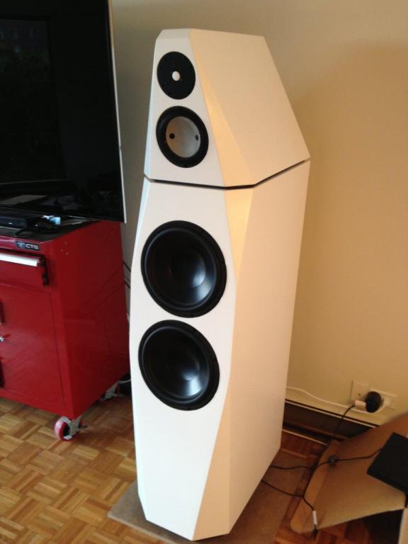

            Hello fellow forumers... after a significant "Transit sabatical" I am now back in Speaker mode. After finding a place to buy and managing to get all of our Singapore belongings safetly across the pacific and to Chicago, it's now time to resume the project... and I have made some great progress in the last 7 days.
            After the huge disappointment of the clear finish over the wood veneer, I have opted to switch to a plain white finish... just to make it easier. I had intended on removing the veneer and resurfacing the MDF, but I thought I would try and get a Water Bourne Lacquer over the Clear Lacquer already there... and it managed to work. I essentially scuffed the solvent based clear... which was very flat aside from the dints and marks the previous finisher had put in, then sprayed on an ML Campbell Stain Blocking Water Bourne Lacquer adn it went on like magic. The adhesion is fantastic and finsh is flat and easy to sand. Thus far I have sprayed on four coats of the primer/sealer/stain blocker undercoat with a 220 grit rub back between coats. It has really good build properties and I am nearly happy with the coat to apply the top coat. I still have some very small deformities to take out in the next day or so, but I hope to be spraying the first of the top coats before the weekend. The top coat is an ML Campbell Agualente White Water Bourne Lacquer and I am hoping for a flat bright white finish. Before the top coats go on, I also need to Re-route the Speaker mounts to clean them up a little and this is pending a step-up transformer to power my 230V tools... hopefully have that tomorrow.
            All good, and all looking positive again. Once they have some top coats on, I then have a few tasks set out for me from Jon such as cabinet impedance etc... finally some progress. The Tweeters are expected by the end of April, but at least I can get the bass cabinets near completion.
            Progress progress progress... more to follow in the next few days with a few additional pictures...

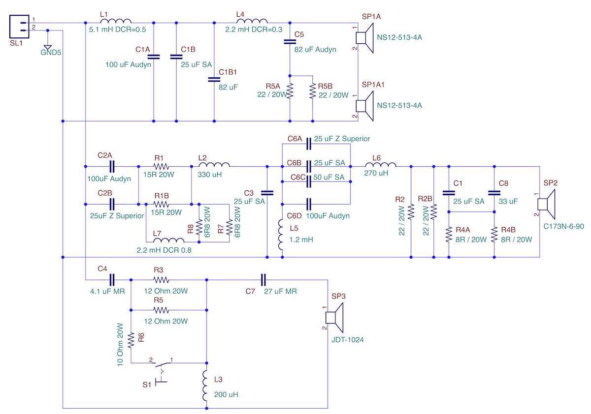

                    Jon - Thanks for the details, as above, I will probably keep this simple considering its a short term project. On to more interesting topics, what is the first thing you need from me once the Speakers are all mounted in the enclosures? Impedance measurements? Let me know so I can get the details sorted in advance. Also, I assume there are a number of key items for the crossovers that I can source now? Can you give me an idea of the final schematic or does this pend my measurements once finished? Let me know... many thanks
                    Will try to get some photo's of the cabinets up later tonight... I am suprised to say... they look really good in white, and I am kicking myself for not doing the white originally. Live and learn...

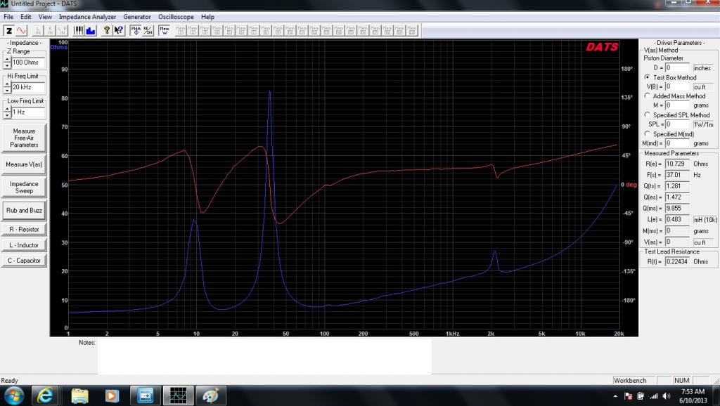

                    The main thing is going to be the impedance measurements for the woofers- using a bass reflex, you have a very different impedance curve with a double hump spaced around Fb, instead of a single hump at Fb- the upper impedance peak often presents problems with the LF crossover. So, with your impedance data, I can import this into the network and see how it looks.
                    I have data for the tweeter, so I'll just have to do a crossover pass with the impedance and amplitude data I've already measured for the N26.
                    The crossover is going to look a lot like this, but with some detail adjustments for the different tweeter, and possibly for the LF based on the impedance interaction (may need an LCR zobel/conjugate network to cancel the upper impedance peak in your system).
                    I'll put together a BOM based on a mix of air core and ERSE iron core inductors, to keep the expense reasonable. For the capacitors, I'll make my recommendations, then you should do what your budget will tolerate. That may mean stepping a grade down on the tweeter caps, say from Clarity MR to Jantzen Superior Z, and pondering your options for the midrange; I'm using a combination of parts in parallel, as even I didn't want to go fully Superio Z on the mid, but mixed them in parallel, which gives much of the benefit in the presence range where you need it, IMO.
                    Resistors here are all Mundorf Supreme using paralleled values to achieve the target, and you can substitute as you feel is necessary, but still try to target a similar power rating (20W each for the Mundorf, so don't go below 10W). I'm being a bit conservative, and not wanting heating effects on resistance value. I figure, if the Mundorfs are good enough for Magico, they're good enough for me.

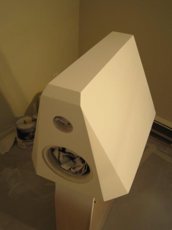

                        Update - White time...

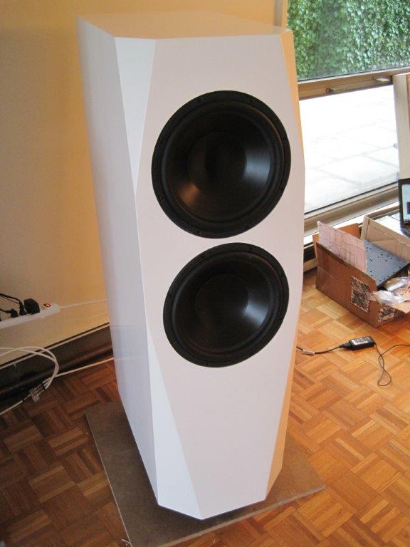

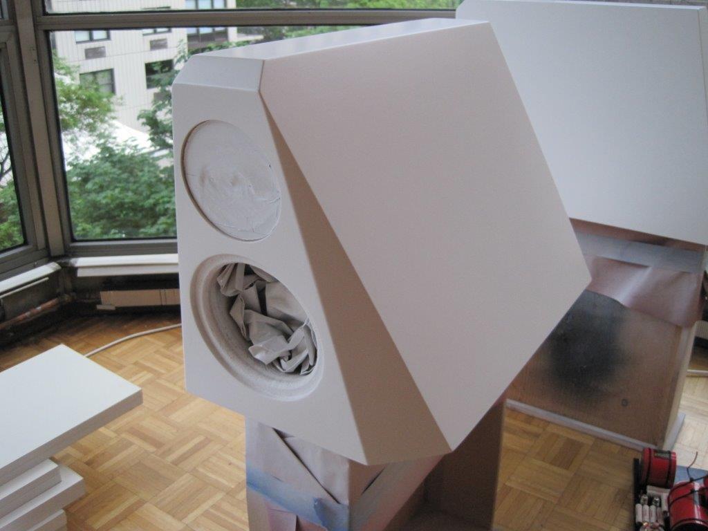

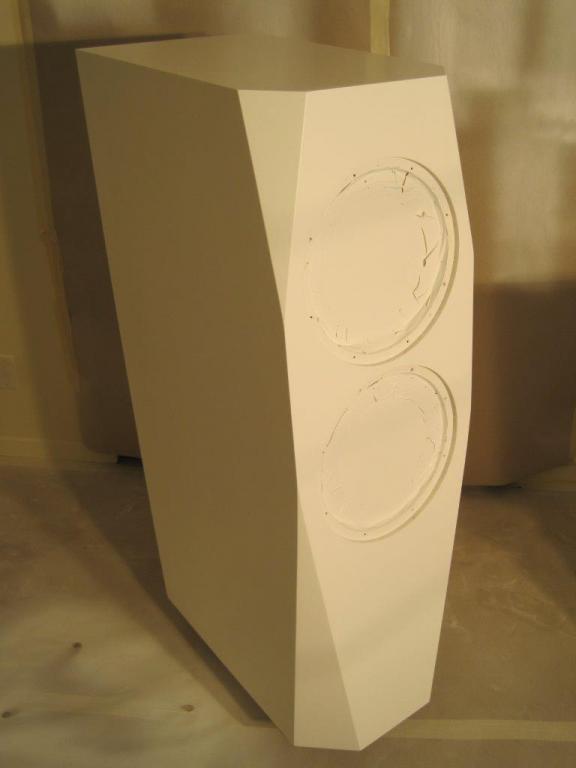

                        Right, as promised, a few pictures of the cabinets in their "White" form. The white is a super crisp color which the photos dont really do justice for. They only have 2 coats of top coat on so far, and I will spray on another 3 or so and then a light rub back and polish. The White is a satin finish as I dont really want the high gloss effect...

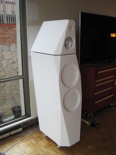

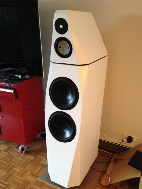

                          #192
                          Excuse the messy "renovation" environment around this picture... but here's how they look now. I have sprayed on a few coats of top coat and am now going to let them harden for the next two weeks while I am traveling. I will then have a final rub down (probably 400 grade hence the hardening) and a last super dustless top coat put on (Will need to reinvent my "Dexter" kill room again). I still need to re-machine the tweeter hole to fit the revised Transducer Labs tweeter... which I am still waiting on.
                          Click image for larger versionName:	IMG_0683.jpgViews:	1Size:	31.3 KBID:	858292
                                Looking pretty nice, Mike. Yeah, that will definitely require a "Dexter" room to finish up! Pressed for time, I didn't go that direction, but I'm more than OK with how it turned out.
                                Just ordered new parts for another spin on the LF crossover, and tweak the midrange- stay tuned.

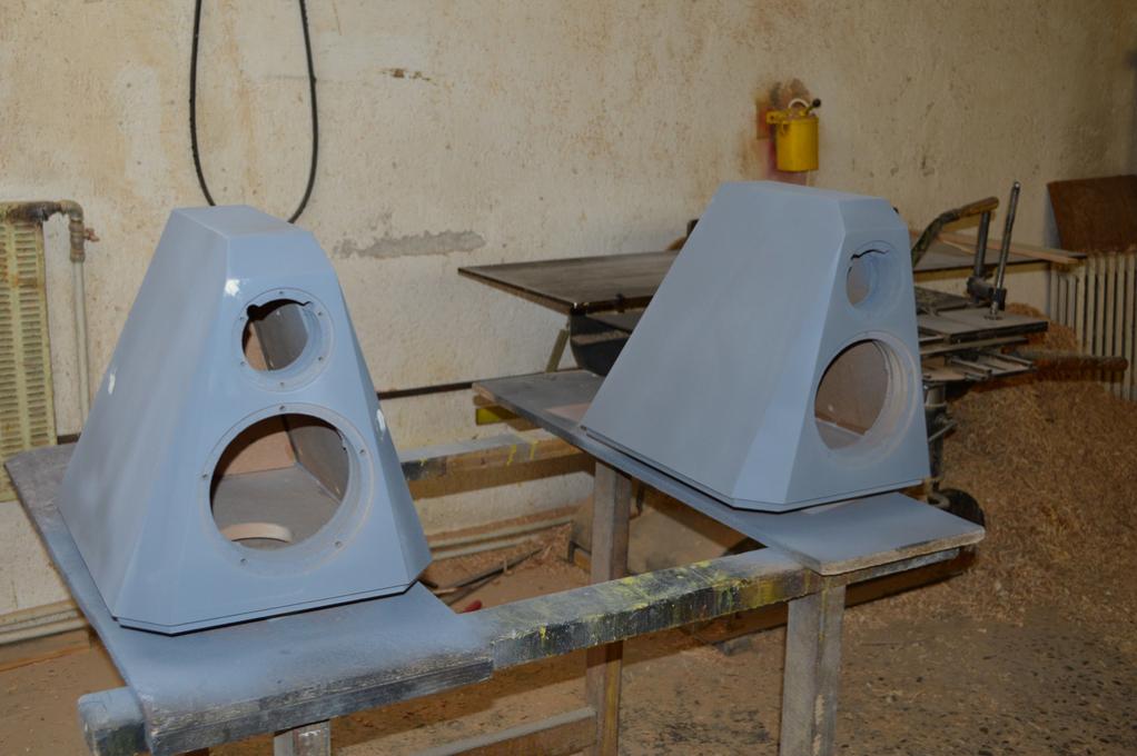

                                  I just found your project and it looks amazing
                                  I have also made a cabinet inspired by Avalon Isis but with only one woofer. Nothing was cnc'ed and it took me some time to perfectly cut all the pieces! I'm at the second coat of paint from the 8 or 10 I plan to do.
                                  Here is a pic of the actual speakers:
                                  enceintes Image not available
                                  And this is how it should look once finished
                                  I can't wait to see your wonderful speakers finished!
                                  Last edited by theSven; 15 May 2023, 20:44 Monday. Reason: Remove broken image links

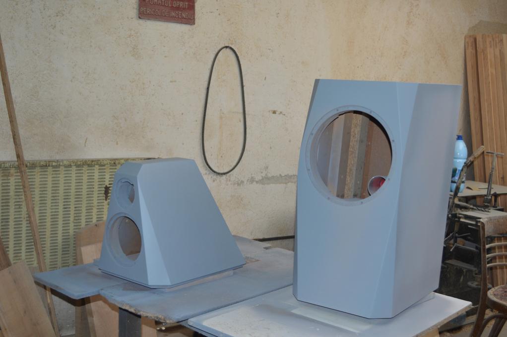

                                      I have used a primer and high gloss (both alkyd) from Tollens. This is basically the best paint you can find in France. As you can see I'm painting in my living room so I use a roller (I'm not sure about the exact word) and the final result is almost as good, if not as good compared to spray equipment.
                                      About my Primer: http://www.tollens-professionnels.co...O-195847o_matp
                                      And the High Gloss Paint: http://www.tollens-professionnels.co...RO-11188o_matp
                                      I have stabilized the MDF before applying paint with a product called epoxy resin two component from Resoltech. This is probably the best product I've ever used so far.
                                      Here is the 3D plan of my mini Isis-Scans Speak speaker
                                      Last edited by theSven; 15 May 2023, 20:54 Monday. Reason: Remove broken image link

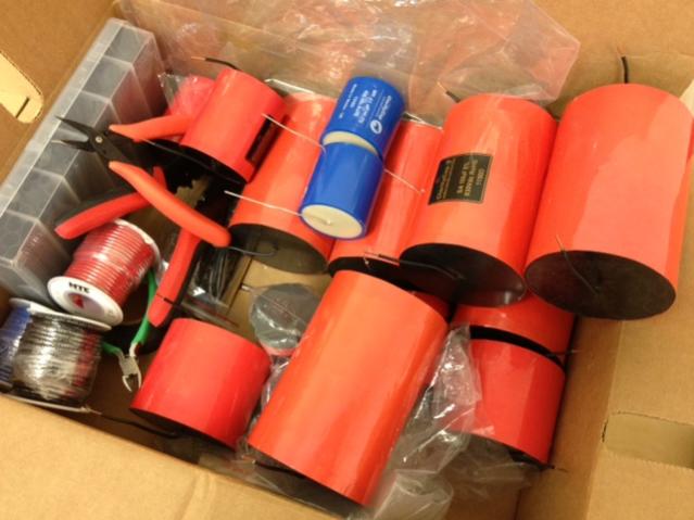

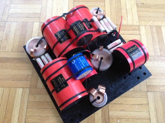

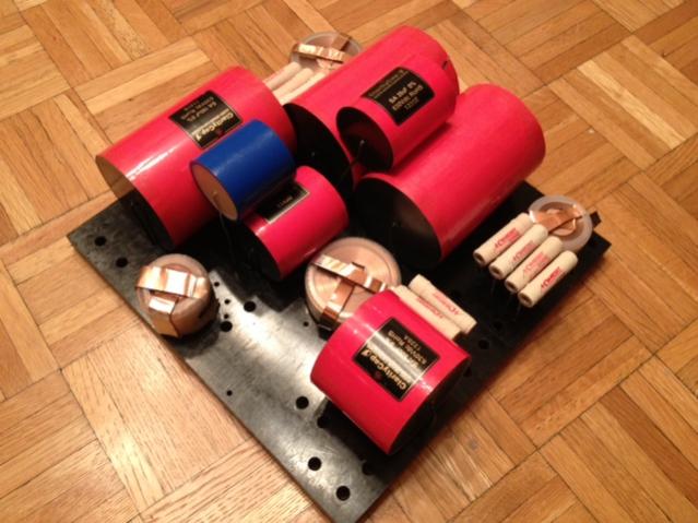

                                                          #208

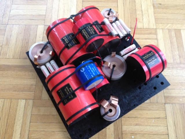

                                                          Box of bits above are the majority of the Mid and Tweeter Capacitors... there are still Inductors and Resistors inroute and hopefully here by the Weekend. The big capacitors are Clarity Cap SA 100uF which are about the size of a beer can... and each crossover will probably end up with above 4 of them... these are not small crossovers. The blue Caps are 4.1uF Clarity Cap MR Series, and I am still waiting on a 27uF version as well, which will be the 400V version that are on back order with Madisound at the moment. In the mean time, the missing caps/parts will just be "virtualized" as I try to work out the layout in 2D CAD. The Bass Driver Crossovers are yet to be finalized due to measurements required from my cabinets once ready to go... Fun times...
                                                          Lastly, a big thank you to Jon for his time on the Crossover Design... this is one skillset I simply dont have, and Jons help on this has been fantastic!

                                                              #210
                                                              Great progress over the weekend... Top Coat sprayed on the Bass Cabinets, now waiting for them to harden before final rub back. In the mean time I have been working out the layout of the Mid/Tweeter Crossover networks...
                                                              This is the plan so far...

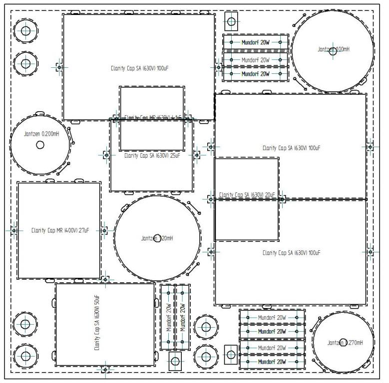

Name:	Mid - High Crossover Layout.jpg
                                                                • 16053
                                                                #211
                                                                Nice work- I'm palming a more formal layout plan for the midrange, too- just to try to optimize the flow and size. I did one combined tweeter and mid board in the prototype phase, but am debating with myself splitting that up. Suppose I should look at both. Getting ready for another meeting with my manager, out here from the East Coast. His wife just got laid off today- it's been a real Monday, though my customer meeting seemed to go fairly well.
                                                                • meb46
                                                                  • Jul 2010
                                                                  • 398
                                                                  #212
                                                                  Arrgghh, Mondays, nobody likes them...

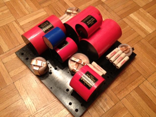

                                                                  Managed to get my Mid - High Crossover Mounting Board Drilled last night so at least I can get a taste of what one will look like... all components are top mounted and then wired underneath... a mixture of drawn copper wire and connectors etc... still waiting on a few parts like the big 27uF Cap, input/output connectors etc... but things are shaping up nicely...
Name:	Mid - High Crossover Mockup.jpg
                                                                  • meb46
                                                                    • Jul 2010
                                                                    • 398
                                                                    #213
                                                                    Mid/High Crossover all mounted to baseboard. I am still missing a few parts and connectors, but the first one is progressing nicely.
Name:	Mid - High Crossover.jpg

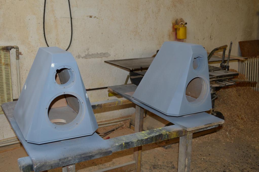

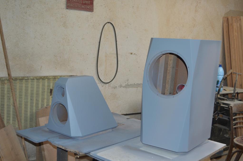

                                                                      Ok, so if it's ISIS let it be
                                                                      I think we will be the three whites,i will paint my speakers in matte white,it is my second white speaker set,and i love the colour.
                                                                      Preparing for the paint job:
ID:	858379Click image for larger version

                                                                        #215
                                                                        Looking great!!! Not sure the weight of your cabinets... but mine are now pushing 200kg with both the top and bottom modules. It makes moving them near impossible and I typically damage the paint work everytime I move them. The Bass Cabinets now sit on dollies, but at some stage I need to try and get them off and onto the bases after the final rub down. I might need to hire a hand or recruit one of my friends to assist... it's just something that my wife can no longer help with...
                                                                        • Aircirc
                                                                          • May 2013
                                                                          • 10
                                                                          #216
                                                                          I made some compromises, mine will weiht aproximatively 70kg-s or more,unfortunately my friends are too gelous to recruit them,so i had to keep a decent weight, and i have to lift them to the upper floor,so....Can't wait to have them finished!
                                                                            • 16053
                                                                            #217
                                                                            Woofer cabinet empty about 118 lb; upper module empty about 45 lb. Not glued together yet, but will be later this summer. Sure am glad those NS12-513 are lightweight Neo! But the assembled upper module feels like 60 lb, haven't weighed it, though.
                                                                            Still have grilles to build. And second crossover build.

                                                                                    4. DATS Installed, Calibrated and initial Impedance Measurements and Curves done
Name:	Impedance Curve.jpg

                                                                                      #222
                                                                                      Thursday Teaser...
                                                                                      Thursday Teaser on cabinet number one... all drivers in, cabinets polished up! Last part for the Mid/High Crossover ready to be fitted and tested tonight. Then its time to move to the other cabinet and do it all over again...
