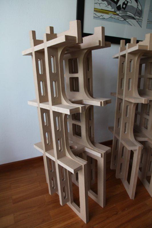

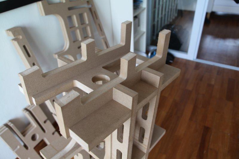

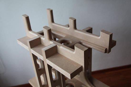

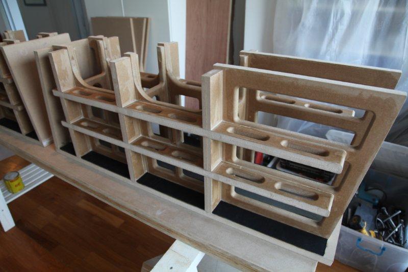

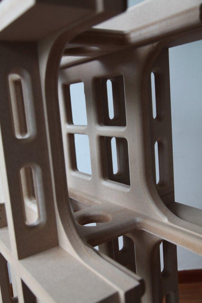

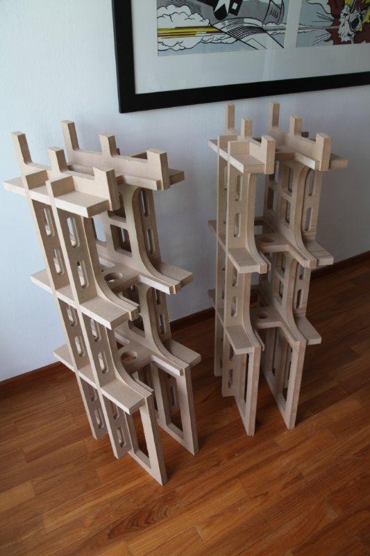

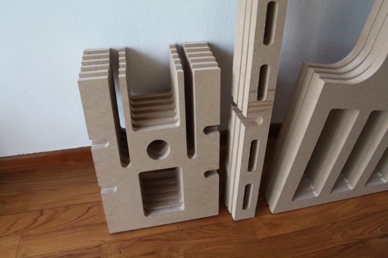

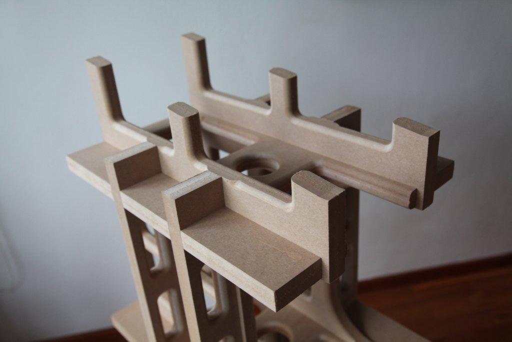

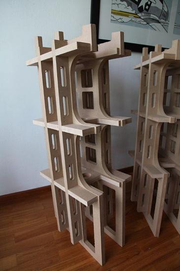

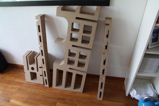

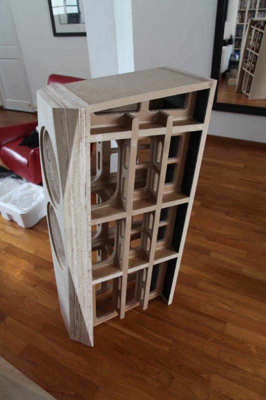

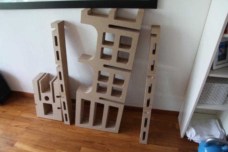

          Finally some serious progress... funny turn of events, I thought when I received the bracing that it would take me a week or so to assemble the two Bass Cabinets. I was expecting to have to custom fit each piece together with some sand-paper edging and fitting... this was not the case!
          Thus far, I have received all of the 2D CNC cut pieces, which are essentially the internal bracing of the base cabinets. On arrival, this is how they looked...
Name:	Internal Bracing 1.jpg
Name:	Internal Bracing 2.jpg

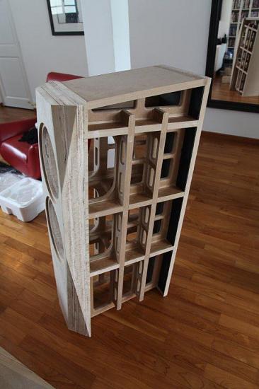

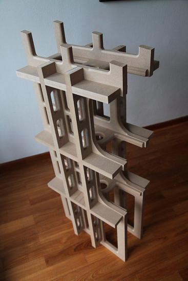

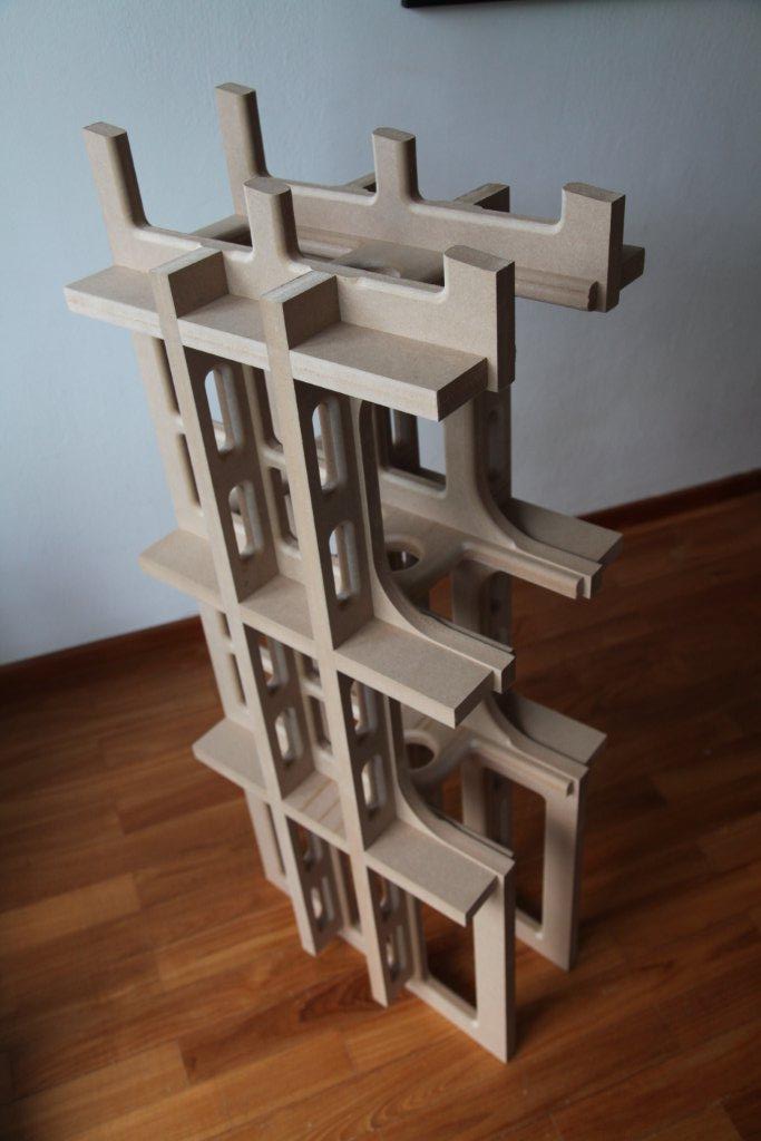

          Armed with nothing... I thought I would test fit a few of the pieces together to see what find of work I have in fornt of me trying to assemble these... approximately 2.5 minutes later... this is how they looked...
          The cabinets essentially "fell" together. The bracing machining is perfect, and my assumption of resistance fits and clearances were spot on. I had thought I would need some "resistance" fit matrix's, but these proved to be absolutely perfect in their matching and fit. HUGELY happy with the result, I couldn't have expected anything better. BIG thumbs up for CNC machining yet again!!!!
          Tonight I will try and get all of the radii machined into the bracing and then get these ready for gluing. I think looking at the MDF, I will definitely need to glue the bracing together and then seal all of the MDF that doesn't get fixed/glued to the other sides/baffles etc. Especially since I am in a humid climate, I think this will probably mean Zinsser Seal Coat... another upside of doing this before the sides and baffle goes on is simply access. Things will get tight to work on soon.
          Updates after all the radii are machined in...
            Wow that's awesome...can't wait to see the main event
              • 16175
              Slick!
              This is the way it SHOULD work! :T Looking good, Mike!

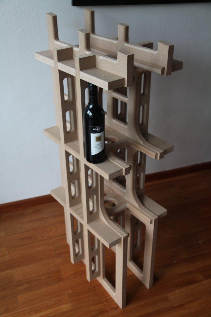

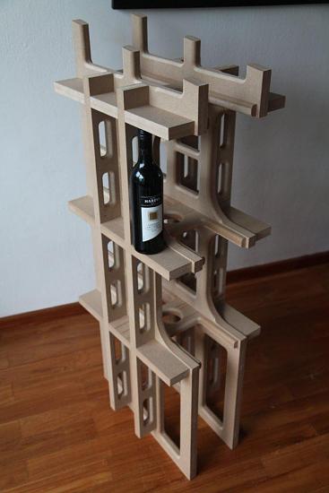

                  That's what happens with good CAD. Just remember to take it all apart before you start final assembly so you don't accidentally forget a piece.
                  You need a wine bottle or something in the pics so we can get a better sense of scale on those.

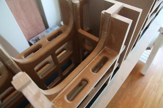

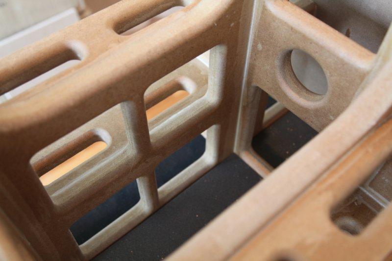

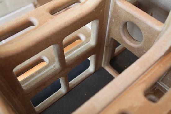

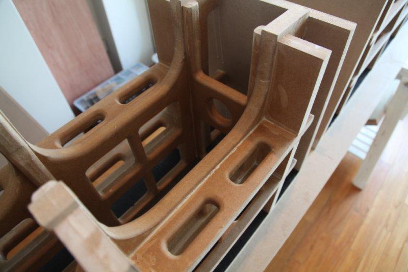

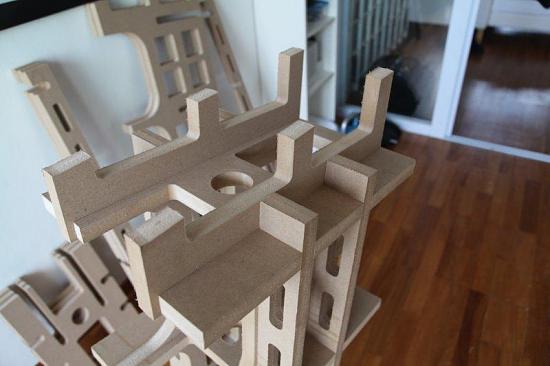

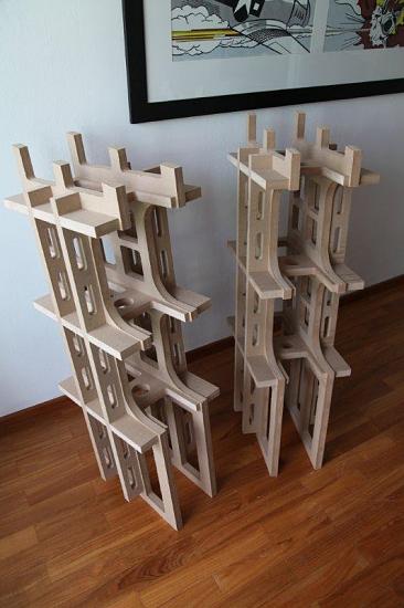

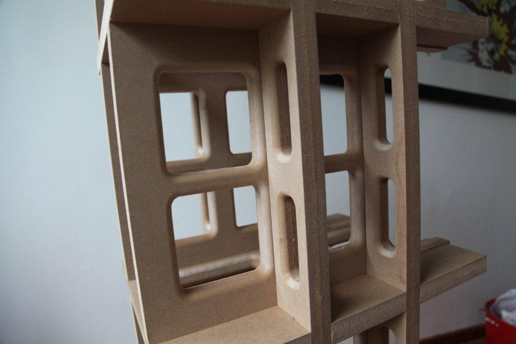

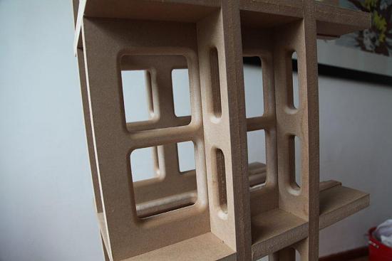

                    A few more pictures after the addition of the internal radii... and a picture for CJD for scaling
                    Unfortunately... now I must patiently wait for the front baffles before I can start and glue these all together... oh the temptation of it all...

                    The wine-bottle photo is a bit decieving, as the bottom chambers are actually much larger. If it helps, these brace frames stand 1150mm x 330mm x 470mm(deep but not including angle). Thus far, the Brace Frames weigh in at 18kg... These are going to be some heavy beasts...
                    Fingers crossed I get my Baffles back next week and I can then start to glue them up and then seal the MDF etc...

                      Mmmmm, see, I'd now be distracted from the desire to assemble more thoroughly. A nice Cab Sauv it seems.
                      • meb46
                        • Jul 2010
                        • 398
                        Yes... i'm fighting the same tendancies... but I had envisaged I assemble them from the baffles backwards. The Bracing structure, while square and now complete, does need the fit with the Baffles to ensure complete accuracy. As I dont have the baffles yet, I am sitting on my hands paitently until they arrive. My thoughts are to Build/Glue them starting with the Baffles and the main vertical braces and then slowly glue in the horivontal braces etc. I'm trying to be thorough, and avoid any "cock-ups" with these "expensive" machined parts. These are not parts I would want to pay for a second time

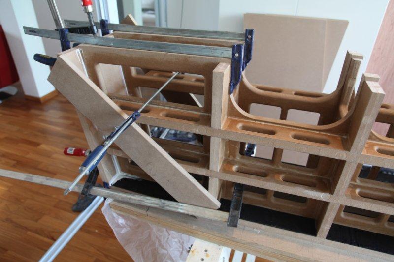

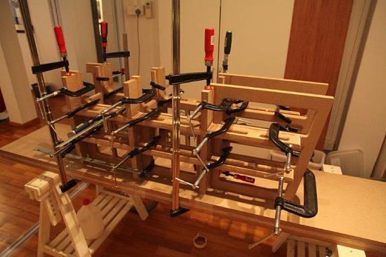

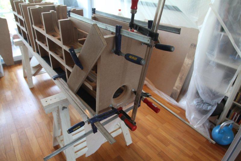

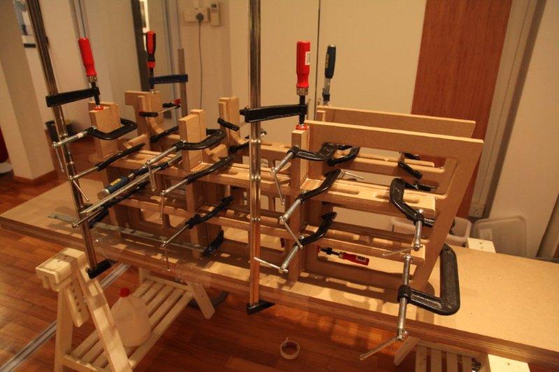

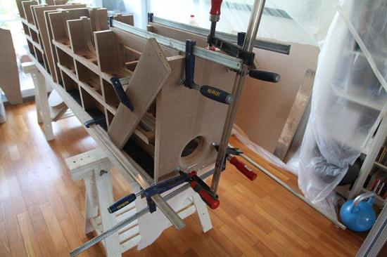

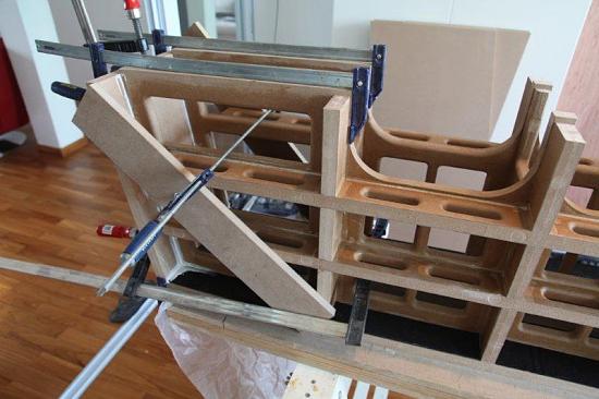

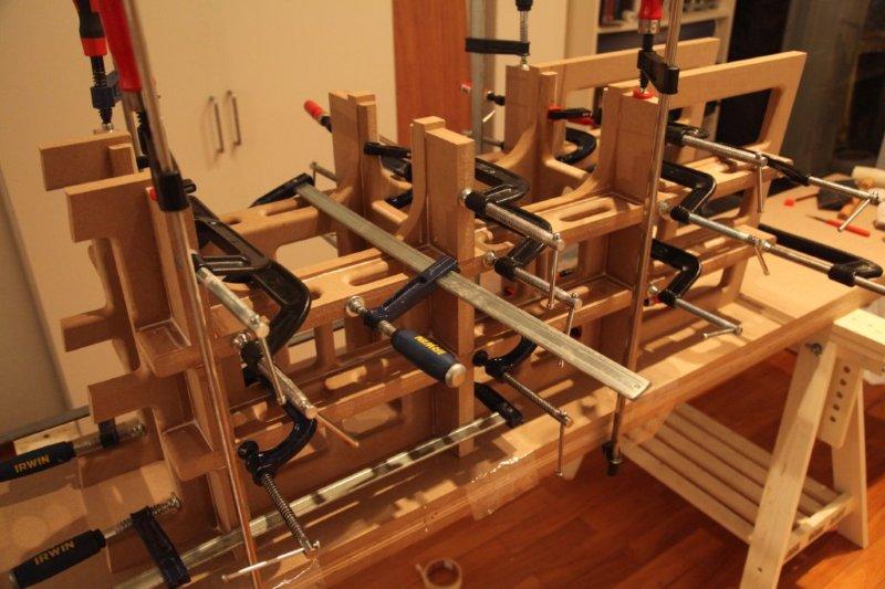

                          I caved... started assembling the internal braces and gluing. Point to note... 30 G-Clamps required to clamp it all together while drying. Will post some further photos later tonight...
                          • meb46
                            • Jul 2010
                            • 398
                            Yes, believe it or not, under the maze of G-Clamps resides the Internal Bracing Structure. Baffles and all other panels are due Friday, so looks like i'm in for an exciting weekend of assembly

                              Most impressive!
                                You can never have enough clamps
                                  I worry that a weakness may be found. . .
                                  should we prepare your shuttle?
                                  (looks like it's coming along nicely! Hopefully it's also fun and rewarding.)

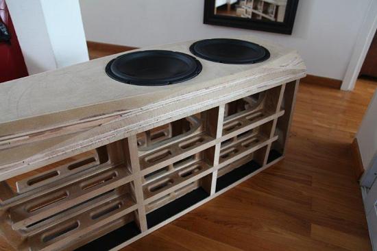

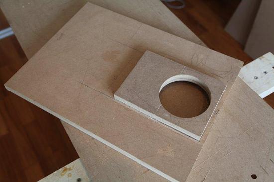

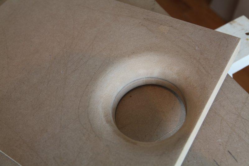

                                                    Updates on the Bass Cabinets - Bottom Panel with reinforced Port Hole. Should enable me to secure the port and tube a little better. The port will be epoxied in and will also have the top flared port epoxied to the internal brace.

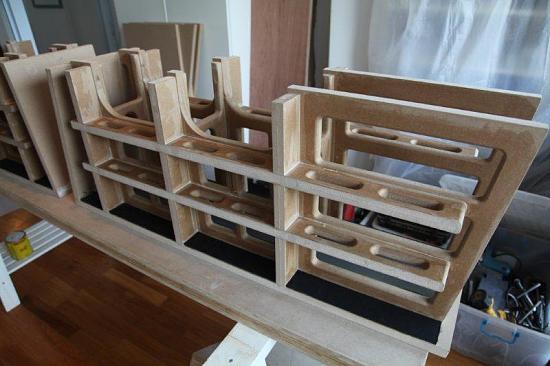

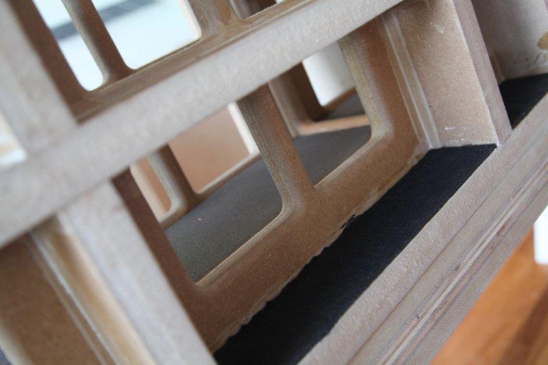

                                                      Bass internal bracing is now sealed with a layer of Poly and the rear panel has has 3mm Bitumen pads cemented to them and then the internal planes have 30mm acoustic Foam. I will be adding more bitumen pads to the top and bottom, and I am still to decide if I will use these on the side panels.

                                                      Obviously these cabinets are gaining weight with the Bitumen...

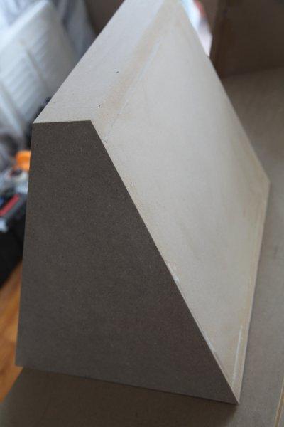

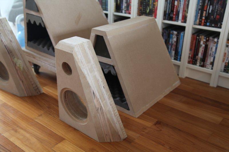

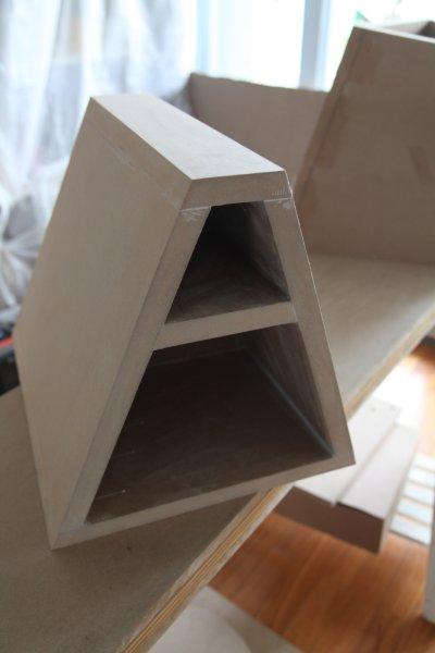

                                                        The Mid/Top Cabinets are a little tricky to put together as I have no right angle planes to clamp and work from. This has been a bit of a trial and error process, but I now have the cabinets assembled, bitumen lined and acoustic egg-shell foam on the internal Mid Driver Enclosure. Even without the Front Baffles, the enclosures sound/feel very rigid. All of the cabinets will get a 3mm MDF skin over them, so will tidy the look up a lot before veneering. I ended up having to use a few screws to hold things together during gluing. Subsequently, these screws have now been removed and the holes plugged.
Name:	Top Cabinet.jpg
Name:	Top Cabinet 2.jpg
Name:	Top Cabinet 3.jpg
                                                        Re-machined/corrected Front Baffles for all of the cabinets are being delivered this afternoon... maybe some photo's later today...

                                                          I expected the top modules would be tricky because of all the angles, but with the high accuracy fabrication you paid for, I'd expect it to go reasonably smoothly- and it looks like it has. How do the front panels match up? Do you have them yet?

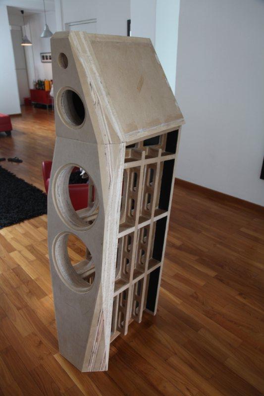

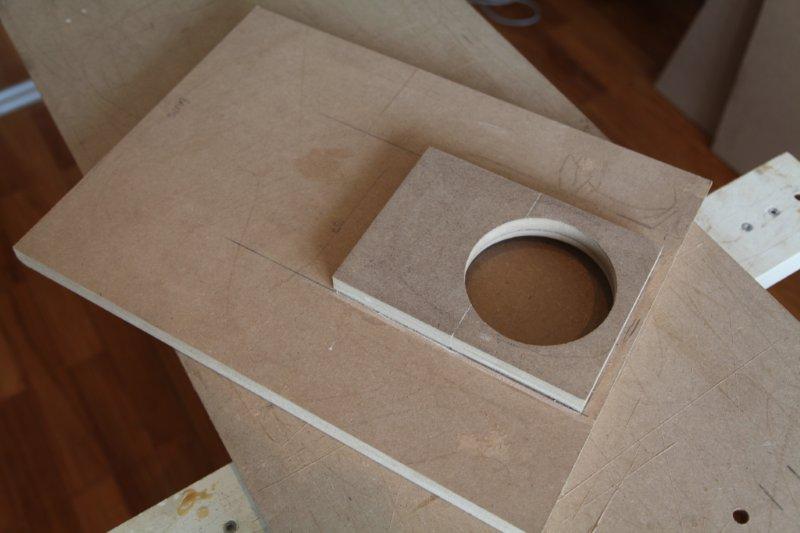

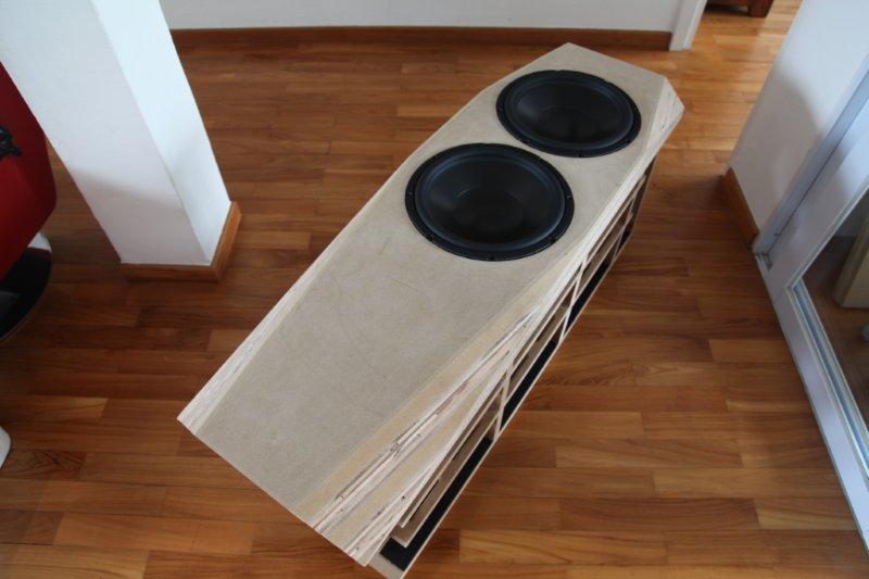

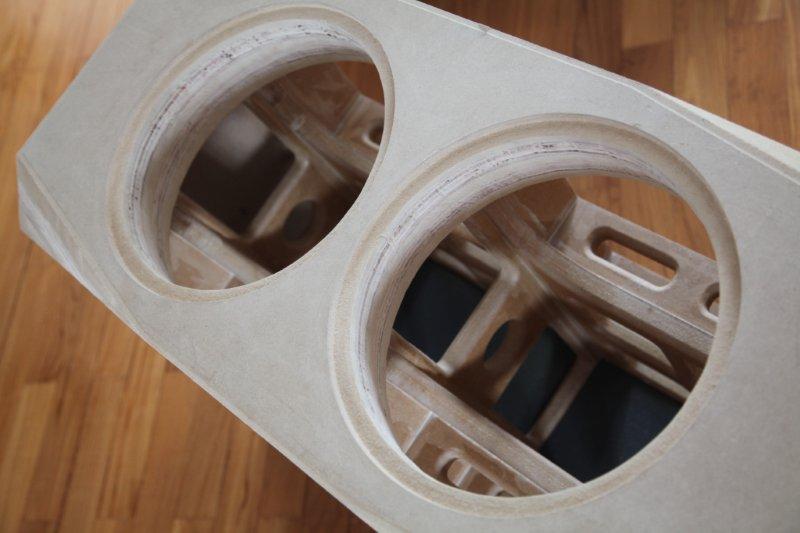

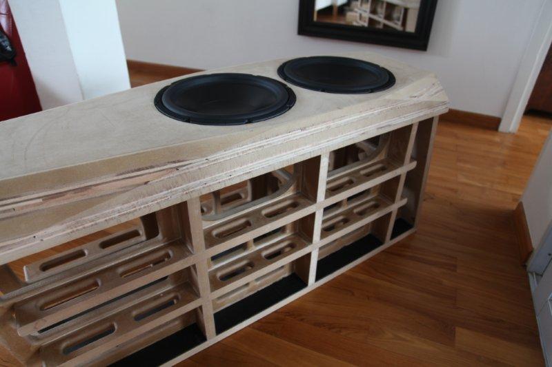

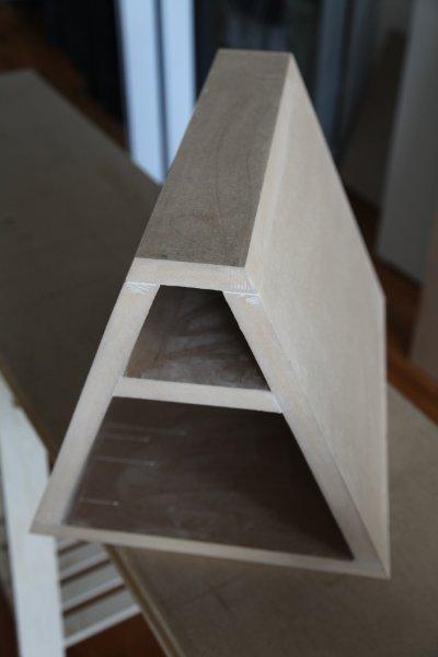

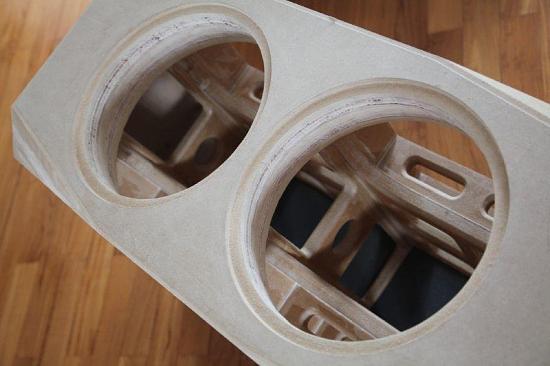

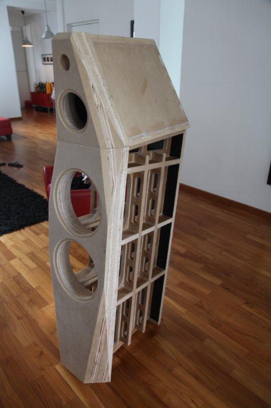

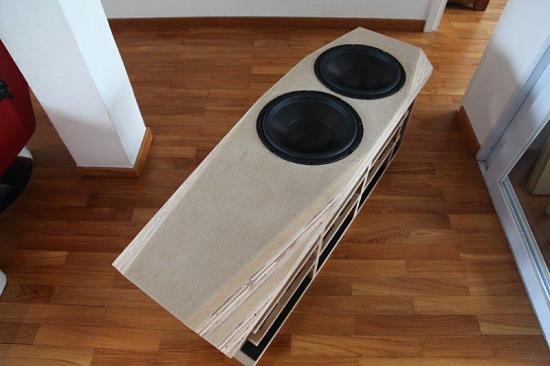

                                                            Baffles have finally arrived... after much discussion and rework, I have got the baffles which I had designed and are pretty happy with. there is some minor finishing to do on them, which is more of a case of my assembly accuracy and not the machining. I will also need to seal/poly the inside faces to slow moisture absorption.
Name:	Bass Baffle 1.jpg
Name:	Bass Baffle 2.jpg

                                                              Mid/Top Baffles...
Name:	Mid Cabinet Baffle.jpg
                                                              And finally... a picture of the full cabinet...
Name:	Full Cabinet.jpg
                                                              Jon - all the baffles match up and I have just glued the first Bass Baffle to one of the brace structures. Once this has dried I will then seal the internal structures... fun stuff!!!!!!

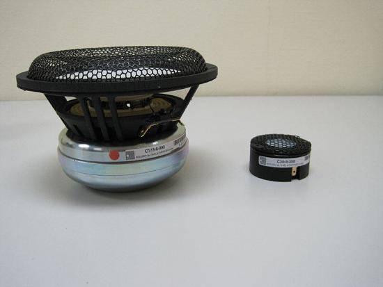

                                                                                On the upside, I ahve my mids and tweeters on-route to me... FINALLY!!!

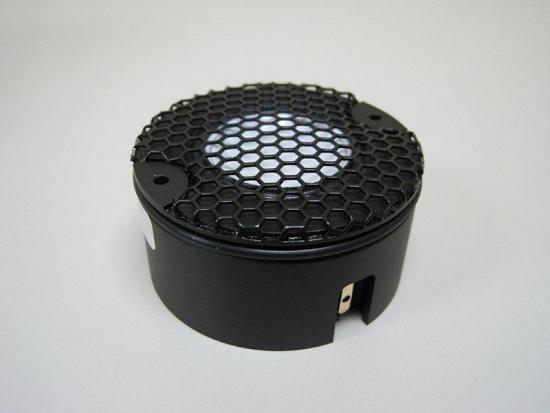

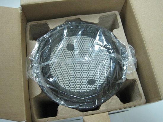

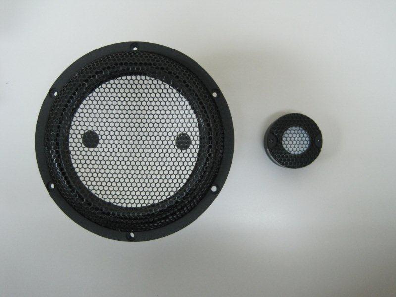

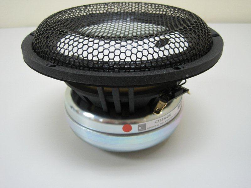

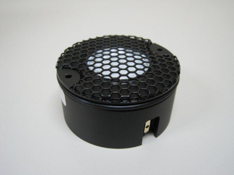

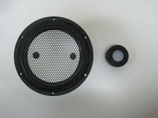

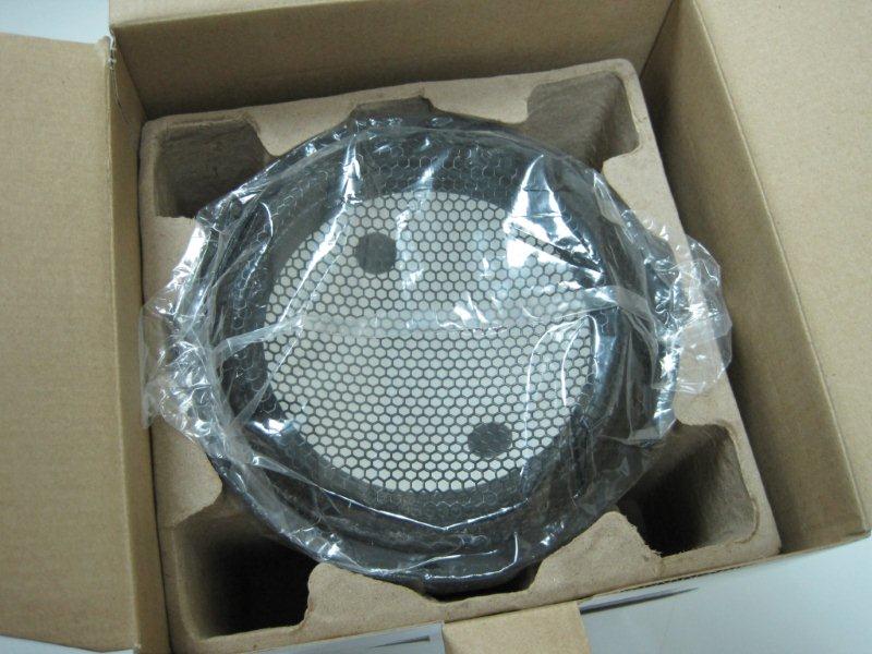

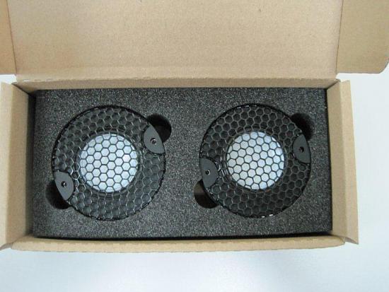

                                                                                      Oh the excitment... returned from weeks of travel to a few boxes on my desk... Finally they have arrived...
                                                                                      C30-6-358 CELL Tweeter from Accuton
Name:	C30 Cell Box.jpg

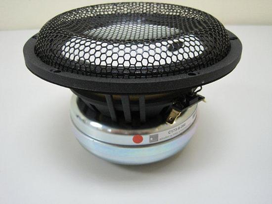

                                                                                      C173-6-090 Mid/Base from Accuton
                                                                                      • meb46
                                                                                        • Jul 2010
                                                                                        • 398

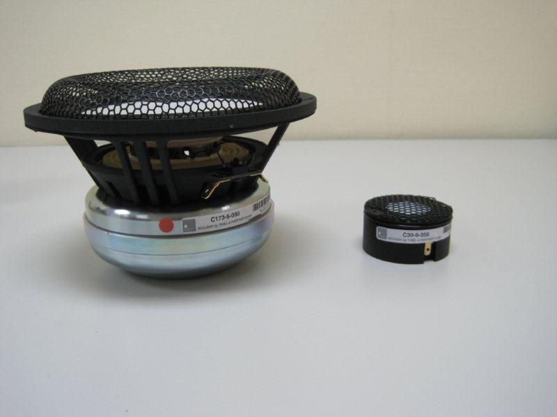

                                                                                        For comparative purposes...
Name:	C173 - C30 Side View.jpg
Name:	C173 - C30 Top View.jpg
                                                                                        I will have a test fit of thesse tonight in the cabinets and get some photos after the weekend of progress. I am still working on the MDF skin and also have just started to get some veneer on the top Cabinets. A long way to go, but the arrival of the Mid/Base and Tweeter Drivers will spur the project on
