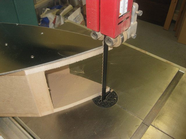

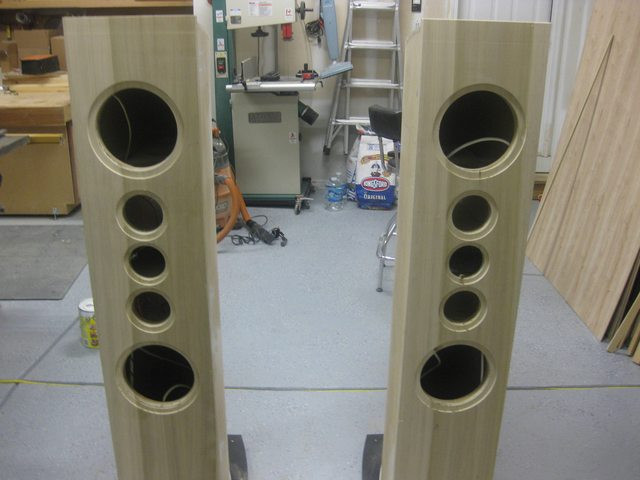

    Cutting wood...

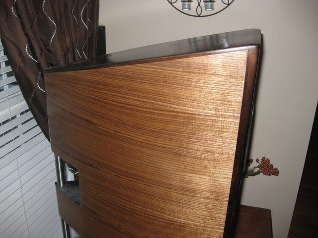

      Looking pretty interesting, I love the base.

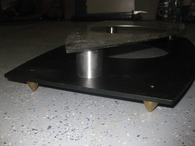

        Yea thanks, it turned out pretty nice. The tubing is 1 5/8in capped and welded (my day job is welding). Those gold spikes were from a closeout deal at parts-express 2.99 or something.

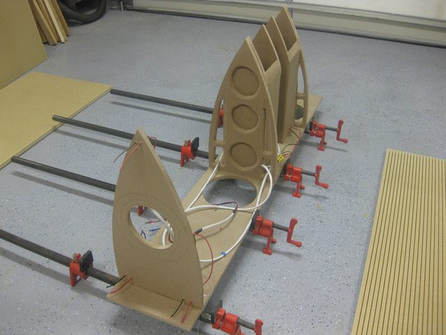

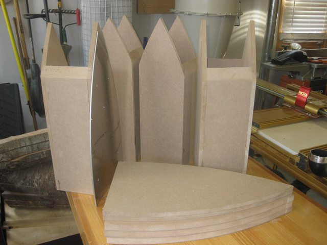

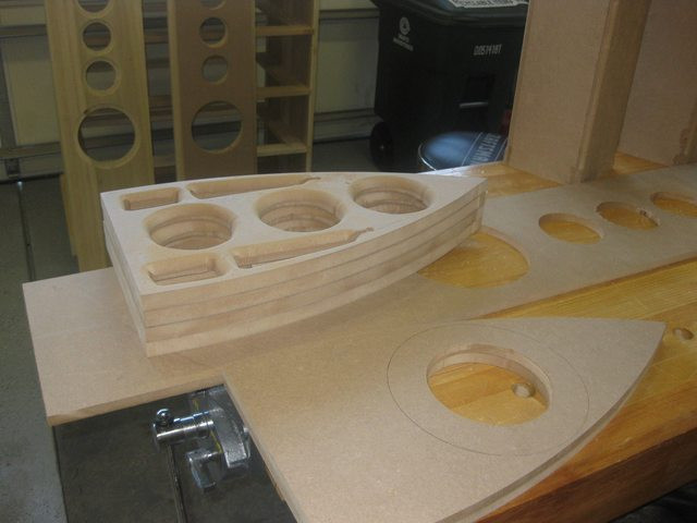

          Assembly:
            Is that all the bracing you put into the lower section? Or is there more?
            Looking quite interesting, regardless.
            • bigbardmusiq
              • Jul 2010
              • 94
              Yes, I thought about adding a brace from side to side.

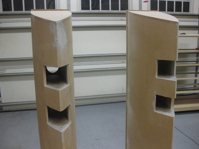

              • bigbardmusiq
                • Jul 2010
                • 94

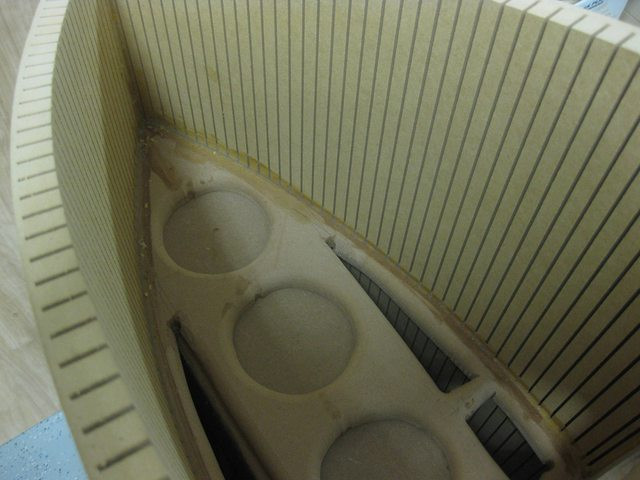

                Slots cut to curve the wood.
                  Are you going to fill the kerfs?
                  • bigbardmusiq
                    • Jul 2010
                    • 94
                    I am still debating that, I saw someone else fill it in with a woodglue mixture. My design calls for an additional 1/4in sheet of Walnut plywood to wrapped around the sides.
                      Are you making a flat spot to mount the binding posts? Or will they be mounted on the bottom or something?

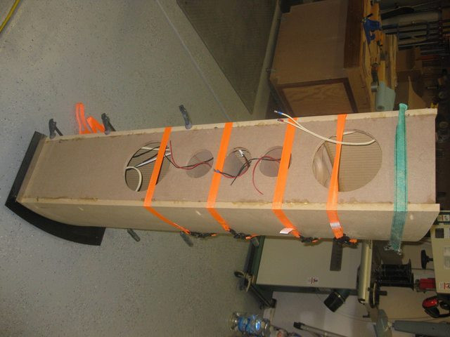

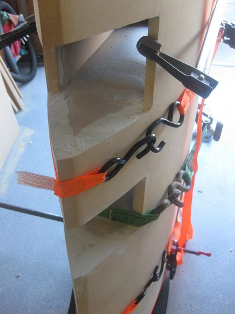

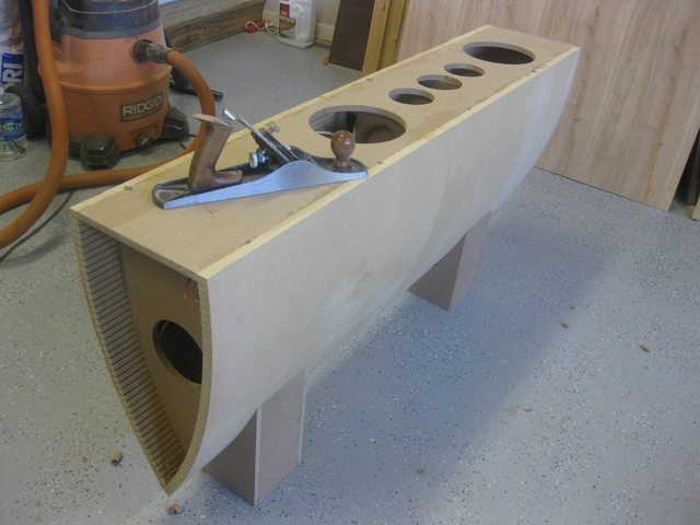

                          Continuing the cabinet assembly:

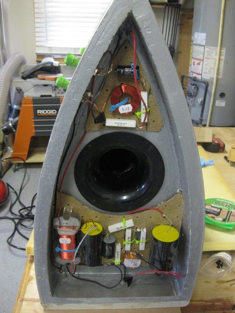

                          • Silver1omo
                            • Sep 2010
                            • 430
                            looking great!
                            Ivan.
                            My Statement monitors
                              I think on the tunnels I would of like chamfered the outside edge so it gradually goes down to a point, would look a bit smoother from the outside. Might not of worked though? Of course that's just a detail thing and not something you'd see all the time. They do look quite neat though!

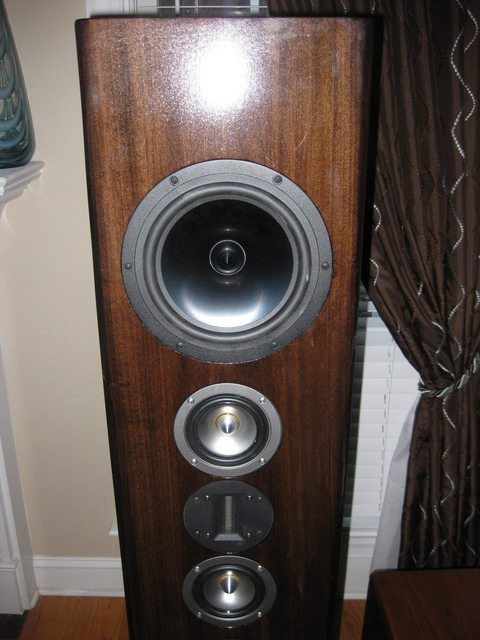

                                  I put a hold on the finish, I just realized I don't have a 3/4 round-over bit (only 1/2) and one of my RS225's is make a cracking noise when played near movie volume. I gonna put another piece of stainless tube in the tunnel opening or even a one inch walnut dowel piece.

                                  • john trials
                                    • 449
                                    Cool looking Statements!
                                    The crackling noise is probably grit in the voice coil area. I (and many others) had it on some of the RS drivers. Try some compressed air around the phase plug to blow it out. I used 20Hz and 30Hz tones along with compressed air to blow the voice coil area clean. The noises from my drivers were easily reproduced with 20Hz tones, so that was helpful in indicating when the driver was cleaned out.

                                                    • Biermann
                                                      • Aug 2009
                                                      • 51
                                                      Nice work.
                                                      Do you plan to fill the inner voids of the kerf cut outer sheets?
                                                      • bigbardmusiq
                                                        • Jul 2010
                                                        • 94
                                                        Originally posted by Biermann
                                                        Nice work.
                                                        Nope, I had to bondo the kerfs near the mid tunnels and the false bottom (my crossover compartment). The very top is a half inch mdf covered by 1/2 in hardwood. the sides have a 1/4in walnut veneer board wrapped around the mdf.

                                                            Originally posted by bigbardmusiq
                                                            Great job! :T

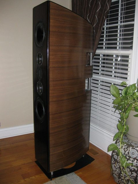

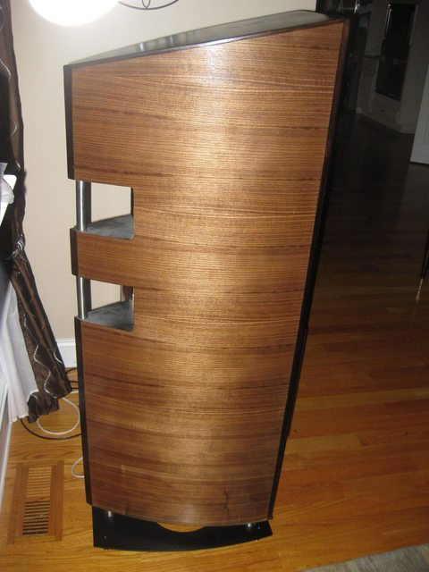

                                                            • joeybutts
                                                              • 476
                                                              Those are beautiful....
                                                                VERY pretty! :T
                                                                • tpremo55
                                                                  • 114
                                                                  Gorgeous speaker! Wonderful finish.
                                                                  ...I hope you enjoy them as much as I have.
