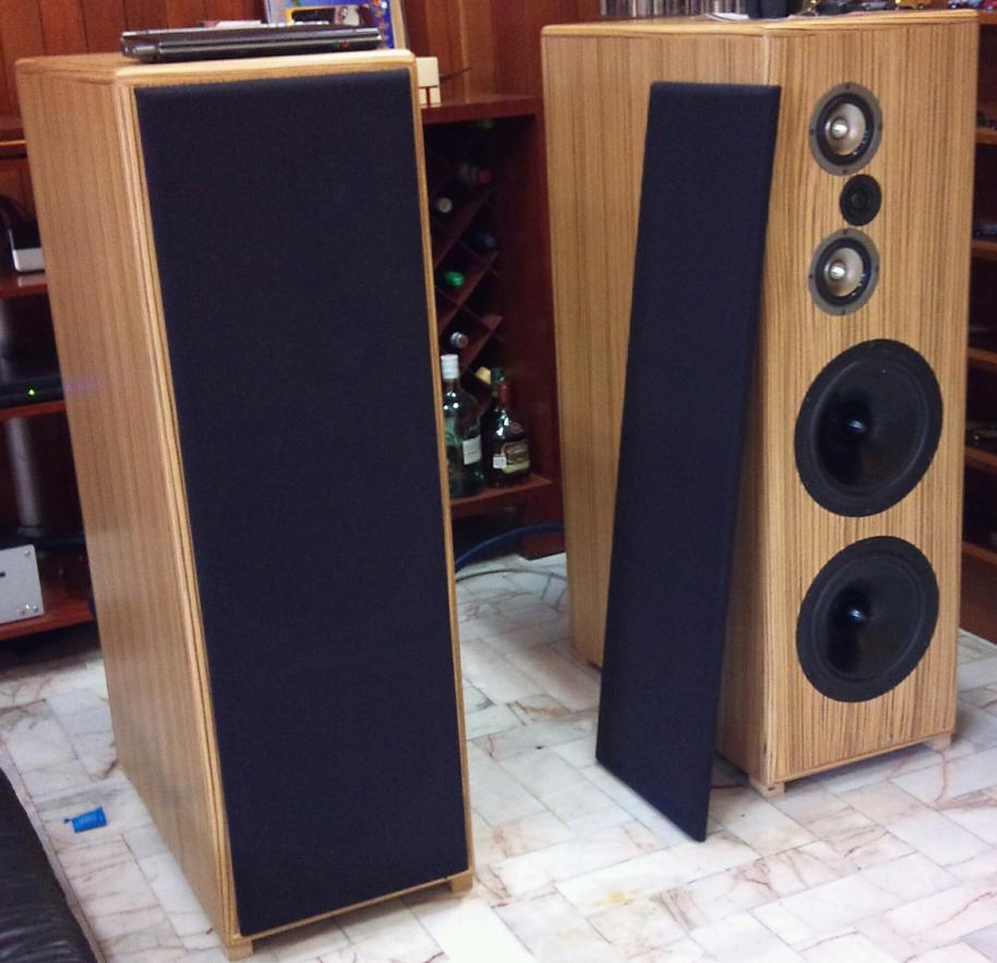

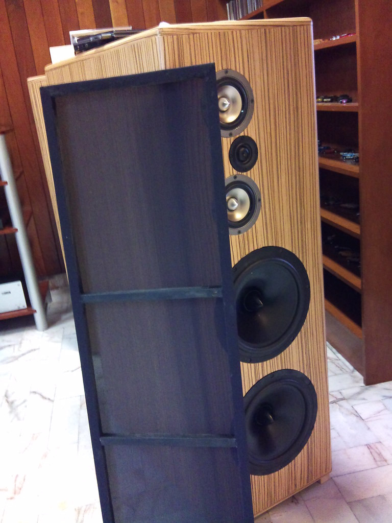

          Still waiting for the crossover parts. They are getting closer. Meanwhile... new grilles!
          Grilles off: no holes or markings anywhere.

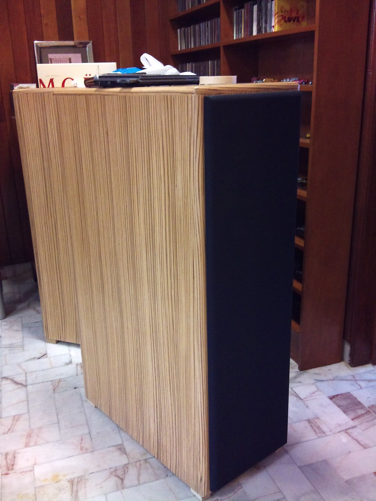

          Grilles on: still no holes or markings... love them!

            Beautiful work on both the XO and cabinets.

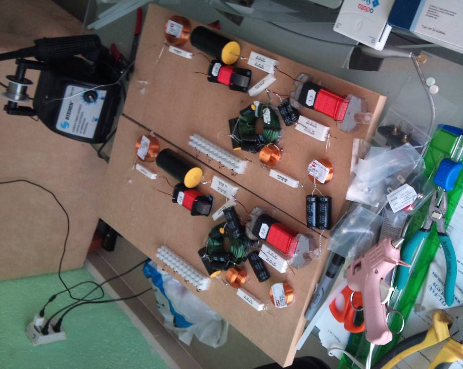

                #97
                Thank you Paul!
                Taco, I began building the x-overs yesterday. I'm using a single board of MDF. It's bigger than needed, because I'm simply terrible at building crossovers. Most of the time when I look at all of your work I wonder how on earth can you be so tidy!

                  #98
                  It's ugly, but electrically and structurally (lots of crimping and gobs of hot glue) so far, it's OK.

                          Wow, good work. Your x-over boards turned out very nice. Do you have enough space in your next home for these babies?
