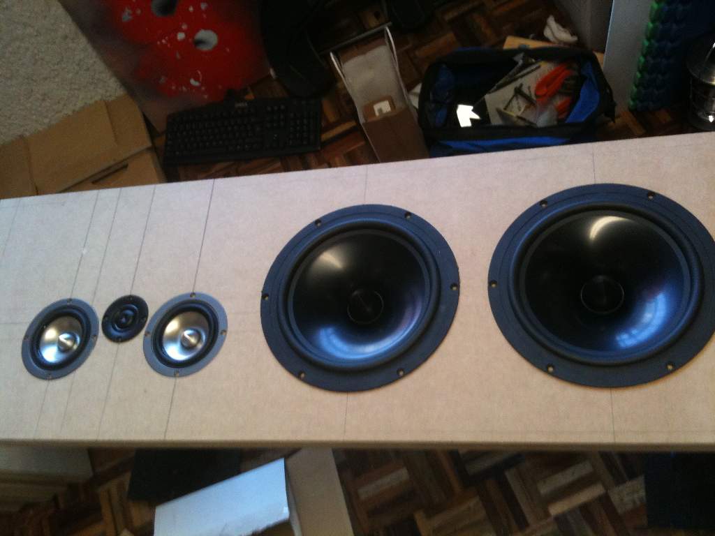

        Memos to myself:
        1) Next time, wear earplugs or something.
        2) Even when measuring, routing, measuring again and routing, I should measure once again. There was a quarter of a circle that still was 1 mm. short. I don't know how it happened.
        3) Small mistakes can be corrected with the Dremel cutting circle jig and lots of patience
        DONE!!! Now to design the midrange enclosure and the bass one.

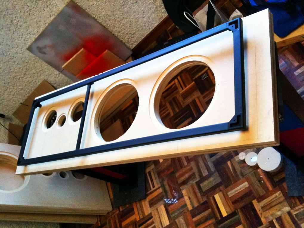

                        Not much was done this week-end. I did the pilot holes (is that the way they are called?) for the drivers and got some cosmetic screws for the tweeters. I already drew the midrange enclosures, and cut the grilles.
                        I got the Parts Express kits. They say they are made for big speakers, PA systems and vintage stuff. I agree. I couldn't believe the size of the frames, they are really huge. And I think at least parts of them are made of fiberglass. Sturdy stuff.
                        After cutting and measuring, I finally got my grilles. They'll look fine, although
                        1 I still can't find a 5/8 bit, which is needed to install the grill to the baffle, and
                        2 I haven't yet glued the cloth to it.
                        I may have someone else finish the grill, since I have no clue as to how to properly fix the cloth to it.

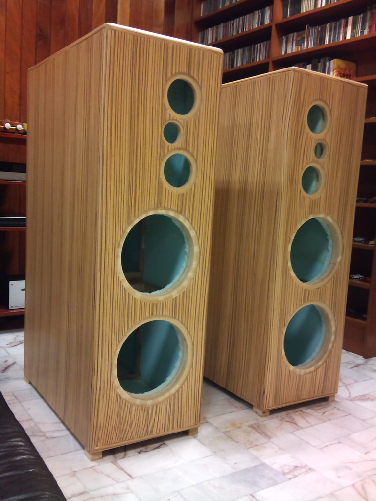

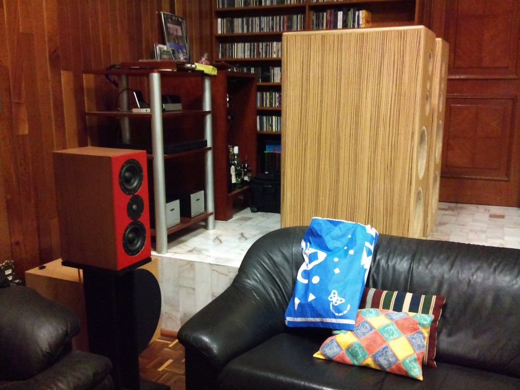

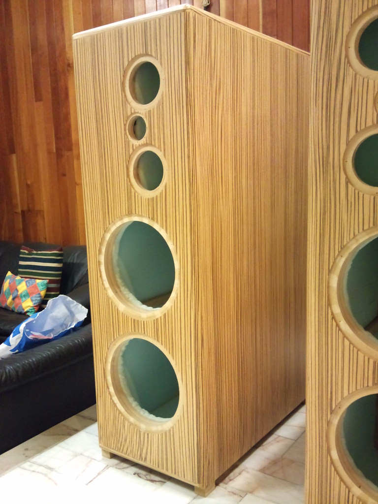

                                          • fjhuerta
                                            • 1140

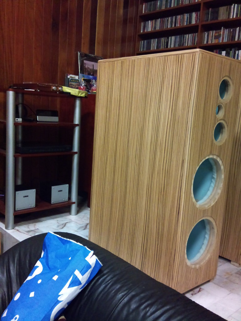

                                            Oh boy. These things are really heavy...
                                            Well, for me at least. They are close to 130 pounds. Without any drivers or crossovers.
                                            And they are HUGE. My wife gave me that look that said.... "yeah, you said they were big, but THIS?"
                                            But, wow... are they pretty. The guy who did them was proud of them, now I can see why! ;x( He even added the magnetic grille, but sank the magnets behind the Zebrano wood. So I can run them with or without grilles without the ugly looking holes I had before!
                                            Pics... just check out their size when compared to my current speakers...

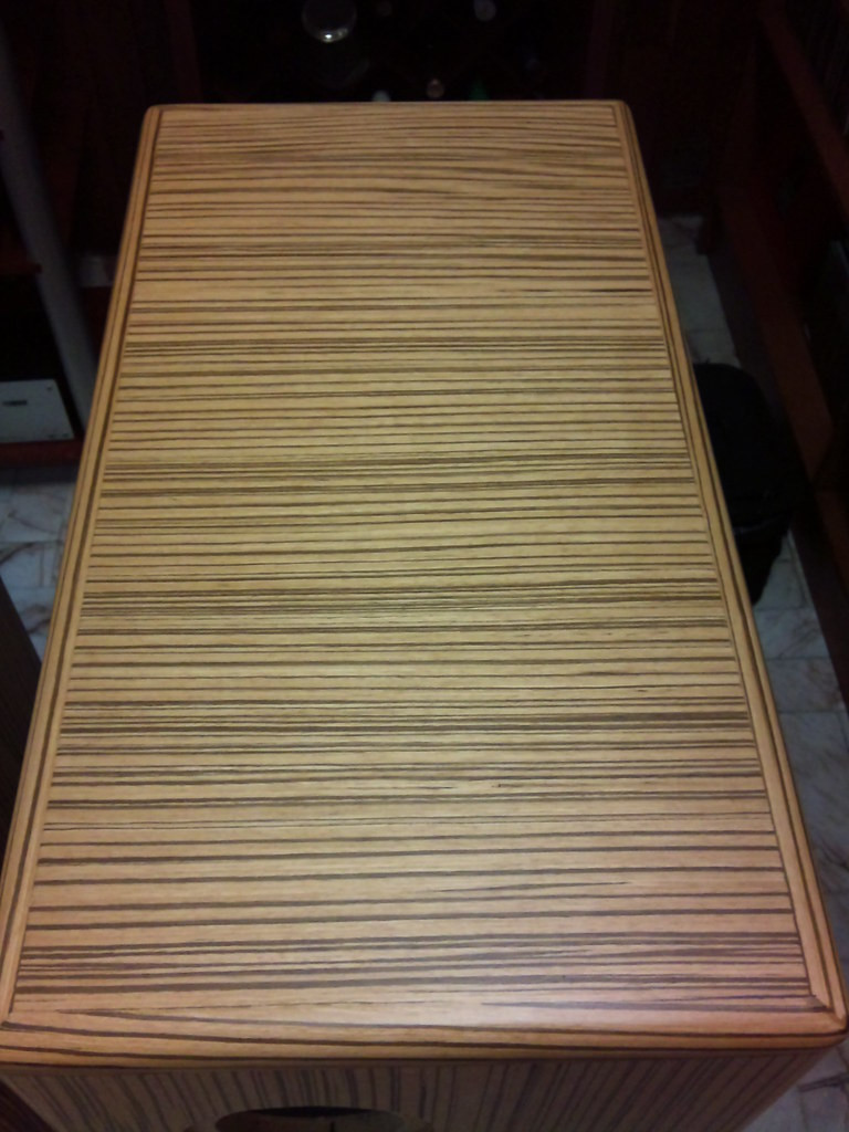

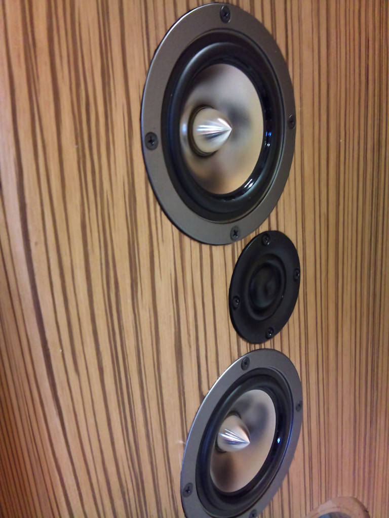

                                                • fjhuerta
                                                  • 1140

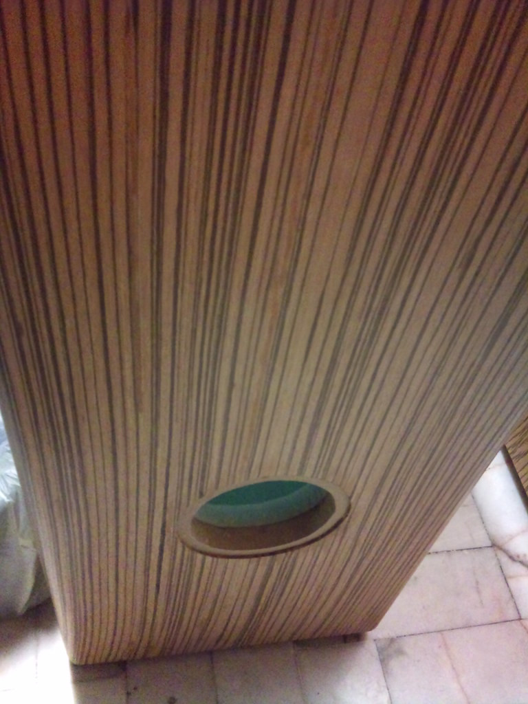

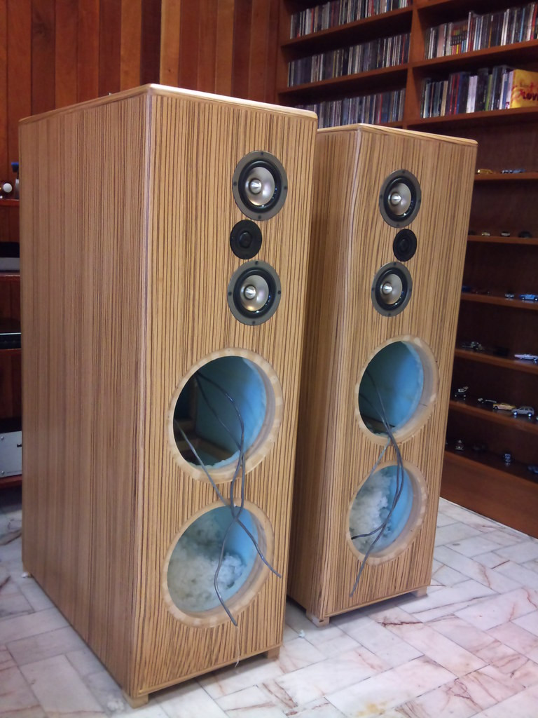

                                                  I've been slowly working on the speakers. 1 ~ 2 hours a day. I finally managed to finish the midrange enclosure. It measures 17 x 45 x 14 cms, and it's completely sealed from the rest of the enclosure. It's fully lined with 1" foam and completely filled with polyester.
                                                  Those Tang Bands are really wonderful-looking drivers; probably my all time favorite. The SB Acoustics tweeter fits very neatly between them.

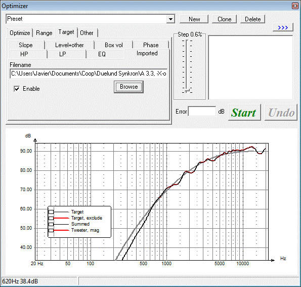

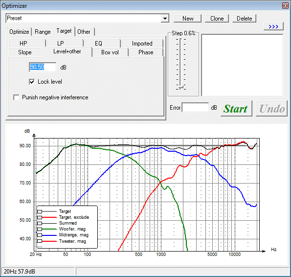

                                                    Here's where I'm at. I like the Duelund curves. So far I've only built a single speaker using it (the Zaph ZDT 3.5 with a different filter) and I was happily surprised at how the design managed to blend every driver perfectly.
                                                    So, a Duelund could sound like a natural filter for the speakers.
                                                    Trouble is, I know the RS270 starts behaving badly at 1 KHz. The Tang Band and the SB tweeter don't worry me at all, the W4's break-up occurs far too high and the tweeter is a champ. But I don't know - if I aim for a 300 ~ 350 Hz crossover point, will a 20 - 1,000 Hz bandwidth be enough with a Duelund filter?
                                                    Time to start reading again...
                                                    Javier Huerta
                                                    • fjhuerta
                                                      • 1140
                                                      Some more food for thought...
                                                      1. Crossover topology: Quasi - Duelund vs. 4th order L-R. 4th order is tempting. I know phase will be easily aligned. It's relatively easy to design. Component count is decent. BUT... and this is a big one (lol): I can't seem to get a decent enough impedance out of the woofers / mids, since they both drop to 3.x Ohm at certain points. And I cannot do a series connection on the mids, since their efficiency is too low to cross them over to a pair of RS270s in parallel. Quasi - Duelund means 2nd order, and as far as I've been able to model means slower slopes (obviously) and less aggressive impedance plots. Which leads me to...
                                                      2) Inductors: If I use iron cores, efficiency goes up. I reckon I could get away with 4 dBs of BSC and end up roughly with a 90 dB/W speaker, but even with a 2nd order slope, impedance *may* reach 3.1 or 3.2 Ohm on a good day. Also, the saturation issue with the iron core worries me - I'm spending so much money on this project, I don't want to try to save some dollars on a stupid thing like that.
                                                      3) FR on the woofer. I know for a fact (MarkK's pages) that there's some funky business going on at 700 Hz, even though PE posts don't show it, on the RS270s. I don't know if 300 Hz 2nd order will be enough of a roll-off.
                                                      4) Crossover component quality - should everything be poly? Are 10W resistors enough=
                                                      I'll be doing some reading on Duelund style crossovers, but I studied Zaph's big SB12.3 pretty closely, and this is what I found.
                                                      1) 90 dB with 2 RS270s is easy, he got 91 out of a single 12" SB woofer after considering floor bounce, etc. That will be my aim.
                                                      2) Iron core inductors on the woofer are OK.
                                                      3) Electrolytics are OK in shunts.
                                                      4) The big SB 12" driver has serious issues at 550 Hz, and he got away with a 250 Hz 2nd order crossover.
                                                      I think I won't have any issues with my design, all things considered. I *think* I'll go with iron core inductors on the woofers in order to get as much bass out of them as possible. Once I have real life SPL / Z data I'll see if I can get away with, say, a 3.4 Ohm impedance throughout the bass (my self-imposed lower limit). If I can't, "back to the drawing board" I'll go (and I'll probably use air cores).

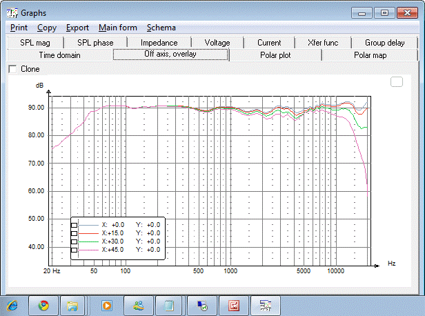

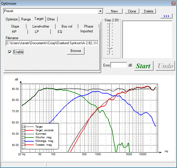

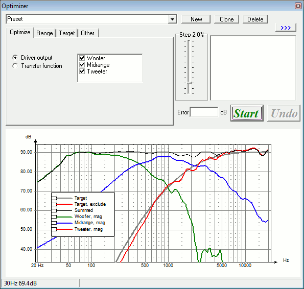

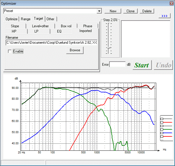

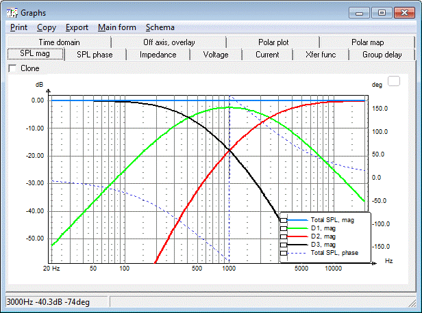

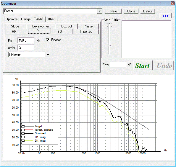

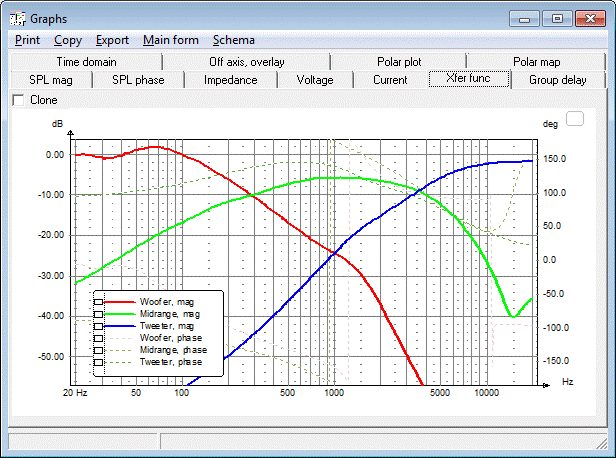

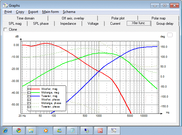

                                                            Yep, I'm still not convinced about the 2nd order roll-off. I've been reading Jon's excellent post on Duelund crossovers:
                                                            I *think* I can get away with this. Was the 270 clean to 1 KHz? I think it is - not as clean as a paper or poly woofer, but it gets there (at least according to PE's LMS files). I did some tests, and
Name:	2nd order 450 Hz.gif
                                                            It can do 1 KHz. It all goes downhill from there, but I don't think it really matters.

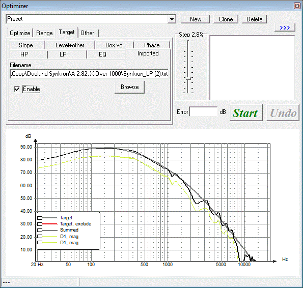

                                                            It's not exactly 2nd order, it's faster. This is 2nd order.

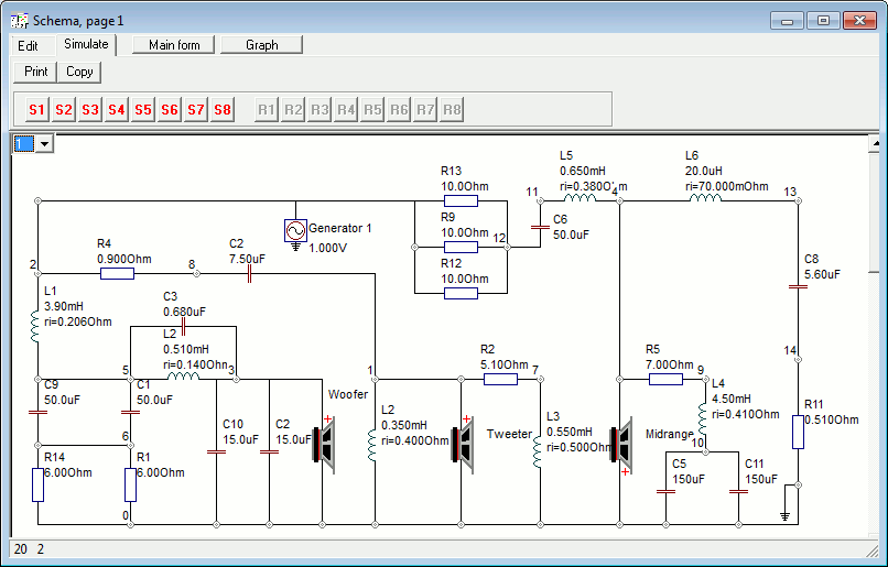

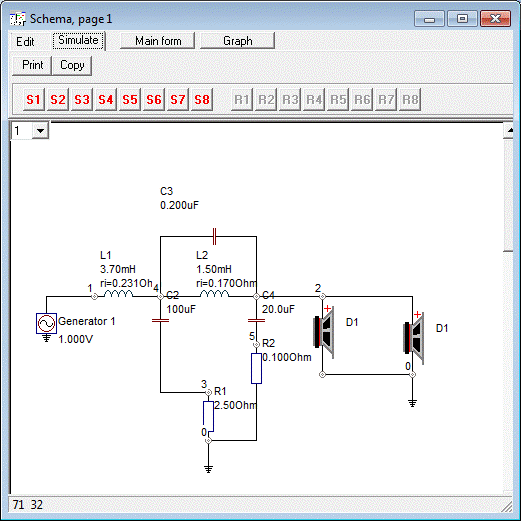

                                                            The schematic:

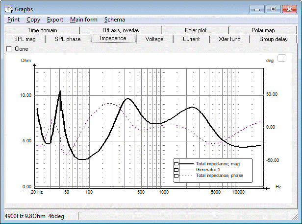

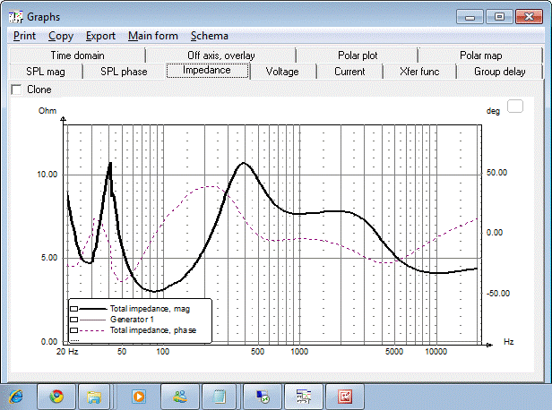

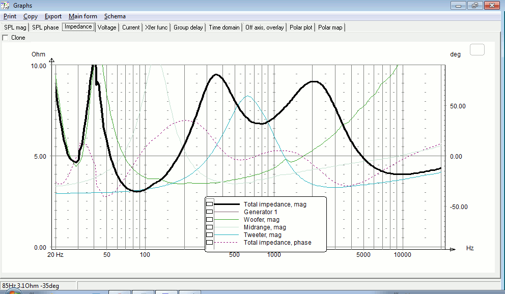

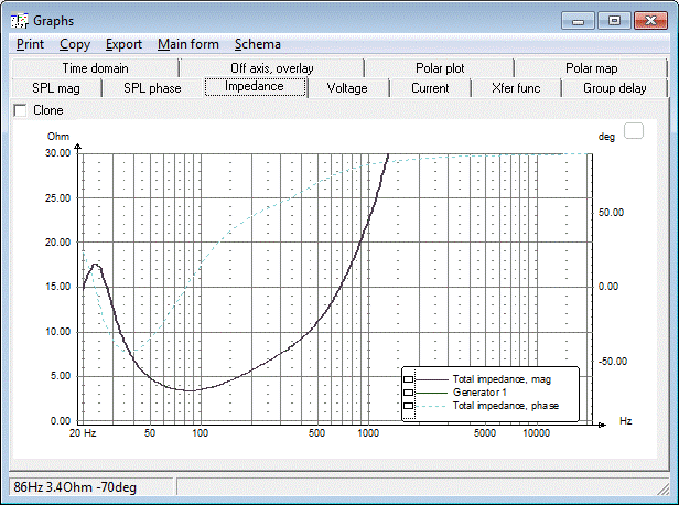

                                                            And the impedance: 3.4 Ohm minimum with iron core inductors! :T
                                                            I've used the KHF Tool on LSPCad and the Parts Express LMS files before when simulating woofer response, and the model always matches real life measurements pretty closely, so I'm hopeful a Duelund crossover, 1KHz center frequency with an Aleph of 2*sqrt(2) will work with the TB W4-1337sd. It can certainly do the 175 - 6,000 Hz required bandwith without any sort of issues. I just hope phase lines up correctly...

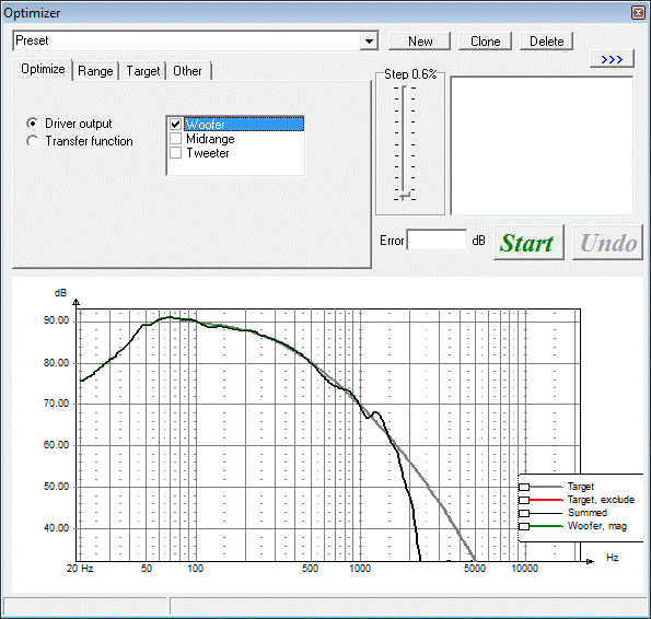

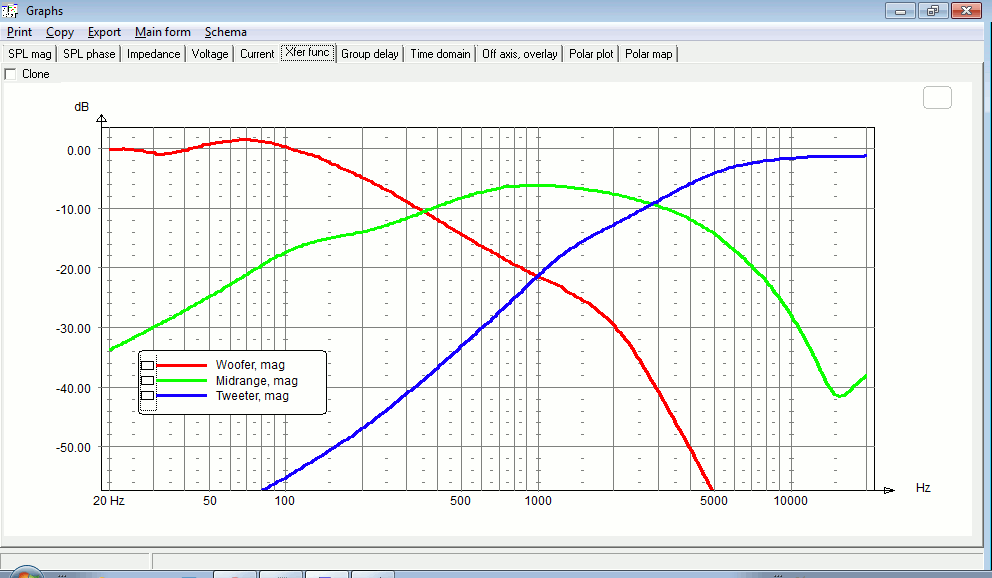

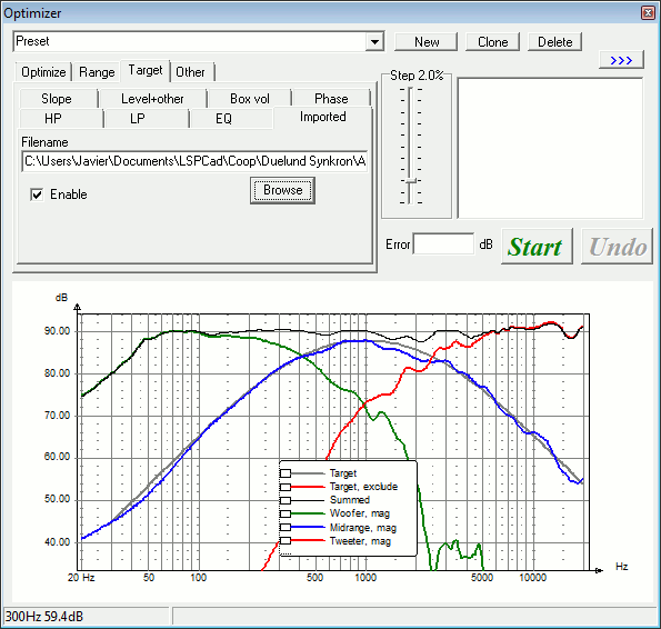

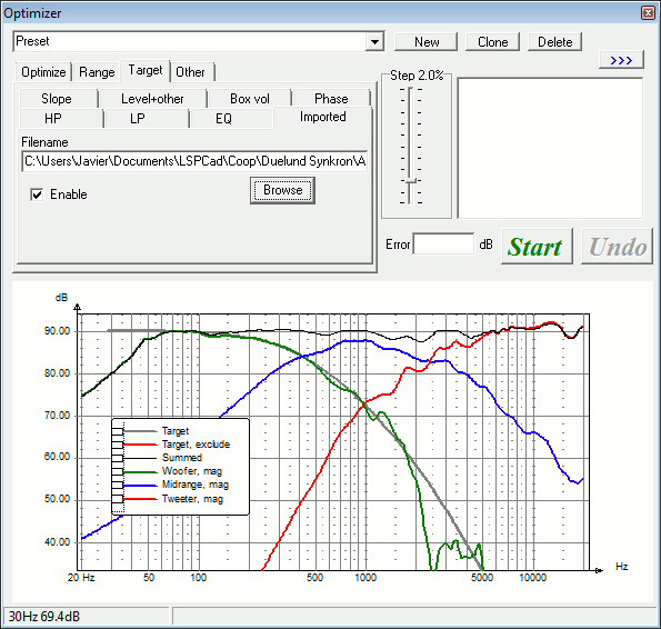

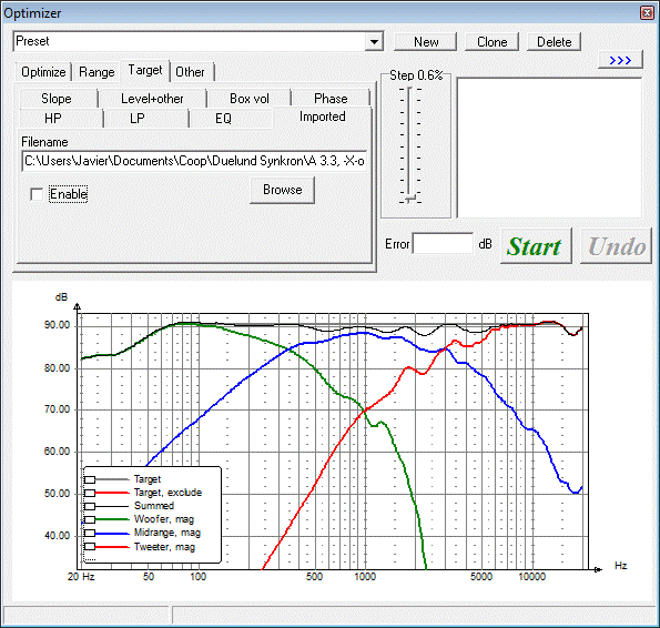

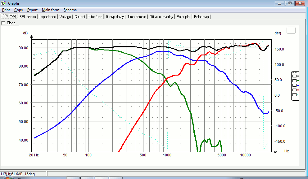

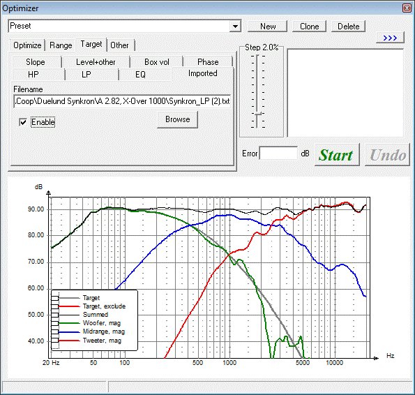

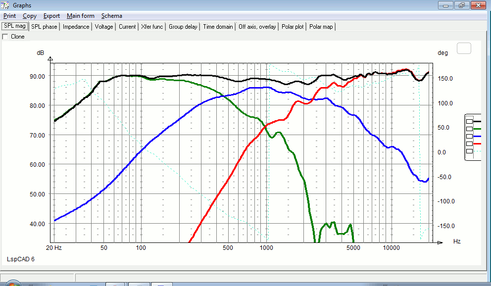

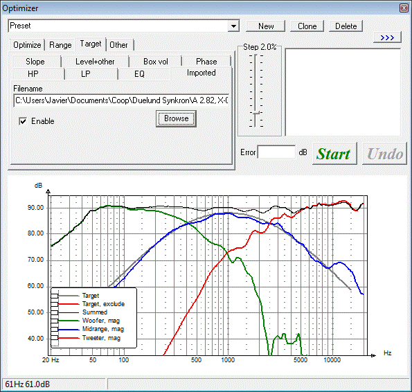

                                                              This is a Duelund filter with an Aleph of 2.82. I got the number from Steen Duelund's site - he recommends it if you can get a midrange driver that is up to the task. A pair of W4-1337sd's can do it, I'm sure.
                                                              -18 dB points for the midrange are at 160 and 6,300 Hz. The woofer rolls off fast enough, I think, and the SB can certainly do 1KHz at -18 dBs. This is my target for this project.

                                                                    Hi C!
                                                                    The graphs weren't smoothed, they are the LMS files Parts Express had for download a long time ago.
                                                                    I already took some measurements and modeled using real data. Things were pretty close to simulations, except for the break-up. Somehow, I don't think the off-axis aspect of it was reflected correctly. Nevertheless, the topology works well.
                                                                    So far, I've optimized for FR and phase. There's a bit of the mild W4-1337s break-up at the upper end, but whenever I get rid of it, phase stops tracking correctly between the midrange and the tweeter.
                                                                    There's no smoothing on the woofer measurements. I did model for diffractive baffle step, so it's there. I didn't consider the port output at this moment. The tweeter and midrange do have a 1/12th octave smoothing, because I took my measurements at 2.2 meters, and there was quite a bit of noise in them.

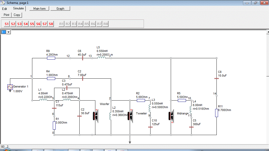

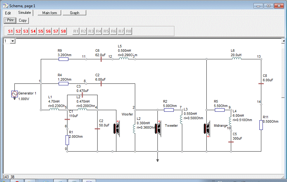

                                                                    The schematic.
                                                                    Crossover points at 410 and 2,500 Hz. Topology: Duelund, Aleph = 2.828, Fc = 1 KHz.
                                                                    There's absolutely nothing out of the ordinary, it's just that I decided to model the whole thing in a different way. It's a 2nd order electrical on the tweeter, a quasi-fourth order on the woofer with Rs across the Cs in order to shape the curve to a 2nd order, with an electrical trap for the break-up. The midrange is harder to describe - I'd say it's a first order on the high-pass, and a 2nd order on the low-pass.
                                                                    I tried to keep component count to a minimum.
                                                                    FR.
                                                                    90.5 dB/W efficiency, using iron-core inductors on the woofers Yep, the TB's wouldn't make it while wired in series, but in parallel they reached the goal without any issues. The tweeter was loafing around, its efficiency is close to 95 db/W.
                                                                    Impedance.
                                                                    OK, so impedance is closer to 3.1 Ohm in the bass. No way I can raise it without messing the FR, not at this point. Not bad everywhere else.

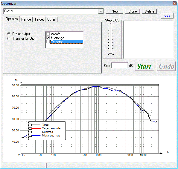

                                                                    Bandpass.
                                                                    As smooth as the TB is, doing a simple bandpass filter with the minimum amount of components is hard. Nothing to notice here except for the fact that I didn't compensate for the upper mild break-up. I'm not sure I'll do it at this point.
                                                                    Notice the big RLC network - absolutely necessary in the lower end, IMHO.

                                                                      Transfer functions.
                                                                      Smooth and unexceptional. I love working with the W4-1337 and the SB29 - they are so smooth, there's not much work needed with them. The RS270 plays low, so the break-up will hopefully not be an issue.

                                                                          OK... here's a new variation on the crossover.
                                                                          I tried lower A values. Phase issues were big. The lowpass had issues - the break-up was evident and hardly controllable. The highpass was fine, but the bandpass really needed more parts in order to work correctly.
                                                                          I tried higher A values and things started getting better and better. I settled on A = 3.3.
                                                                          The topology is the same, values are different. The only reason I did it is because the W4 is the centerpiece of this design; it's small enough to work higher up in frequency, and it definitely has the needed bandwidth.This one is A = 3.3. The midrange works a bit harder (320 Hz - 3,200 Hz x -over points), but really - no big deal.
                                                                          The new -18 dB points are 140 Hz and 7,400 Hz. Still pretty much within the capabilities of the driver.
                                                                          Impedance is a bit wilder, but on the safe side. Phase tracking is at least equal to A = 2.8. But I could add an RLC shunt that takes care of the mild W4 break-up... so now the midrange is squeaky clean. And phase tracks perfecly well; better than my last design.
                                                                          I'd like to know if anyone sees any problem with the design; if there aren't, I'll work it a bit more and build it. I think a 4" driver can do 3.2 KHz without beaming - off axis simulations seem to point this out. At 15°, there's no phase cancellation, either. Sweet.
                                                                          Here it goes.
                                                                          FR

                                                                          Lowpass
                                                                          Highpass
                                                                          Bandpass
                                                                          Z

                                                                            Schematic
                                                                            Transfer function
                                                                            Off axis
                                                                            The off axis measurement is a real one I took at approximately 15° (with such large cabinets, exactly measuring 15° and moving the speaker would have been kinda difficult!). There's no phase cancellation whatsoever and FR is pretty flat. I also took a measurement at 30° - 40° and it's equally well behaved.
                                                                            So, things are moving forward, although a bit slowly. I'll keep on working with this crossover for a while and post the definitive version when I finish it.

                                                                                      Click image for larger version  Name:	Schema.gif Views:	4476 Size:	23.6 KB ID:	855706
                                                                                      Circuit topology is the same, except that I re-ordered components. Check out the 3 10 Ohm resistors in parallel connected to the midrange circuit. My plan is: R12 is not going to be soldered to the rest. I'll run one wire from the generator (+) leg to a "BSC terminal plate" mounted just above the input terminal plate. The return wire from the "BSC terminal plate" will be soldered right to the C6 input, effectively creating a parallel element to R13 and R9 . I'll then use a dual banana plug
                                                                                      Click image for larger version  Name:	091-334_HR_0.default.jpg?resizeid=104&resizeh=600&resizew=600.jpg Views:	0 Size:	48.8 KB ID:	936493
                                                                                      With the third 10 Ohm resistor (R12) soldered between the legs. If I plug in the banana plug with the 10 Ohm resistor, I'll have no BSC.

                                                                                      If I leave nothing plugged, I'll have a nice 2 dB BSC. If I replace the 10 Ohm resistor, I'll have any value in between. No need to take out the X-over boards. Cool, yet stupid

                                                                                      And the Xfer function:
                                                                                      Click image for larger version  Name:	XFer.gif Views:	3525 Size:	30.9 KB ID:	855710

                                                                                          Here are the final curves. I hope Steen Duelund is proud. I sure know the W4-1337s is one of the very few drivers that can be used this low and this high... A = 2.82, Fc = 1000 Hz.
                                                                                            Click image for larger version  Name:	A282_1khz.gif Views:	4273 Size:	48.0 KB ID:	855674
                                                                                            Actually, he recommended A=4, but the demands become even harder to fulfill, he only used heavily modified or self built drivers for these.
                                                                                            Otherwise, very nice thread. :T
