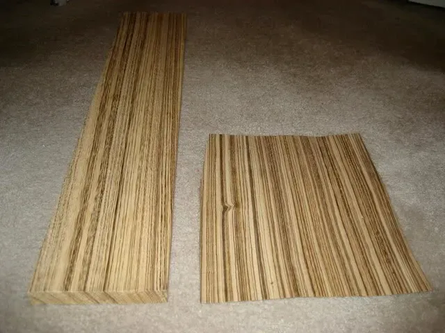

                              I know it's early, but here is a sample of the Zebrawood veneer I am planning to use.
                              Next to it is a small board of Zebrawood that I am planning to use for the outriggers.
                              The board was another purchase at the KW Wood Show, it was an unplanned purchase but I hope it will work well.

                              • numberoneoppa
                                • 535
                                Beautiful veneer/wood, should look great.
                                -Josh
                                • Jed
                                  • 3621
                                  I love Zebrawood. I can't wait to see these done in it!

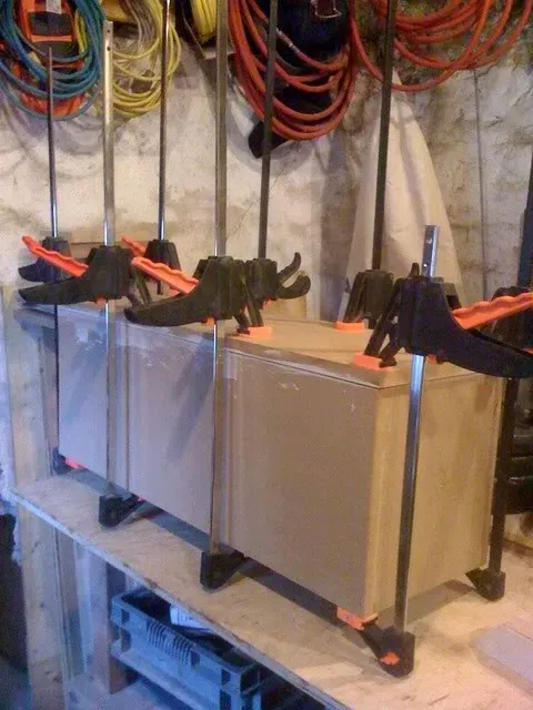

                                    Hi Guys I would like to make a quick update.
                                    I have edited a few posts today as my previous posts on other threads have been combined together in this thread, and it wasn't making sense, I hope my changes are okay.
                                    Today I got my 2rcc glued and clamped together.
                                    I am really happy to actually see something that looks like a speaker box :P
                                    I have got to say, this is a LARGE center channel, I like! :B
                                    I will probably have to start on the towers soon as I wait for the Sonic Barrier and a few other bits and pieces to arrive. I don't think I can close it in until I line it.
                                    That's all for now
                                    Thanks for reading
                                    Knights
                                    Last edited by theSven; 28 June 2023, 21:48 Wednesday. Reason: Update image location
                                    • FroDaddy
                                      • 274
                                      The pictures are a bit deceiving regarding the 2rCC's size. At this pace you'll be done with the build in notime at all!

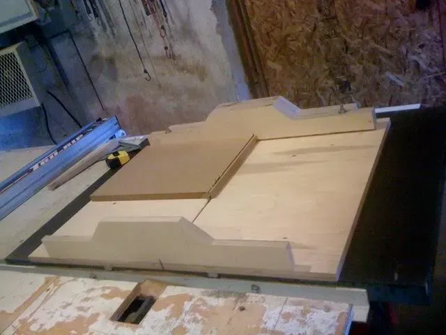

                                        I halted the build for a while because I was having a problem cutting my boards straight. All the strips were cut for me but I was having difficulty doing my cross cuts. I researched for a while and decided on a table saw sled! 8) (sorry about the fuzzy pictures I forgot my camera and had to use my phone)
                                        I just finished it and it works perfect
                                        So now back to building

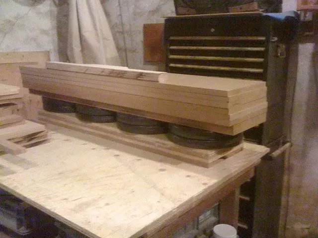

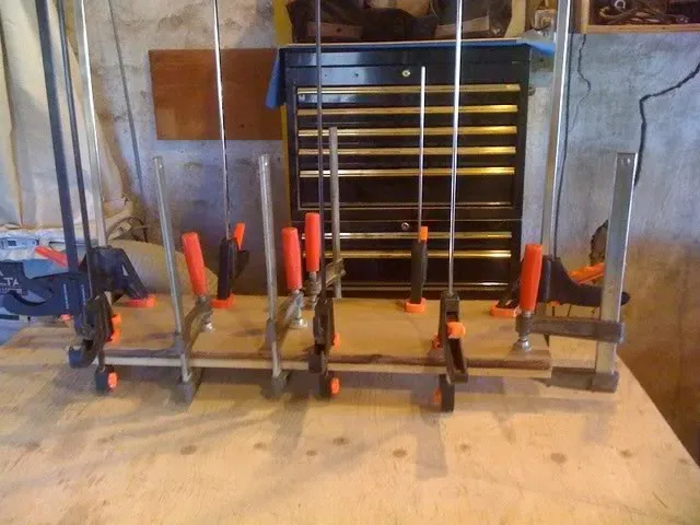

                                        I have glued up all my baffles as I want to cut all the speaker holes at once.
                                        The first one I did I clamped it and it did not stay flat.
                                        Is a slight curve anything to worry about, as a think I can clamp it flat when I glue it. Or should I make another?
                                        I learned from my first baffle and used weights the next time. Much better!

                                        Here is a picture of the back clamped on

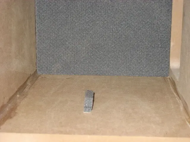

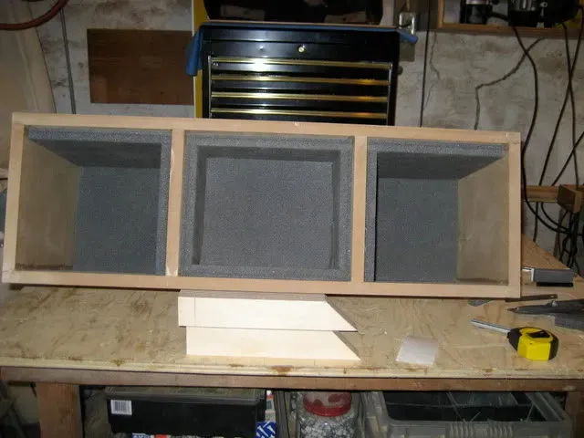

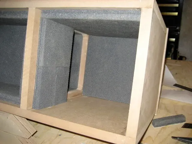

                                          I have a quick question on the application of the Sonic Barrier
                                          The BOM calls for 2 sheets and I am trying to figure out how much I need.
                                          I read that it is to be placed on all interior surfaces, this may seem like an obvious question but do I need to place it on the outside of the Mid Tweeter box? If I put it there it seems that I will not have enough.
                                          It looks like it is not needed because the brace hole does not allow for it.
                                          Any insight would be appreciated
                                          Regards
                                          Knights
                                          Last edited by theSven; 28 June 2023, 21:51 Wednesday. Reason: Update image location
                                          • FroDaddy
                                            • 274
                                            Click image for larger version  Name:	photo4.webp Views:	0 Size:	7.8 KB ID:	943397
                                            Regards
                                            Knights
                                            I covered all surfaces that the woofer could "see", and I placed sonic barrier behind the mid chamber with what little sonic barrier was left.

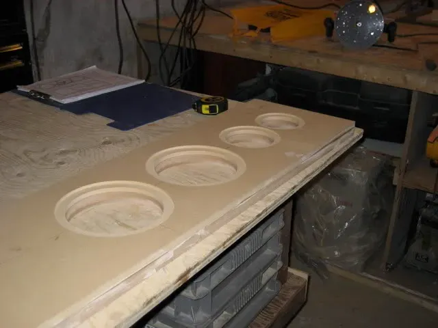

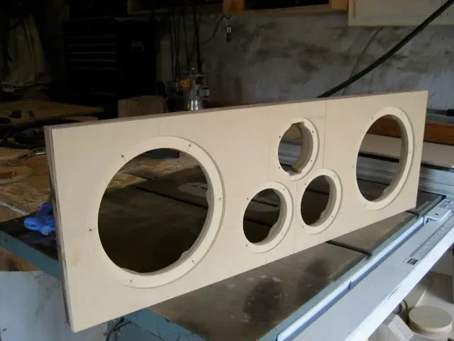

                                              I started tonight to rout the baffles and I have a question about the gasket.
                                              I got the 3/8" by 1/8" gasket from Parts Express.
                                              Should I use the gasket on the tweeter also, as it has a thin gasket on it all ready?

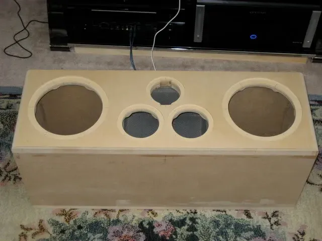

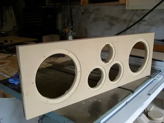

                                                  Today was spent routing baffles, slow dusty progress.
                                                  Here is a completed Mini Statement baffle, except for the extra tweeter cut and back rounding to allow the speakers to breathe.
                                                  One thing I learned quickly is to make a test hole in a piece of scrap,
                                                  ( Not Mickey Mouse) I tried every hole and recess on a piece of scrap wood.
                                                  The first hole I did came out about .020" small.
                                                  It was just slightly small but the speaker would not go in. To adjust my size I switched up to a 5/16" bit which made me just slightly larger than spec but it seemed to work well.
                                                  The next hitch, my original plan was to build the Mini Statements then eventually build a center. I then decided to build the Frocenter at the same time as my friend is allowing me to use his wood shop so space is not a problem.
                                                  So what is the problem? I bought the small Jasper jig as the biggest cut on the Mini's is 7 3/16" and the 2RCC center has bigger woofers that can't be cut on the small jig, so I am going to have to make a simple jig for the outer recess on the 8" woofer.
                                                  So hopefully I can have my baffles finished this weekend and the center baffle glued on then I can start assembling the Mini's. Hopefully my Erse order comes soon so I can build the crossovers. Can't wait to hear these speakers, things are starting to come together.
                                                  Regards
                                                  Knights
                                                  Last edited by theSven; 28 June 2023, 21:53 Wednesday. Reason: Update image location

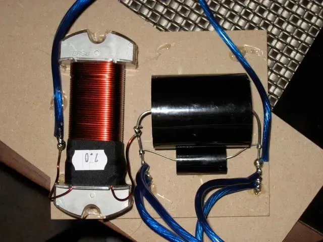

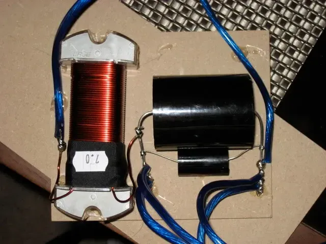

                                                          I am working on the crossover for the center and I am having a hard time with the thick speaker wire.
                                                          How are you supposed to connect the thick stranded wire to the crossover network?
                                                          Thank you
                                                          Knights
                                                            How thick? I usually use 14 ga, because it is on hand. Just twist the wires together and solder. I've not had a problem. I now use a Weller Soldering Gun. ~$28 from Lowes. I used to use a cheep soldering station. For the thick wire, the big gun works much better. I think it was Mark H. who recommended it.
                                                            • Jed
                                                              • 3621
                                                              Thank you
                                                              Knights
                                                              WBT solder has a low melting temp. What gauge wire are you using? Hopefully not thicker than 14 gauge. If you don't want to solder thick wires to the boards, you can do the Jon Marsh/Thomas W technique with the white radioshack terminal strip and just screw the contacts tight.
                                                              • KnightsOfNi
                                                                • Feb 2010
                                                                • 68
                                                                Edit (thanks K as well I missed your post this morning through the sleep in my eyes) :Z
                                                                Thanks for your reply Jed, my inexperience in speaker building is showing!
                                                                I am using eutectic solder from RadioShack and it is working great for my point to point wiring.
                                                                I have a bunch of KnuKonceptz 12g wire left over from when I wired my car system, it is beauty wire but maybe too heavy?
                                                                I can't seem to fully tin the wire.
                                                                The biggest problems are, the areas on the crossover that I need to connect more than 1 wire.
                                                                When connecting the woofers in parallel should I be running both wires direct from the crossover, or should I connect the '+' and the '-' of each speaker together?
                                                                Both ways would give me parallel but what is recommended?
                                                                Thanks again for your help
                                                                Knights
                                                                • Jed
                                                                  • 3621
                                                                  You either need to get a hotter solder iron to use 12 gauge, get some 14 gauge wire + WBT solder, or use a terminal strip. I think there is a labeled crossover picture with the connections for where the + or - goes.
                                                                  • KnightsOfNi
                                                                    • Feb 2010
                                                                    • 68
                                                                    Thanks guys I chose to get a larger soldering iron.
                                                                    What a difference
                                                                    It soldered the 12g onto the crossover no problem
                                                                    I am making two boards, the one above for the woofers and another one for the tweeters and mids.
                                                                    Do my connections look alright? First time crossover builder.

                                                                      Well today I also lined most of the speaker with 3/4" Sonic Barrier
                                                                      I must have misunderstood where the lining should go because I don't seem to have enough.
                                                                      Is this enough lining on the bottom of the speaker?

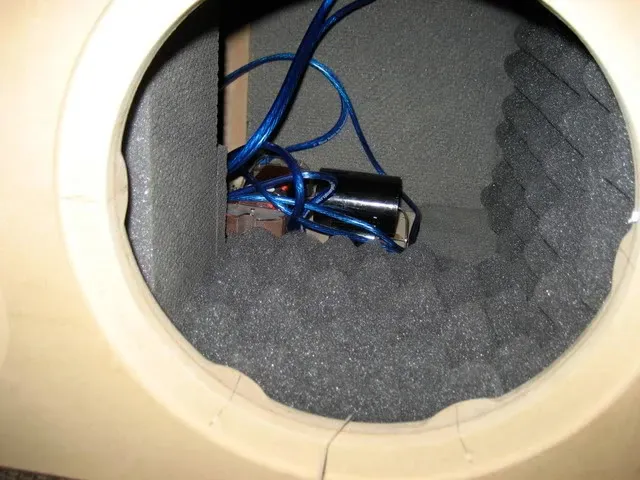

                                                                      Okay sorry I am kidding! :B
                                                                      Seriously though, I lined the back, top, Mid tweeter area and in behind on the back top and bottom and then run out.
                                                                      And another view
                                                                      Did I misunderstand or should I have got more?
                                                                      How I plan to proceed is, place the crossovers on the bottom near the braces on each side,
                                                                      then cover the rest of the bottom around the crossover and the sides with the convoluted acoustic foam I got for the Mini's.
                                                                      Does this plan sound alright? As I am in Canada getting another sheet would be expensive and take about 2 weeks.
                                                                      Another full build day planned for tomorrow.

                                                                      • Jed
                                                                        • 3621
                                                                        We didn't use Sonic Barrier behind the midrange chamber. That area is just filled with Acousta Stuff or poly fill. That's probably why you ran out of Sonic Barrier.
                                                                        I also don't recall using the Sonic Barrier on the wall that separates the woofer from the mids.
                                                                        Maybe Frodaddy can chime in on that. He's got the cabinet and put the BOM together.
                                                                        • FroDaddy
                                                                          • 274
                                                                          Click image for larger version  Name:	IMG_1164.webp Views:	0 Size:	30.4 KB ID:	943405
                                                                          Click image for larger version  Name:	IMG_1163.webp Views:	0 Size:	34.5 KB ID:	943406
                                                                          I covered the immediate woofer areas with sonic barrier first, then I placed the leftover sonic barrier behind the mid chamber. Your options are limited now, so if it were me I'd move forward with some temporary dampening on the bare MDF then put some sonic barrier there later. The front baffle is looking good btw!
                                                                          • KnightsOfNi
                                                                            • Feb 2010
                                                                            • 68
                                                                            You got me a little worried.
                                                                            When I line the remaining surfaces will having more lining than you planned have a negative effect on performance?
                                                                            Learning as I go
                                                                            Thank you
                                                                            Knights
                                                                            • FroDaddy
                                                                              • 274
                                                                              No worries, having more will deaden the cabinet more, and will produce a positive result.
                                                                              • Jed
                                                                                • 3621
                                                                                Or he could remove it from the areas that don't need it and glue it in place if the adhesive is no longer good.
                                                                                Frodaddy, is correct that the additional sonic barrier is not a bad thing since this entire enclosure is stuffed anyway.

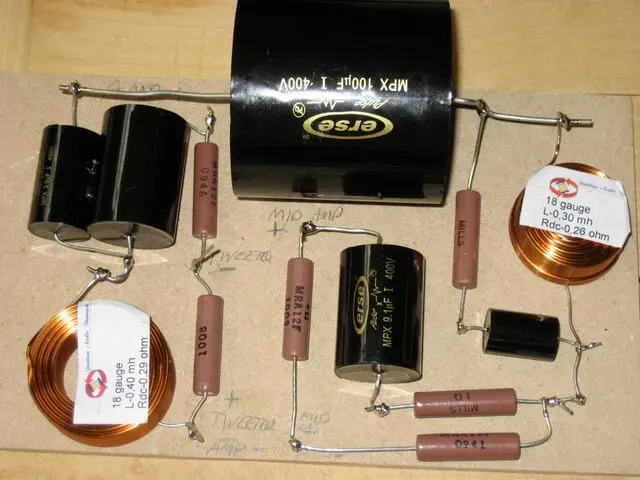

                                                                                  Just finished the second crossover board other than the hot glue.
                                                                                  Does it look alright?
                                                                                  Did I read the circuit right, the Mid and tweeter are connected out of phase?

                                                                                  The first box is finished :T
                                                                                  All I need to do is figure out what I am going to do about the Sonic Barrier shortage, install the crossovers and speakers and I should get some sound.
                                                                                  I should really be patient and veneer it first, but that pile of speakers are calling to me. (or is it my Wife telling me to hurry up so we can sell my Paradigms :W )
                                                                                  Mini Statement build should start now in earnest, baffles are already done so it should go quite quickly.

                                                                                    If you snap a picture of the woofer board I can label that too and put it in the reference thread.
                                                                                    Jed
                                                                                    Last edited by theSven; 28 June 2023, 21:59 Wednesday. Reason: Remove broken image link
                                                                                    • KnightsOfNi
                                                                                      • Feb 2010
                                                                                      • 68
                                                                                      Thanks for doing that Jed, it clears things up nicely!

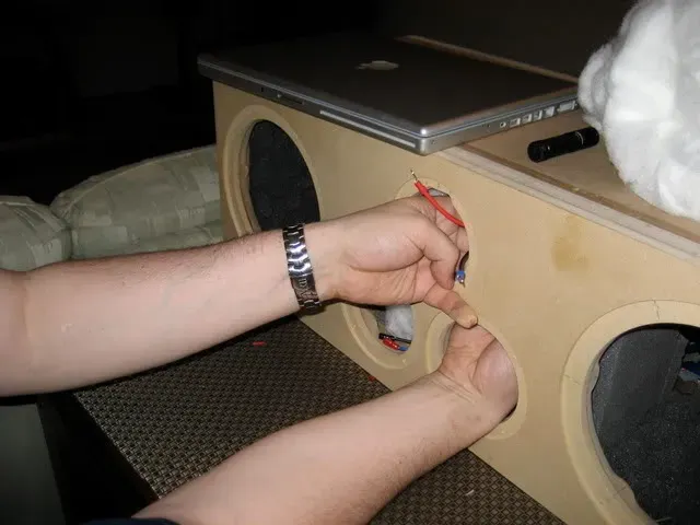

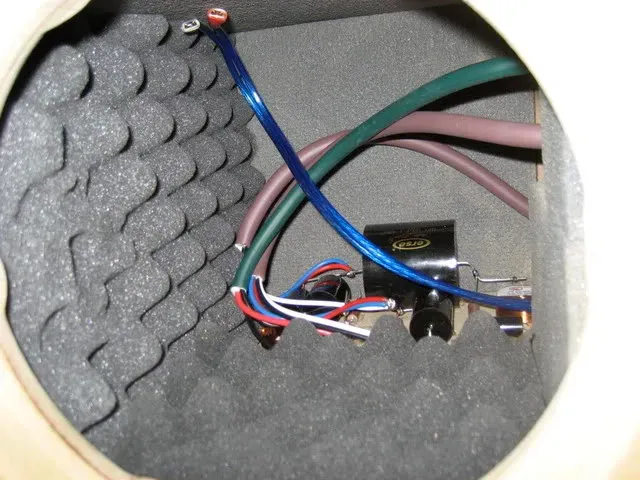

                                                                                          Here is a couple more pictures of how I got there.
                                                                                          Woofer crossover in place
                                                                                          Tweeter and Mid crossover
                                                                                          Wish I had tiny wee hands now. I was surprised how stuffed the speaker was with both bags installed as recommended, but I will trust the experts.

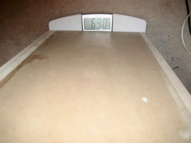

                                                                                          I quickly checked online to see the weight rating of my tv stand, it is rated at 65lbs.
                                                                                          So I wonder how much my speaker weighs?
                                                                                          I think I know what my next project is. :T
                                                                                          I am hoping to hook it in to my amp tomorrow, will report my findings (hope it works ops: )
