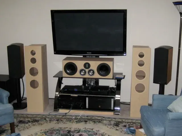

        Knights
        Last edited by theSven; 28 June 2023, 22:04 Wednesday. Reason: Update image location

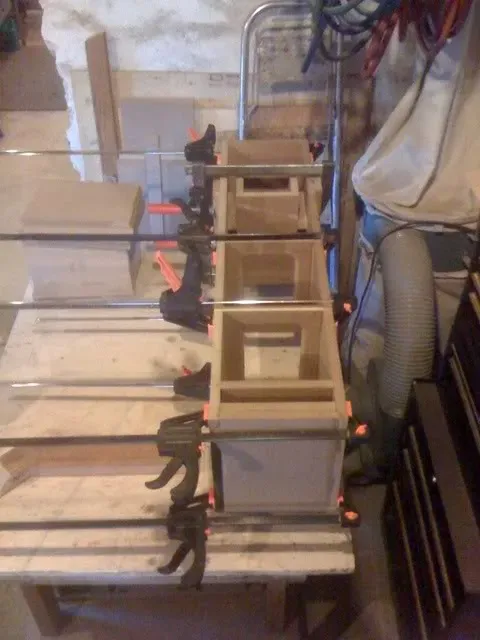

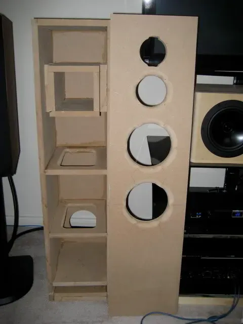

          It has been a long time since I have reported in.
          Progress has been slow but ongoing.
          The battery in my camera quit, not discharged, just completely stopped working! 2 replacements are on their way!
          Today I glued and clamped up my first Mini Statement. Sorry about the quality of the picture, (using the iphone again.)
          I glued and pin nailed everything to one side with 90 degree clamps 1 by 1, then today I glued the other side on.
          This picture shows the false bottom and the double thickness base.
          I did not like the thick base on the drawing, so I increased the cabinet length and installed a false bottom to maintain the same volume.
          I made the base double thickness because I may dado the outriggers into the base depending on the finished height.
          Just an initial comment on the 2rcc center channel, the dialog clarity is outstanding. In some systems when there is a lot of ambient sounds the dialog can be lost, not on the 2rcc 8)
          I will probably decrease the stuffing in the woofer section however, talking to Fro he wanted to tame the bass a bit for his application, for me though I would like a little more bass so I am going to experiment.
          I am truly blown away by the level of support by guys on this forum, THANK YOU!!
          That is it for now, got to wait for the glue to dry :T
          Knights
          Last edited by theSven; 28 June 2023, 22:05 Wednesday. Reason: Update image location

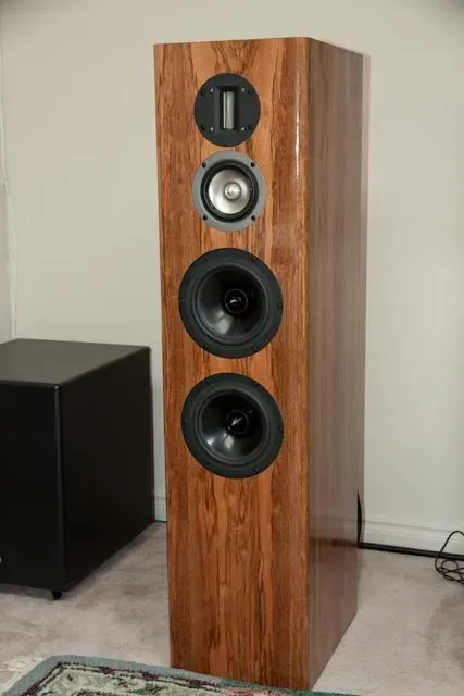

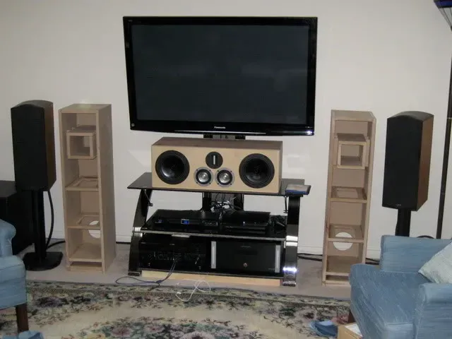

                    Well I finally got some work done!
                    I have been very slowly chipping away at them, but spring time seemed to find me so many other things to work on.
                    I brought them home to check on the mid tweet height and to install the foam on the inside.
                    And with the baffles
                    A better view of the inside
                    You may be able to see the false bottom in that picture, I made it taller without changing the volume.
                    Does anyone know if the Precision Port cut length is the same as the one in the BOM.
                    I could only source the Precision port in Canada.
                    I was planning on tall spikes and outriggers but now I have them home I think that standard spikes on outriggers will be high enough.
                    That is all for now
                    Regards Knights
                    Last edited by theSven; 28 June 2023, 22:06 Wednesday. Reason: Update image location

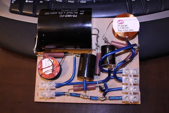

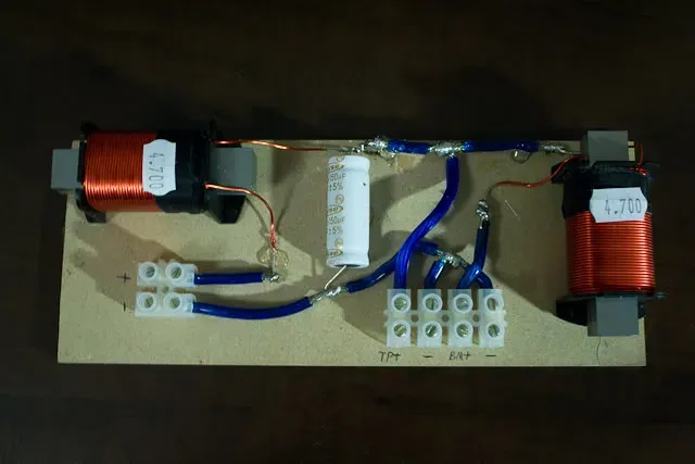

                      I had to take a break from building but I am finally back at it.
                      I have been working on the crossovers this weekend and I have got both woofer networks done
                      I am happy how they came out, the funny thing is that the 150 uf capacitors are physically different, one is longer than the other but they are labeled the same.
                      Any Idea why? Is it likely to be ok
                      I have one of the Mid Tweet networks done (note to self use a bigger board!! :W )
                      It is probably hard to tell but does my layout look ok?
                      Thanks again for all the advice.
                      Regards
                      Knights
                      Last edited by theSven; 28 June 2023, 22:07 Wednesday. Reason: Update image location
                      • KnightsOfNi
                        • Feb 2010
                        • 68
                        Cat 5
                        I know a lot of people use Cat 5 networking cable to make there own speaker wires, does anyone use it for internal wiring in there speakers?
                        I have 14 guage Neotech that I am using to hookup the crossovers to the woofers.
                        I am contemplating using Cat 5 for the Mid and Tweets, does this sound like a good Idea?
                        Also, on the crossover I noticed I have the 4 ohm resistor soldered to the ground rail before the 5.6 mfd cap.
                        As they are both connected to the same line I assumed that it was OK but now I am worrying about it.
                        These are my first speakers so I am fretting over EVERY detail!
                        Thank you for your help and advice,
                        Knights
                          Knights
                          Hi Knights,
                          The resistor position is fine.
                          I've used cat5 and didn't like it. I prefer Bluejeans 12 gauge bulk. A side note is that we're not to discuss audio cables on this forum since the owner of this forum also owns a cable company.

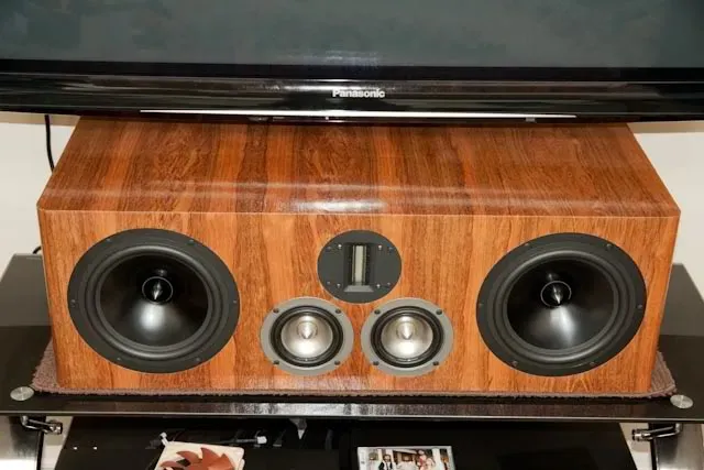

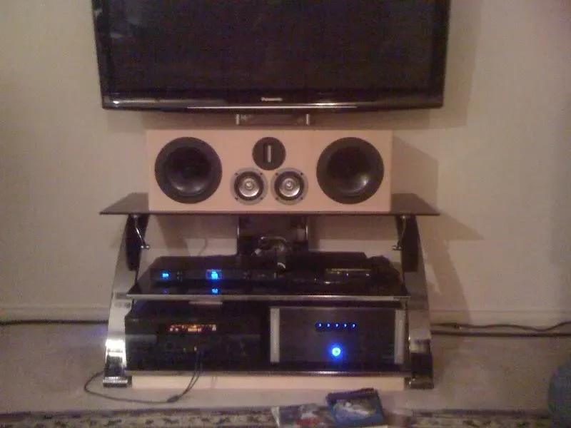

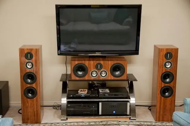

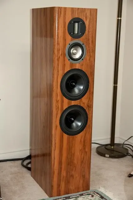

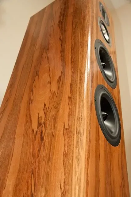

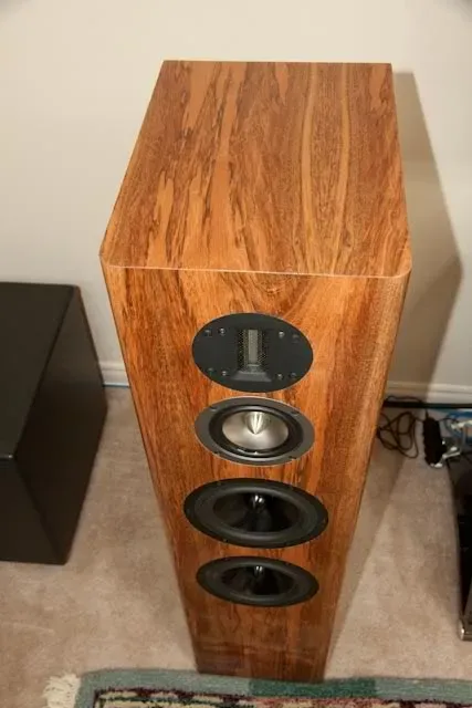

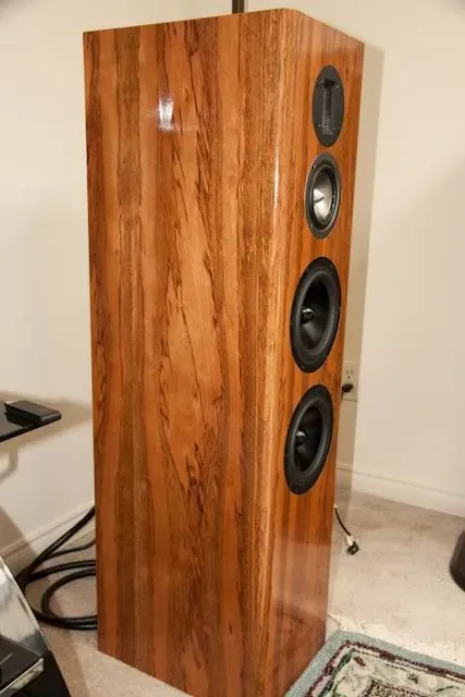

                                    Well thankyou everyone who helped me so far, the center channel is done!! :B :T
                                    I installed magnets under the veneer so I can use a grill to protect the speakers from fingers.
                                    Image not available​
                                    And a close up of the beautiful grain pattern
                                    I was planning on Zebrawood but it did not work out.
                                    In the end I used figured Jatoba with 5 coats of Deft waterbase and it came out better than I can of hoped.
                                    I now have the 'Mini's' to finish, can't wait so I can finally hear them.
                                    Thanks again for everybodys help
                                    Regards
                                    Knights
                                    Last edited by theSven; 28 June 2023, 22:08 Wednesday. Reason: Remove broken image links
                                      The center looks great! :T
                                      • snmhanson
                                        • Jun 2010
                                        • 194
                                        Looks great. Love the figure of the wood. How does it sound? I saw you had it up and running for quite a while now but I didn't see a report on your impressions. When I finished my 2RCC I thought it was a little light on the bass. The mids are great though and the bass has even opened up a bit since then.
                                        Matt
                                        • KnightsOfNi
                                          • Feb 2010
                                          • 68
                                          Hi Matt, I had the same impression as you, great mids and highs but light on the bass.
                                          So I put in a lot less fill this time when I reassembled it. I have not been able to listen properly since, but Frodaddy suggested that less stuffing would probably help.
                                          Thanks for your reply
                                          Thanks too to Jim Holtz for continuing to follow my progress your Minis are next to be finished, can't wait :T
                                          I am resisting the temptation to assemble them before veneer this time so I will actually finish them :W
                                          Regards
                                          Knights

                                                                                        Finally Done
                                                                                        I have finally finished the Mini Statements
                                                                                        Here are some finished shots
                                                                                        Low angle
                                                                                        High angle
                                                                                        My 2RCC again
                                                                                        Family shot
                                                                                        My Minis are rear ported hence no base, but I am going to make some outriggers and add spikes.
                                                                                        I set in some magnets in the baffles before veneering so I will probably make some grills to protect the speakers from curious fingers :W
                                                                                        I will add more comments later.
                                                                                        Thanks to all who made this possible ;x(
                                                                                        Regards
                                                                                        Knights
                                                                                        Last edited by theSven; 28 June 2023, 22:12 Wednesday. Reason: Update image location
                                                                                          Beautiful! :T
                                                                                          • Jed
                                                                                            • 3621
                                                                                            Those look fantastic. I love the veneer and finishing.
                                                                                            Jed
