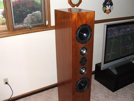

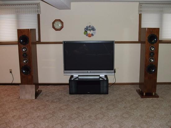

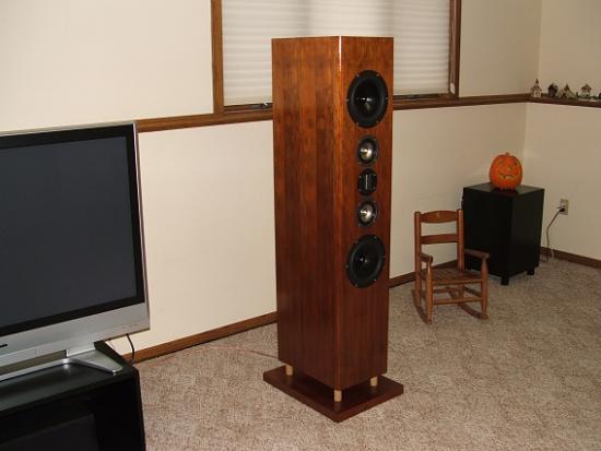

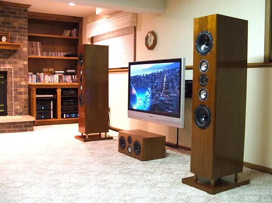

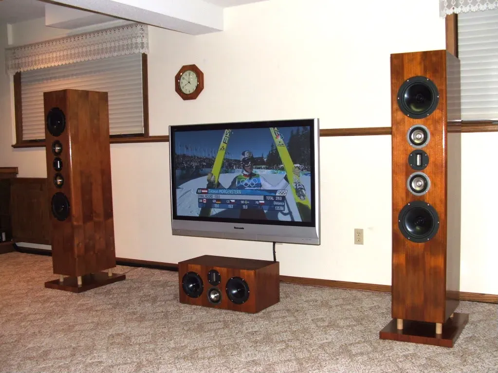

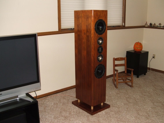

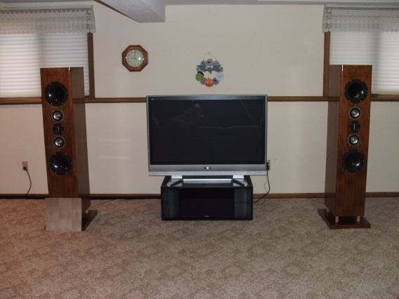

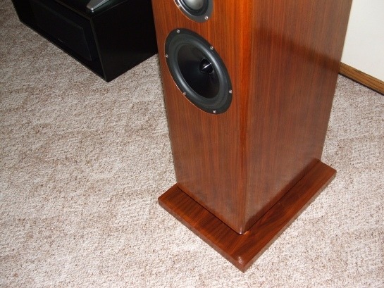

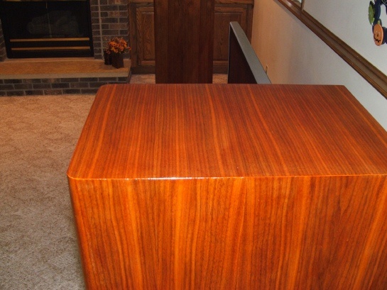

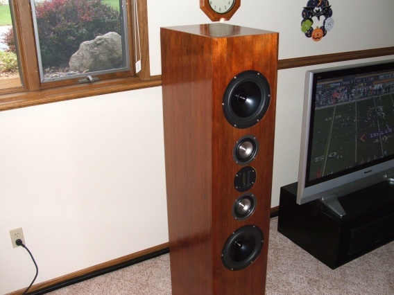

    I finished my Statements build this weekend! I'm loving them! Jim, Curt, Wayne, thank you so much. Can someone let me know what size pics I should upload? I have some pics of the finished build.

        Sawdust...Nice looking speakers. Congrats on finishing.
        We were at the same point in our builds a few weeks ago, right? I'm nowhere near done. Tung oil is SO slow at curing. I'll be happy if I'm done by Thanksgiving!

          Thanks John. Yeah we were pretty close. I've thoroughly agitated my wife in the process with the amount of time I've spent on these in the evenings. She did manage to say they were huge.... and looked nice last night!
          Keep at it and you'll get there.
          BTW, I did steal Soundemons base idea.

                Paint the "legs" black and they're IMO the best looking Statements so far! :T

                  Thanks for the compliments guys. I'm a 70's type of dude, back when walnut was on everything audio. I wanted to get back to the golden era of audio (analog)! :W

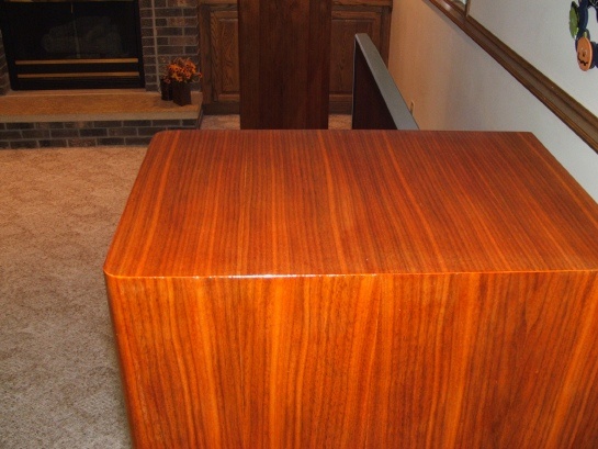

                        Looks great. What finish did you use on the walnut? From the pictures it looks like some color was added, but that could be the camera.

                            What did you use for your veneer? Those look very nice!

                                DancesWithBeers you are correct about the color. I used Transtint orange (100:1 ratio) as was recommended on several sites for walnut in order to warm it.
                                wkhanna congrats on the win!
                                rob17, it's walnut with the orange color brushed on and amber shellac and Danish oil and more amber shellac and finally wipe on poly which goes on thin enough that it doesn't get that plastic look.

                                      Excellent veneer work, sawdust! I've never seen walnut tinted - you've got unique and beautiful speakers there.

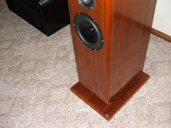

                                        I love the bases that you have them on. Functional and with great aesthetics. Nice work!

                                          Thanks guys. Locojones, I copied Soundemons base idea. I believe he is in the veneering/finishing process now and I look forward to seeing his completed build. Updates Soundemon?

                                              Having finally gotten motivated, (and able to live without the speakers for a week or more) I'm right in the middle of veneering. I'm doing it the hard way, with raw veneer, and pieces that are only 6" wide. lots more work, but only $25 for enough to do the LCR.
                                              My biggest debate is whether to do the lower base in veneer and keep the legs black, or do I make the whole lower base black...

                                                Veneer them and then cut black construction paper to fit the base as a test. If you like the black better, sand and paint. :W

                                                      The depth and luster I believe comes from the amber shellac. It takes some practice to apply as it dries very very fast; you need to thin it. A 1lb cut is what I used. Amber shellac and walnut are a match made in heaven IMO.
                                                      The orange color is added to simulate aged walnut, plus I like the look. See: http://www.woodweb.com/knowledge_bas...ed_Walnut.html

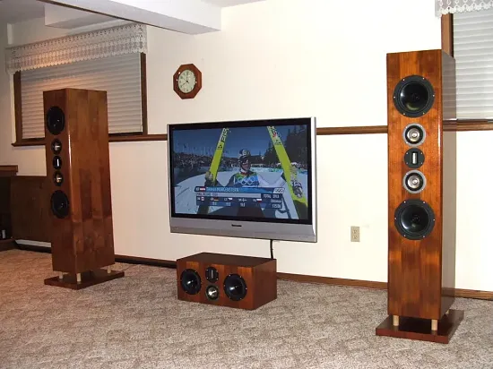

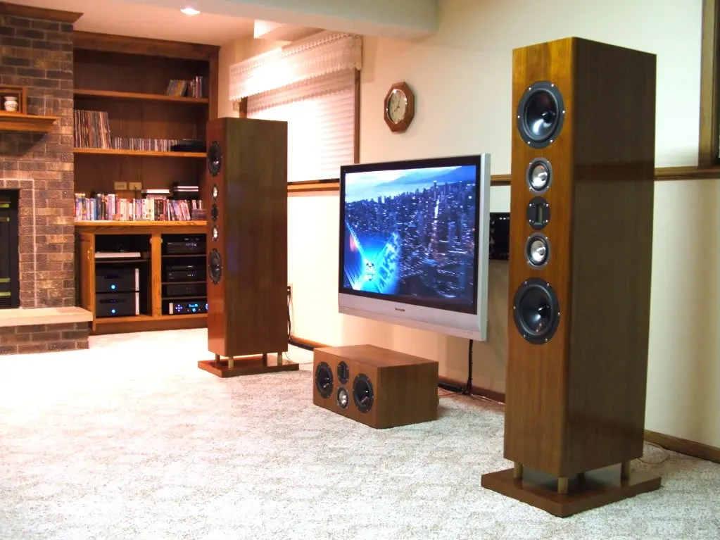

                                                            All done with the center except I think I'll make a base like the L and R Statements when the weather warms. This has been a very fun endeavor but I'm having withdrawal issues! Where's that router I bought?

                                                              Are you going to build a stand for the center there? Nice cabinet of Emotiva!
                                                                I'm going to raise the center with a stand just like the L and R have under them this spring.

                                                                  Awesome looking set up. The statements make your TV look teenie.
                                                                  have any heat issues with all that gear in a cabinet?
                                                                      Want to tell my wife that?! I'd love a 100" screen to drop down in front of it and a nice projector to watch movies on!
                                                                      No heat issues so far.
