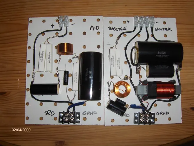

                                          I received all my components today except for the veneer which I just ordered last night.
                                          I assembled the crossover networks into 3 separate networks .
                                          Time to start cutting and installing foam.
                                          Curt , forgive me for butchering your network designs. I just cant seem to make them look pretty ops:
                                          Last edited by theSven; 25 July 2023, 08:03 Tuesday. Reason: Remove broken image link
                                          • BeerParty
                                            • 475
                                            Originally posted by Rightbrained
                                            Curt, forgive me for butchering your network designs. I just cant seem to make them look pretty ops:
                                            If you want them to look pretty, you have to use some additional wire between the pieces in (my build). If they are going into the cabinets, you don't need to worry about it since you will be the only one to see them (unless, of course, you do something foolish like take pictures of them and post the pictures on multiple forums where everyone likes to look at pictures. Oh. Oops. :W )
                                            Just make sure they are small enough to go through the woofer holes and the wires are long enough so you can install and remove them after the front baffle is attached.
                                            Last edited by theSven; 25 July 2023, 08:10 Tuesday. Reason: Update image location and htguide url

                                                  looking good! However, you do need to cover the back where the crossovers are mounted with foam or the sound waves will be reflected straight into the back of the cone of the woofers.
                                                  Also, can you get the crossover for the ribbon through the ribbon cutout in the baffle? I'd strongly suggest you be able to get all of the crossover boards out after the speaker is assembled, just in case. :W

                                                    Thanks Jim,
                                                    I will pull the tweeter board back out and trim it down some to be sure it will fit through the cutout .

                                                        I would SERIOUSLY consider redoing the xo boards. They look like they are well constructed but without a removable baffle you will not be able to get those out. Trust me when I say that a time will come where you wish you could get at those. (:

                                                          With the crossovers mounted directly behind the drivers, wedging foam or fiberglass around and in the crossover boards is about the only solution. I prefer to mount my crossovers low and on sidewalls. That way they're mounted below the drivers and it's easy to apply deadening material behind the drivers.
                                                          Brian is also correct that the crossover boards should be sized to allow then to slip through the driver cutout. I've had to take out many crossovers for "tweaks" after the speaker was completed.

                                                            I ended up moving the ribbon boards and installing foam in front of the boards.

                                                                                          • mt1962
                                                                                            Mini statement 3 crossovers
                                                                                            by mt1962
                                                                                            Are there any pictures available of the Mini statement 3 corssovers ? Also any details on the speaker termination panel.
                                                                                            I am just embarking on the project and have searched the forum but cannot see details on this part of the project.
