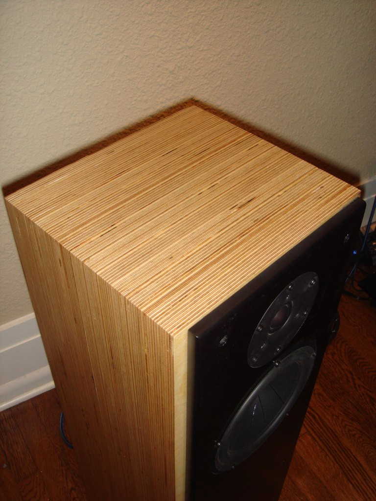

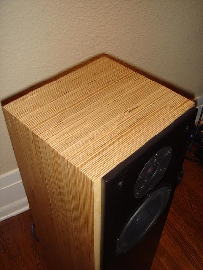

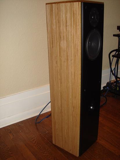

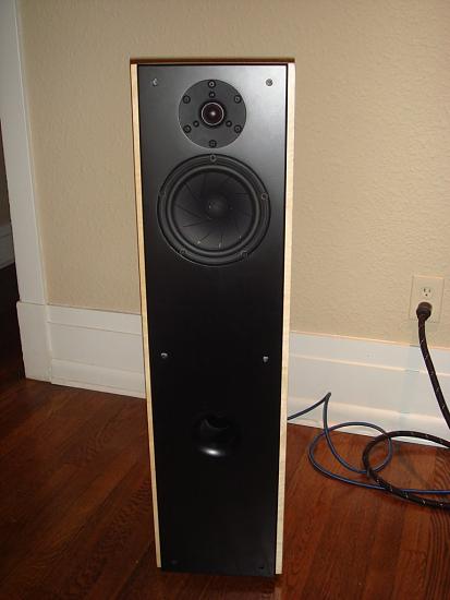

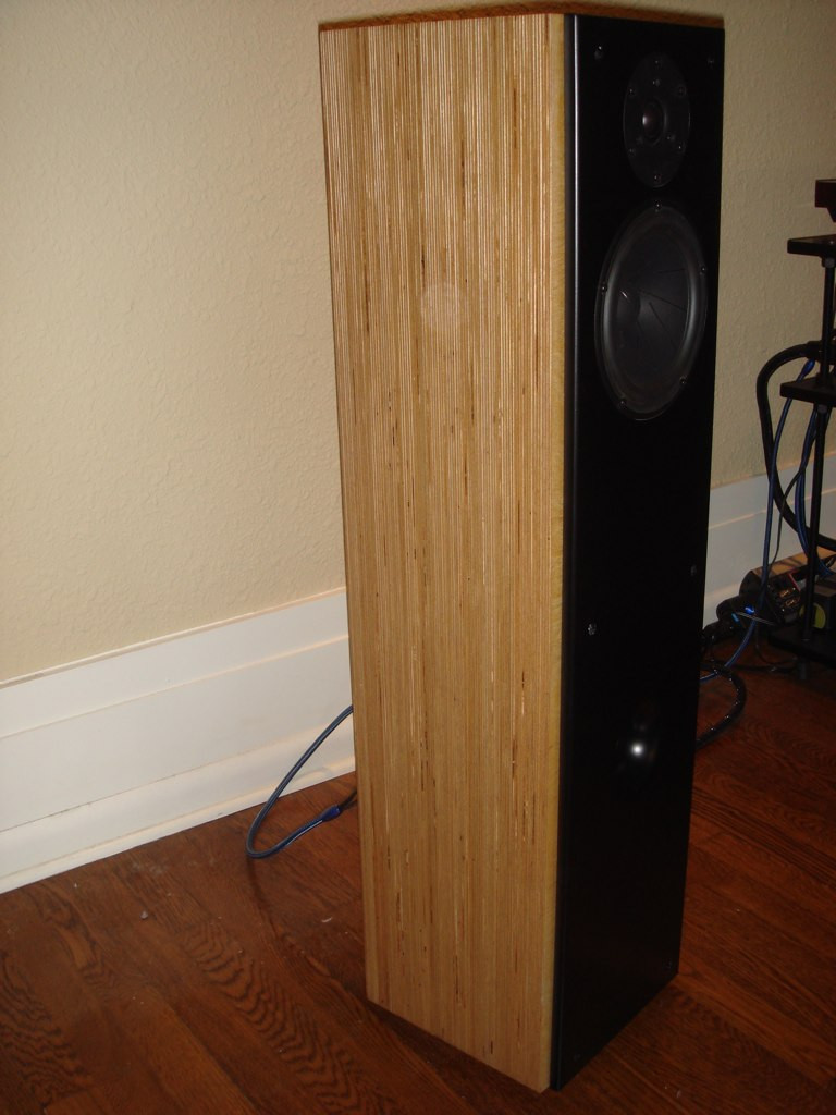

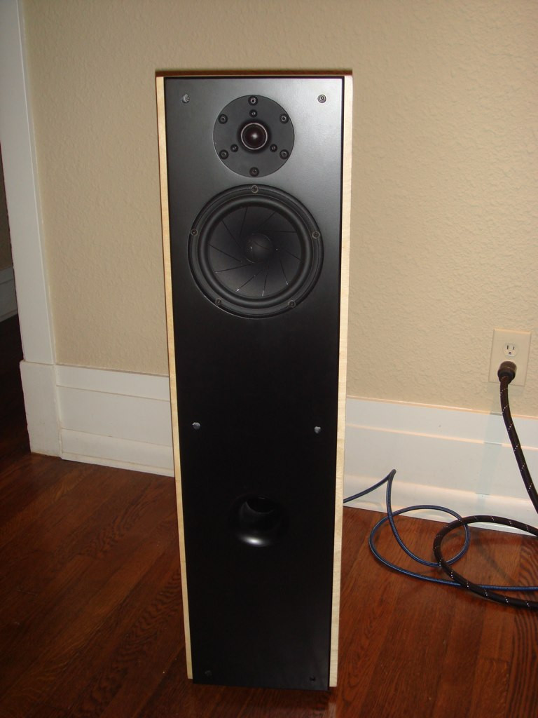

      So I finally got around to finishing these. I had to scrap the curved front baffle idea because I couldn't get everything to line up and lay flat. In the end I just ordered a pair of the pre cut baffles from Madisound. Anyway on to the pics

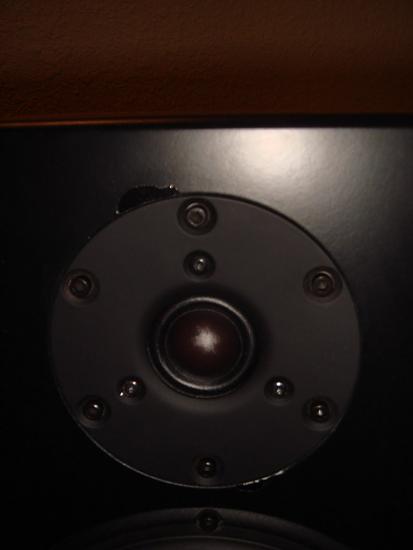

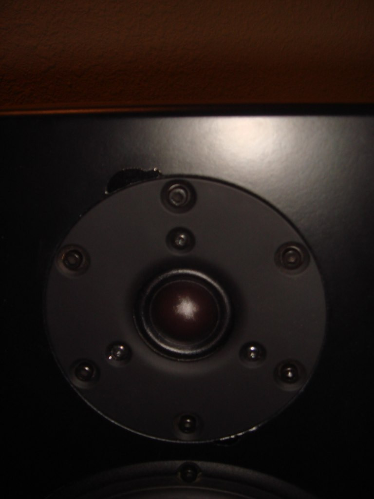

      One small issue. One of the tweeter cutouts had too much paint build up and the clear cracked when I screwed the tweeter in. I need to figure out how to deal with this???? I almost don't want to post this picture because it ruins an otherwise beautiful post

          They look real nice. That looks like a lot of CNC time. What was the cutting cost?

            Originally posted by djn04
            It took 3 sheets of "Baltic" Birch. It is Russian birch but at a cheaper price than Baltic birch. It's better than the dragon birch stuff and better than a lot of the real Baltic birch I saw. The only stuff I saw that looked better was apple wood ply. It's some sort of English wood or something but it was 130 a sheet. This stuff was less than half the price.
            Appleply is made right here in the US. It is expensive, it is all hardwood plys, but the grades of each ply is virtually perfect vs Russian/Finnish birch ply. Pricey yes, but it is really good for appearance grade ply.
            Great work on your project!
            Mike Mastin
            • djn04
              • 49
              I don't remember exactly but most of it was in the curved baffles, which I ended up not using. The birch was easy to do though. Much easier than routing it myself too.

                  Thanks everyone. Does anyone have a suggestion for touching up the cracked clear? Maybe a paint maker?

                    Nice job on the speakers, that's cool that Steve was able to CNC the parts for you, he makes some nice hand planes as well.
                    Too bad about those cracks. It's pretty tough to blend a satin finish like that, especially without the original material it was shot with. Personally I would feather it, build it back up, block it out, and then shoot the whole panel, than rub it out to whatever sheen is desirable. However that is a lot of work, and it would be cheaper and more efficient to just buy another baffle hate to say.
                      But I think this would be way to costly for a speaker build.
                        I'm with Biermann. You could try really hard to patch that up and never quite get it right or just buy another baffle. You could probably talk them into some sort of a discount since the first one you puchased is obviously defective. :x
                            I would do that but the port has been bondo'ed and painted to blend into the baffle and it was a lot of work to get it to blend in. I guess it was so good that no one noticed :W
                            I'm gonna try to touch it up I think. You don't notice it unless the light hits it just right and you're looking for but of course I notice it.

                              I would feather it out then spray a few coats of poly or whatever. No one will ever know... :T

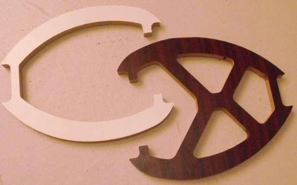

                                      You need to provide DXF or DWG file (I use DXF). Someone will have to generate the gCode based on your drawing which will be used by the CNC router.
                                      Edit : I need to add that not everything can be done on a 3 Axis CNC. My advice, try to make something simple before investing loads of time and money.
                                      Here's a test piece I've made recently :

                                      This is my second test and I still need to do a last one with all the pieces just to be sure they fit together. If your 3D model is not 100% perfect, your going to run into trouble...
                                      Hope this helps,
