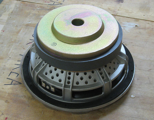

    Apex Jr 8" Subwoofer magnet view
    [ATTACH=JSON]{"alt":"Click image for larger version Name:\t590006079_65be4e6252.jpg Views:\t1 Size:\t66.3 KB ID:\t952071","data-align":"none","data-attachmentid":"952071","data-size":"full","title":"590006079_65be4e6252.jpg"}[/ATTACH
