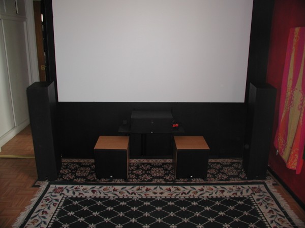

            how did you position your asw300 subs? i had one and man it sounded awesome.
            Here is a picture of how I have them setup.I tried different positions and this is what works and sounds best for me.I had the asw608 and asw610 and asw610xp and the asw300 in my opinion blows the other 3 out of the water.That.s why I opted for the asw300. :T

              The towel hanging from the right wall is part of my room treatment...well sort of until I get or make a real one.
