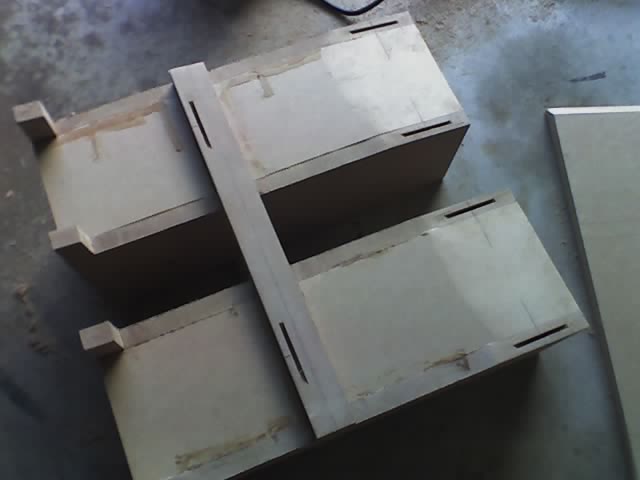

                              #104

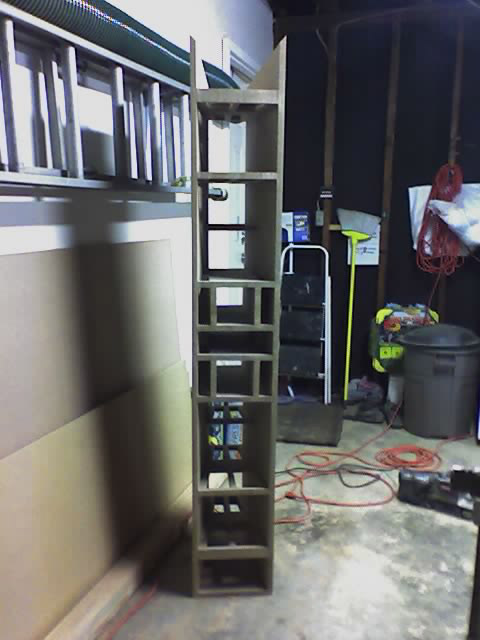

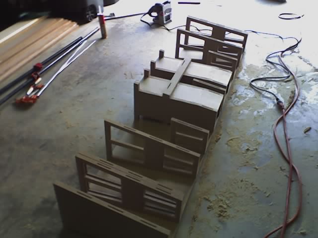

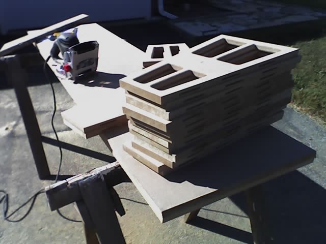

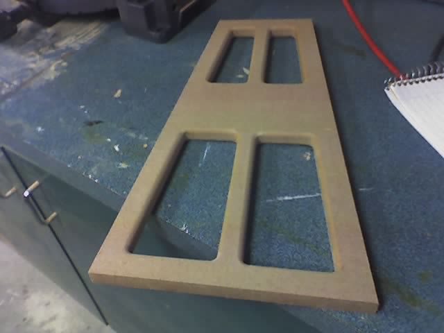

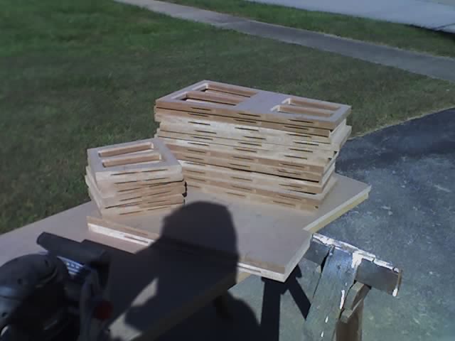

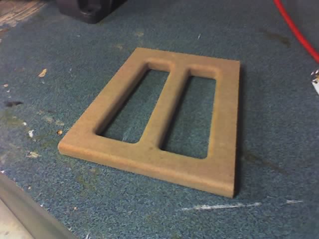

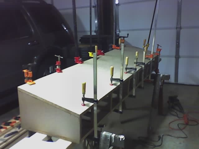

                              Hey guys, more great progress this weekend!!!
                              1) The full vented braces are cleaned up and rounded over...
                              2) The half vented braces are cut, cleaned up, and rounded over...
                              3) The midrange braces are cut...
                              4) The midrange walls are cut...
                              5) The midrange enclosures are constructed, glued and dried...
                              6) And, probably the most cumbersome part was that since the sides of the speaker are angled, the back walls of the midrange enclosures "intersect" the sides of the speakers... So, I took the belt sander and very methodically sanded the sides of the midrange enclosures down to match the angle of the speaker walls... I used one of the full size braces as a template...
                              The first set of pictures just show the final braces cut out and rounded over...

                              • mlammert
                                • Dec 2007
                                • 373
                                #105

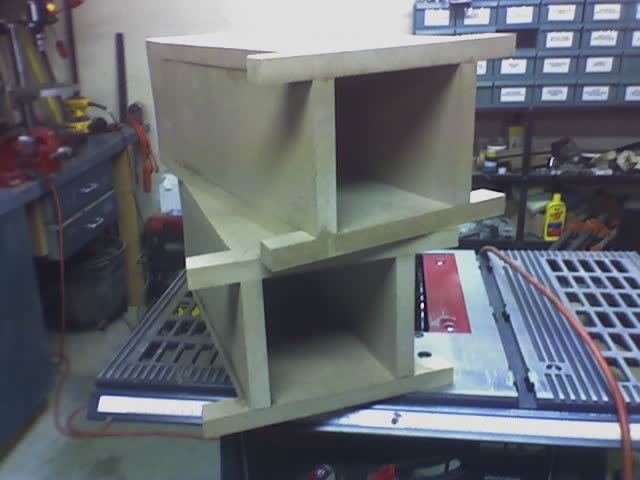

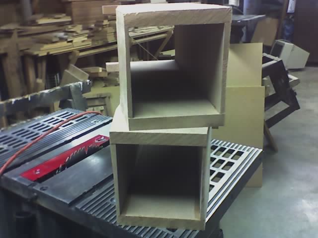

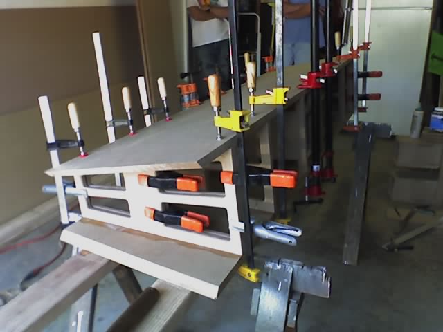

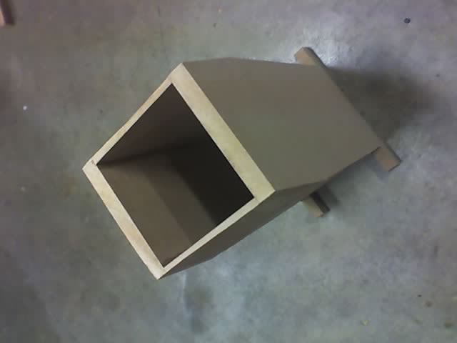

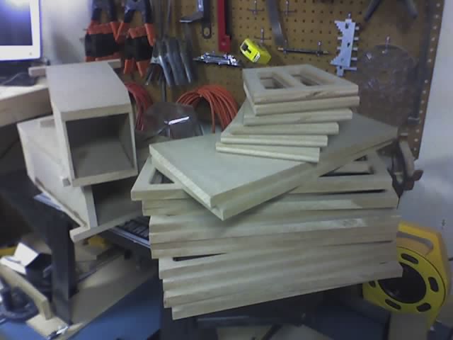

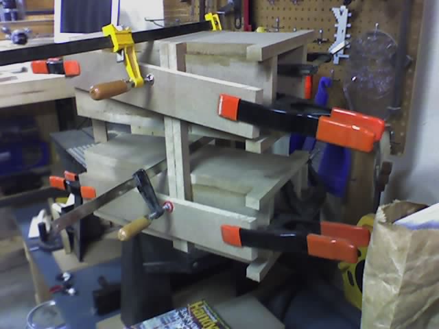

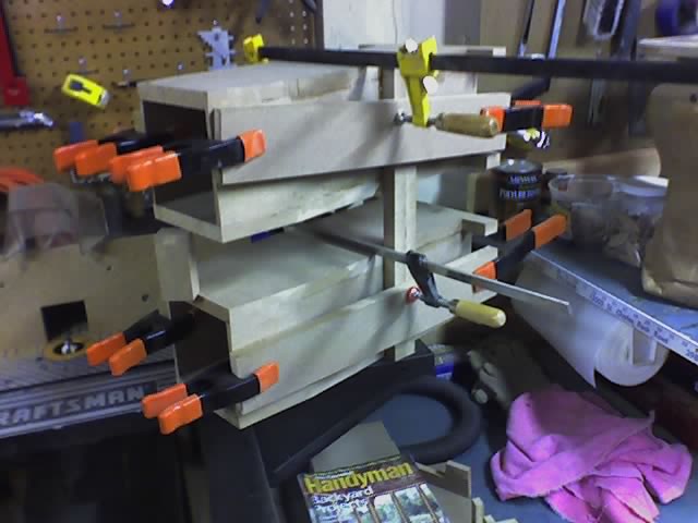

                                This second set of pictures shows the construction of the midrange enclosures...
                                The first two are the construction of the midrange enclosures...
                                In the second two you can see the angled ends of the midrange enclosures...
                                The final pictures shows all "internal" pieces/braces for the speakers...

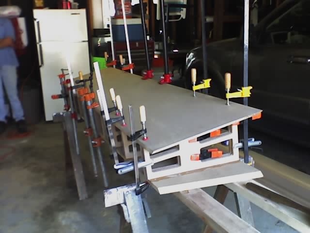

                                • mlammert
                                  • Dec 2007
                                  • 373
                                  #106
                                  Oh, and just in case anyone is wondering, yes I know I only have two midrange enclosures built... :P
                                  I only have 10 bar/pipe clamps so I can only build two at a time...
                                  Hopefully tomorrow I will construct the second pair and have them finished for next weekend and hopefully (cross your fingers) construct the shell of one of the speakers next weekend...
                                  More soon...
                                  Thanks guys!!!
                                  Mark

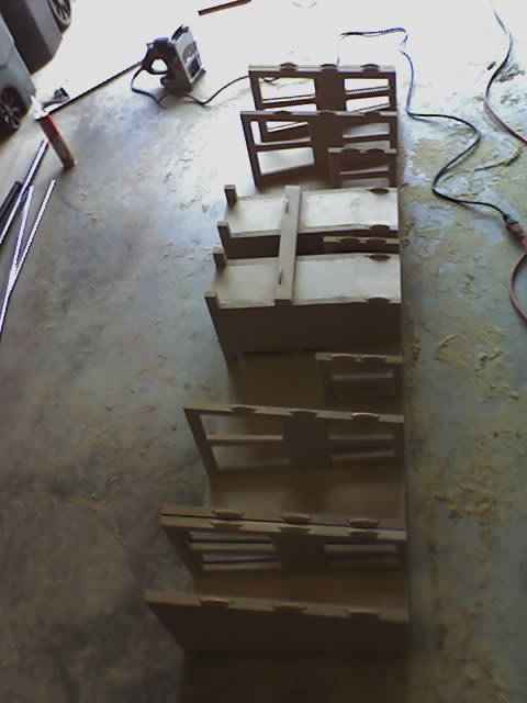

                                        #109
                                        Well, I have the final two midrange enclosures completed and ready...
                                        I now have all internal pieces for the speakers built and ready... :T
                                        Unfortunately I have had some family commitments pop up this weekend, so I don't know if I will be able to construct the speakers as planned... But, we'll see...
                                        Don't these people know I have speakers to build!!! :P
                                        Hopefully I will have more updates next week...
                                        Thanks guys,
                                        Mark

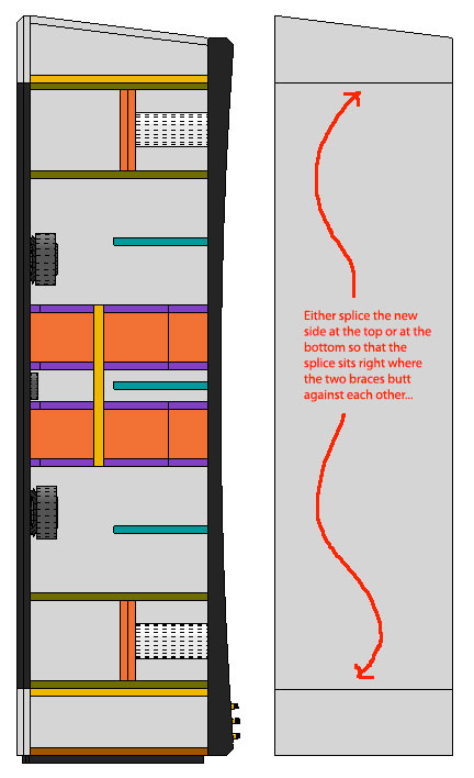

                                            Okay, I am very mad... I just made my first irrecoverable mistake on the speakers...
                                            I was cutting the MDF for the sides of the speakers... The first speaker went awesome... Both sides cut perfectly...
                                            So, when I went to cut the sides for the second speaker, I basically cut two left sides... Remember, the top is slanted and each side is unique since the speakers are trapezoids... And, since each side is unique due to the angle, I cannot reuse the incorrectly cut piece...
                                            I was SO mad!!! I measured like 10 times... However, I only checked to be sure I was correctly orientated once... Once I realized what I had done it was one of those scenes from the movies where the dude screams and all the birds fly our of the trees...
                                            Oh well...
                                            My question is, should I go and buy another piece of 3/4" MDF for this and re-cut a whole new side piece???
                                            Or, what are your guys' thoughts on splicing two pieces of MDF together??? I can basically cut off the incorrectly cut angle and just cut a new angle and butt the two pieces of MDF together to form the side... If I did this I would make the spice at either the top or bottom of the speaker where I have my two braces butted next to each other... As labeled on the attached picture...
                                            The only thing I am worried about if I splice is the final finishing of the speaker... Even if I use wood filler/bondo on the seam, will it show through???
                                            What are your guys' thoughts on those two plans???
                                            I am SO disappointed in myself right now... Err... :M
                                            Attached are some pictures of the good speaker sides I cut...
                                            You can see the angle profile along the top (high end is the front and the low end is the back)... You can also see the 45 degree cut I made so that there is no end grain showing when I place the top on the speaker...
                                            Thanks guys!!!
                                            Mark

                                              #112
                                              Use bondo, not wood filler, bondo doesn't shrink.
                                              I used it to cover my magnet recesses and a mistake I made with the jasper jig for my driver cutouts.
                                              Even though I veneered my speakers, I could have easily painted them without the bondoed (is that even a word?) sections showing through.
                                              After sanding, if it wasn't for the color difference, you wouldn't have been able to tell where the MDF ended and the bondo began.
                                                #113
                                                Personally I would get another sheet of MDF and cut a whole new piece rather then trying to laminates two pieces together.
                                                  #114

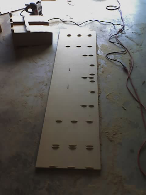

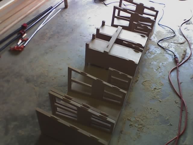

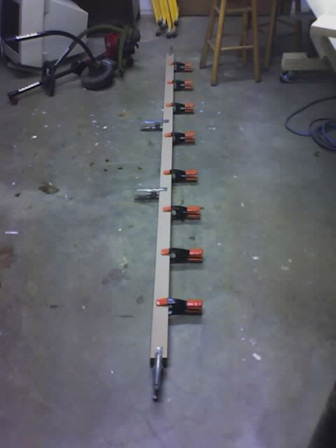

                                                    #115
                                                    Hey guys,
                                                    After reading through the responses, I guess your advice was the same thing that was already in the back of my mind:
                                                    Get a new piece of MDF and do it right the first time...
                                                    Looks like I will be doing that this weekend and hopefully maybe get one speaker built...
                                                    Thanks as always guys!!!
                                                    Mark
                                                    • mlammert
                                                      • Dec 2007
                                                      • 373
                                                      #116

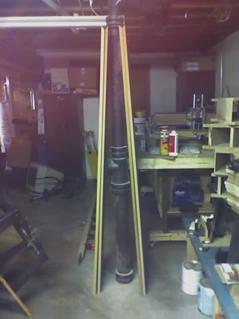

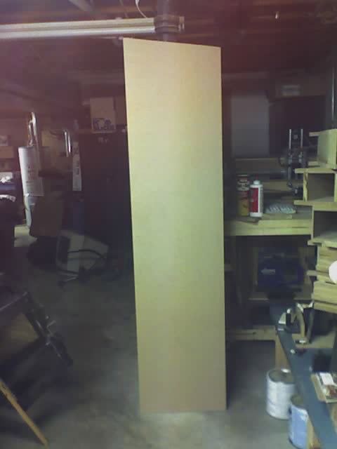

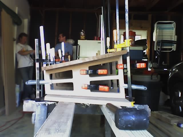

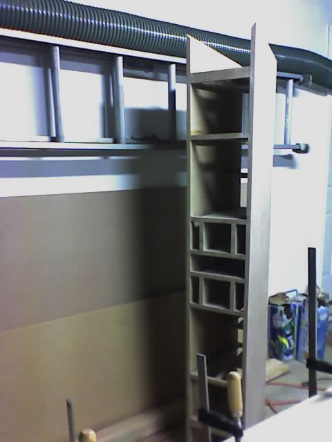

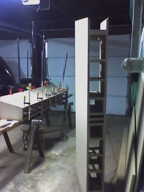

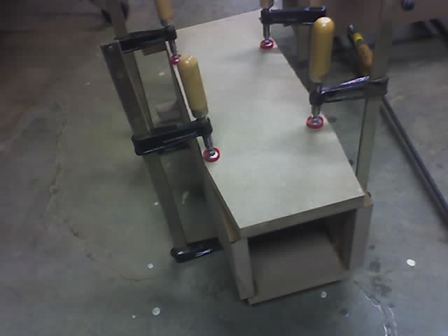

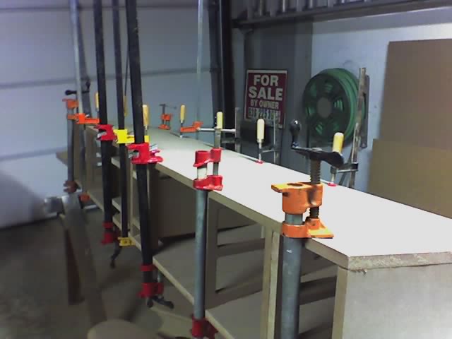

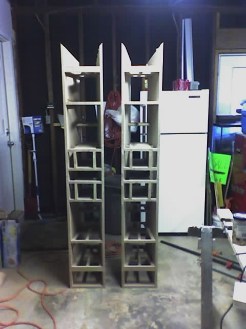

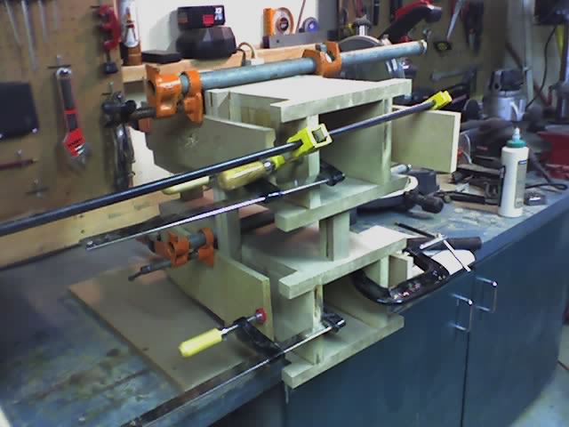

                                                      More good progress early on Saturday!!!
                                                      I got the new sheet of MDF and cut the new side for the speaker... Very nice...
                                                      In the first picture you can see all four sides stacked next to each other...
                                                      I then went and cut biscuit slots in all the braces... Second and third pictures show the biscuit slots in the various braces...
                                                      The last pictures shows how I took two skinny pieces of scrap from when I cut the original speaker sides and glued them together to use as the vertical braces for the midrange enclosures...
                                                      If I did my math correct these should be the same angle as the sides of the speakers...
                                                      While the glue is drying (and in between family stuff) I am hoping to layout the braces on the speaker sides and cut the matching biscuit slots in the speaker sides...
                                                      Looks like I am going to have to start placing my orders for the speakers and crossover components soon!!! 8)
                                                      More to come!!!
                                                      Mark

                                                          Then, through talking with Curt and Jim, I discovered that the original Statements were on the "small side" of what the drivers like as far as air volume... So, these Statements are actually roughly 24 liters larger than the original Statements; per Curt and Jim's recommendation...
                                                          Curt helped me out quite a bit in re-configuring the ports for the new volume...
                                                          If you go back to this post:
                                                          You can see the overall new dimensions and new port configuration...
                                                          If memory serves me correctly, the front baffle comes in just at 6 1/2 feet tall...
                                                          More on its way!!!

                                                            #119
                                                            Hey guys,
                                                            More good progress made on Sunday...
                                                            I have the vertical braces cut and gluing to the midrange enclosures...
                                                            Picture one is the best; but the others show some other angles to the whole mess of clamps and whatnot...
                                                            I cut the vertical braces so that they would match the angle of the speakers' side walls...
                                                            The vertical braces are attached to the midrange enclosures so that they are perfectly aligned and the space in between each midrange enclosure is 3 1/4" inches per the driver cutout requirements... 8)
                                                            I measured various diagonals across the two midrange enclosures and I am quite confident they are square to within 1/32 of an inch...
                                                            You might see little blocks in between the two midrange enclosures... Those will be removed after the glue is dried and clamps are removed... I just used them for helping stabilize the enclosures while clamping...
                                                            Stopped by Home Depot and got some liquid nails... I am going to use that when I glue the midrange enclosures to the speaker walls... I wanted to use something more than just yellow glue since I had to use the belt sander on them and there might be slight inconsistencies that might cause voids and whatnot... Liquid nails will do a good job in filling any of those voids if they exist...
                                                            I also got some double backed carpet tape for when I cut the driver circles out for the baffle...
                                                            While the midrange braces are drying I will be measuring the layout lines on the sides of the speakers for when everything is ready to assemble...
                                                            More this week hopefully!!!
                                                            Mark

                                                              #120
                                                              One speaker shell is complete!!! 8)
                                                              Awesome progress was made this Saturday...
                                                              The following pictures show the glue up process of speaker number one...
                                                              In this set of pictures you can see all the biscuit slots and biscuits as we did a dry fit of the braces and the speaker sides...
                                                              Everything was pretty much ready to go except for cutting a few extra biscuit slots here and there...
                                                              The braces are not all 100% exactly the same; so I will have to do some very very minor sanding to get all the ends of the braces flush with the front and back edge of the speaker walls... But, I assumed this going into this stage and all is good...
                                                              More in a minute...
                                                              Mark

                                                                #121
                                                                Final set of pictures show the gluing process for speaker number one...
                                                                I used Titebond III for gluing all the braces to the speaker sides because these were perfectly flush with each other...
                                                                I used liquid nails to glue the midrange chambers to the sides because due to the use of the belt sander the walls were not 100% flush... They were all well within tolerance but I wanted the "bridging" properties of the liquid nail for the 1/32 to 1/16 gaps that might be between the midrange chambers and the walls...
                                                                After everything was in place and good we measured square and it was all within 1/16 of being parallel and square across a 6 1/2 foot length... I am pretty darn happy with that...
                                                                The attached pictures just show some various angles of glue up and the clamps...
                                                                The small clamps you see are where I glued the two vented braces together at the top and bottom of the speakers...
                                                                I need to wait for this to dry to do the other speaker because I am out of clamps.. And, I need to buy more biscuits... I believe we counted 66 biscuits for one speaker... :P
                                                                Let me know what you think...
                                                                More to come...
                                                                Thanks guys,
                                                                Mark

                                                                                  Hey guys,
                                                                                  More progress on the speakers...
                                                                                  The one speaker shell is complete... I have sanded down all the edges where the braces and mid enclosures meet the front and back of the speakers... Some of these shifted ever so slightly (about 1/16") when I clamped them so I just took the belt sander and made everything smooth and square...
                                                                                  The second speaker shell is all setup and ready for glue... I have all the biscuit slots cut in the side panels... I have accomplished a good dry fit...
                                                                                  However, the panels and biscuits are too cumbersome to glue and clamp with one person so I need to wait till I have a buddy come over or see if my wife can help...
                                                                                  With the second speaker waiting, I have began to plan for the back curves... I am pretty confident that those will go smoothly... 8)
                                                                                  More later...
                                                                                  Thanks!!!
                                                                                  Mark

                                                                                      Just for Dougie; here are some more pictures!!! :P
                                                                                      The first few pictures are of the first speaker standing upright... Again, I took the belt sander and made all the braces and edges square with each other...
                                                                                      Tonight I had my neighbor come over and help me glue and clamp the second speaker together...
                                                                                      The next couple of pictures are of the second speaker being glued up... It didn't go together nearly as smooth as the first one.. But, everything once again seems to be within 1/16" of everything so I am again pretty pleased... Nothing the belt sander can't assist with...
                                                                                      I have all my schematics ready to start working on the rear curves... So it should go pretty easy...
                                                                                      The rear of the speakers are 7" wide... So that means I have one inch on each side of the 5 inch midrange openings...
                                                                                      To make glue-up of the rear curves easier and eliminate having to do any unnecessary cutting I am going to laminate the following series of MDF:
                                                                                      .5" + .5" = 1" for the left full strip...
                                                                                      .75" + .75" + .75" + .5" + .75" + .75" + .75" = 5" for the middle strip with the midrange openings... Once this series is glued up I will cut the entire strip with the chop saw to achieve the 5" openings for the midrange enclosures...
                                                                                      .5" + .5" = 1" for the right full strip...
                                                                                      1" + 5" + 1" = 7" wide rear curve...
                                                                                      I hope that makes sense... 8O
                                                                                      Anyway, hopefully I can get the master curve template finished this weekend and maybe get one of the panels created...
                                                                                      More soon!!!
                                                                                      Mark

                                                                                            More great progress early on a Saturday morning...
                                                                                            The second speaker glued up quite nicely...
                                                                                            Took the clamps off this morning around 6:00AM and began sanding down all the braces where they meet the edges of the sides of the speakers... I learned from the first speaker and this one was much better and took less time...
                                                                                            Here is a picture of the two towers standing next to each other...
                                                                                            More soon!!!
                                                                                            Mark
