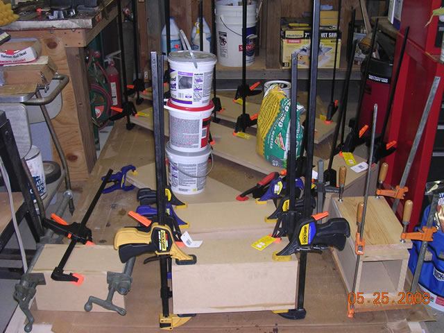

    Day 2

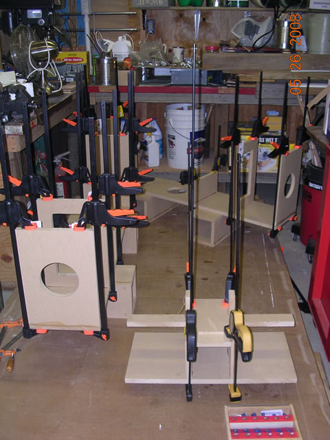

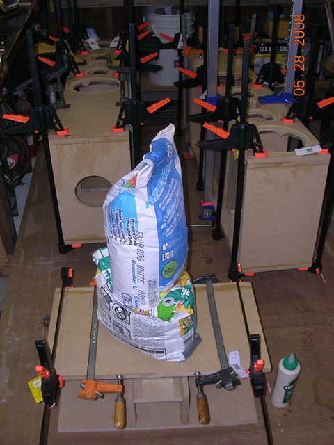

    The baffles and tunnels were glued together with Titebond 3 and held together with Harbor Freight clamps.
    After I took this picture, I had to learn to use a router for the first time. That took a few hours, but I managed to get a couple of cuts on pieces that weren't being glued.

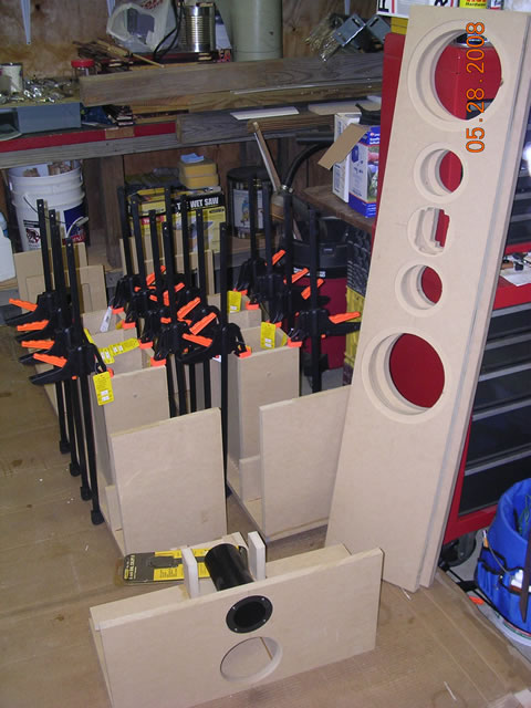

    Day 3
    A long day cutting holes, I didn't get finished but I did enough to glue the braces to the rear baffles on the mains. The center was making progress with the bracing as well.
    Here was my first mistake, make sure to set up the wood as flat as possible at all times. Later, the MDF was warped and I believe it was because I didn't have full length support on the long sides but instead chose to prop them up on the tunnels in this manner

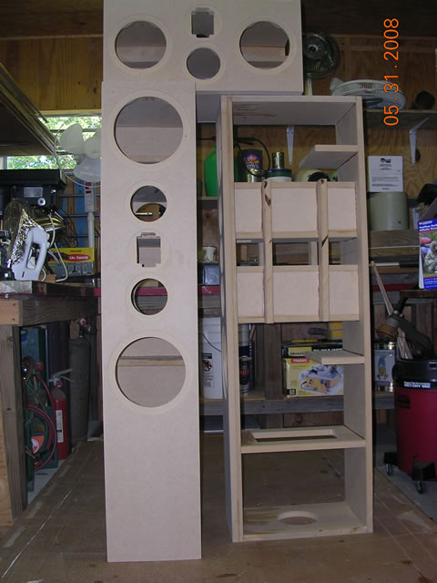

      And then I mated the front baffles to the mains and the top to the center:
      Just in case you're wondering, this is my father's workshop that he's letting me use to build the speakers. I joke with him that he has a mini Home Depot, so chances are if get stuck and need something, chances are he'll have something that will work :rofl:

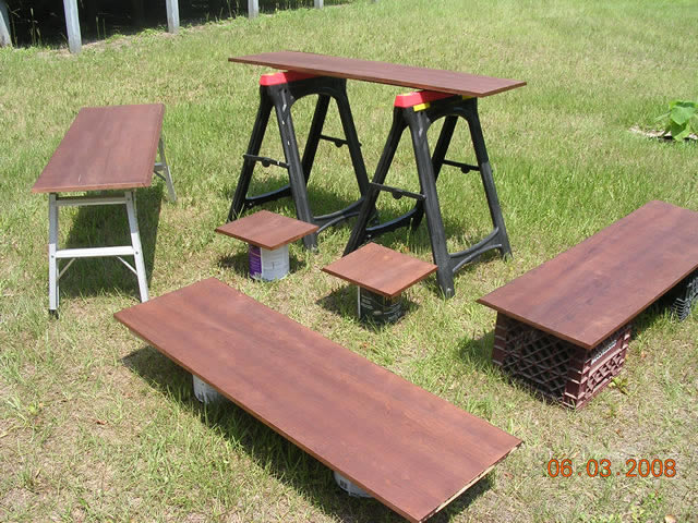

            Day 11

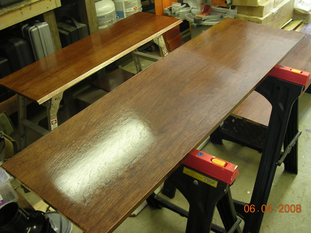

            Finishing the day up, I lightly sanded the stained sides and then wiped them with a rag soaked in mineral spirits. This added more richness to the wood, and I was excited how they were taking shape. This picture is with a single coat of Minwax high gloss polyurethane:
            Another light sand and another coat of poly was all they needed. Things were shaping up... or were they?

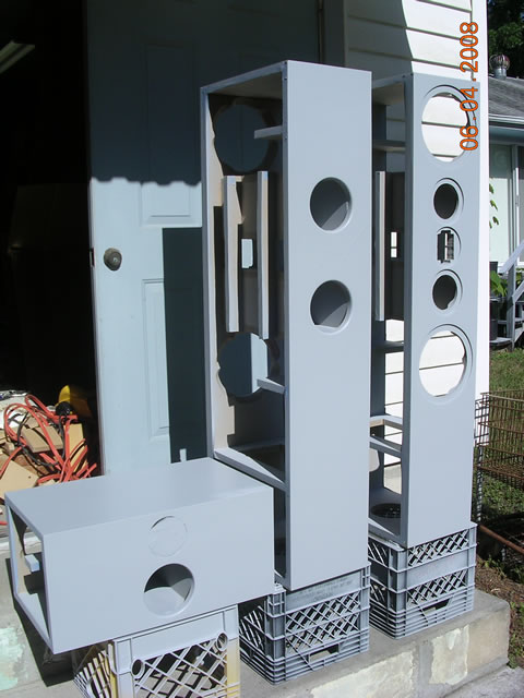

            A lot happened after the center sections were going for paint. The first mistake was trying to use a high pressure, high volume house sprayer to spray the material. The consequence was a full 9 hours of sanding down the finish on Day 13 to try again. The second mistake was I didn't fill any MDF edges and I lightly filled the seams; I thought the large amount of primer I applied would be enough to cover them. I was able to sand the primer smooth for paint, but to this day every additional application of material will show these lines no matter how smooth I prepare the surface ahead of time. The seams get less and less pronounced and were barely noticeable on the center channel finish, but the lesson learned was to do a full effort to fill the seams and edges.
            I purchased a Harbor Freight HVLP gun for the follow-up paint coats. By this time my vacation had run out, so progress from here on out was going to be very slow!
            Day 17

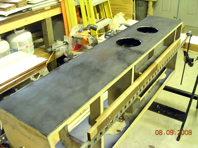

            After learning the new gun, I applied a couple of coats of material to center sections. The paint dried, and I discovered the finish was horrible. I'm still not sure where the mistake was made, my application was smooth and the finish looked good on the test pieces I experimented with. I continued to use a latex high gloss enamel paint, so that contributed to the problem. Next time I will use an oil based flat black with the same gun to see if the problem was with the wrong material.
            Overall shot:

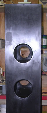

            Close-up:

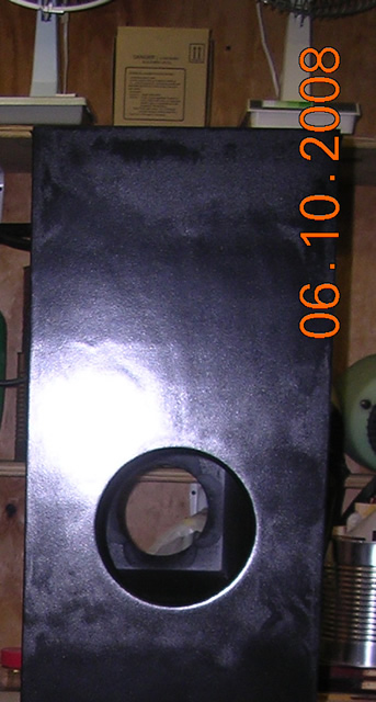

                At this point is where I was disappointed and didn't document my progress. I broke away from trying to complete all 3 speakers at once, and concentrated all my efforts on the center channel. After spending several hours sanding the center channel down again and spending a week fixing areas where it was unavoidable to sand into the primer for an even finish, I shot some water based clear on it only to get nearly the same result as in the previous post! I was highly discouraged and was thinking it was "Mission IMpossible DIY" so I took an extended break from building.

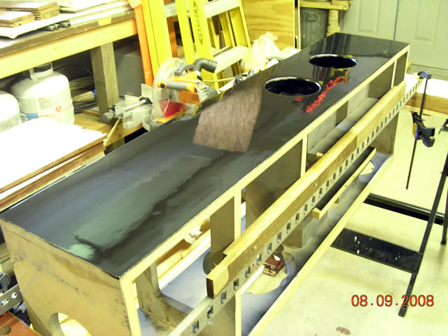

                Returning to the project, I had to sand down the center channel again. I was angry at this point so I ordered both press-on vinyl and iron on black melamine veneer from PE. I read a post where someone used polyurethane on the top of covering, so I wanted to do the same. After ordering, I took some spare melamine and contact paper from other projects and applied poly to them. It was satisfactory, but the center channel was daring me to apply some poly to the recently sanded flat black finish. Wow! This was the direction I needed to take! Luckily PE has excellent customer service and allowed me to cancel my order without any penalties.
                I was going for a glossy black, so I spent another week finding the right method for the poly. A word of caution for those reading, yes I used oil based poly over water based paint. This CAN be done if the water based paint has fully cured. It had been over a month since the last coats of black were applied, and I had sanded off the other coat of clear so I was good to go.
                Only the center channel, I prepped the surface with a final 2000 grit wet-sand then used 1 part mineral spirits, 1 part poly, wiped on fast with a blue shop towel, then a quick straight wipe to finish the coat, and walk away. It took some practice to get the right amount of poly on the applicator for the area I was surfacing, also factoring in the speed of application and the flash time of the material. For another coat, I found by trial and error that I needed to do a really light wet-sand with 2000 grit to knock off enough dust so it won't show through on the follow-up coat, and to level some of the faint streaks that are inherent with this method (they won't completely disappear, though). I did not sand on the final coat since I had to be in perfect light to see the blemishes. I'd say the finish is good enough for most of us DIY guys, and once I got the hang of this method it was much faster than what I've read about a true piano black finish.
                So now that I had a method that worked on the center channel....

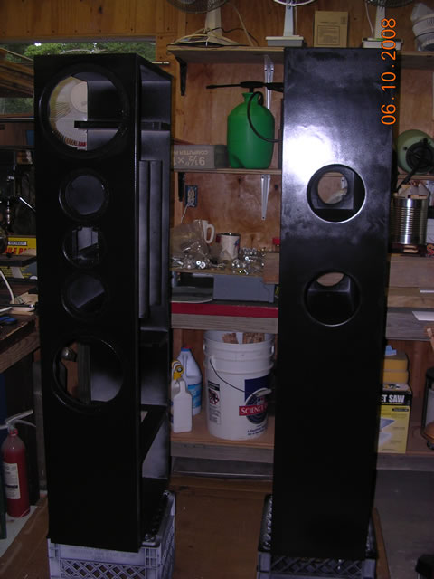

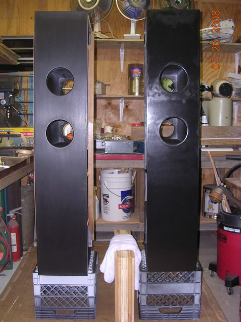

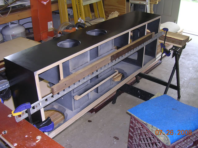

                  Today I started working on the "big guys" again. This weekend's agenda is to get both speakers sanded to a flat black.
                  I removed the painters tape from the sides, and my father and I rigged up this contraption for sanding and poly. The finish doesn't look too bad in the picture, but in person it is completely unacceptable.
                  I knew it was going to be a hard day's work! I estimated 8 working hours for each speaker cabinet, but luckily it was only 7 working hours. I used the flash on this picture so you can easily tell the difference between the two cabinets. The one on the left is the product of today's work, and the right speaker is what I am correcting. Tomorrow will be another long day to get the 2nd cabinet to a smooth, flat black.

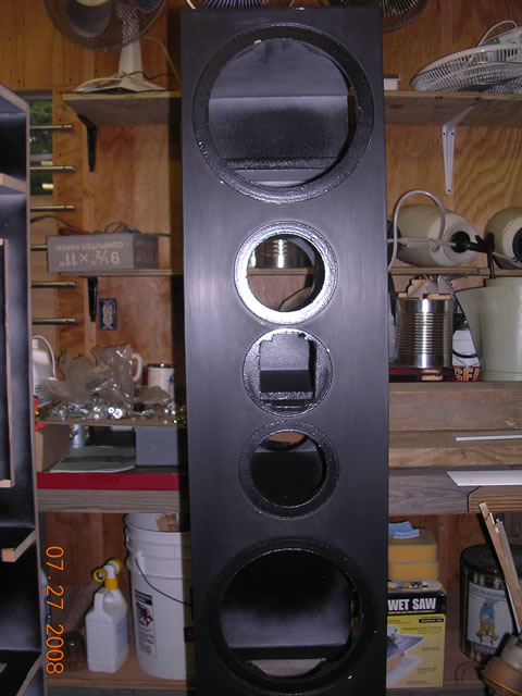

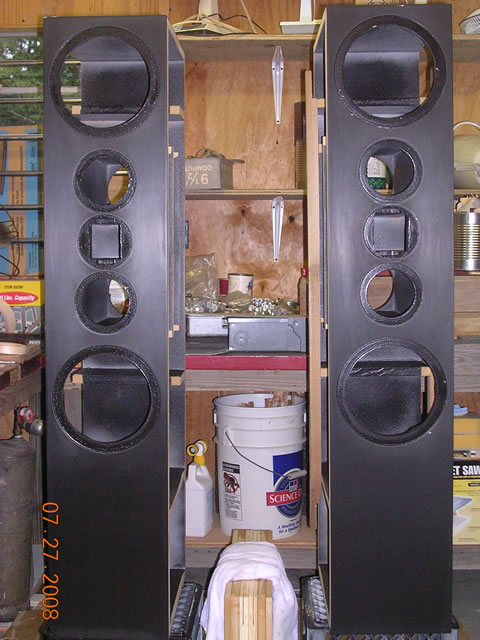

                                  Today I finished sanding the other Statement in 5 1/2 hours. The paint on the back of the cabinet had dried much harder, and was thin as well. I usually use 320 grit as the first step, but it wasn't working. I had to go with 220 and tried to use finesse, but it was inevitable to have sanding errors. A second reason I don't like using 220 because it leaves deep scratches that are hard to sand out afterwards. I decided to try wet sanding with 600 grit, and it did a good job removing the 220 leftovers.
                                  Luckily the front baffle on this cabinet was the easiest yet, so it was done much faster than I originally thought. My standard 320 pressing hard, 320 light, 1000 pressing hard, 1000 light, then two passes of 2000 light worked. This sounds like a lot of steps, but the 320 levels everything out so the remaining steps only take 30 minutes combined. Here are the two speakers sanded to a flat black with 2000 grit (the one on the right was done today):
                                  The rear of this speaker had some bigger problem areas than the front. I had the same thing happen on the center channel and have a procedure to fix them. I use a layering process in which I use a foam brush that barely has enough material in it, and then apply it to the areas that need repair. I let it dry, then sand smooth, then repeat the process until there is no trace of the problem. Some areas on the center channel were finished after 2-3 layers, but some of the trouble spots took at least 7... after that I stopped counting. It's not that difficult, just a test of patience. Since the layers are thin, it is possible to sand after 2-4 hours of application. Here is a closer picture of the sanding errors where I went down to the primer; look for white spots around edges. After I snapped the picture I applied a layer over the problem areas. This will keep me busy for a few days!

                                                                                      Progress has been slow, but I'm doing some work on them again. I tried using some flat black water based paint to layer up the patches, and I'm still unsure whether that was a good idea or not. The bad cabinet is still bad and needs a lot of patchwork:

                                                                                        I managed to finish the patchwork on the "good" cabinet, and I applied a coat of poly on the front & the top. I'll need to apply at least one more coat to each side, though.
                                                                                        The "bad" cabinet is still being patched up and it has quite a ways to go.
