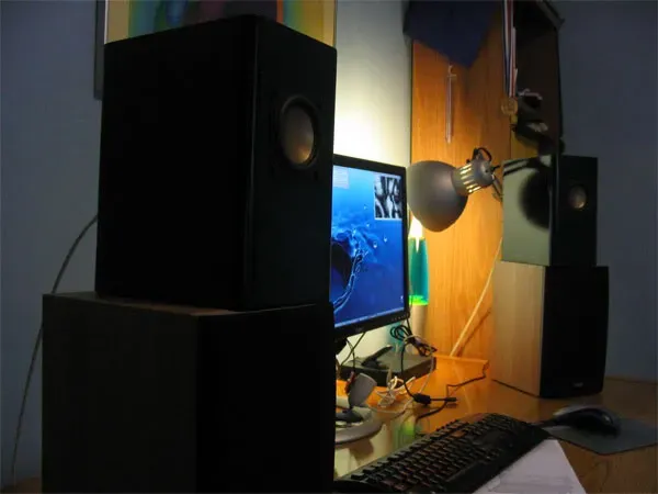

      Mmmm...those look nice all finished up in your room.
      I bet they sound excellent too.

        My opinion, I like the screws. Great looking speakers overall, really. A couple questions:
        Are the crossovers removable to be altered? If so, how are the boxes sealed? Also, did the tweeter get a small seperate compartment, or is the back open into the cabinet?

          Appreciate the compliments cobbpa and Willy! :T
          The port back plate I have is airtight and removable. It's attached using four wood screws. If you look at post #22 you can see how I did it. Nothing fancy.
          Tweeter is open into the cabinet, no separate compartment is necessary as the tweeter itself is sealed.

            Ahh, I gotcha. Are they painted over or just countersunk? (Since we can't see them in the finished pics) Won't those screwholes eventually get loose if you pull it out more than once or twice? Or did you use a plastic threading?

              Will you post some thoughts on how they sound, and with what amp/source you are using?
                They're countersunk. I'm using woodscrews with pretty deep threads for my drivers. I've mounted and unmounted them several times and they seem to fit just as tight as the first time I mounted them. I see a lot of people use t-nuts and bolts for this kind of thing but wood screws work just fine for me.
                  I've tried em with both a Peter Daniel LM4780 Gainclone kit as well as my Rotel RA-01. The Nat P's walk all over my B&W 600S3's in terms of dynamics, detail, and clarity. I don't know what else to say other than they are very very clean sounding. I'm looking to buy a more powerful amp for extra headroom, but with the 40 or 50W I have now, I can still drive them louder than I'd ever need in their current setting.
                  Note that I am no golden ear, far from it in fact, but I just absolutely love my pair. Once I've got my dual RS 12" subs built and actively crossed over to my Nat P's, I don't think I'll be upgrading any time soon. That is until I get my own place and have space for a set of Arvos..... :T

                    Looking very nice Anthony. You must have a fair amount of woodworking experience to pull off such nice looking set of speakers for your first attempt. I'm glad you like them.

                          If by fair amount of woodworking experience, you mean building a pair of Zaph's little Hivi B3N fullrangers, then yes, I do I've always been good with my hands though and I took a woodworking class in high school. I can only wish I still had access to such a fine woodworking shop now. 8O
