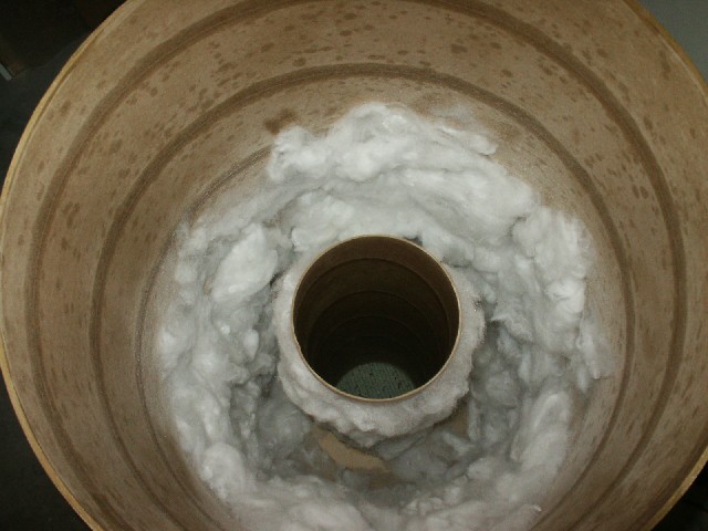

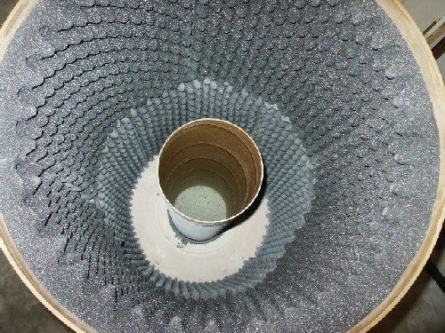

    Well, Thomas, I guess I had to dive inside the tube anyway so how's this look? Let me know because I definitely don't want to foul this up.
    Pretty much you can now see down to the end cap. I pulled out an awful lot from way down in there - it grows in volume when you fluff it.

      I don't know much, but that looks good there, in the last pic. I would think no more than that is necessary along the inner wall (concerning the thickness anyway).

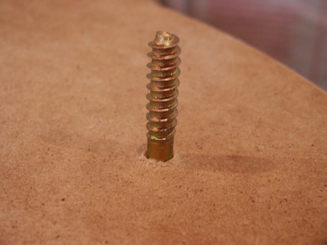

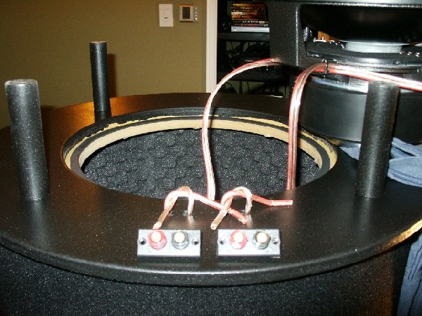

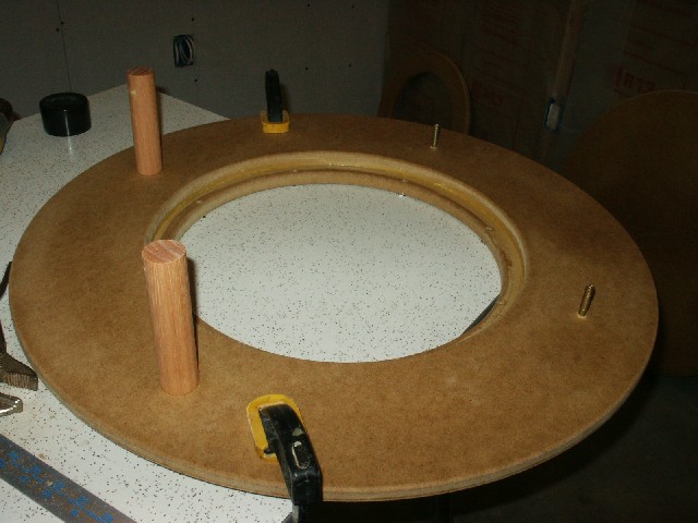

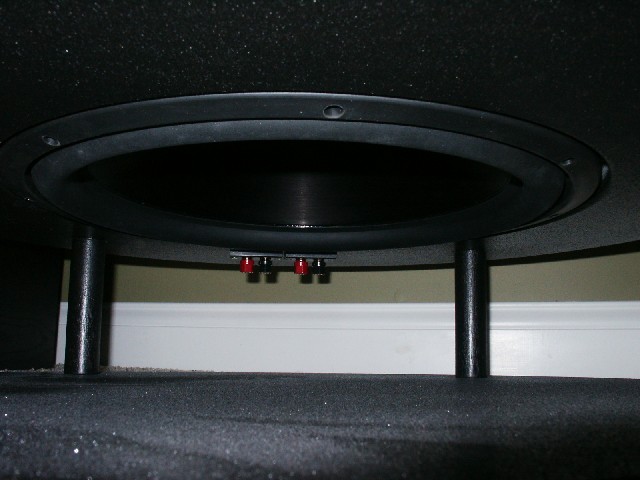

        Thanks WillyD. Y'know, I've planned and researched every aspect of this project but when it came to the fill I just spaced it off. ops:
        Here are a couple of pics of the legs. I used banister studs for the upper end of the legs. This lets me attach to the bottom plug with a blind hole (no need for sealing the screws).

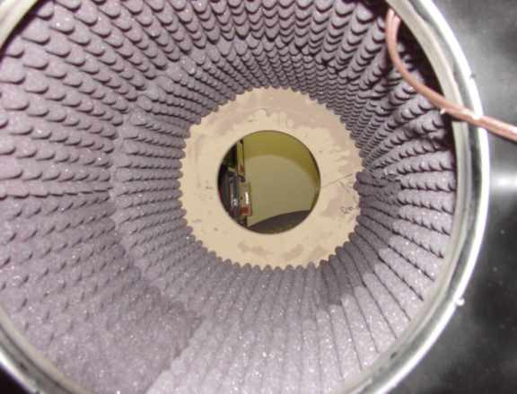

          The standard approach is to line with a couple inches on the walls of the enclosure
          This is a 20" dia tube, 2.5" foam, and an opening for a 6" port.

            I see. Would you adise that I remove of the Acousta-stuff and switch to foam, or forge ahead withthe poly? Other than easier installation, are there any other benefits of the foam? Are there any detriments to the poly?
              #96
              The Acousta-Stuff is somewhat more absorbent than the generic PE foam. So using a lot of it will mess up your box model. It's fundamental use is for stuffing sealed boxes. I don't know of any way to get an even layer around the tube.
              Might just drop by the local home center store and grab a roll of fiberglass insulation. Pretty cheap and the best thing available to absorb bass frequencies (nasty to work with though)

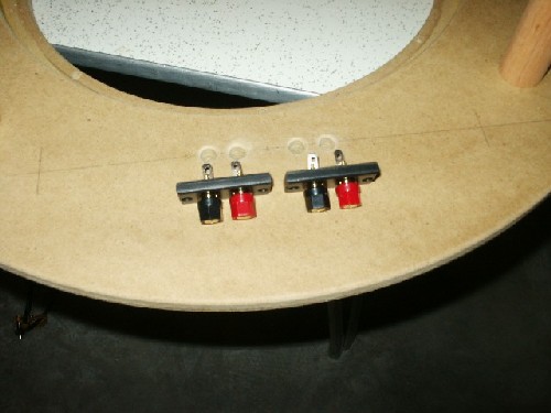

                                Alright, I have now fully recovered the project from my bone-headed installation of the wrong dampening material. I cleaned out the last of the fuzz with lacquer thinner and got back down to bare tube for installation of the acoustic foam.
                                Thomas, I made a little box for side-mounting the binding posts, but after getting off track I decided to abandon the box to save time attaching the box and working the carpet around it. I just went ahead with bottom-mounted posts. It was just fast and easy which is just what I need at this point.

                                  #106
                                  Oh man you need to start over the little peaks in the foam aren't all lined up. There needs to be a completely symetrical pattern otherwise the SQ is messed up.... :wink:
                                  Wise choice to use the bottom mounted inputs. A fraction the work of the little box. And they make for a nice tidy installation, with nothing sticking out to bang the wall as you move the sub around.... :T

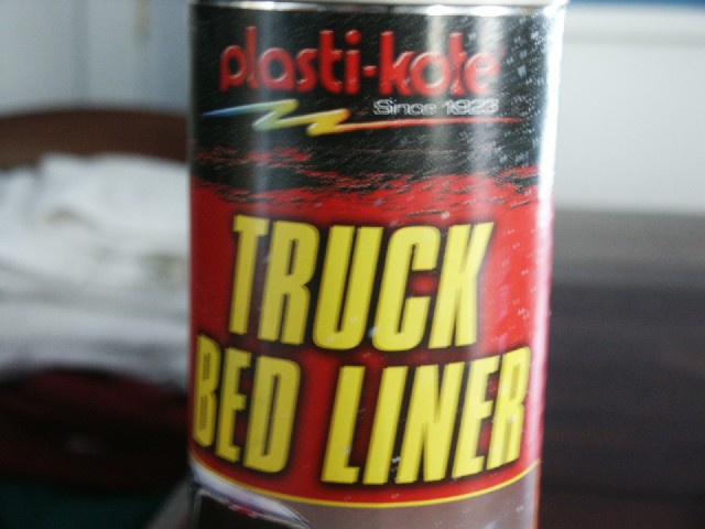

                                        • 226
                                        #109

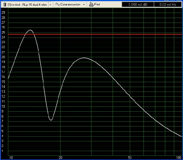

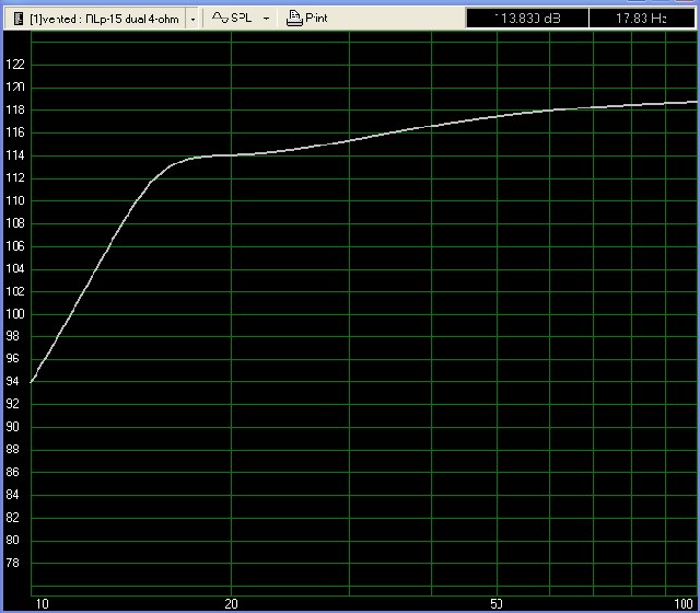

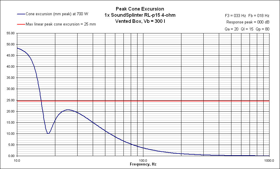

                                        How do you select the nominal frequency of a Linkwitz-Riley active high pass rumble filter, which has a rolloff of 24dB / Octave?
                                        Also how do I model this in Unibox? I see it has this feature but an FRD file must be created.
                                        • HMenke
                                          • 226

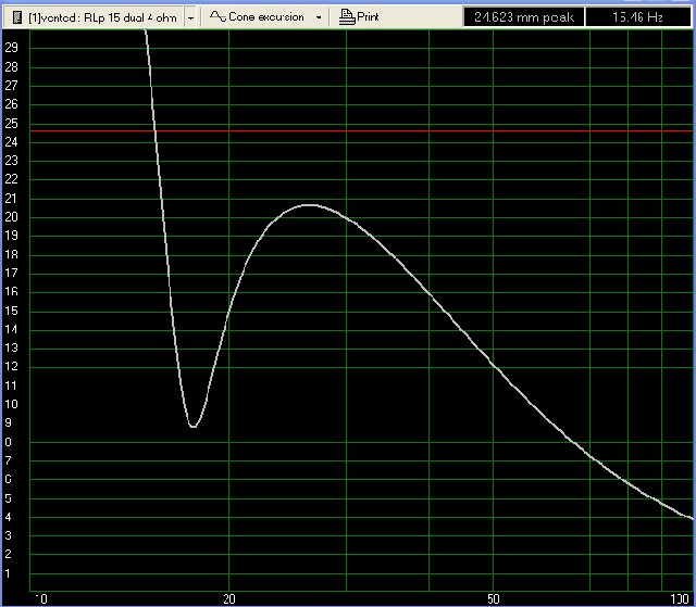

                                          #110

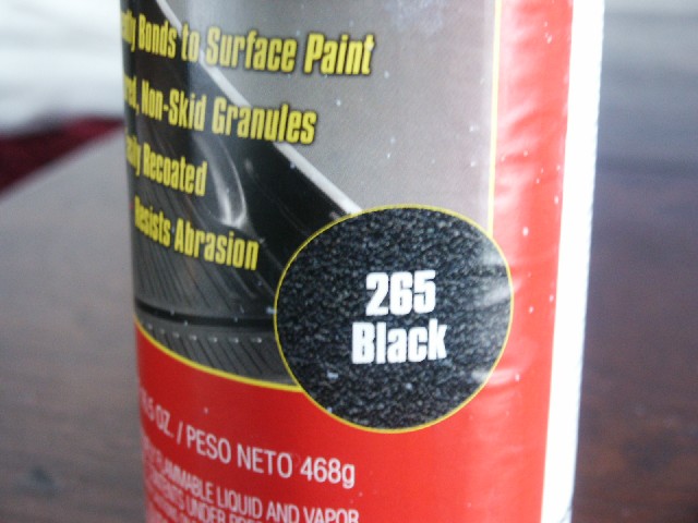

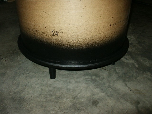

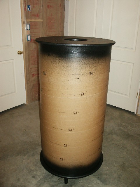

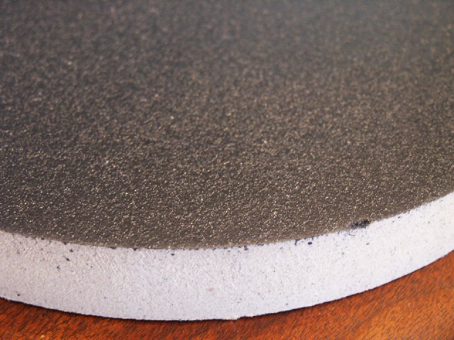

                                          sub finishing method
                                          I've completed my experiments with spray-on truck bed liner and I'm pleased with the results. This material gives a slightly sand-pebble finish, very uniform, that hides minor imperfections in the substrate. The overall effect is sort of semi-gloss/semi-flat. At some angles it looks flat while at other angles it looks slightly shiny with the pebble texture breaking it up. Overall it is very attractive and low-effort. Plus it will obviously be pretty durable and resistant to chipping. It takes two coats; the first for overall coverage and the second to achieve good uniformity.
                                          Here is a picture of my scrap test piece. It's hard to get depth of field with my camera but you can see the texture in focus toward the front part.
                                          Edit: photos of the type of material that comes in the spray can. It is also available in 1-gal cans for roll-on application.
                                            Good question....
                                            I'd be tempted to use sockets for the frequency setting components then experiement. If you look at the Sidewinder link on Collo's filter page you can see how he plotted the excursion w/wo the filter he built.
                                            To create a frd file you manually 'trace' the plot (SPL Trace) you want to import.

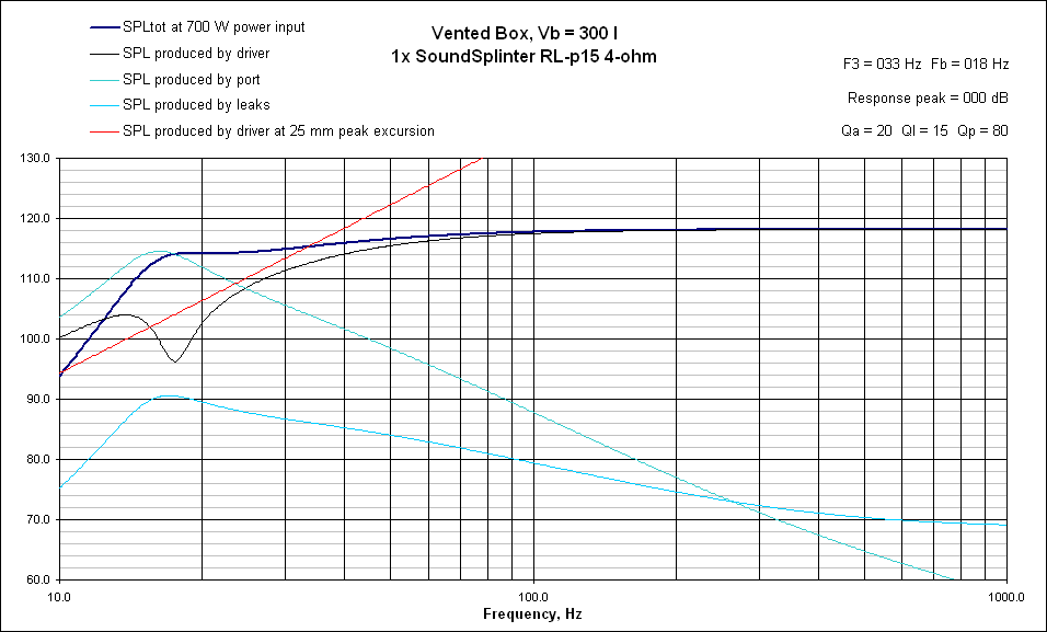

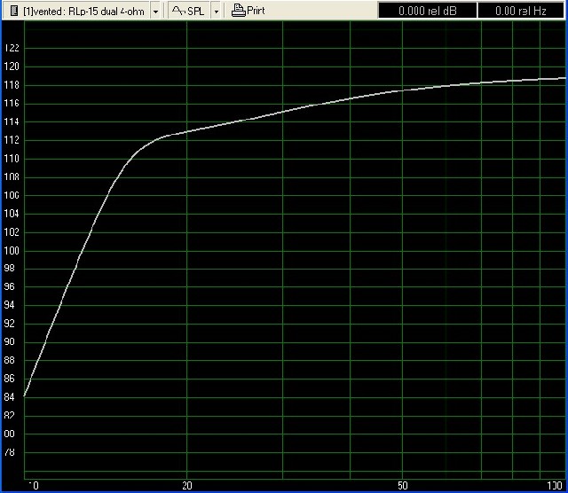

                                                    Yes, I think that's the one that Chuck used. I haven't decided which one I'll use. In the meatime I am trying to figure out what the corner frequency should be: 1) equal to the port tuning 2) higher than the port tuning 3) lower than the port tuning.
                                                    The Unibox page has this info about the FRD import feature:
                                                    FRD file import feature added. You can now import an active filter correction function and see the resulting frequency response, cone excursion, port air speed and much more. A typical design approach would be to simulate your box in UniBox and export the frequency response as a FRD file. Import this into the Linkwitz Transform program found on the FRD consortium Web and simulate your active correction filter. Export this correction as a FRD file and use the new import feature of UniBox to see the final results.
                                                    I went to http://www.pvconsultants.com/audio/eq/linktran.htm and downloaded the Excel file. I was able to export my FRD from Unibox and import it into Linkwitz Transform Beta. I selected "Use FRD input model" and then "Enable Subsonic Filter." At this point you can select up to 2nd order with a Q of 5 (no orders higher than 2nd are modeled) and your target corner frequency Fc. That's as far as I've gotten because I'm unsure of the effect of the filter on the responce curve. It's not clear what some of the curve labels are such as "LT correction" and "Speaker".
                                                    My sub FR and driver excursion modeled in Unibox look like the attached graphs.
Name:	VB Response SoundSplinter RL-p15 4-ohm.gif
Name:	VB Excursion SoundSplinter RL-p15 4-ohm.gif

                                                      zeroing in on Fc
                                                      I gave up on Linkwitz Transform Beta and went over to the filter modeling in WinISD.
                                                      I couldn't really get the FR curve in WinISD to precisely match the output of Unibox, but close enough I hope. The EQ/Filter function in WinISD is pretty cool. You can model a 4th-order Linkwitz-Riley active high pass filter. I am toggling between 12 Hz and 13 Hz. 13 Hz prevents hitting Xmax at all, but 12 Hz gives more extension and just barely allows hitting Xmax at 700W. The chances that I will play anything at 700W are about zero, so I am leaning toward 12 Hz.
                                                      Here are the SPL and Cone Excursion plots from WinISD with the filter enabled (graphs 1 and 2) and disabled (graphs 3 and 4)
                                                      Last edited by theSven; 28 June 2023, 21:00 Wednesday. Reason: Update image location
                                                      • collo
                                                        • 67
                                                        #117
                                                        you beat me to it!

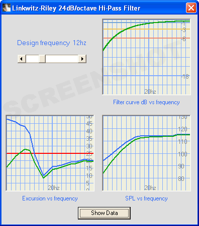

                                                        I've knocked up a small app to show changes to cone excursion and SPL as the filter frequency is changed.
                                                        Just move the scroll bar to see the changes
                                                        It's still pretty primitive - no save or autoscaling, but I've estimated your sub from the graphs you supplied, and used this as the default data.
                                                        As you've found 12 to 13hz is what you need

                                                          Originally posted by collo
                                                          you beat me to it!
                                                          http://www.users.bigpond.com/bcolliso/filter-beta.exe
                                                          Wow, now that is very cool! Very nice feature - makes it easy and quick to find the right corner freq. Nice job!

                                                              #120
                                                              What I like about collo's application is how it allows you to adjust the corner frequency in real time and instantly see the effect on all graphs at the same time. It couldn't be simpler to use or more informative for "what if" scenarios. ;x(

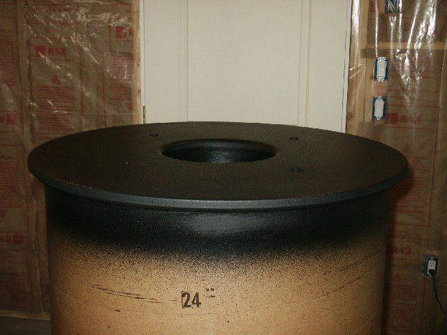

                                                                  I finished "painting" with the spray-on truck bed liner and its looking good. The stuff turned out to be a little trickier than expected on larger areas. You have to work fast and keep moving to get an even coverage. But once it dries, errors tend to fade away. It won't hold up to close critical inspection, but at a normal viewing distance I am happy with the result. I used more cans than expected as well. I bought out the supply at my local Wal-Mart (one can) and the other local store had none. They showed nine in stock but "couldn't find them" in the store room. I ordered two more cans online and used them up last night, still not done. So this morning I went to the next town south and found two more cans to wrap it up. Total needed: five.
                                                                  I installed the grille sockets in the top cap to hold on my DIY port grille. Last weekend I finished it. I got the fabric stretched "tonight like a toiger" :B and it looks pretty cool. I'll post pictures with the final completion.
                                                                  When the bed liner is good and dry, the next step is carpet. Then I am going to haul it into the HT room and install the woofer, binding posts, and the bottom floor plate. Then it will be done!

                                                                    #123

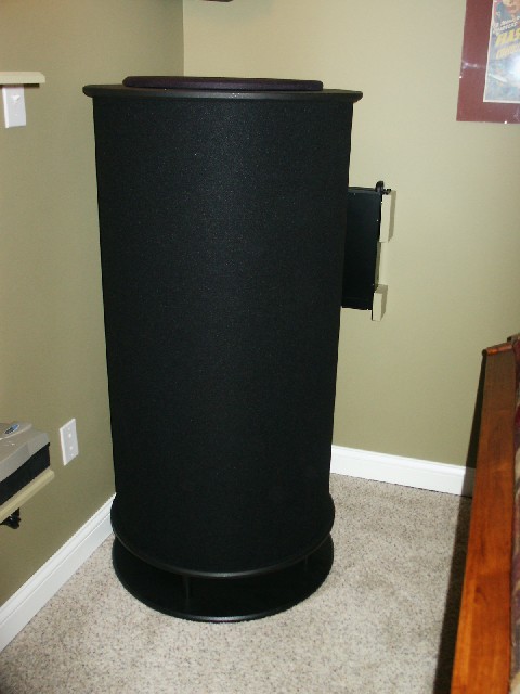

                                                                    Done!
                                                                    Ready to hook up, test, set levels, and EQ on Sunday!
                                                                    Thank you Thomas, Steve, Chuck, Ben, collo, and everyone else who jumped into this thread with help and advice. I could not have accomplished this mission without this forum and you guys! :T
                                                                    Pardon my construction dust in the woofer shot. Amazing how it shows up on camera. I will be back at some point to post FR curves pre- and post-EQ.

                                                                              Alright, I am back after completing the dreaded "spouse initial demo", i.e. "OK, so let's hear this thing you've been obsessing over for the past month."
                                                                              We sat down and she said, "Now you know I don't have the 'Golden Ear', so I'm not sure I'll be able to tell any difference." Voice inside my head: "Uh-oh!" :roll:
                                                                              We demo'd a DVR recording of the aforementioned Chick Corea ensemble, followed by Toy Story 2 Chapter 1 again. Guess what? She digs it! At one point during Toy Story she actually laughed out loud and said "I can feel the couch moving under me!" Keep in mind this was not cranked, probably about 90dB average program level.
                                                                              Her summary comments: "You can definitely feel it more, but it's not really louder. It seems like it comes on and goes off when it's supposed to. It really adds to the experience, but it never gets distracting. Sometimes I didn't like the old subwoofer when it starting booming and vibrating. Don't you think we have a really great home theater? Why would we ever go out to the movies now?"
                                                                              I tell you, it doesn't get any better than that in this house when it comes to getting projects like this "officially sanctioned." 8)
                                                                                #129
                                                                                Henry,
                                                                                You sub looks fantastic. Also, I love how you mounted you amp. I've been thinking about building some type of vertical rack for my amp ever since I saw you photo and someone mentioned how much better it would be for cooling (since I've cut my fans probably in half).
                                                                                It is interesting to hear your wife's impression. My wife is probably similar. She could have really cared less, just wanted me to be happy and stay out of trouble. But, after I got done, she said that she would humor me and listen, but she didn't expect to hear much differance, because she usually can't. hehehehee I made her jump and duck in here seat during Incredibles! Also, listening to music, she just the same things as your wife. I think half the fun of this project is getting the response from those nay-sayers.

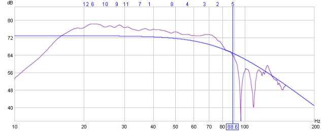

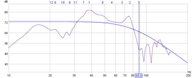

                                                                                  Measured performance
                                                                                  Hi Ryan,
                                                                                  Hey thanks, I appreciate it. Whenever I do something like this, there's always that nagging fear that it will turn out bad and be an embarrassment. I am so pleased with the results I can't stand it! :B
                                                                                  The amp mounting has worked out great. It's so convenient to have the hookups close to the sub. Even still, I'm using 10-gauge for the short run to the sub and also internally (found a great price on the heavy gauge from cablewholesale.com). Thermally, I've got convection working a little against the fans because the intakes are on the front panel, so the air is exhausted out the bottom. I thought about reversing the flow but really it seems to be just fine as is. The amp isn't even getting warm much less hot.
                                                                                  A few months ago, I moved my "standard" sub location from the LF corner to the LR of the room. Now that the sonosub has shown that it also likes this corner, I will go ahead and permanently install my line level sub cable and my remote switched AC power receptacle here as well.
                                                                                  Here are some initial measured performance graphs. The first is without EQ and the second is with 10 bands of parametric EQ applied. The uncorrected graph is a bit wild; I have a tough room with two peak modes. At this point I don't know what is causing the dip between 16 and 32 Hz, but I was able to eliminate it with gain filters.
                                                                                  I can't say enough good things about using a laptop with Room EQ Wizard, a decent external sound card, the RS meter, and a midi connection to an equalizer like the DSP1124P. You just measure the sub in-room, set your filters in the software, upload to the equalizer, measure again, tweak filter settings, upload again, measure to be sure, and you're done.
                                                                                  Henry
                                                                                  Last edited by theSven; 28 June 2023, 21:02 Wednesday. Reason: Update image location

                                                                                    Gotta love that midi connection! Right, Henry? Graphs look good!
                                                                                    • HMenke
                                                                                      • 226
                                                                                      #132
                                                                                      Oh yeah, no more getting up and standing next to the BFD to tediously change filter settings on by one! I've still got some more tweaking to do on the curve but for a first pass not too bad.
                                                                                      Later on I'm going to run a sweep with the mains connected to see how they blend with the sub. With my old sub, I went back and tweaked the high end to smooth things out in the upper bass region. I expect the mains will fill in the crazy dips that show up in that area.

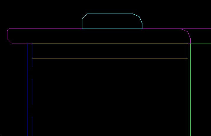

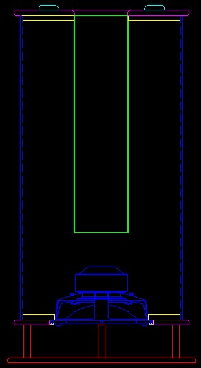

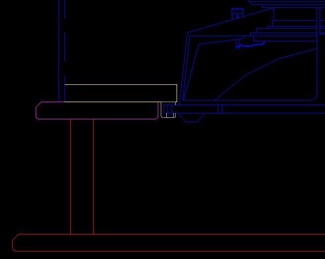

                                                                                          I was mostly going for function, but a couple of things I did from a 'styling' standpoint that contribute to a more 'high tech' look: a) the large-diameter port grille on top b) a 45-degree chamfer bit on only one side of the end caps, floor plate, and grille frame c) 1/8" roundover to remove the remaining sharp edge, but still retain the 'square' shoulder look.
                                                                                          Here are some images pulled from my CAD model that show some of these edge details.
