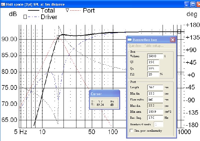

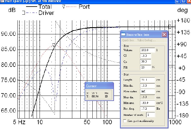

      • HMenke
        • 226
        Two designs
        Here are LspCAD screen captures from two designs, 212L and 393L. The 393L seems to have flatter extension with roughly the same rolloff.

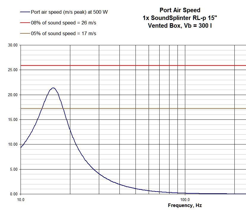

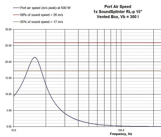

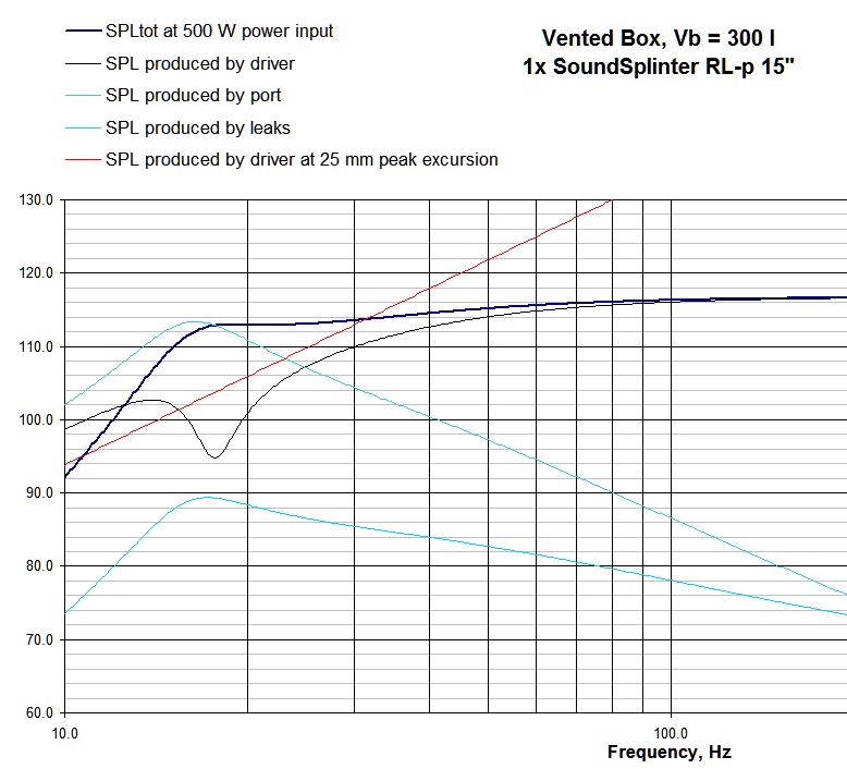

          Henry,
          Since you're willing to live with a such a large enclosure you can get some interesting results.....
          If you can find material for a 8" port, 33.5" long you can get some pretty low port air velocities using a 300L box ....:wink:
          And if you want to run Unibox, you need to change the security setting in Excel to allow macros before loading the Unibox spreadsheet

          • HMenke
            • 226
            Originally posted by ThomasW
            Henry,
            Wow Thomas, that's awesome! Yes, I am not bothered by a large enclosure. In fact, it's cooler! Fortunately I have a wife who puts up with me (we have a folded corner horn in the living room for "whole house audio"). This unit will go in the dedicated basement HT room.
            I realized after looking at your post that with my LspCAD model, I had the amp power set at only 1W, so I wasn't getting a realistic port velocity. I can see that 8" would be a lot better than 6"!
            Thanks for the Unibox tip: I'll give it a try.

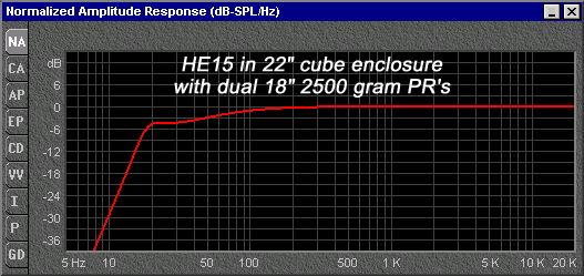

              I may be way off, but isn't it best to avoid any kind of a bump, or resurgence in output once the FR has started rolling off - in other words blend in the port's output so that it mates with the initial rolloff? I realize the room will make any anechoic response one is shooting for somewhat null and void, but in regards to overall performance, isn't the bump is undesirable? With the SS RLp15, especially the dual 2 ohm version, I find you can't really avoid that when you try to start using very large enclsoures. Yes, no?
                Steve,
                It's not a problem I'm aware of.... Many designs have a relatively big 'saddle' or dip between the driver roll-off and the output of the port. It's filled in by room gain
                Here's a plot of the original Stryke cube sub. This was the quickest example I could locate...

                • HMenke
                  • 226
                  My theory is that you want the port to kick in and augment the driver's output when the driver starts to roll off. If you could achieve an ideal match, the combined response would stay flat and then roll of steeply at some point. In practice it seems like the combined response shows a shallow rolloff, a small bump, and then a steep rolloff.

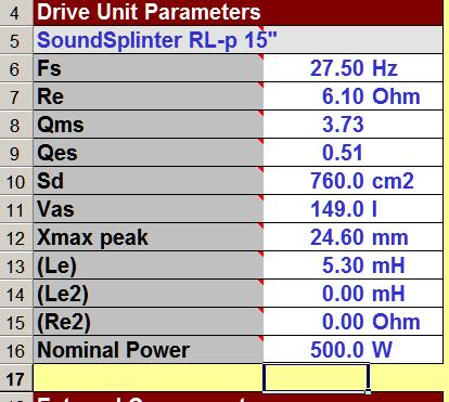

                  • HMenke
                    • 226
                    Question re: amp power
                    Thomas, I got Unibox working in Excel with your tip and was able to duplicate your 300L 8" x 33.5" port model, so I feel pretty good that I'm on the right track now. Peak cone excursion at 25Hz is only 17.5mm at 500W so the RL-p15 is hardly straining. Can you check my RL-p15 model parameters (attached). Some of the quantity names in Unibox don't appear on the SoundSplinter T/S parameters page so I "guessed" at what they might be called by SS.
                    I've modeled the 4-ohm and 2-ohm versions of the driver and I think Steve is right, the 4-ohm looks better. The 2-ohm generates more of a bump for soem reason.
                    Question: when you enter "500W" into Unibox, are you saying 225W into each 4-ohm voice coil?

                      Here's what I used, I rounded some of them off since I'm lazy.

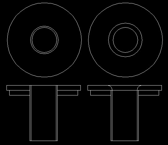

                                    I had an idea to possibly improve the appearance of the port. Rather than bring the tube out flush with the outer cap, I could possibly cut the outer cap to the ID of the port and then round it over. The inner plug would be cut to the port OD, so the result is that the end of the port butts up to the outer cap and you don't see the port end. When you look down into the port, you just see a thin joint. Would this be overly difficult to accomplish? I am thinking it might be hard to align the holes so the inside joint is flush.

                                            Henry,
                                            Sorry but I don't understand the description of the port finishing.
                                            I agree with the aesthetics of a taller narrow tube. And 24" tube is a pain to work with because it's so big and bulky...

                                              • HMenke

                                                Here's a quick cross-sectional drawing. It seems like most people do it as shown on the left, and I am thinking I could do it as shown on the right and have a decent-looking port that doesn't need to be covered for aesthetics. Although it might need to be covered to prevent 8O something falling into it accidentally.

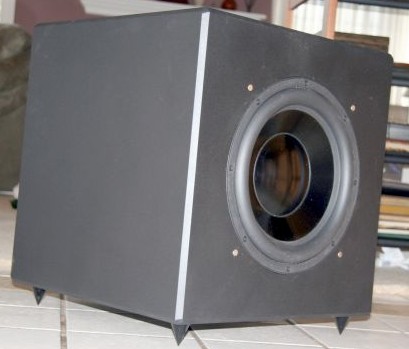

                                                      Originally posted by HMenke
                                                      Here's a quick cross-sectional drawing. It seems like most people do it as shown on the left, and I am thinking I could do it as shown on the right and have a decent-looking port that doesn't need to be covered for aethetics. Although it might need to be covered to prevent something falling into it accidentally.
                                                      I did it as you are showing on the right, and you be surprised to find that quite a few people do it that way. When you get up to large diameter ports, you basically have to create your own flare, and this seems like the best way. Yes, you will want to cover it - I used one of these:
                                                        First yes you can make the port like that. Just factor the flare into the total length of the port

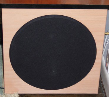

                                                        • HMenke
                                                          • 226
                                                          http://www.partsexpress.com/pe/showd...number=260-426
                                                          Steve, looks good. I thought that the DIY grille on this box subwoofer looks pretty cool too. If it was close to the OD of the top cap, it would eliminate some of the finishing and look cool.
                                                          I also like the type of textured paint found on the second photo of the black box sub - the craftsmanship on this unit is first-rate. I think I will shoot for this finish on the end caps etc.

                                                            • HMenke
                                                              • 226
                                                              Steve, this small flare radius doesn't have much practical effect, does it? I read somewhere that the flare radius has to be pretty large relative to the port dia. to be effective. A small radius like this would be mainly cosmetic, no?

                                                                  How large of a radius are you using? My outer layer of 3/4" MDF is completely rounded over and then I did some "artistic" filing and sanding :B
                                                                  Does it have much of an effect? Probably not - the port is 8" in diameter to begin with, so air velocity never gets very high in the first place. But it has to be better than nothing.
                                                                  • HMenke
                                                                    • 226
                                                                    That's alll the radius I would give it too. I think such a small radius would be almost completely cosmetic because (acknowledging that I'm no expert on fluid mechanics) the difference in terms of air turbulence caused by zero radius and a 3/4" radius has got to be insignificant. I'd think you'd need at least a 2" radius to make any real difference. The key here as you say is going to be the 8" diameter where the air velocity is just plain low to begin with.

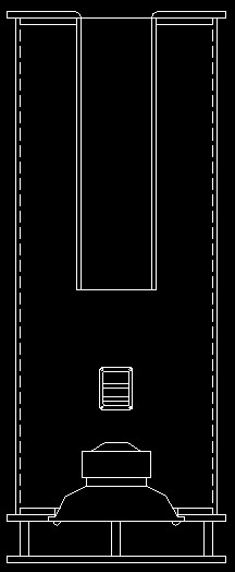

                                                                      Here's a look at what I have drafted in AutoCAD so far. I don't have a CAD model or detailed dimensions on the woofer, so I will have to wait until I get delivery to take measurements and improve the woofer details. Drawn to scale, the port looks pretty big but it still fits the enclosure nicely. This is 22" dia. x 56.5" Sonotube for 315L, and the port is 8" x 31.75" for a tune of 17.5 Hz.
                                                                      How high do you guys recommend the support posts to be? Currently I have them at 4" tall.
                                                                      Last edited by theSven; 28 June 2023, 20:51 Wednesday. Reason: Update image location
                                                                        4" is fine. The design looks good.... :T
