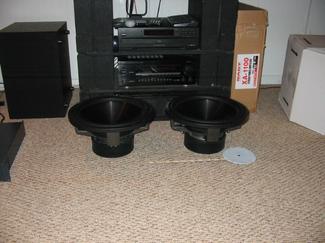

                                              I'm scared that I didn't know what I was getting myself into! Oh my gosh!

                                                I'd be interested in how close you can put those drivers to a conventional TV before you can see the effect.
                                                Ray
                                                  See where the Nady box is. Both are sitting in their boxes in that position. I was worried, but it doesn't seem to be a problem.

                                                    If I had all that stuff I would be hooking those suckers up and seeing how they sound sitting on the floor.
                                                    :B
                                                      It took them well over an hour to come out of the deep freeze they were in. Its kind of cold here in Chicago, and they were in my trunk most of the day. Well, one was in the trunk, and the other was in the passanger seat, because they both wouldn't fit in the trunk!
                                                      By the time they were warm, my wife was home, it was dinner, etc.... I'm going to hook them up tomorrow night.

                                                                            Anyway, back to subwoofers. I hooked up the twins to the amp this evening. I just set them on the floor, and wired them in series. I threw in The Incredibles and Matrix. I'm not so intimidated by them now.
                                                                            I am correct in my thinking that they need an enclosure to function, right? Because there was very little there, and I had the amp turned 3/4 of the way up.

                                                                              LOL - yup, what you heard is the "twins" pumping air from the front of the cone to the rear and back again...
                                                                              Yes, they need an enclosure (or a baffle at least.)
                                                                                They have a VERY stiff suspension, so it will take some time for them to loosen up.
                                                                                Also BE CAREFUL running the drivers without a box, you can damage the drivers doing that.
                                                                                Little sound in free-air? Yep that's because the front and rear waves are out of phase. When there's no box they meet and cancel each other out
