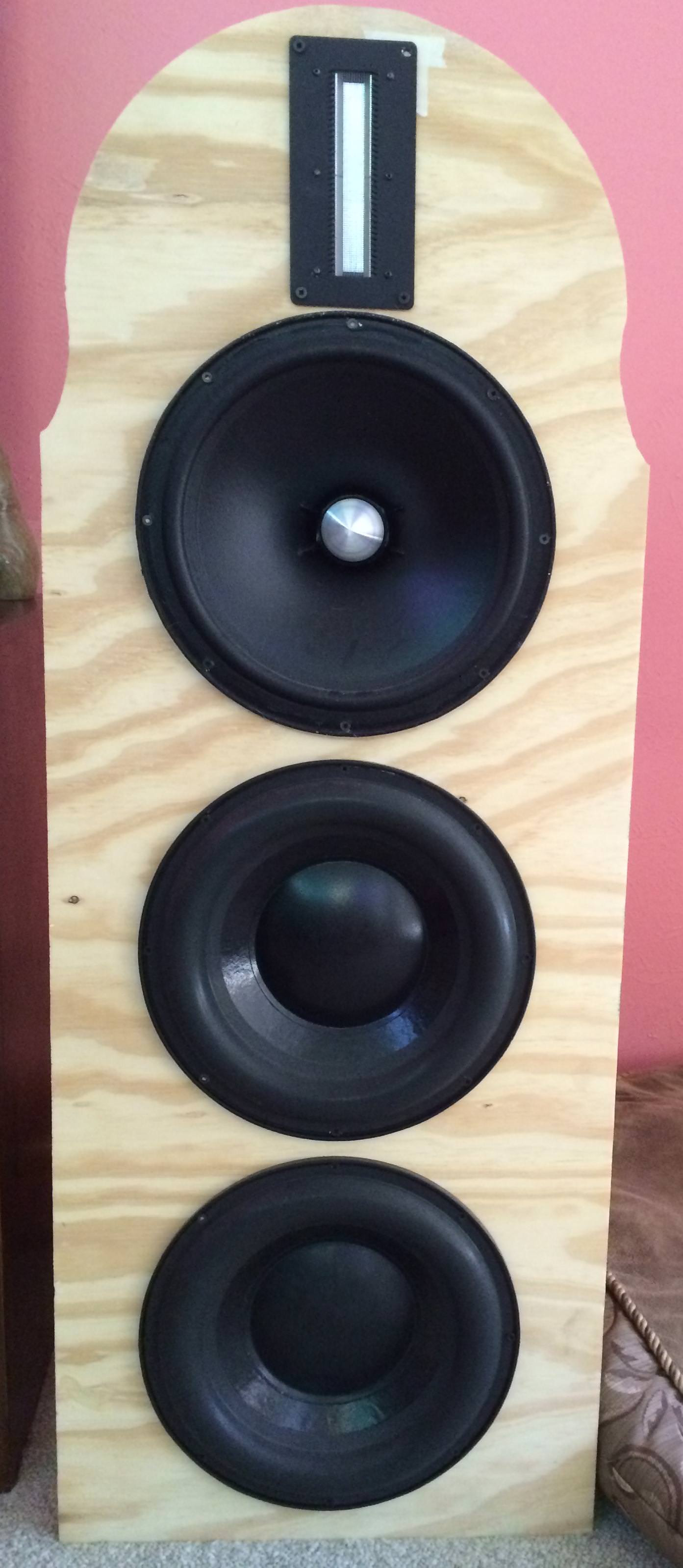

                  No build, but here's a picture. Build was very simple: cut plywood, install drivers . I used a behringer dcx2496 for crossover. The drivers are the GR Research 12 inch servo woofers, Acoustic Elegance Dipole 12, and Raal 140-15d. I'm rebuilding with the same bottom 3 and then will experiment with different one or two driver options to go above the dipole 12.

                    Sweet system!
                    Maybe you can try a Seos waveguide on the Raal? http://horns-diy.pl/en/horns/seos/seos-raal/
                    Where do you cross the ribbon?

                      • neuro
                        • 51
                        Originally posted by Jonasz
                        Sweet system!
                        Thanks!
                        Crossover is the key question and is why I'm not just putting the same tweeter back on top in the rebuild. I've convinced myself that the Dipole 12 does not meet the Raal 140. The Raal really wants 1500+ as a crossover point and even that's being pretty aggressive. A 12 inch mid starts beaming around 1100. They really don't logically meet in the middle. I used a low power amp on the ribbon so there was no real chance of blowing it, then set the crossover as low as I was comfortable (based on input for various strangers on the internet ). I may have settled around 1400 (don't perfectly recall). The problem is that I was probably lacking dynamic headroom from 1400-2000 or so. The Raal just can't be expected to play peaks that low.
                        My goal with the original design was to keep it simple yet top quality. To be fair it generally sounded fine, great actually. When it comes down to it, I also want to play and try something new. If I can't find anything better sounding I'll happily go back to the theoretically sub-optimal but great sounding original setup.
                        I considered that SEOS waveguide for the Raal to get a little extra extension. I read somewhere that the manufacturer doesn't really recommend it though, thin ribbon isn't meant for the greater air load from a horn/waveguide. A TPL150 on a waveguide could be another great option, but the more I research implementation comments the more I see similar comments as to the Raal, they both are big enough to go lowish but they really prefer to stay above 2000. I could go on about good potential options but won't keep filling your thread (unless you want the thoughts) since you were focused on the low end.
