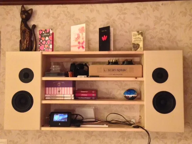

      This is what I did in the kitchen. My wife wanted a "kitchenradio" so I did this with parts I had laying around.
      It's a RS28F and SS15W combo crossed at 1kHz for widest dispersion in a walkaround area. The electronics are a Squeezebox Touch wich can be controlled either by iphone or by touchscreen. Just going to tidy-up the cables and then call it done!
      Plays both Roseanne Cash, Mozart and Metallica satisfactory and the wife is happy (even though she's mostly interested in hitlist country tunes... :roll
      Oh and if she sees this I better mention she actually did the woodworking herself or I'm dead meat... :rofl:

        Now that's slick!! Well done ^^

          Thanks Kevin!
            Nice setup Jonasz.

              Livingroom setup
              Just showed it for ideas and inspiration.
              There's still units around on the used market. It's pretty versatile bc it plays flac from the server, Spotify Extreme and Wimp Hifi (flac).
              I'm by no means an expert in the field and there's probably newer units around.

                That's a nice example of how one can incorporate good sound into a room without needing a specific 'space' for the hifi to be located.
                  Jonasz, very nice little control center.
