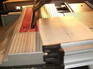

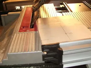

                                                    Facets can be easier to do than they look. For my floor standing speakers, cutting the facets was fairly involved (for me, at least). But for my small speakers like those you’re seeing, it’s relatively easy. Keep an eye on the Schlafmutze thread. Eventually I will post a step by step build process. I took photos along the way. If you have a sliding mitre table on a table saw, it’s pretty easy. Here is a preview:
                                                    Click image for larger version  Name:	CutTopL_Facet.webp Views:	0 Size:	12.2 KB ID:	946760
