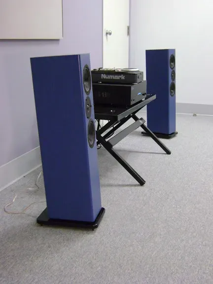

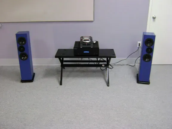

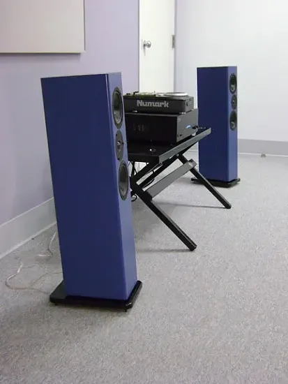

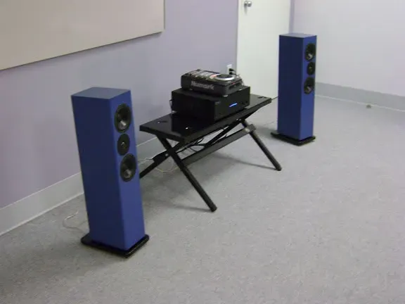

    Finally got them done. Absolutely thrilled with how they sound. Couldn't be happier.
    Complete build thread is here:

    I know it's a common design, but I like to think I put a bit of a unique twist on them.

      Wow ! I'm the first to reply ?. Very nice work , I followed your build over at techtalk forum.. Wondering how they sound tilted ?

        Don't take it personal, things have been a bit slow this time of the year and all. I think you did a fantastic job on the cabinets and it must have been a lot of work getting that paint so smooth. :T
        Question, how far below ear level is the tweeter when you are sitting down? Curt must have designed for an axis slightly above it.

          It's only a 4 degree tilt... before building I checked with Curt C and he seemed to think that it wouldn't affect the sound... they sound great

            They look dam good! I especially like the back tilt they have. I always position my speakers with a slight tilt.

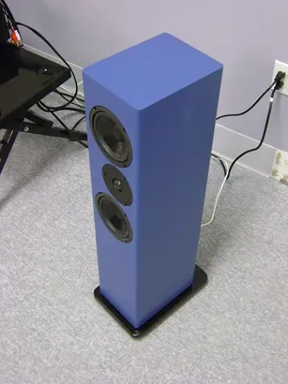

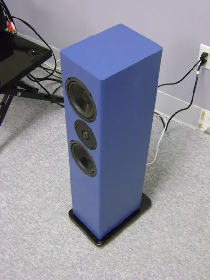

              Getting the paint smooth wasn't that bad... here's what I did...
              1. After gluing the cabs together (3/4" mdf), I used a palm sander with 40 grit to get all the joints flush...
              2. Sealed them with 2 coats of a 50/50 mix of wood glue and water.
              3. Sanded with 320 grit.
              4. Three coats of primer.
              5. Automotive glaze to fix minor blemishes
              6. More primer on the fixed blemishes
              7. Sanded with 400 grit
              8. 3 coats of paint
              9. 3 coats of clear coat
              Sounds like a lot, but it really wasn't that bad. The wood glue/ water technique for sealing works very well. It's easy, inexpensive, and environmentally friendly... I highly recommend it for sealing mdf.
              As for the height of the tweeters, I believe they are about 23" off the ground (I forget the exact dim's)... I do know I designed the tilt such that when you're sitting down 12 feet away they are pointed at ear level.
              The Tritrix transmission line design is 36" tall, which puts the tweeters at 26" off the ground, which is significantly below sitting ear level (which I figure to be about 34"-36")... so I don't think Curt Campbell (the designer of the Tritrix) was overly concerned with the tweeters being at ear level.

                The speakers look great. I will have to keep your finishing technique in mind next time I am going to finish MDF. My edges never look as nice as yours.

                  Very nice looking speakers. I will also have to keep your finishing technique in mind when I get around to finishing my Statements setup.
                  -Chuck
                    If you don't feel like mixing glue with water and want to (maybe) save some money, go to a paint store and ask for 'PVA drywall primer'. Basically it's glue and water and it's used to seal up the paper of sheetrock before the finish coat(s) of latex go on.

                      Nice Job! The slant is cool! Are you going to build a CC and Surrounds to go with? Or is this a strictly 2 channel setup?

                          Very nice speakers! I love to see something else than black piano painting
                          In your room this was just perfect.

                            Strictly 2-channel
                            Actually, this room is at work, where I built them... haven't brought them home yet... but yes it is uncanny how good they look in that room... almost a shame to take them out of there.

                                Finally got a chance to take some better pix... (added to the original post, the first 6 pix with the white background)
                                Not sure if you can tell from the photos, but I repainted the bases to have a less glossy finish... they were too glossy before.
