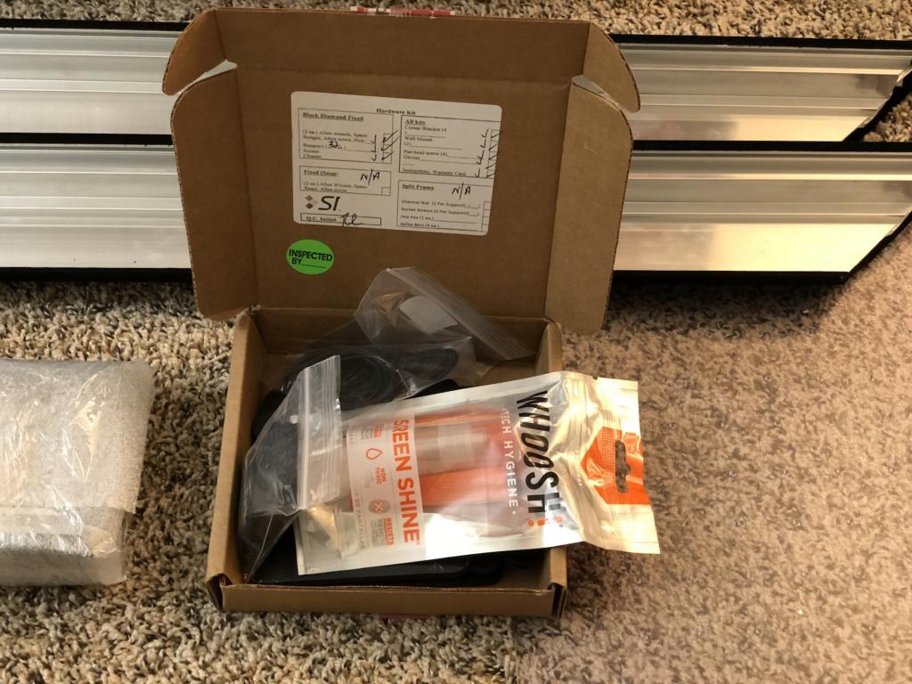

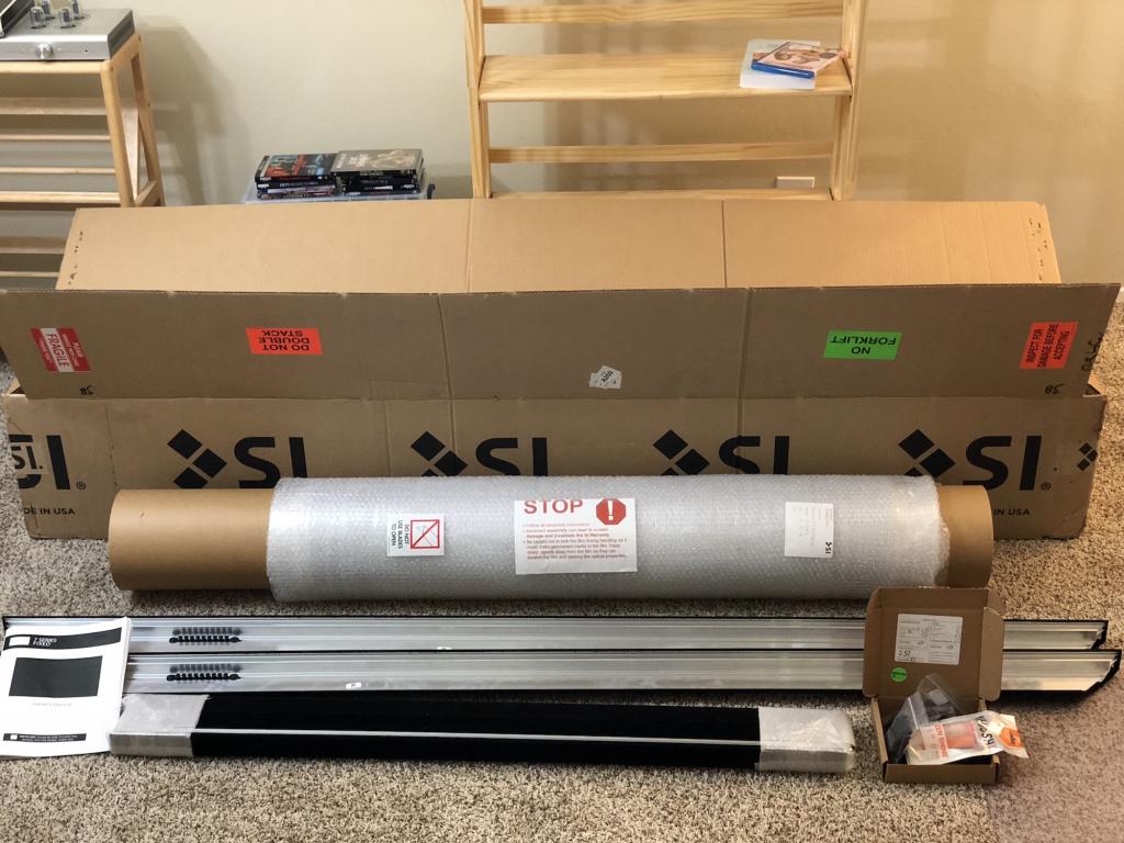

    Everything was nicely packed in one box; heavy foam stabilizers at each end of the box, and the tube for which the actual screen material was wrapped around had the frame components inside.

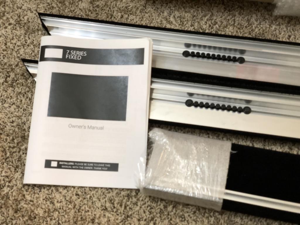

    The manual has lots of drawing but not many words; this works for a lot of people, but I wouldn't have minded more words...
    The hardware box includes gloves for handling the screen and the "bungees" for tensioning it as well as the required Allen head tools for the assembly braces and some spare parts, just in case...

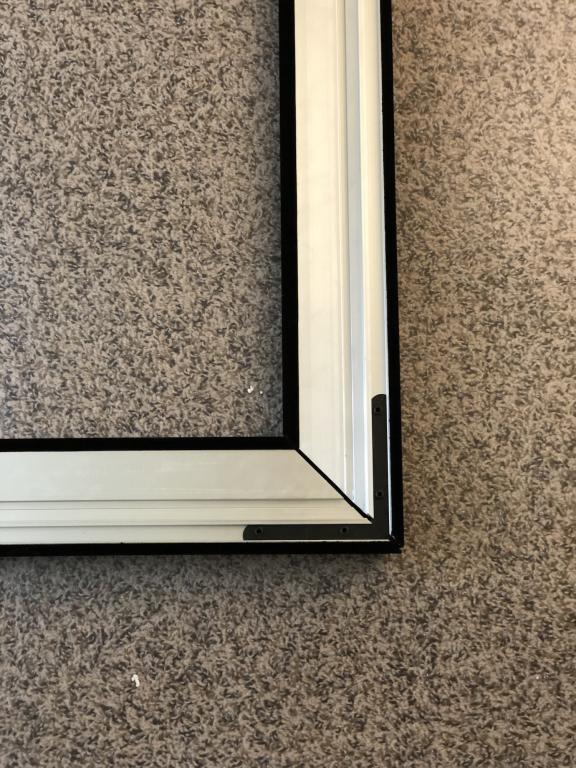

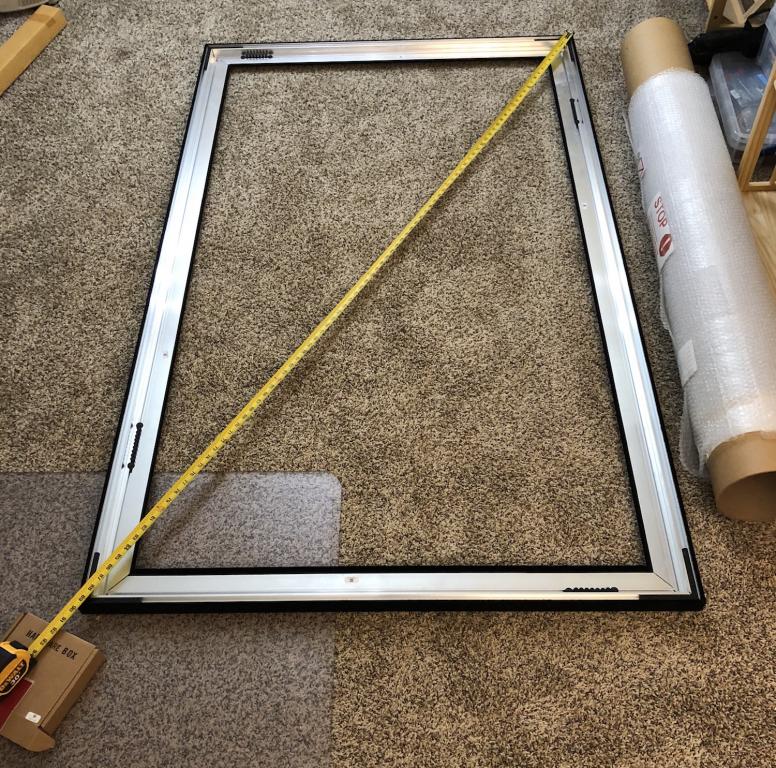

    The key first step in assembly is installing the corner pieces AND getting the screen absolutely square- in practice, this means measuring the diagonal several times until they're dead on equal while adjusting the frame positioning before fully tightening the set screws in the corner - initially, you want to go just sort of finger snug.

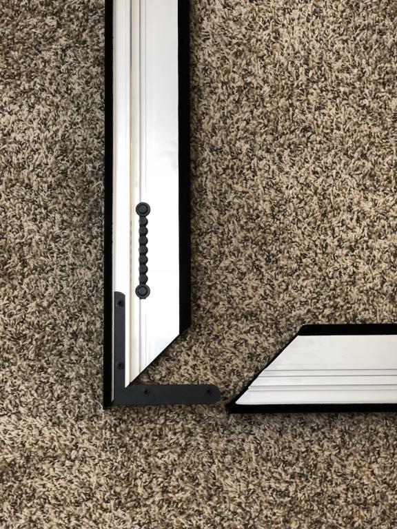

    I connected three sides this way, it's pretty easy to do for the first three, but then I found that it was easiest to install the hardware on the fourth side, and slide it into the existing set

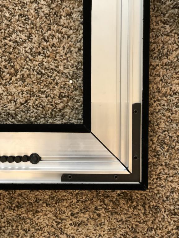

    It's quite important to line the pieces up so that the aluminum extrusion pieces are used to align the miter; the black covering may not be of uniform width on the backside, so don't use it as a guide.
    When the diagonals match (about 89-3/4" for this build) then I went ahead and tighten everything down, while doing my best to minimize the gap on the aluminum pieces- it seems the black covering on the front side is a bit more proud than the aluminum, so I still had a small gap on the back.
    Now it's ready for attaching the screen... as busy as things have been, I doubt I'll get to this before next Sunday evening!
