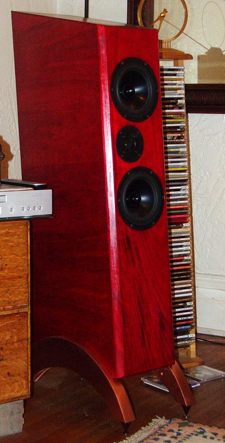

        You can find a more interesting selection of veneers if you're willing to work with raw sliced veneer, instead of backed sheets. Can be cheaper too. Combine that with some solid wood pieces and you can get all of the things you asked for.
            Thanks for the answer,
            I really like the finish of these box. But I've worked once with some raw sliced veneer. I had so much troubles with it... Maybe it was because this was my first time with this material.
            The veneer was hard to cut and sometimes it teared. Notice that I was applying the veneer on a no rounded edge box.
            Do you have any advisce, guide or tricks to be able to do a really nice work like on your box.
                Click image for larger version  Name:	dyemap1s.jpg Views:	0 Size:	11.6 KB ID:	948495 Click image for larger version  Name:	dyemap2s.jpg Views:	0 Size:	13.3 KB ID:	948496
                I like how you stained the tweeter recess to match the veneer. That's the kind of compulsive perfectionism I can appreciate. :T

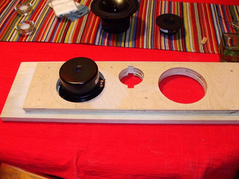

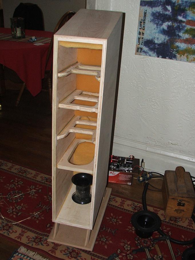

                  I wanted an 'all wood' look on my speakers, too.
                  I did not want to use MDF, and also, did not want to use veneer.
                  The solution I came up with was fairly simple.
                  I built mine using BB ply, but with a bit of a 'twist'.
                  The top, bottom, sides, back and first/inside layer of the baffle were made with BB ply. The front baffle and rear BB ply panels were inset or 'framed' by the sides, top and bottom since I used but joints. This left the edges of the play visible from the back, bottom (no big deal, no one often looks at the back or bottom), front and top.
                  To deal with the front, I used a solid piece of poplar for the baffle, and backed it with the 3/4” ply, resulting in a 1 1/2” thick baffle, which is a good thing for baffles.
                  To deal with the edge grain on the top, I bought a 1/8” piece of BB ply craft board and 'capped' the tops with it. From 3 feet away, you really can't notice the seem or edge of the cap.This pic shows the cabinets with the caps, before staining.
                  Finished with no visible seams or end grain (except from the rear, of course)
                  Just another way to skin the proverbial cat!
                  Last edited by theSven; 22 August 2023, 08:55 Tuesday. Reason: Update image location

                    I like the idea of using real wood for the outler layer of the front baffle. That allows rounding over all 4 edges. But I've read that any real wood will create problems later. With changes in humidty, temperature, etc. the wood will crack and shrink. No personal experience, though.

                      And wkhanna, nice boxes! Doing the BB/solid lamination sounds like a good idea... besides making a seriously stiff front baffle, it likely would help resist whatever warping the Poplar might want to do later.. I really like the different look of the "feet", an artful way to get the towers enough off the ground for that rear firing port to have decent breathing room.
                        Thank you JonP!
                        BTW, I’m sure you meant to say ‘bottom firing port’.
                        As far as warping, when choosing solid wood, you need to ensure the moisture content of the piece is V low, kiln dried or naturally aged wood is available at lumber yards, but the stuff you get at BB hardware stores has much higher H2o content. This may be the reason some others have reported problems. You know, people have been making furniture from real wood for while, it seems to have worked OK for a few thousand years.
