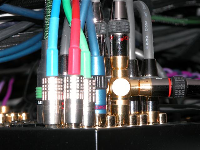

                                            Well, I finally found the time to do the Pseudo Bi-Amp of my mains.... It certainly is noticable for a psuedo bi-amp :T In my old set up it was noticable only at the upper volume range, however with the Rotels sending 200WPC to the Mid/Highs and 200WPC to the Bass Drivers, it is noticable over the entire volume range.
                                            Bass just seems so much tighter now with a lot more Punch. On Jesse Cook's Free Fall Album, Track 6, "Incantations" it's as if I have tactile transducers bolted to my couch :E It's awesome. :E
                                            I can also turn up the volume to much louder levels now before the B&W 600's start to lose control. Before Bi-Amping, a Volume level of 80 was about the point when distorsion would creep in, now I can go as high as 88 or 90 depending on the disk... It's loud and it's extreme, and I would not listen at the level for long, but it's still pretty clean and controlled at that point. The highs are significatly more distinct an seem crisper. Cymbals just seem to hang in the air some point above the speakers. I played Roxy Music Avalon in Multi Channel SACD, and it was so cool! It has so much depth and dimension that was not there when driving the B&Ws with only 200WPC. It makes me want to do the full mod of removing the stock cross overs and replace them with electronically adjustable ones. Before I was looking at maybe upgrading my mains, but I may just settle in for a bit as this has really given new life to my speakers. And I may experiment more with actual Bi-Amping with external cross overs.
                                            You know that old aeronautics addage of "Anything will fly if you bolt enough power to it"?
                                            Well it seems almost "Any Speaker can sing if you bolt enough power to it"
                                            Here is the T unit.
                                            While I wouldn't recommend going out and buying amps just for the pseudo Bi-Amp, if you have the spare amps kicking around, then it's certainly worth while.
                                            I currently have the 1080 driving the Mid/Highs, and 2 channels of the 1095 driving the Bass drivers.

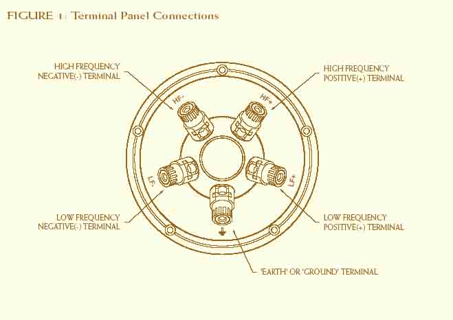

                                                I know that Tannoy do this. Here is a cut and paste from their site.
                                                "All models feature a Tannoy researched and pioneered system of driver chassis earthing. This system reduces the effect of RF interference, which would otherwise blur and mask fine detail."
                                                I know others as well, but cant recall which specific models..

                                                  I picked up the same adaptor as Bing did for my 1066. I'm using 4 channels from my 1075 to feed my Paradigm monitor 7's.
                                                  So far I've only listened to Fiona Apples "When the pawn". There is much more clearity to it now. Everything from the high's to the low's is more detailed, cleaner and more open sounding. It's not an earth shattering difference, but well worth the effort.

                                                      The photo was just to show how some manufactors use the grounding of the speaker chassis.
                                                      Just to show that this is not just my crazy idea... 8)
                                                      In regards to the cable - you could use a "Y" splitter cable inserted into the amp end, that way you would only need one pair of interconnects. However since your using the 1080&1095, then that does not apply..
