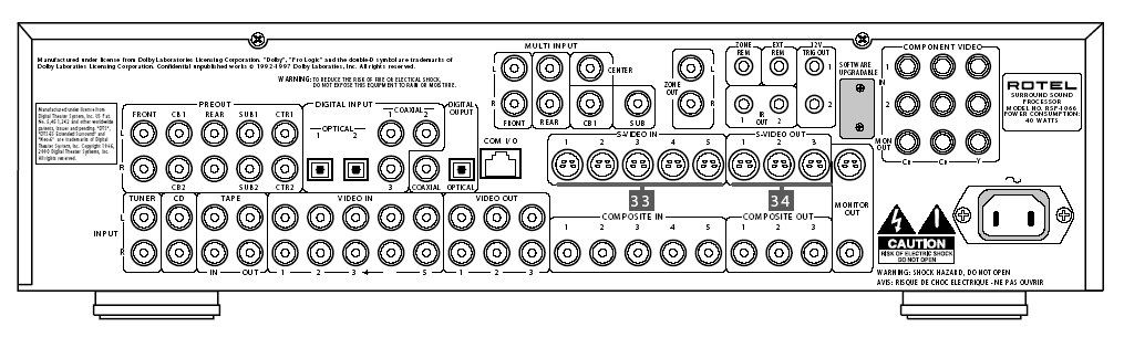

    Does the RSP-1066 have 7.1 out connections??

    Hi!
    This is the back view of the 1066:
    I hope this will answer your question. As far as I can see, the 1066 has preouts for two back centers (CB1 / CB2), so 7.1 should be available. Only the multi-inputs seem to be restricted to 6.1.
    • dali
      • 48
      To the best of my knowledge there is no 7.1 source material. DD EX and DTS ES are both 6.1, the extra channel in 7.1 is not a discrete channel, it is derived from the CB channel. Hope I'm making sense.
      If the original question meant "can I have a a 7.1 speaker setup with a RSP 1066" the answer is yes.
