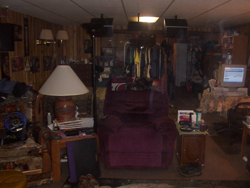

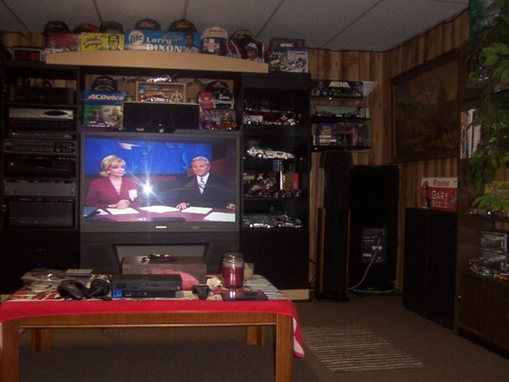

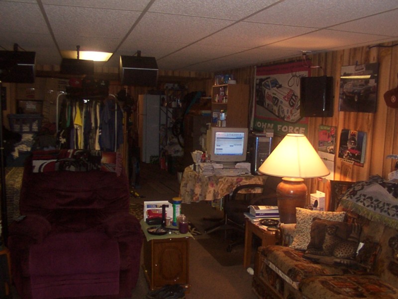

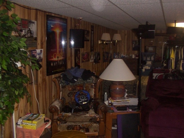

                It seems like all the bass signals follow each wall to the right and left of the sweetspot.I am going to post some pics here in alittle bit as soon as they download from my camera and post them so you can see my layout and the limited sub placement.
                • RACER4551
                  • Apr 2004
                  • 71
                  The sweetspot is 14 feet away from the front of the tv and the side walls are 6 1/2 feet away from each of the side walls.Sorry for the dark pics,this setup is located in a basement and is pretty dark down here.

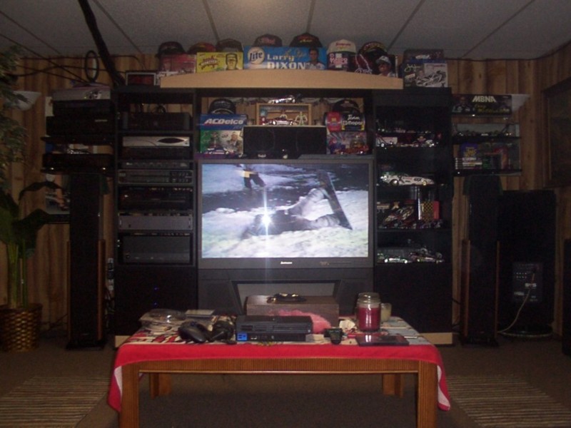

                    Here's a better pic of the sub location,i could try and move the sub out further on that right front wall.
