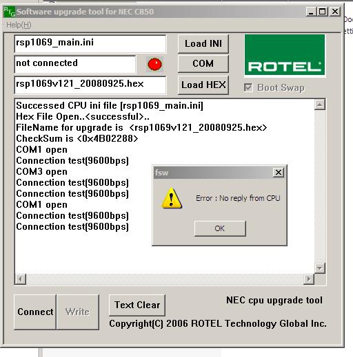

    Hello.
    I am trying to upgrade the Rotel RSP-1069 with the latest firmware obtained from Rotel.
    I have the official cable from Rotel.
    I am using Windows XP.
    I have a serial port on the laptop.
    I activated firmware upgrade in the rotel menu system.
    Whenever I try to connect, I receive the following error
    "Error: No reply from CPU"
    I tried all the com ports; my serial is com1.
    PLEASE HELP ME! WHAT AM I DOING WRONG?

    Have you put the RSP-1069 into the upgrade mode?

      Yes, I have

        Just something you can try: can you put 115200bps in the field next to connect? or maybe you need to change the baudrate of your COM port to 115200bps.

          Unfortunately, that did not work either

                                  • mkedda
                                    • Jan 2009
                                    • 6
                                    this update allowed the hdmi handshake to occur between my projector, rotel, and htpc.
                                    i fnally got it to work when i set the rate at the highest possible level in the com setting

                                                                    I too am having difficulty upgrading firmware, on the RSP-1069. I have the NEC flash 2.7 upgrade program, plus the main, video and audio firmware. I am using a USB-Serial cable, with DB9-RJ45 cable.
                                                                    I've set the COM3 port to 38400, 8 data, 1 stop, No flowcontrol, etc.
                                                                    All I get from the processor upon trying to "CONNECT" is "Error : unknown reply code from cpu".
                                                                    Help!

                                                                    • Kevin D
                                                                      • 4601
                                                                      You might have to try a different usb-serial cable.
                                                                      Also, is the db9-RJ45 the one that came with the unit? Off the shelf ones are not compatible. You need the Rotel cable or make your own.
