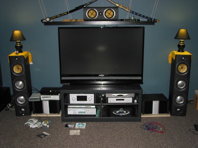

                                    • 2901
                                    You need to get it for the "Wow" factor. Trust me.
                                    That's a 1090 sitting on the left and the 1095 on the right, plus I have the 1080 sitting in a box, it doesn't really get used much as of right now. Might sell it, dunno yet.
                                    The differences are this...
                                    1090:
                                    -Much better bass control. It's not as "heavy" or "bloated" as the 1080. It's extremely quick and accurate and definitely deeper, almost like there's weight behind each bass hit.
                                    -The highs, at first, I think are softer. What I'm hearing is that I think the the 1090s highs are more defined. They aren't as powerful as the 1080 or the 1095 for that matter. But they are more accurately produced. After a few days listening I really like the sound better, miss a little bit of the brighter sound of the 1080 and 1095, but the accuracy makes up for it. Plus you can hear differences in how cymbals are rolled against or hit. Definitely easier to picture if the cymbal was hit in the center or outer edge.
                                    -Mids: About the same on either, the 1090 I'm finding has a little more detail to the voices, but there's not as huge of a difference as the rest.
                                    Imaging between the two is is almost identical, with me tipping my hat towards the 1090 ever so slightly. I really think they kept this almost identical.
                                    The biggest thing you will notice is the quickness of the 1090. It's like you're playing music faster, everything has attack, bass drum hits, bass strings plucked or fingered. Even guitar strings have a quickness when strummed quickly. Which all creates a much more accurate/real-to-life quality to the music.
                                    For me, I was a little hesitant to get the 1090 as I already had the 1095/1080 combo, but after having it now for a few weeks (I had let wkhanna use it for the last 5 months or so) and done some serious A/B, not blind mind you, but as best I could A/B, these are what I notice with my measly B&W 604s3s,
                                    ...and the best part, when powered on, it dims the lights in the house (even on it's own dedicated 20amp circuit in a 200 amp service on the same leg). Yeah it draws some power on start up. lol
                                    I ONLY wish it had a 12v trigger, that would have made me very very very very happy! But I guess that means I need another APC unit...maybe a H15 to go along with my S15. :B
                                    But do you need anything more than it does look bad a$$!!!!!! Isn't that enough!? :rofl:
                                                            Hey! What is my amp doing in the pic of your system!
                                                            Oh Wait.......That is my old amp. And it does look V nice in your system too , BTW.
                                                            Thank the gods I now have my own all BLACK 1090. The improvements is.....well...... like day and night.
                                                            All of the above is a joke between friends (a friend, BTW, that would let me use his own premium equipment with no reservation all....thank you, Dan!), but everything that Dan so well described about the 1090 is a true account of what happened when I put a RB 1090 in my system.
                                                            In fact, after having Dan’s 1090 in my system for a week, I was compelled to searched out and find one for myself. But my all black RB 1090 is just a slight bit better. :W
