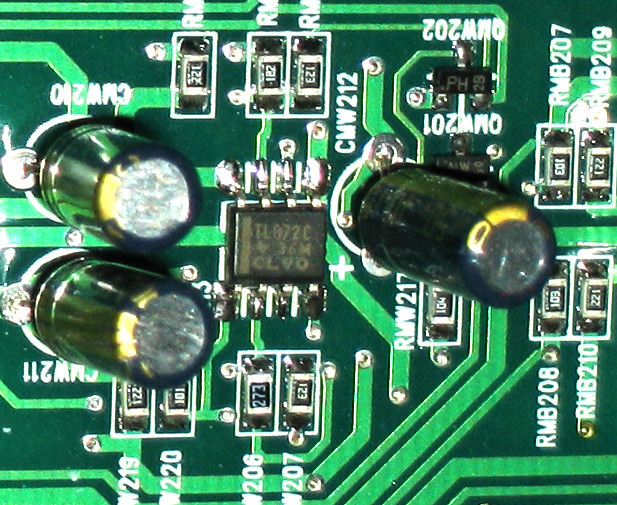

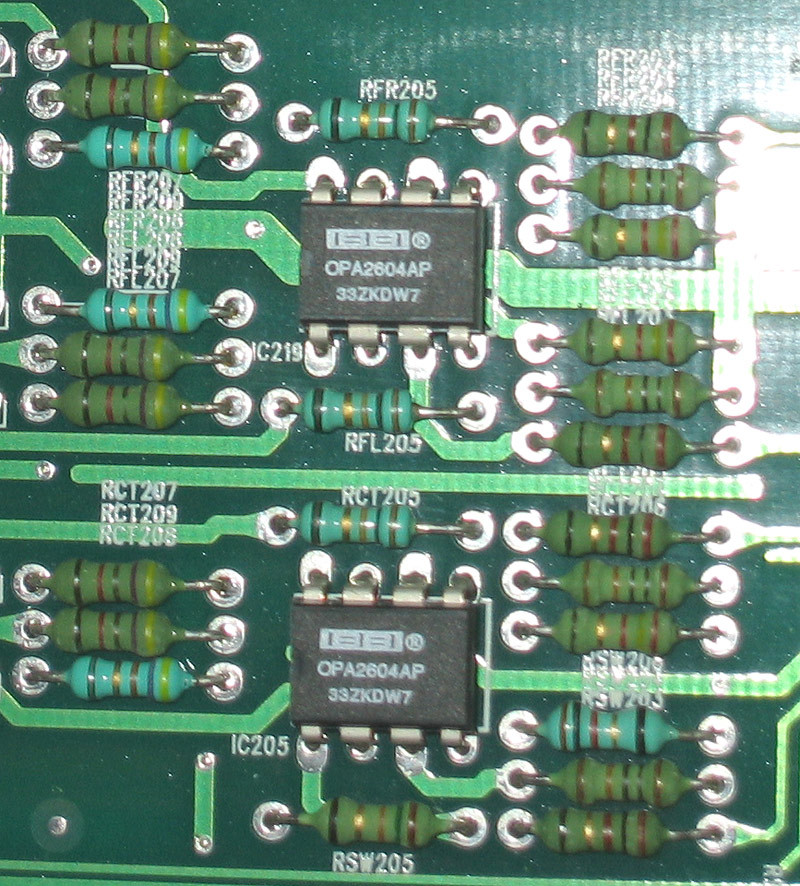

                      Hello Guys,
                      I am so sorry to revive such an old thread, but I really need to ask.
                      I have an old RSP-1098 that I still love and use, of course it lacks all the new stuff out there, but for HDMI switch I use an equally old VP50pro and a Dabelet device.
                      I have a friend, who is a computer engineer, he said he can help me swap the chips, for free, however, since he never fiddled with amplifies and Rotel, he asked me precise instructions, I know I need to replace a few op-amps, to a better one.. OPA627, if not mistaken... How many of those should I buy to improve MULTI-IN, Pre-outs, and at least 2 other analog inputs?
                      Do I only need the OPAMPs? Is there any kind of the adaptors? Also.. I checked Farnell Newark and Digikey, and I found:
                      - OPA627AP;
                      - OPA627AUE4;
                      - OPA627AU;
                      Which one should I buy?
                      Please anyone, some help? And again, sorry for re-living such an old thread.

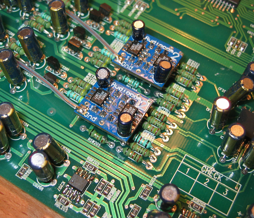

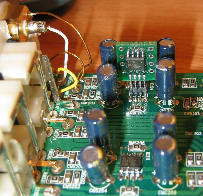

                        Hi!
                        Quite a long time I tweaked my 1098 (still used nearly everyday), but from what I remember :
                        OP627 are single opamps, you will need two of them to replace the stocks dual Opamps (TL072C & OPA2604AP if I'm right) from the Rotel.
                        Stock:
                        Modded:
                        I recommend you to consider the following two modules :
                        Parts ConneXion offers 25,000+ high-end DIY audio parts, from capacitors to vacuum tubes. Get premium components, expert support & fast worldwide shipping!
                        Best regards
                        Yves

                          Hello Yves and thank you!
                          How many modules should I buy? I would like to improve multi-in, pre-outs and 2 analog inputs.
                          and where do they go? I mean.. You have used 2 different components, right? a pair in place of the TL072C and another for the OPA2604, right?
                          THank you!
