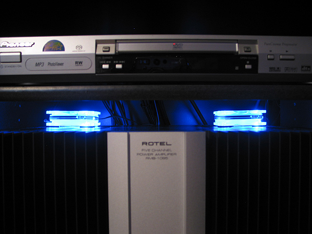

        • 2901
        Wooo hoo to PC fans! Since this picture they've been updated to 120mm fans which move a ton more air and produce less noise. I can barely hear all 7 fans at 6ft away with it dead quiet. I mainly here the PSU fan which I'm going to get a fanless one at some point.

          PewterTA, where did you pick up those fans. looks cool! also, how do you have them wired and in which direction do they blow? into or away from the 1095?
            thanks!
            i cant tell how PewterTA has them wired,but from experience with fans i suppose that for optimal airflow you need to install fans that blow air IN and fans that suck it OUT!
            i think something like a 2(or 3):1 ratio of IN-OUT fans is good but i can be wrong !!! :

              If I were to put fans on the top of my amp I would have them sucking air out of the amp because heat rises, and you want the fan to asist that existing air flow. The fans will be drawing cool air in the bottum of the unit if set up this way. If more cooling is needed fans blowing in can be used but should be placed underneeth the unit for best results!

                I have 2 X 12v fans in top of my 1095, one on each side on hot days only. I had them sucking but there was too much noise for me so I turned them over & now have them blowing air in from the top. They still do the trick but only use them here in summer when it is 30+ in the house.
