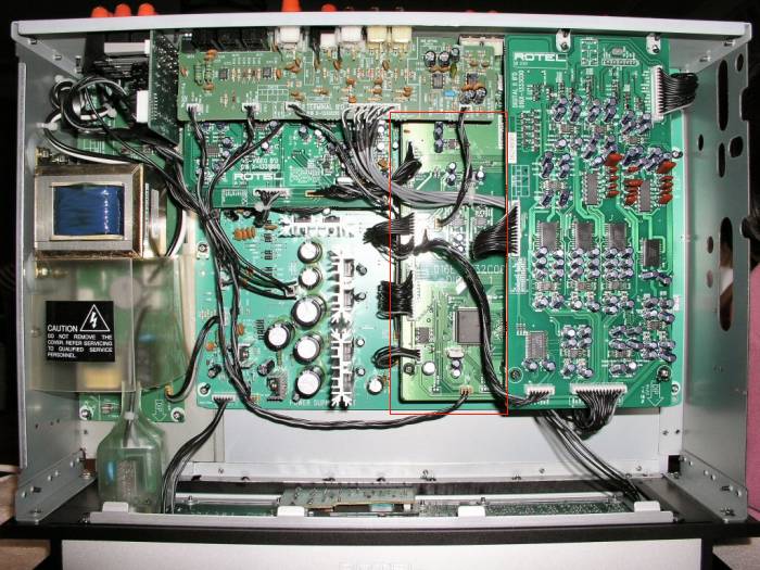

                    In my case the processor board was replaced for a new one. If this is your case, don't forget to upgrade firmware, as the new board had an old version. Now everything is OK
