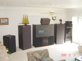

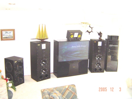

    The picture in my "avatar" to the left is my latest DIY subwoofer project. It has two active drivers and 4 passive radiators, and I'm driving each of the woofers with a separate amplifier.
