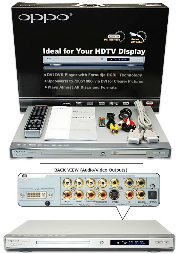

    I love watching music DVDs, and I want to improve the quality of the audio side. I currently use an LG DVD which is connected to my Rotel / B&W hi-fi system.
    I’m therefore looking for a reasonably priced DVD player that is highly regarded for its sound quality. I was interested in Rotel but I’m now tempted by the Oppo OPDV971H because it's inexpensive and the video quality is rated so highly. However, can anyone comment on the sound quality of this DVD player?
    I'm also interested to know whether a modern DVD player like the Oppo will provide superior sound quality to my 13-year old Rotel RCD-855, thereby enabling me to play CDs and DVDs on the same device and free up space in my cabinet. Do any of you have an opinion on this?

    Hi Bigburner, I haven't heard the Oppo. While the 1072 pretty soundly beats the 855 (my dad has one), his 855 is, IMO, better than a 945 (which I picked up about 2 years ago). I'm pretty sure I'd take the 855 over a 4 year old (basic) pioneer dvd player that I've been using too (if I only wanted to play CD's). For its age, the 855 is a good disc spinner.
    To be honest, I don't think that a player, such as the Oppo, which retails for approximatly $200 US (I think) and has heaps of features, will have a fantastic analogue audio stage. However, as stated above, I've never even seen an Oppo, let alone heard one. My comments regarding the Oppo are speculation.
    Hope this helps, Ben
      Thanks Ben. Do these specs tell you anything about the SQ of the Oppo?
      Hardware:
      RF AMP/Servo DSP/CD Decoder/DVD Decoder: MTK1389
      Memory (Flash): 8M(bit)/16M(bit)
      Memory (DRAM/SDRAM/SRAM): 32Mbit/64Mbit
      D/A Converter for Video: MTK1389 108MHz/12bit & CS4955 54MHz/12bit
      D/A Converter for Audio: CS4360 192KHz/24bit
      Loader: Sanyo Optics DV34S
      Audio:
      192 KHz Sampling Frequency, 24-Bit High Quality Audio DAC
      Dolby Digital Down-mixed 2-Ch Stereo (L. R)
      Built-in Dolby digital Decoder, Dolby Digital (AC3) 5.1 Channel Output
      Built-in DTS Digital Decoder, DTS 5.1 Channel Output
      Dolby Digital/DTS/LCPM Bitstream Output
      3D Surround (Virtual Surround): Concert, Live, Dance, Techno, Classic, Soft
      Audio Characteristic:
      Frequency: 20Hz~20KHz
      Signal-to-Noise Ratio: >90db
      Dynamic Range: ≥ 80 (1KHz)
      Total Harmonic Distortion: <0.01%

        I don't think the specs would allow anyone to make such a judgement except in the case where they revealed clearly inferior components. As unfortunate as it is, there is really no way to know unless you have a listen.
        The only other option would be to find someone like Jerry who owns an Oppo and might have made comparisons to his other players.
        • DrJRapp
          • Apr 2003
          • 1204
          What aspect of Audio are you concerned about? Digital multi-track, analog 2 channel or analog multi-track.
          If it is digital multi-track you are concerned with then the Oppo will, like any other DVD player, function purely as a transport, (a good stable one at that with it's Sony-designed Sanyo-built SACD loader) and your pre-pro or receiver will do the yeoman work of conversion to the analog domain, therefore it will determine the overall sound quality, not the Oppo. If your concern is analog 2 channel then we have to look at the fact that the Oppo uses the exact same Crystal Semicondutor 192/24 bit DACs as does the RDV 1060, so it should sound roughtly similar. Some people even say that it will outperform the Burr Browns in the RCD 1072, however, I myself like the Burr Brown sound, that's why I have a dedicated ($2K)CD player that utilizes them. The DACs in the Oppo basically are the same DACs that also appear in the RSP 1098 and 1068, so I can't imagine why someone with either of those components would use the analog 2 channel output of the Oppo anyway. Why incurr the cost of more cables? As`for multi-channel audio such as DVD Audio and SACD, I would have to vote for the Oppo over the RCD 855 because if my memory serves me correctly, the 855 didn't have those modes back in it's day. I used to play SACD from the Oppo to the Multi-inputs of my 1098. I found the bass management to be useful, and the Oppo was every bit as clean as my Denon 2900 (very highly regarded for audio) in DVD Audio. I now do all multi-channel audio only thru the Denon, mostly to avoid additional cable overhead.
          There are certain members of these forums who, due to their lack of knowledge of the real facts would incorrectly try to lead you to believe that the Oppo is somehow sub-standard due to it's low price and small size. Next time do you homework guys before shooting from the hip. Don't let the low price fool you, the DV971H is every bit as audiophile as an RDV 1060 even though it may not be as pretty. Audio wise, it will hold it's own with most four figured machines. Build quality is excellent by the way. The Oppo is built by a huge company called Winbase, which is at least as large as Sony or Panasonic. They also build the Cambridge Audio pieces side by side in the same plant, as well as the remotes for Rotel.

                Facts eh? Jerry, I do not doubt the digital prowess of the Oppo. BUT, Bigburner has an RC-1070. No processor with DACs (by the looks of his profile). I therefore assume that he would be relying on the Oppo's internal DACs (which are fine) and it's analogue output stage - not so fine in comparison to the Rotel RCD-855. So, in reply to this question:
                My opinion is that the CD playing performance of the Rotel RCD-855 will be superior to the CD playing performance of the Oppo.
                This opinion was formed by looking at the facts. Let's start with some of the specifications supplied Bigburner:
                Now, compare these to the RCD-855's equivalent figures:
                SNR: 100dB
                Dynamic Range: 96dB
                THD + Noise: 0.0025%
                Comparing the Signal-to-noise ratio:
                The signal to noise ratio of the RCD-855 is 10dB greater than that of the Oppo. FACT: (Assuming both have correct line-level output voltage) The Rotel's analogue stage is 10X less noisy than the Oppo's. 1 point to the Rotel.
                Comparing the Dynamic Range:
                The dynamic range of the Rotel is 16dB greater than that of the Oppo.
                FACT: The dynamic range of the Rotel's analogue stage is 39.81X greater than that for the Oppo's analogue stage. 2 points to the Rotel.
                Comparing Total Harminic Distortion:
                FACT: The Oppo's analogue output stage has 4X the total harmonic distortion of the Rotel. 3 points to the Rotel.
                So, in using the FACTS (based on my homework :W ) and not simply 'shooting from the hip', I still recommend that if Bigburner gets the Oppo, HE SHOULD NOT get rid of the RCD-855.
                Jerry, I'm not rubbishing the Oppo, but a LOT more goes into sound quality than just the DACs used. IMO, the statement:

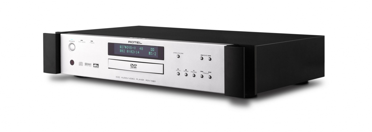

                is rediculous. Let's talk power supply, analogue output stage topology and components, component layout. Despite using the same DAC (I'm relying on your infomation here, haven't checked this), the analogue performance figures for the RDV-1060 are as follows:
                Audio characteristics:
                Signal / Noise Ratio 110dB
                Frequency response:
                CD (at 44.1 kHz): 2 Hz to 20 kHz
                DVD (at 48 kHz): 2 Hz to 22 kHz
                DVD (at 96/88.2 kHz): 2 Hz to 44 kHz
                DVD (at 192/176.4 kHz) : 2 Hz to 88 kHz
                Dynamic range:
                16 bit: more than 100 dB
                20 bit: more than 110 dB
                24 bit: more than 110 dB
                Wow and flutter: Unmeasurable (less than ± 0.002%)
                Total harmonic distortion:
                16 bit: less than 0.0018%
                20/24 bit: less than 0.0012%
                The Oppo every bit as audiophile as the RDV-1060? PLEASE.

                            In case any Oppo owners are interested, there is a guy who modifies the Oppo DVD player. Kris Deering tested his modded machine against the stock machine and found significant enhancement in picture quality and a some noticeable improvement in sonic quality. $400 for the mod. http://www.boldercables.com/servlet/Detail?no=265
                                Jerry,
                                some time ago I did a lot of search figuring out the DACs on various equipment. So I have to say that all mentioned equipment has different DACs:
                                Oppo: CS4360
                                RDV-1060: CS4396
                                RSP-1068: AK4395
                                RSP-1098: CS43122

                                      I may get fried for this opinion, but I'm always surprised at how little value manufactures and consumers put on the actual look of components. I know that there is a good debate over the Oppo vs RDV 1060 etc..., regardless as to who is right I have to say that the Oppo looks cheap.
                                      Personally I want to please my ears and eyes. I have a friend who has a whole B&O setup with the virticle CD player (BEO 9000), the oval DVD player beautiful speakers etc, while the sound quality may not be the absolut best, it is still pretty good and the looks/design of the equipment is jaw dropping.
                                      Its funny that most people when buying things for their homes (i.e. appliances, cabinets, couches etc.) consider looks equally if not more to quality, but that all changes when it comes to home theater. Granted most people in this forum have good taste becuase the buy rotel and rotel is good looking equipment that sounds good.
                                      Ever piece I buy for my HT has to look as good as it sounds, and I have made some decisions that may reduce sound/picture quality by 5-10%, but in exchange increase the quality in looks by 100%.
                                      LOL after saying all of that and going back and forth between the Oppo and RDV 1060 I have decided to buy both, just to do a comparision for myself, and have the good looking RDV 1060 in my rack. If the Oppo sound and picture quality is miles better, well I guess I will just have to hide it in my B&O AV rack
                                      sorry not sure if I really made a point here....
                                      I'm sure you are not the only one that feels that way. I for one, hate displaying ugly or cheap looking equipment. BTW, this is not aimed at the Oppo.

                                        since we are comparing stats, lets compare the one you CAN do by looking.

                                          I agree with you completely. I love the way my Rotel gear sounds, but I'da had a harder time justifying the purchase if I didn't enjoy the appearance of the equipment. The same can be said for my B&W speakers. Granted, everyone has different taste, and what is appealing to one person may not be to another. However, I don't think appearance of quality is as subjective. One may not like the appearance of Krell's equipment, but I doubt anyone will argue that it looks cheap.
                                                  I wouldn't exactly call the Oppo ugly. It is small and unobtrusive and it uses the same shade of silver powder coating as Rotel does. It essentially can be made to dissapear on a rack. It's even smaller than the 1077.
                                                  I may be going blind, but all DVD players look (appearance) about the same to me in a darkened theater room!...lol
                                                    and what about when the lights go on? I guess if you have a HT room dedicated to just HT then it is less of an issue. If your components are in a high traffic area then it becomes more of an issue.
                                                    tell me...whats missing from it that makes it so much smaller and lighter then most other players?
                                                        It's got a state of the art switching power supply, therefor no massive transformers or capacitors. Other than that, just air.
