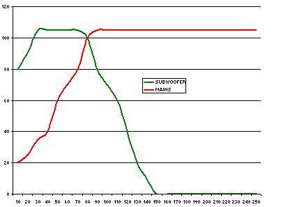

        June what the cross over point means is that at the setting you choose the main speakers will stop playing and the subwoofer will start. Now its not a brick wall meaning that your speakers won't be playing anything below 100 hz just that it rapidly falls off compared to frequencies above that point. It might make more sense if you look at the following plot that I did for my speakers some time ago.
        As you can see the front speakers play down to around 80 hz in this plot before rolling off on a steady curve while at the same time the subwoofer starts to pick up about the same time to maintain a smooth response all the way down to the lowest frequency its able to play. Ideally this transition should be very smooth so that there's no hole from where one speaker transitions to the other but that's easier said then done in many rooms without the aid of an equalizer to boost or cut problem spots.
