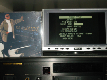

        Asterduc,
        I gotta say... you have me stumped... Unless you just hooked up the RCA cables from your player to your RSX and didn't remember to re-assign your RSX's CD input from digital to the analogue inputs? Have you unpluged the digital cable from your CD to make sure?
        I use the RCA inputs from my CD player assigned to the CD selector, and assigned the digital input from the CD player to Video 3. That way I can use the CD selector for 2 channel listening or multi channel HDCD listening, and use the video 3 selector for multi channel listening.
        Cracking!
