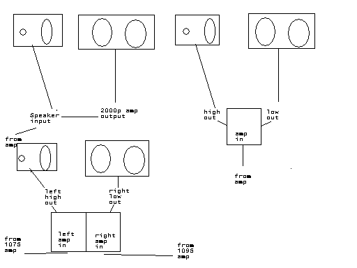

          Do you have the 2000p's or i's? (p's have the built in power amp for the subs).. If you have the built in amp, I would look into getting an external crossover, ditching the built in amp, and the running the 1090..

            Hey kevin,
            I do have the 2000's with the built in amp for the subs. How do I go about doing all that?
            • Kevin D
              • 4601
              A couple of different ways.. Non user friendly.
              You have too choices. Passive or active. Passive you would install a passive low-pass crossover inside the sub unit. You could then either run a 1090 to both the upper speaker unit AND the wires going to the sub unit's new crossover. Or you could run your 1095 to the sub crossover and the 1075 to the upper-unit.
              Second way is to get and active crossover like the Bryston 10B. It has selectable frequencies for the upper and lower crossover points. You would then have to use two amps, the 1095 to the subs and the 1075 for the highs..
              If any of that all ready sounds like more you want to handle, then I would stick with what you have. You have big speakers, but in reality whatever amp you get will only be powering the 6.5" mid and the tweeter, the 1095 you have now will be plenty of power for them.

                  Much appreciated on you're thoughts guys, i like the idea of doing some mods.
                  Kevin D: Whats the possabilities on you giving some diagrams for doing these mods to my speakers? Would really like to get my hands dirty on this one!
                  • Kevin D
                    • 4601
                    Easiest way would be to pick up this:
                    4ohm crossover
                    I choose 4ohm because I believe that's what the sub section of your speakers are. It appears that the crossover is stereo. You should be able to cut the crossover in two and use each side in one speaker. If not, you will have to by two.
                    Take the amplifier out of the back of the speaker. You should see two sets of wires. One will go directly to the speaker inputs (on the top I believe) The other will come out of the amplifier section. Remove both wires.
                    The crossover will have three connections (negatives may be shared, I'm not sure). From amplifier, high-frequency out, low-frequency out. I'll continue as if you will only have one amplifier running the speaker.
                    Run a new wire from the speaker input to the from amplifier contacts on the crossover. Run the wire that used to come form the speaker input to the high-frequency out. Run the wire that came from the amplifier section to the low-frequency out.
                    You now have the speaker level input running all the speakers, with a crossover splitting low-frequencies and high-frequencies to the appropriate speakers.
                    If you wanted to use your 1095 on the low section and the 1075 on the high section, go ahead and get two of the crossovers and don't split them apart. Run the 1095 output to the right side and only hook up the sub wire to the right low-out. Run the 1075 output to the left side and only hook up the mid/tweet wire to the left high-out.
                    I'll try to attach a very crude MSpaint diagram. Upper left is stock. Upper right is single amp, lower left is two amps.
                    Depending upon how the wires are connected to the 5-way binding posts, you might be able utilize both the speaker and subwoofer binding posts to have a stock appearance from the outside.
