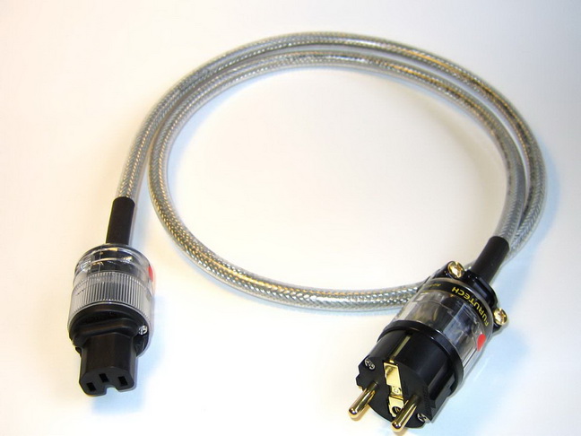

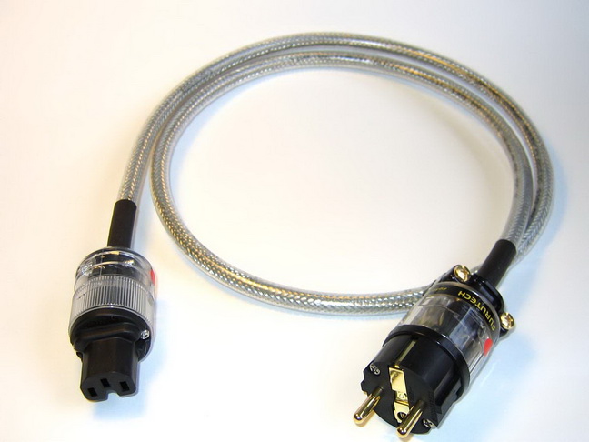

hi all
I have mad my cables myself with a cable from Lappgroup with some plugs from furutech and those works fine for me
and i think that those make a big + to my system :T
looks like this
this one
it dosen cost so much $$$ to buy and it do a great job for me
here is a guide with belden powercord
diy guide
have a nice day- Bottom
I agree 100%! This is a good DIY project. The best thing is that you can reuse the plugs if you need a longer cable in the future, or if you need the cable shorter, that can be done for free! What's not to like about that?!- Bottom
14 awg is fine for most equipment, but rather thin for power amps, unless you're at 220/240V like frasse74 (the double voltage means that the current requirement is cut in half and consequently a thinner cable can be used). At 120V, I'd recommend 12 or 10 awg for the power amp...- Bottom
