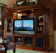

      Here is the entertainment center that i'm using. The console where the 67" samsung DLP 1080p will sit is wider by 11" and has three compartments instead of two like the picture shown. So the C1 processor, Denon 5910 DVD, (3) JC1's and (1) A21 will be enclosed behind glass doors. It will be quite the squeeze.

        Ouch! That will be tough! You somehow need to be able to provide a flow of fresh cool air at the bottom that uniformely flows on the sides of the JC1s and is exhausted at the top.
        I guess the easiest solution would be vented doors and a bunch of fans at the back should do the trick.
